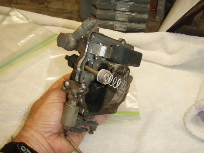

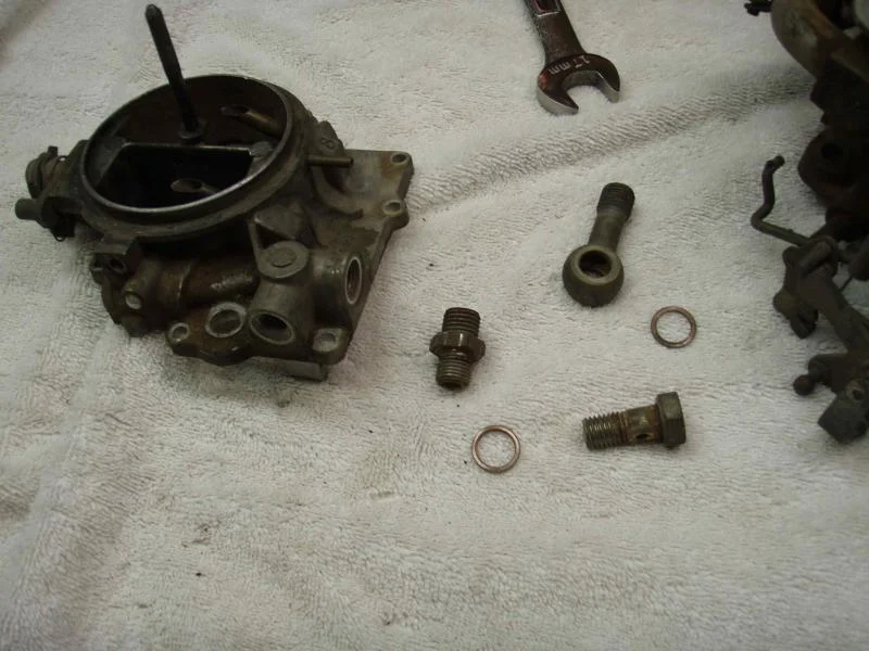

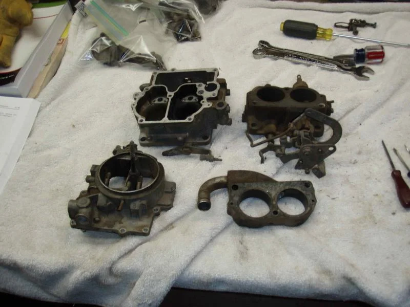

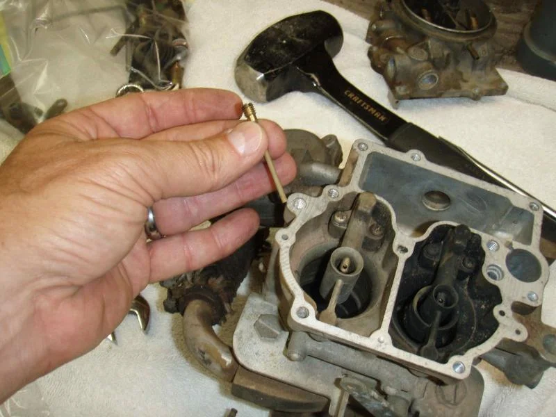

This evening I set off into dissassembling the carb. Here are a few pics.
and here are a few more pics of progress

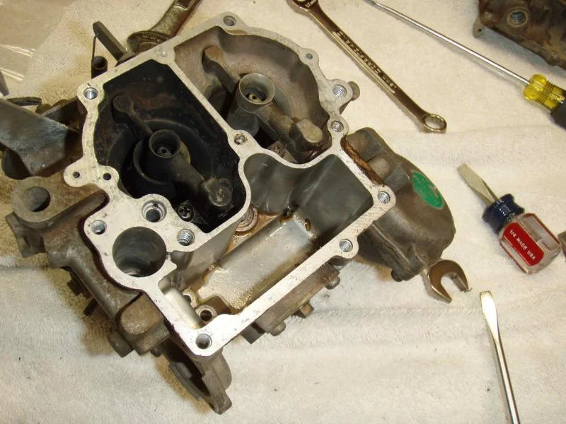

The air horn disassembly came off without a hitch. I was on my way into the base when I got to the jets. The primary came out nice and clean, but the secondary appears to be the victim of abandonment in a previous rebuild.

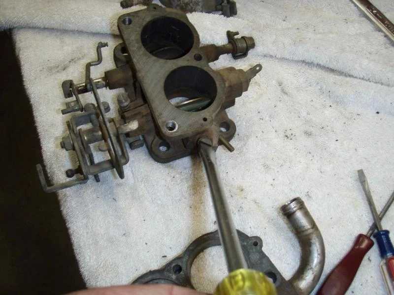

I have tried to get a picture or two but its tough in the bottom of the bowl. The face of the secondary jet is totally stripped so I have hit it with PB and now I'm looking for help. I really don't want to get out an extractor as I have mostly poor experiences. Does anyone have the silver bullet?
IIRC you're going to want the biggest/widest screwdriver blade that will still fit through the access hole. Be careful not to make it worse than it already is. Take the primary jet to to a couple of stores and pick up a couple of different screwdrivers that fit tightly. If a screwdriver that fits tightly doesn't fit through the access hole, try grinding down the width of the screwdriver a bit. It should not be that difficult to remove.
In the end, if you can't get it out, there is no rule that says that you must remove every part during a rebuild. If the secondary is clean and working, you can try just leaving it in.

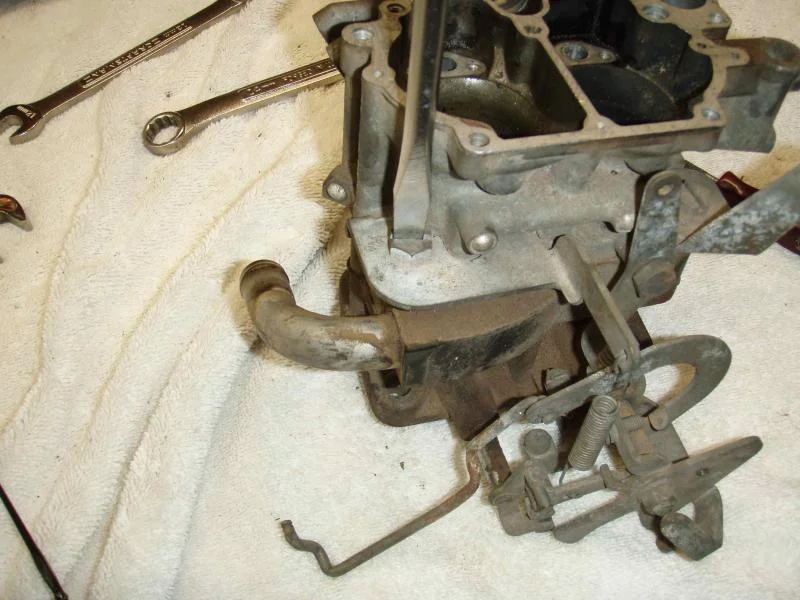

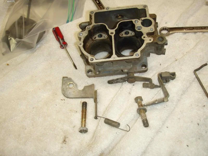

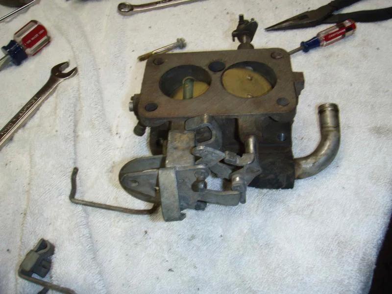

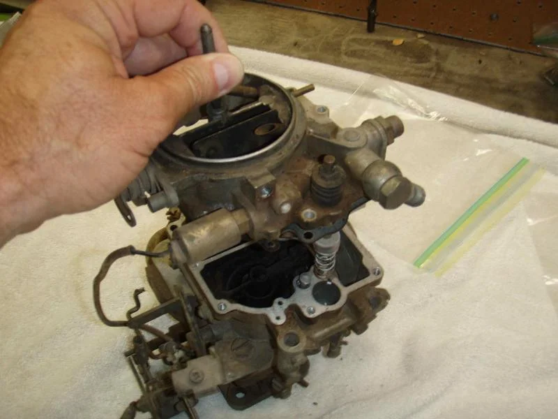

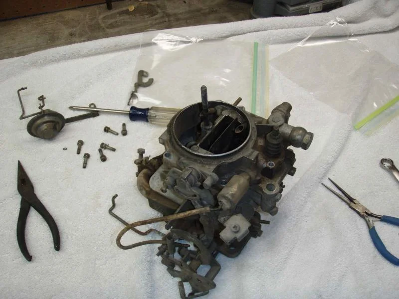

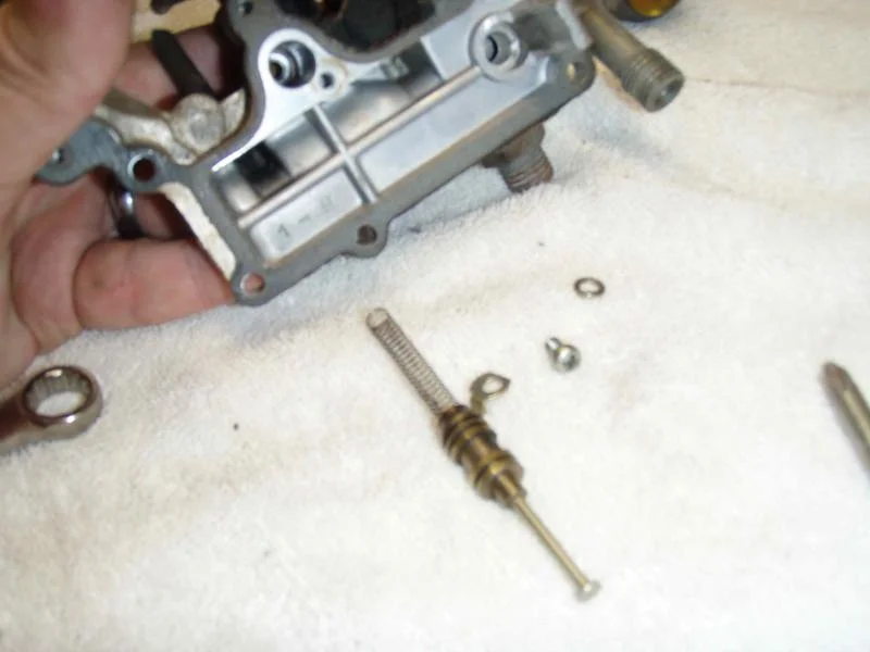

I've kept going knowing I want to get that secondary jet out before dipping and cleaning. More pics of progress.:popcorn:
...and finally at the stopping point for the night, I've got it disassembled (with the exception of the secondary jet) and ready to clean.

On screwdrivers, what about that big fat one with the yellow handle that you are using? I'd take a grinding wheel to the sides of that until it fits through the access hole.
If you haven't tried yet, spray around jet with PB Baster. I had the exact problem with mine. It was the first time I've used the Blaster. 20 min. later it unscrewed like butter. My .02
