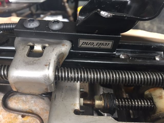

The most difficult part of any of this was the seat riser install. Take your time, curse, and make yourself a cocktail pre-install.
(I had just finished getting the passenger seat working with new gears and caps and I was TERRIFIED of F'ing things up. But I didn't and all went well)
And I must say the wife appreciates the extra height of the riser.
F.E.M. (fire extinguisher mount)
Seat Riser
