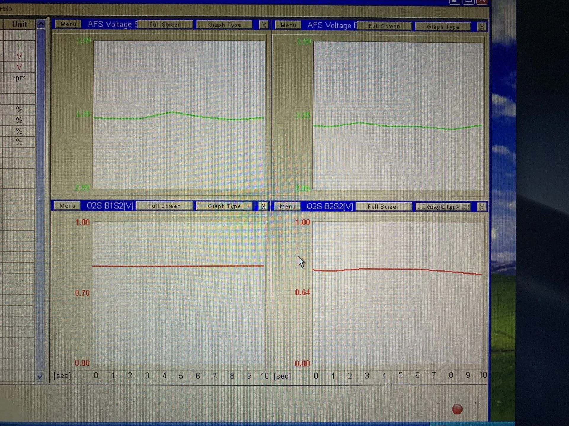

After replacing fuel filter, cleaning MAF and TB, no pending code yet and I see some difference in B1 and B2 Voltages.
I can see what @Julian Stead said about B2 sensor moving up and down. at least the Voltage is close to B1 and B2S2 has some moving between .64 to .74
@Julian Stead do you see difference in pic below to the earlier one. some changes, improvement?
The voltage and the small amount of switching(moving up and down) is good, nothing to worry about, what is good to see is that your B1S2 is now within spec....If that amount of switching brings up a fault code in the US I would be surprised.
All looks good at the moment, hope it stays clear.
