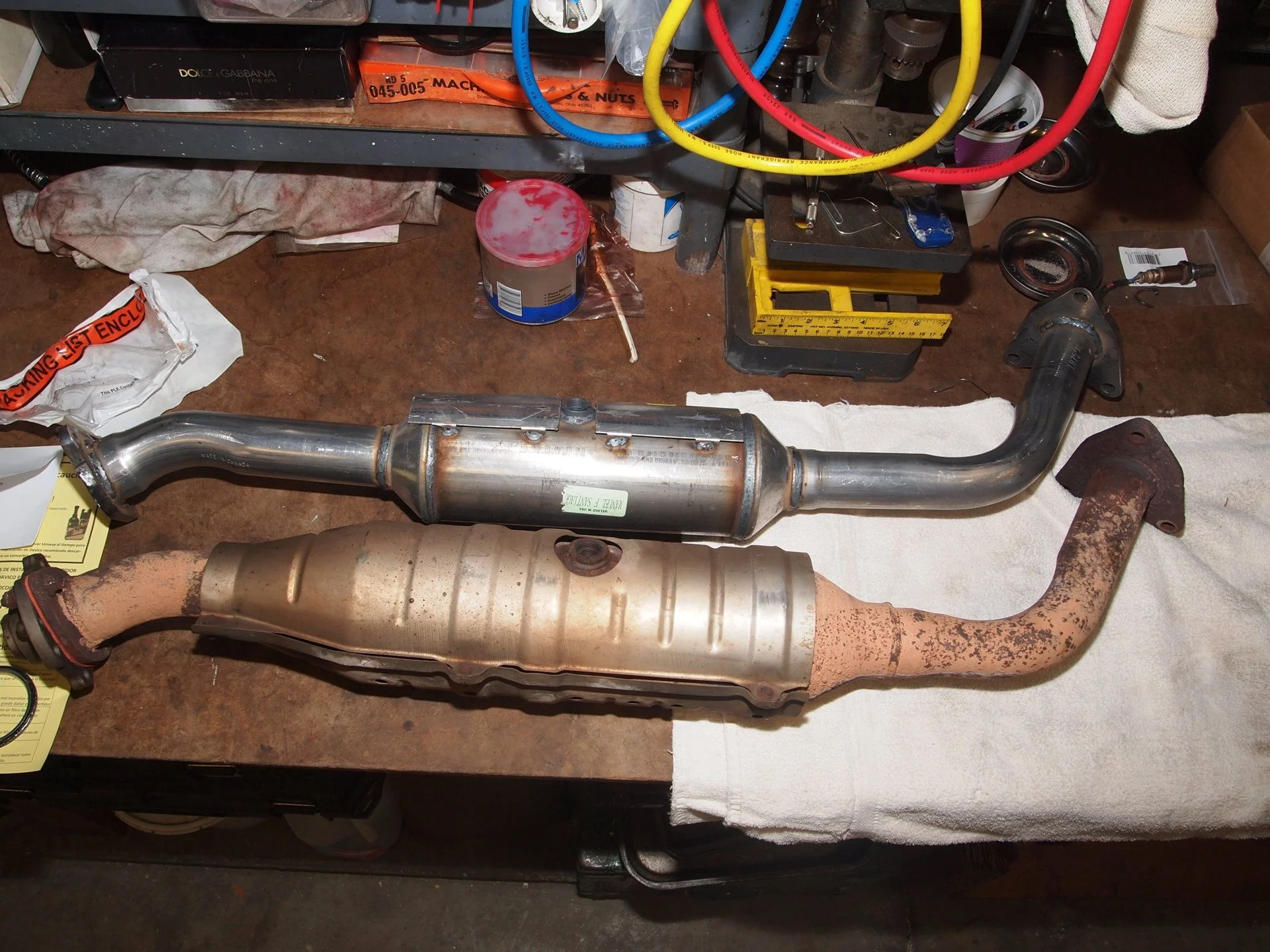

The CAT I used on bk1 (DS P0420), Davico 17194. I did so to match, what Midas installed 4K miles earlier on Bk 2 (PS P0430), which was before I got involved with this rig.
Davico does not sell retail. To my door, I was right around $300 from retailer. I'm having issue with customer service of both manufacture and retailer I purchased this Davico from. So I'll not post a link. A dumb issues really. But I'm shocked at how they've handle it. Makes me wonder about how they'd handle warranty. But all these aftermarket CATs, are 5 yr or 50K miles warranty. They must be tested and approved to EPA standards. They are all consider a lifetime product, OEM or aftermarket. They do not just go bad if well made. Something external effects them.
Davico comes with plug (plug was missing in one I bought) for second O2 hole and two gaskets for pipes/flanges. It's universal as to PS or DS, that's why it has two O2 holes. I purchased a new 18mm plug (automotive drain plug), two O2 18mm crush washers (no one but me replaces those), two OEM gaskets (I like them better), 3 OEM nuts for upstream flange studs of exhaust manifold (FSM has as none reusable), Two nut & bolts (FSM has as none reusable) for down stream pipe flange to muffler.
The Davico replacement CAT internal ceramic material, has a slightly smaller diameter and are shorter in length than OEM. They have a heat shield on top only. I'd like to see a full heat shield. One could wield on brackets and fit OEM shielding. But not a big deal to me either way.
The CAT Midas installed did end up getting a P0430 again. You can read about in the link I provided early and here in this thread. You'll see reading the above link, Midas totally messed up every single point they touched on installing the PS CAT. I've correct the issues Midas created, and I reinstalled the CAT. Some stuff they messed up I've not yet posted. So far no more CAT code. But they touched the O2's probe, so it may have a limited life.
I had pulled that PS CAT Midas installed, just to see what was going on. I thought perhaps they did not correct upstream issues or run 44k, seafoam, CatClean, etc cleaner through engine before install. To not clean upstream carbon & gunk before install, it may re-clogged. I talked with them and they did not do anything corrective. I had run cleaners 44k, seafoam, CatClean and repair upstream stuff, before I installed DS CATs. So I thought possible I re-clogged the PS CAT Midas installed.
I felt, since it was replaced recently. It would be easy to remove. I also had all parts I needed to reinstall by the book. So I pulled it off.
Man was I pissed off. I've seen so many bad job, but this one was a mess. You'd think exhaust is one thing Midas would do right. Hey they were once called Midas Muffler.. No wonder the P0430 DTC came back.

Even OEM narrows in bend. Notice the heat shield.

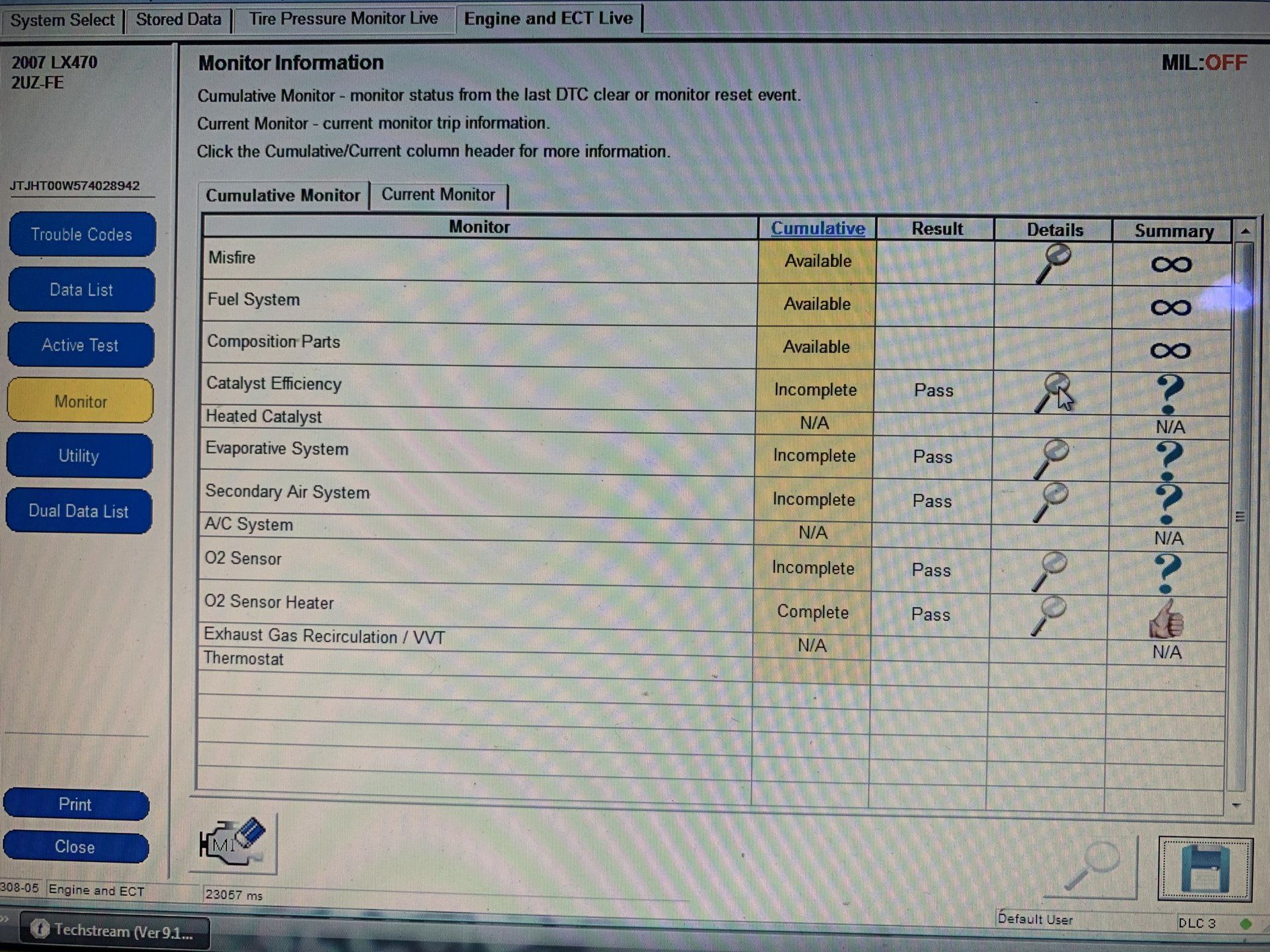

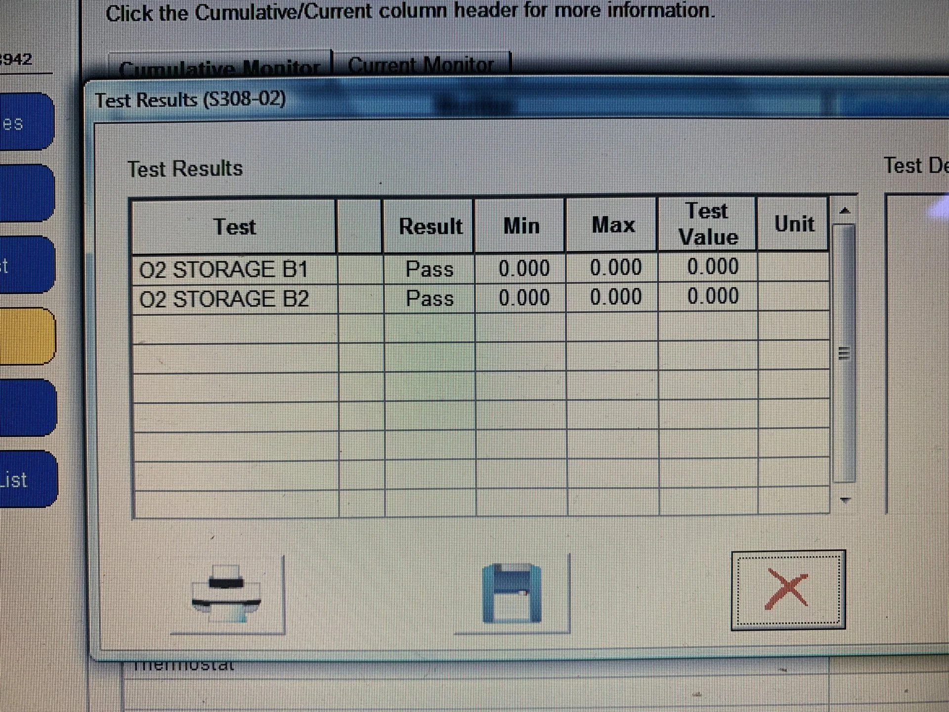

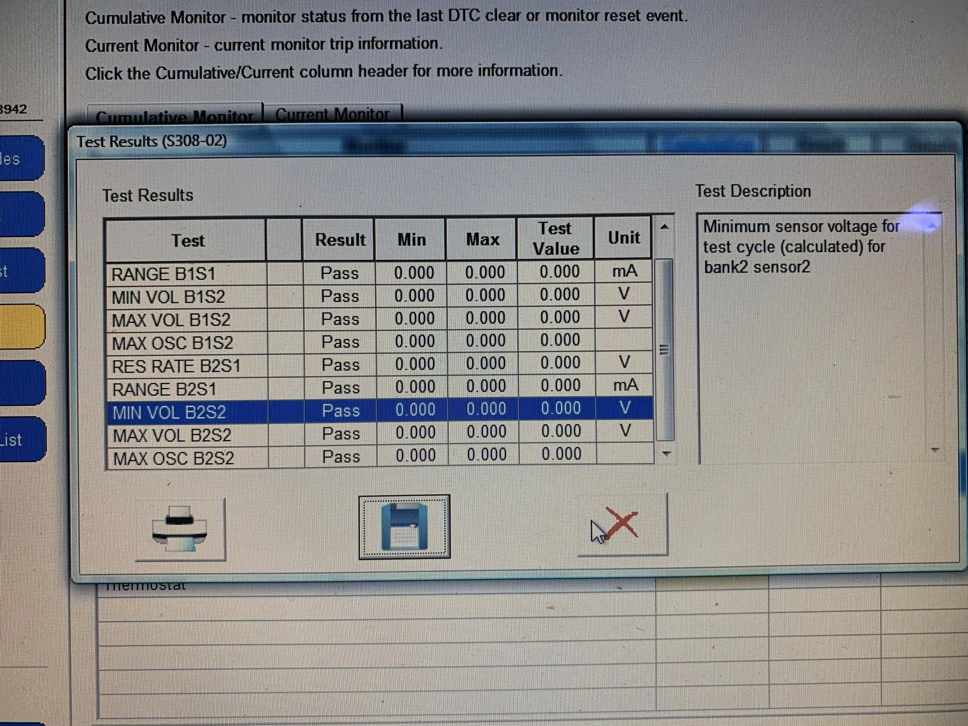

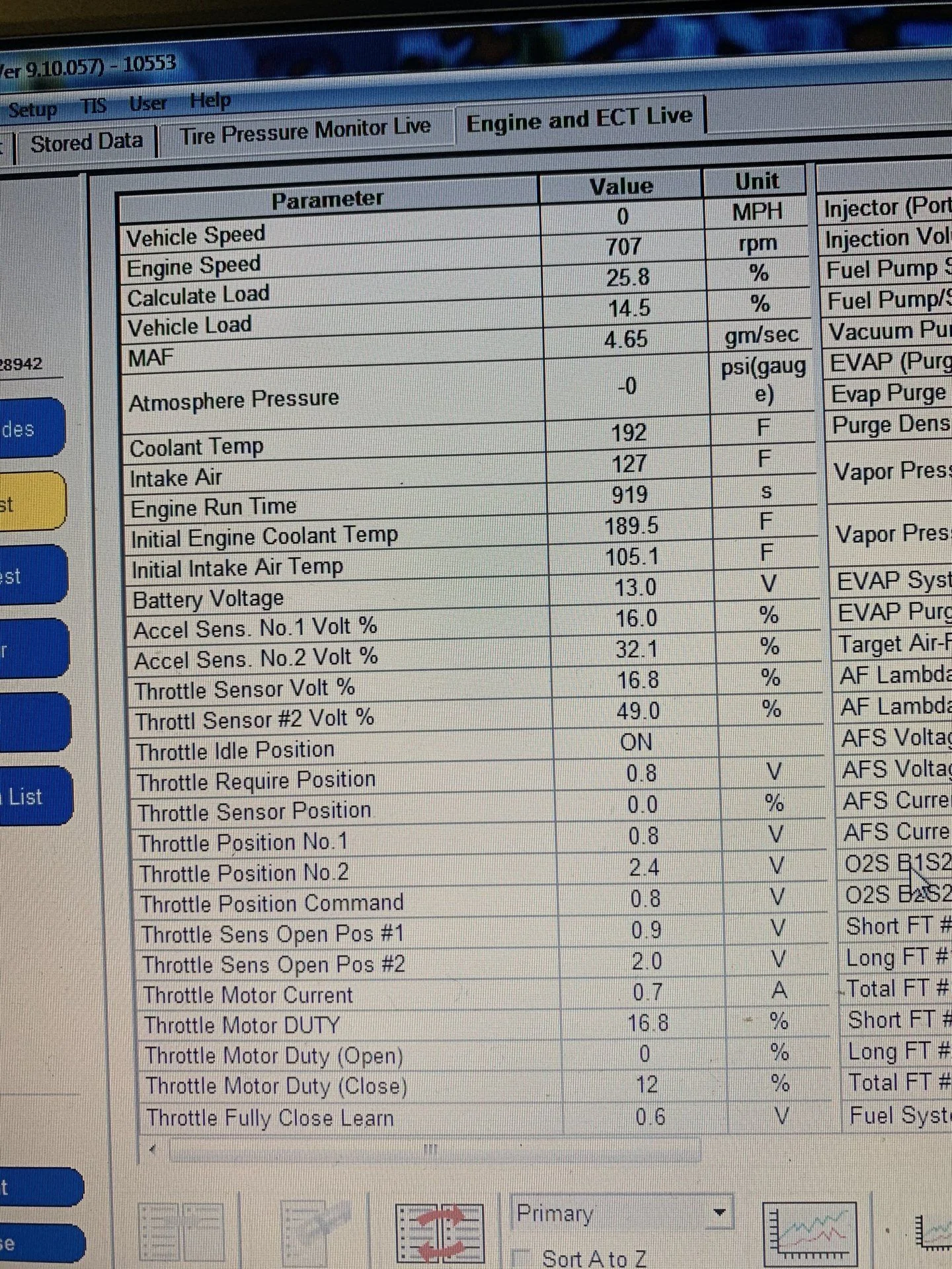

Is it safe to say I have no problems with AFs, O2s nor catalyst converter with these data?
Interest CEL going out.
Do you have CAT Temps. After warm up Run at idle, and then at 2K RPM record CAT temps at start of 2KRPM and after two minutes held at 2K RPM..
Be interesting to see what happens when you swap O2s.
ok ok both are crush bent. the heat shield on the aftermarket is welded? for decoration only? Lol!
the oem heat shield has 4 bolts on it

Your coolant temp looked okay, but just a tad high at 192F (depending on OAT (outside Air Tempo), may by just right, if you were just idling.

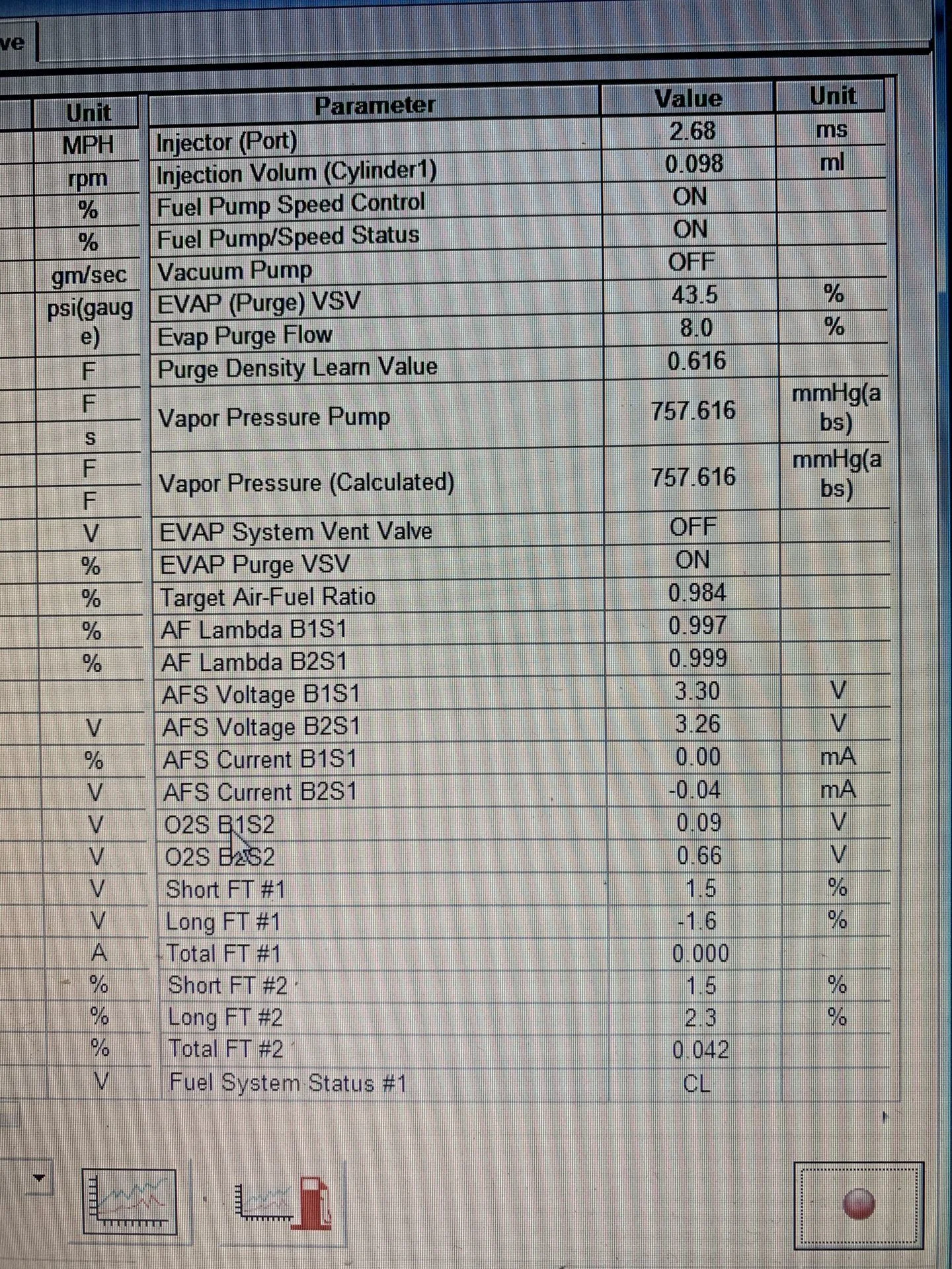

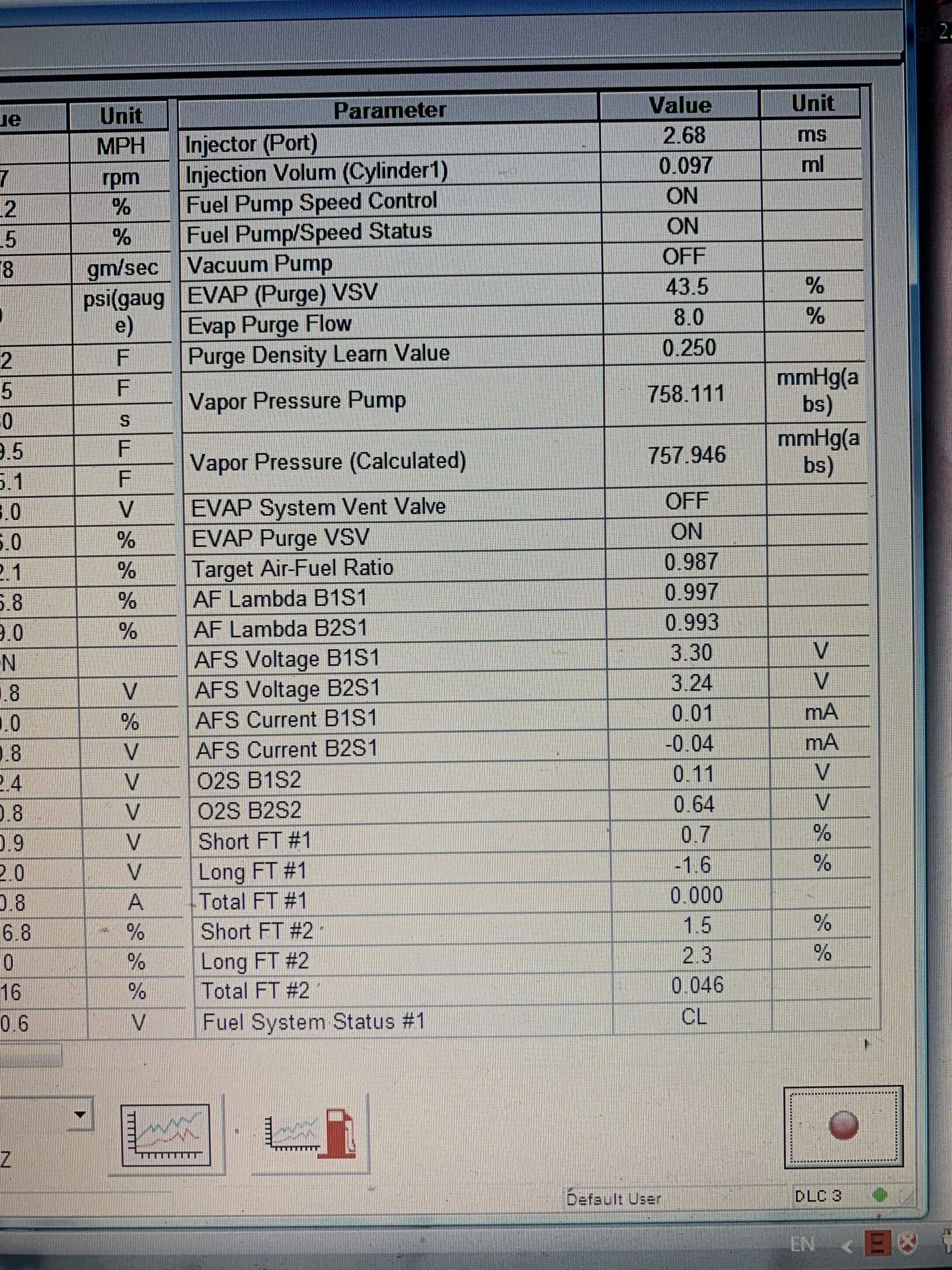

I see bk 2 ST FT and LT FT are both positive. They are not out of line in fact look good. But I'd like to see bk 2 more like bk 1.
BK2 has higher .62V in O2. Question is why. This could be minor vacuum leak on bk2 and or exhaust leak. Could be wonky O2. Or a number of issue adding up.
What are CAT temps read from in TECK stream?
After warm up Run at idle, read CAT temps?
at 2K RPM record CAT temps at start of 2KRPM? and after two minutes held at 2K RPM?
Also use a IR temp gun and read temps on CATS. Google how to!
