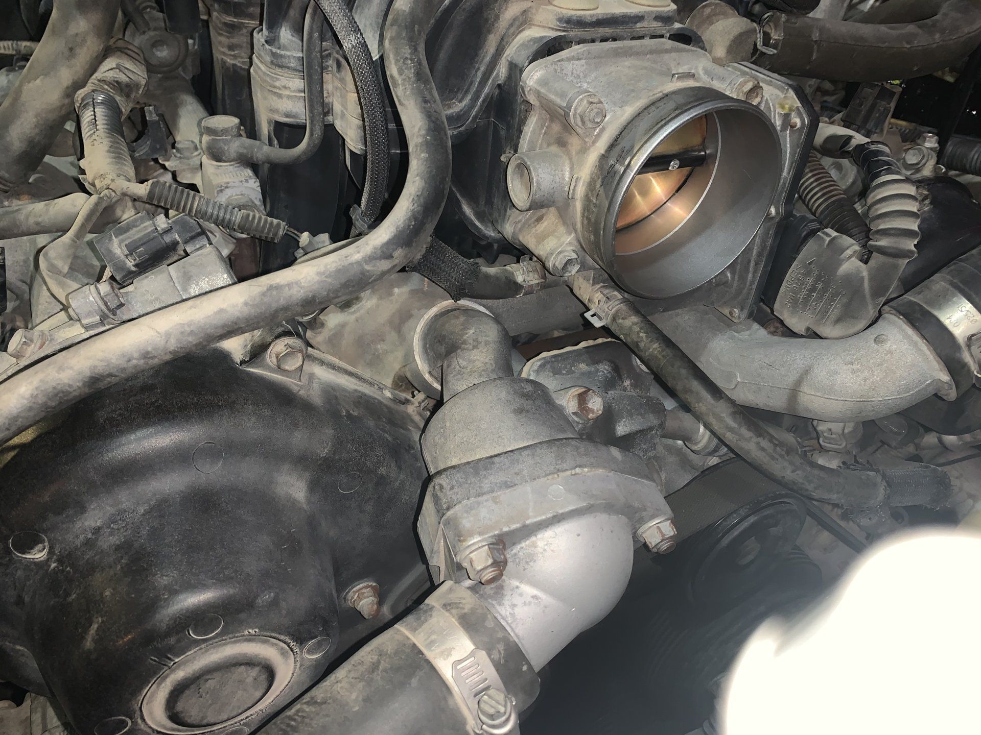

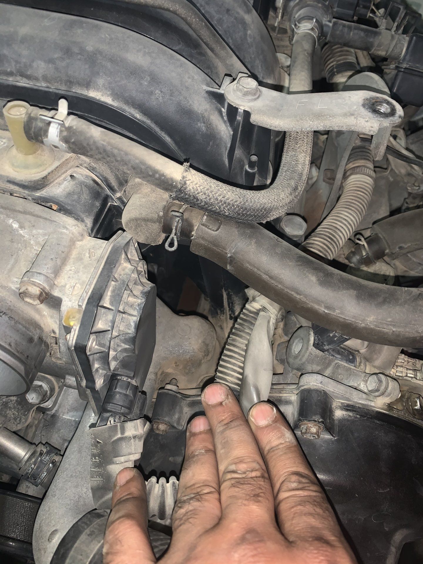

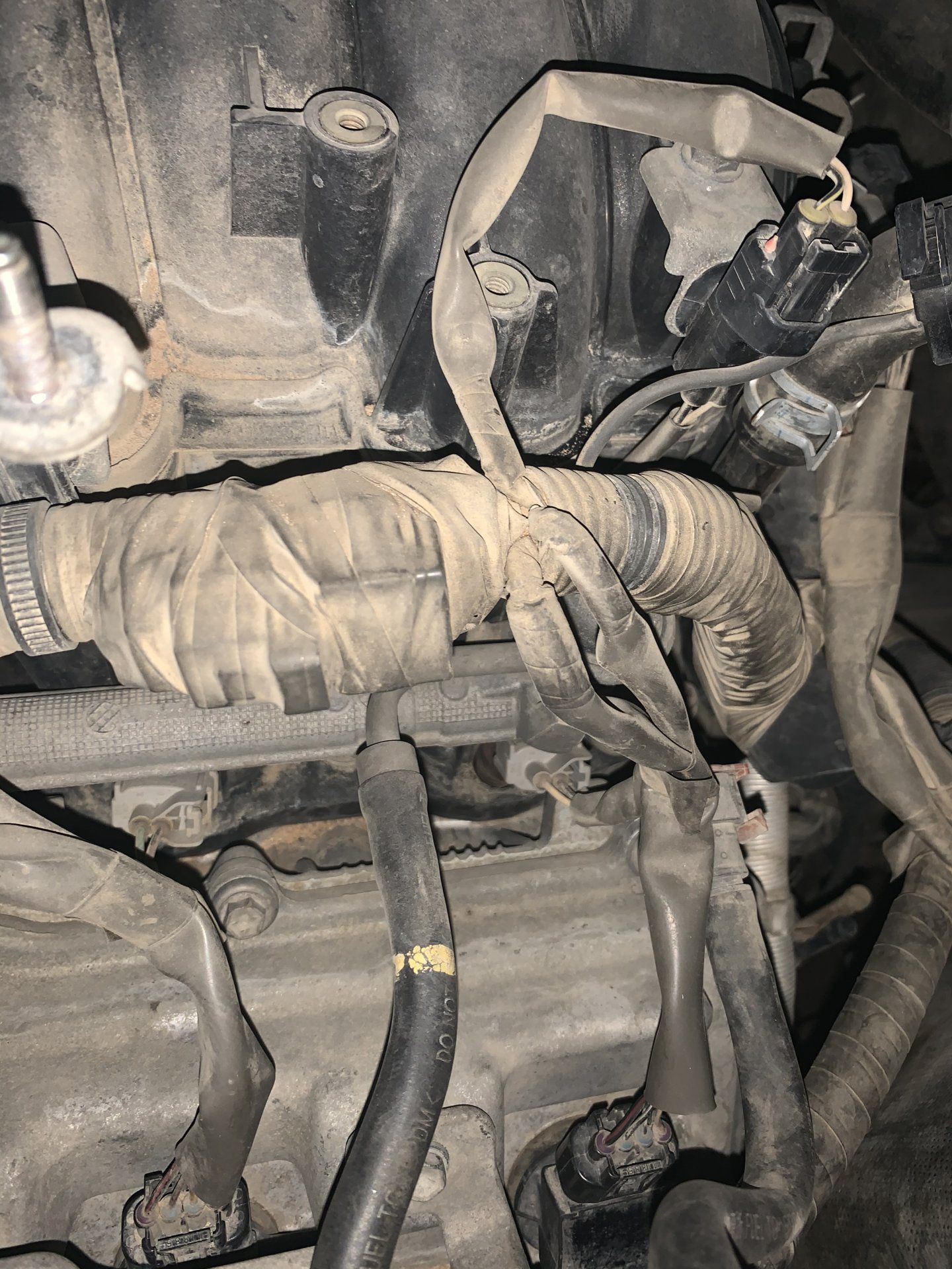

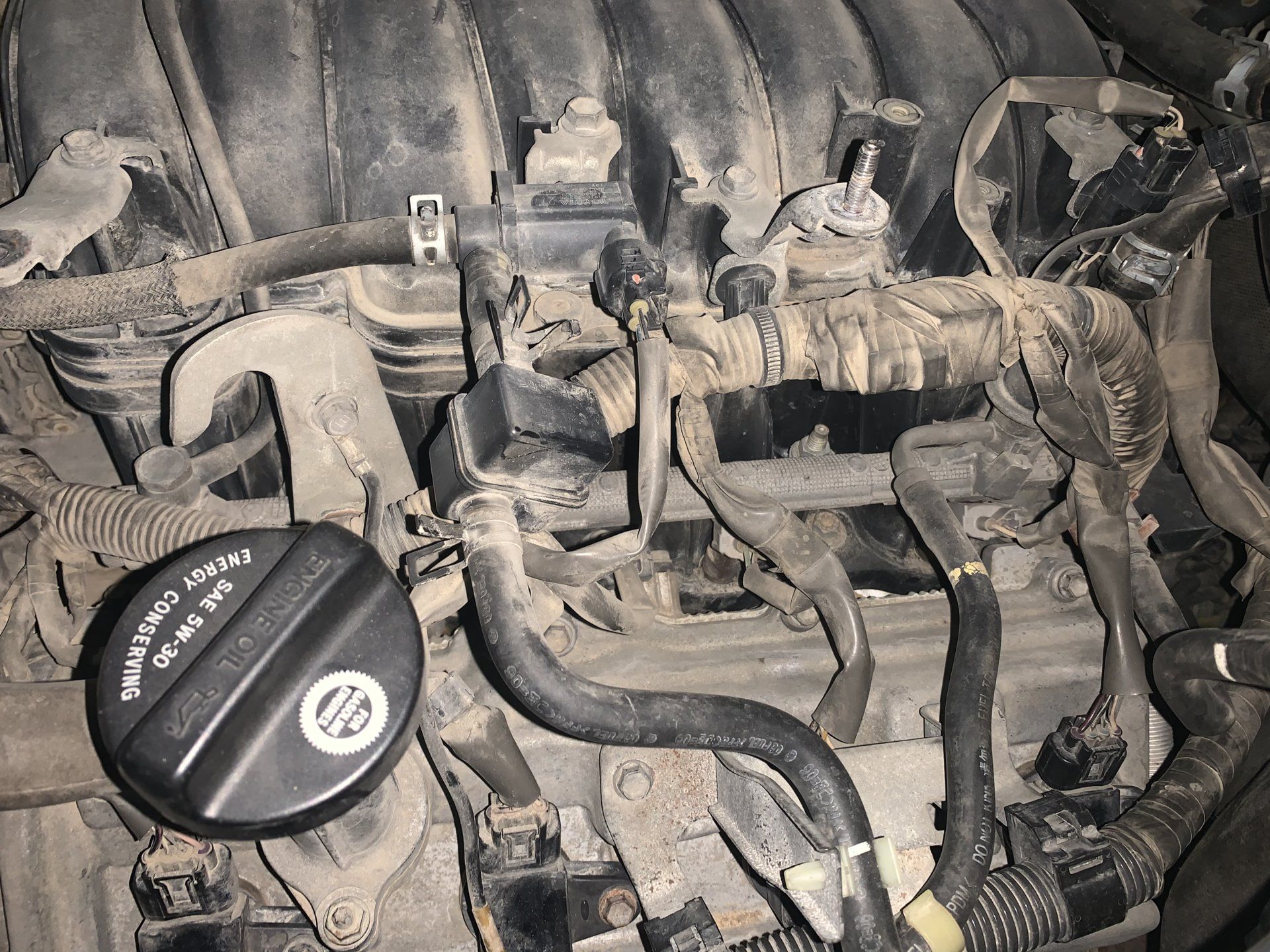

Where is the pictures of intake to head area you said you'd get and post?
