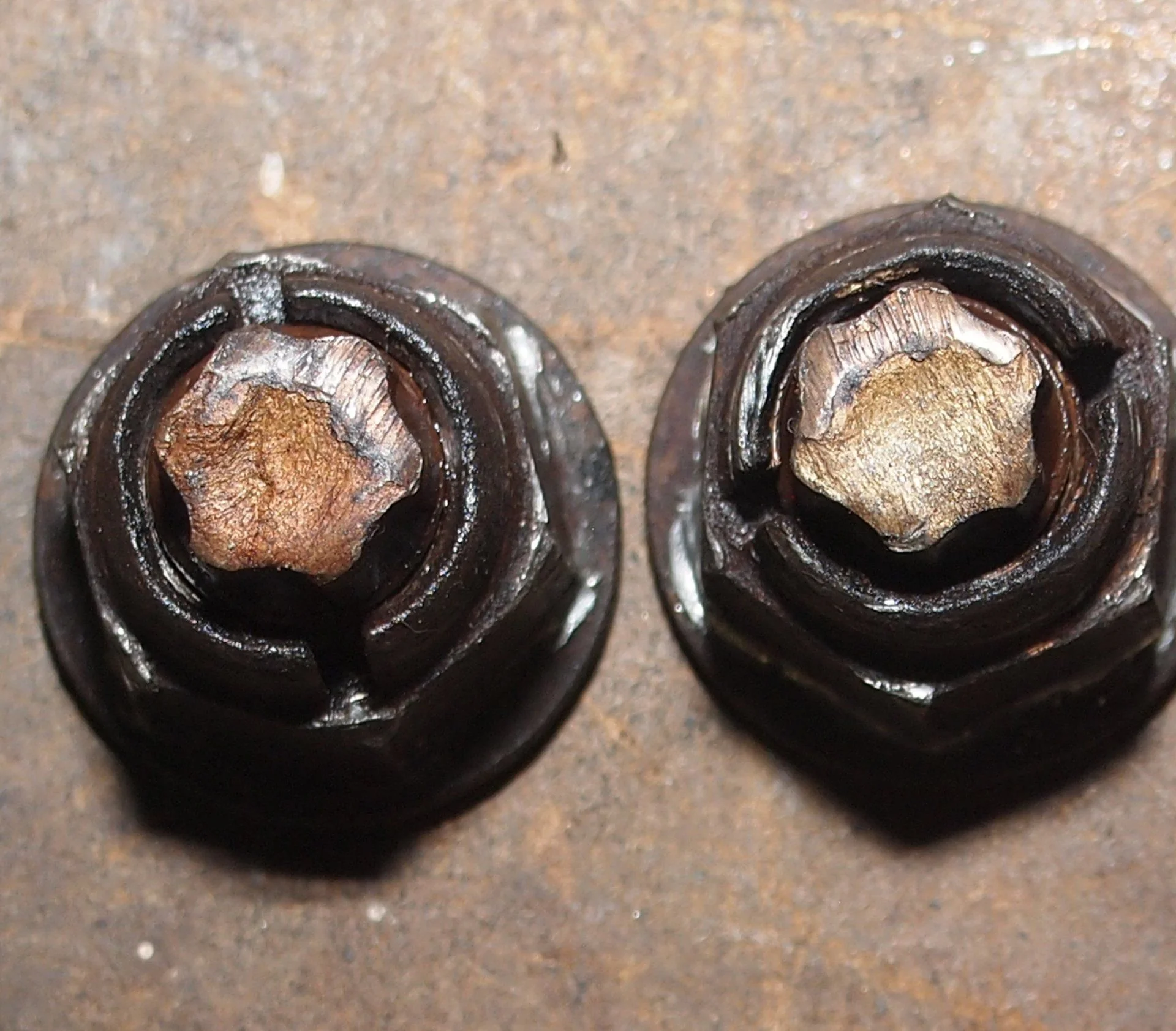

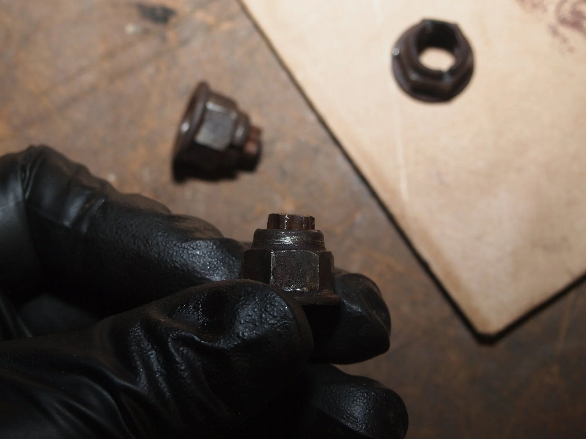

I'm pulling an aftermarket CAT some INDY shop installed a few thousands miles ago. Threads look good and clean. IDK, but nut looks OEM, but the shop buys a lot for NAPA, not Toyota unless no choice.
I pulled nuts from other side which area factory install no issues. I've pulled these nuts off a few exhaust over the years, never had any issues. Even ones old factory install. I did lube these threads with penetrating oil. They did not look like I needed lube. But I did to just condition the dry threads.
I put my Snap-on impact wrench to work on it, with beefy 12" extension and 6 pt socket. I start with 60 PSI. I notice socket barely turning and impact labored. So I cranked up PSI to >90PSI. No better. Move to next nut same thing. Grab my 3/4" breaker bar and turned some more. But all 3, are so hard to turn I fear I'll remove stud or worst break the stud. I'm very surprised stud did not already come out, of the one I have nut near off.
Anyone seen this. It will be very hard to split the nuts or drill out a busted stud. So for now I stopped.

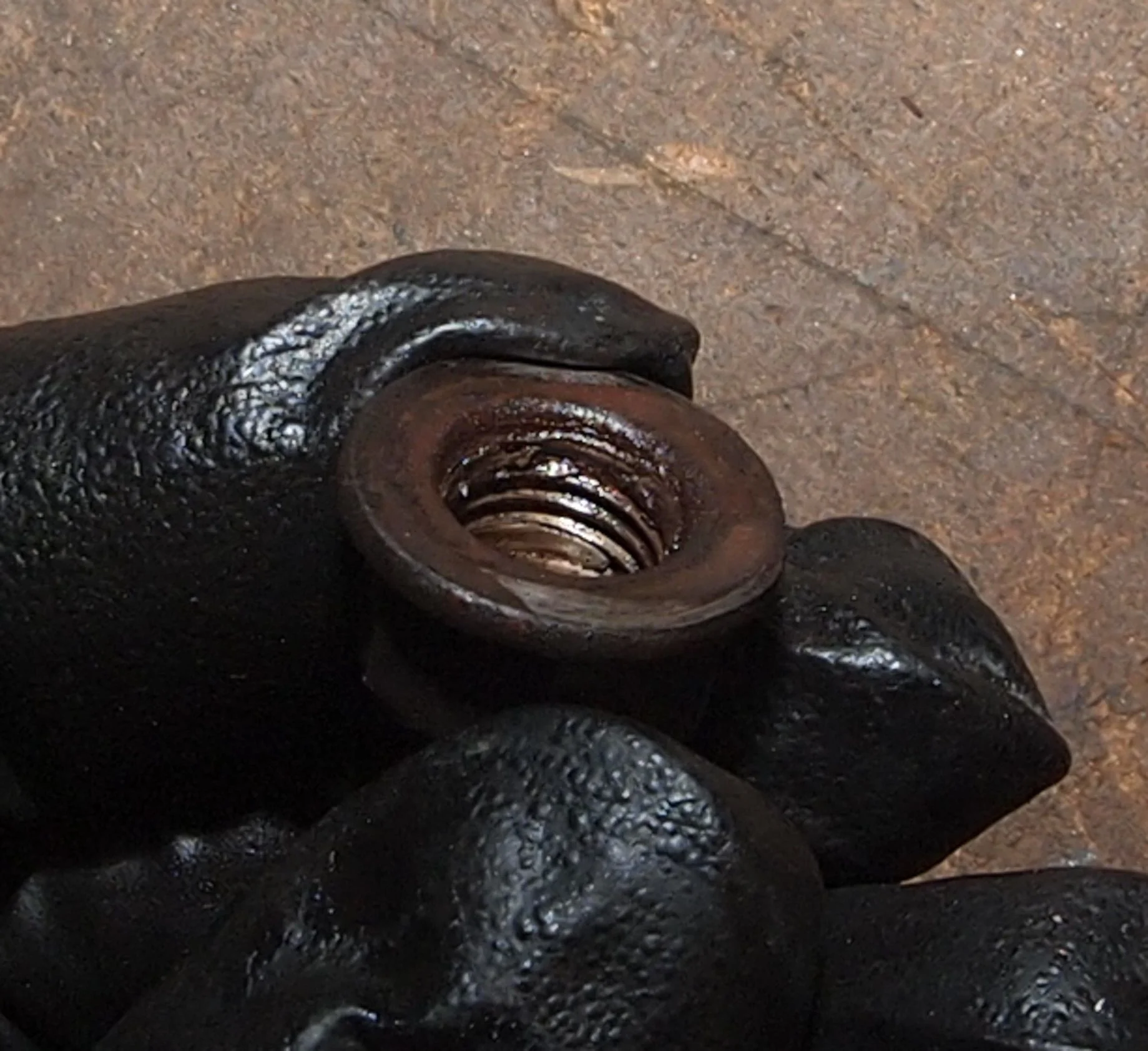

Other CAT with new OEM nuts for comparison.

I used a 150, working 120PSI compressor w/ a 3/4"x 50' heavy yellow air hose with 1/2"x 25' cobra on the working end. I started with low PSI as did not feel I need more, with these, what I presumed new nuts. The went to 90 PSI didn't do any better, I was like WTF!
I've turned the nuts, that I can do. Hard to see in the poor quality picture, but one is almost off. One is turned one full turn. One is still torqued in. Keep in mind these are new and have only be on a short while.
I can crank up the pressure to 120PSI. But feel of nuts is wrong, when I tried by hand to test..

Extension I used is a beefy impact one. I used the thick (beefy) extension so I'd not get any flex. It's same I used on nuts of other side. I took other side of with it no problem.
Once a felt I had and issue with these nuts using the impact. I grabbed "big boy" as I call it, my 3/4" breaker bar, it will bust any bolt on a cruiser. "Big Boy" is my best friend. I used it, just to get a better feel on what is going on. I gave enough toque to turn it, but it was very hard to turn and getting harder to turn even though nearly off. I then stopped.
It just strange 3 new nut on good threads.
I talk with shop that put these on. They say they are OEM. The non OEM they have are oval lock type, splits are OEM.
If they cross threads all three on I'll be pissed.
Soaking now.
Heat is next.
Then I'll give another shot.
Only other idea I have is split the nuts. One of the tricks I just learn in mud... Thanks guys.

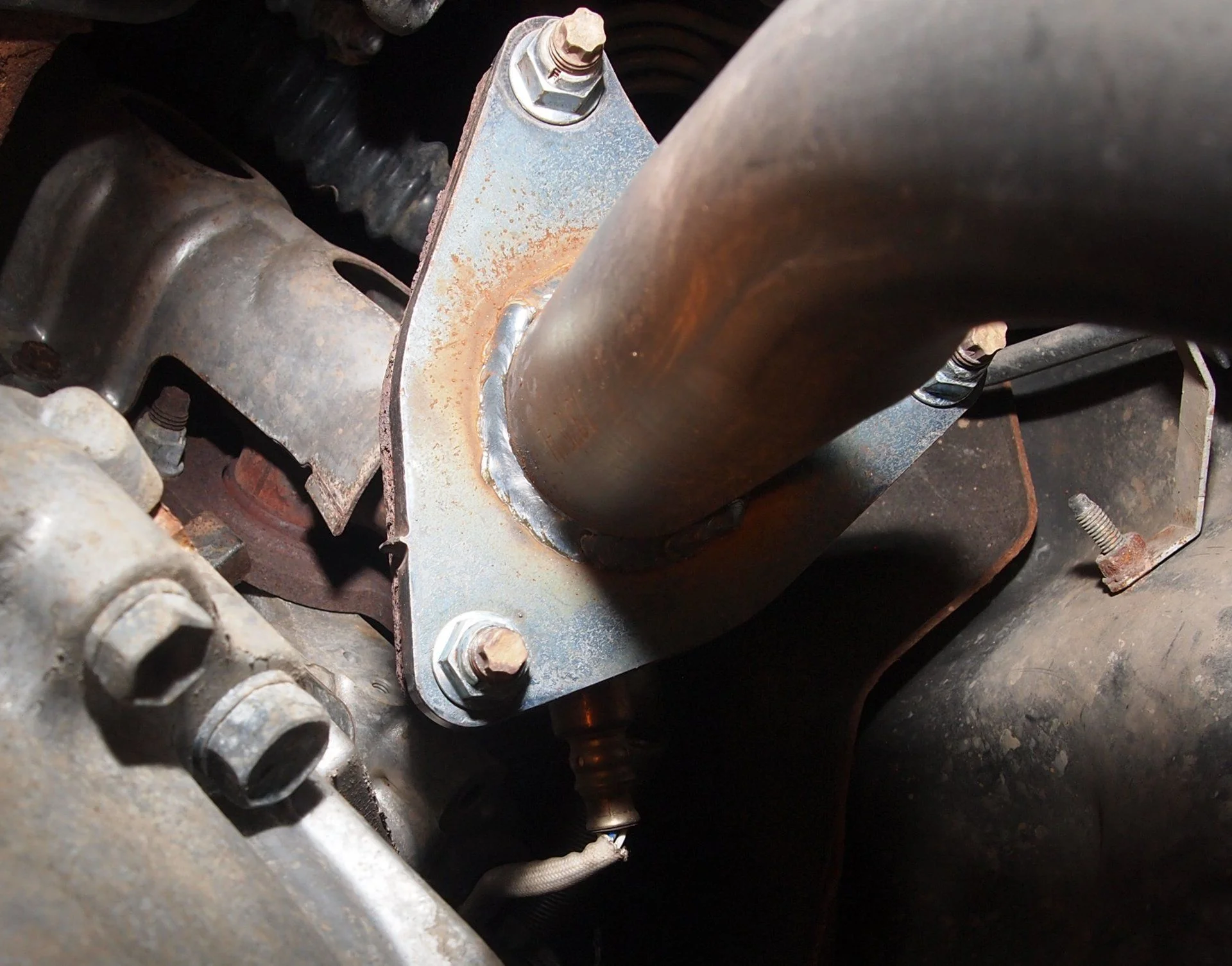

In looking over now that I have CAT out. It's very apparent this tech used a lot of brute force.

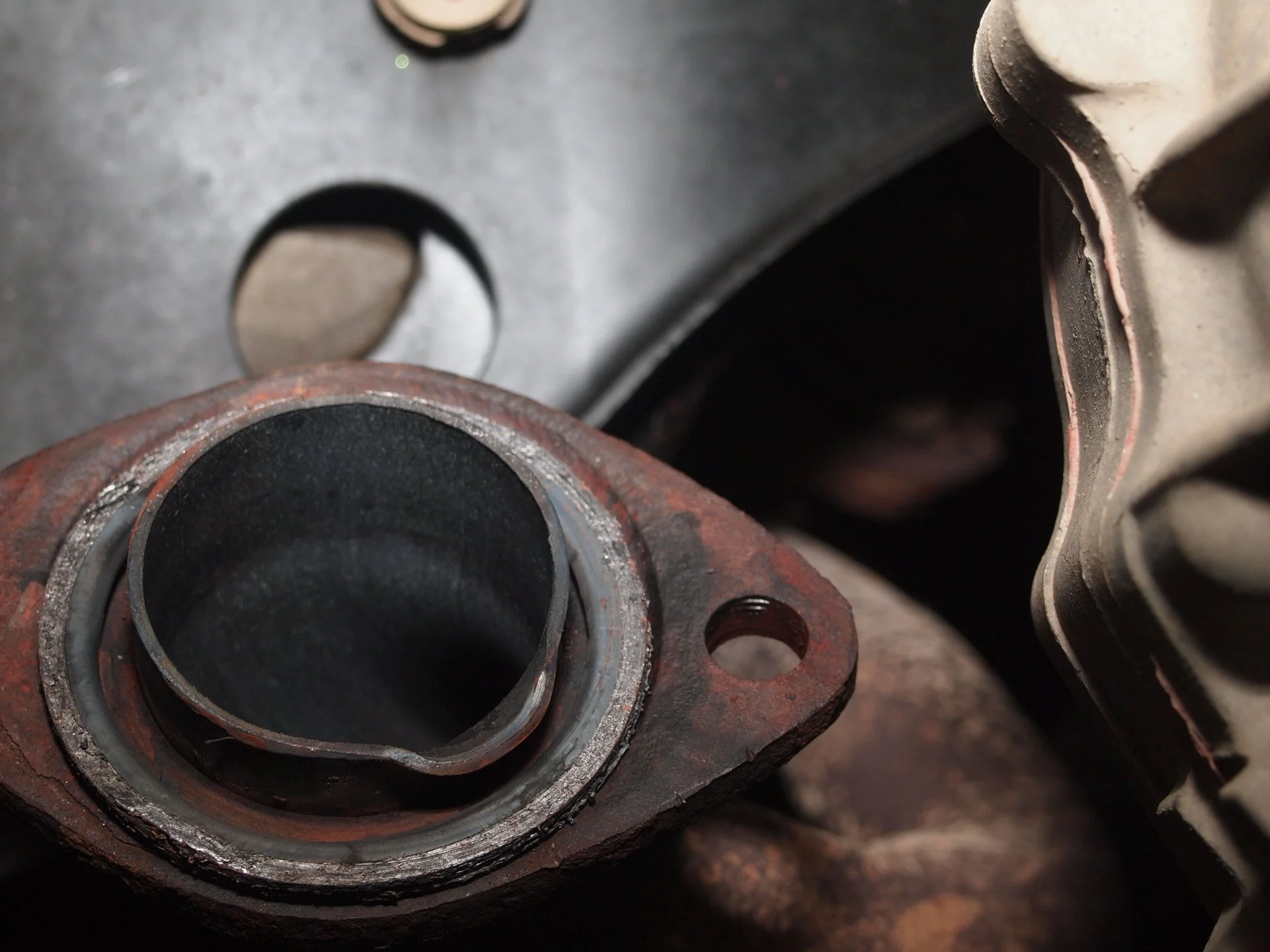

The rear flange of CAT sits at and angle, so that we only need lift up CATs from rear flange once all bolts out and nuts off. This easily frees the whole CAT and we slide the CAT back and the snake out forward.... So SO Easy.
It appears this yahoo SOB &%&^$# at Midas, pulled down on the rear CAT Flange and used brute force to man handle it out.
This is exhaust pipe from muffler that CAT attaches to at rear of CAT.
Notice how down stream pipe is bent down. This must have been from CAT hanging up on pipe and force it down to remove.

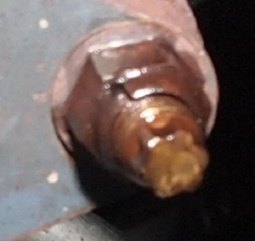

I also found the tips of the studs on exhaust manifold have marks that further indicates force used, that he had the CAT jamb in badly and used a lot of force to force it out. Very likely he did some damage to stud threads at that time. Then during assemble just force the nuts onto the studs. When he should have use a thread restore tool first.
Metal to metal swipe across the tips of studs.

He also use the old nuts and bolts. The FSM has a good reason for (list as non reusable) not reusing these nut and bolts.
They are one time use locking nut and they get very damaged form heat and rust.
He cross threaded 2 of the 3 stud on exhaust manifold.

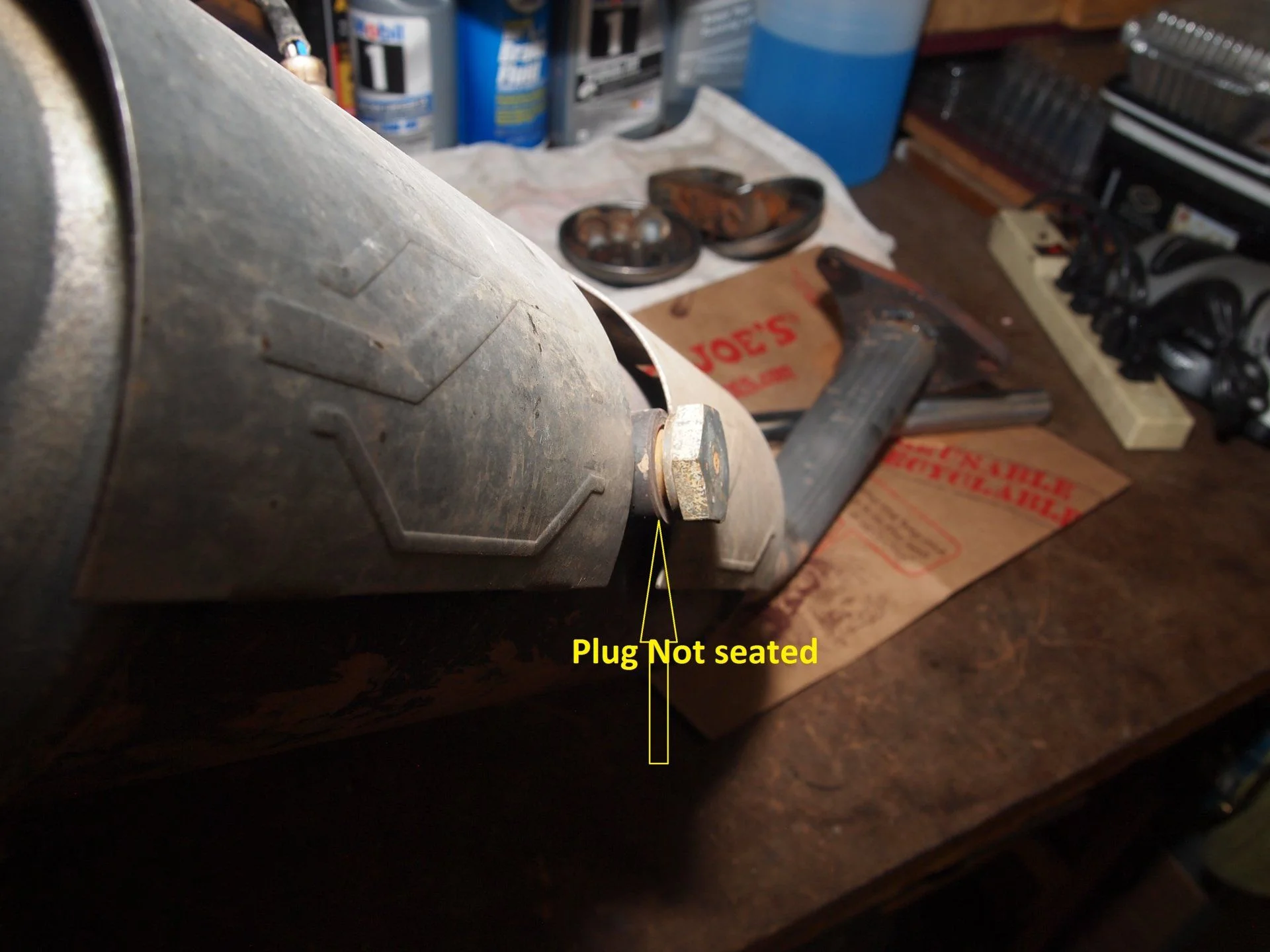

He went the extra mile. This aftermarket CAT has 2 O2 holes. One must be plugged. He barley got the plug in, in fact it may have been leaking air. Plug has a flat seat/seal washer that they should be run down to. They should also have a crush washer gasket place on them. That can mess up a CAT and or mess with readings I suppose.
But was enough. NOOOOOO
This guy just keep going. What was he 2 years old. DANK, he cross threaded the plug too or use wrong thread pitch IDK.

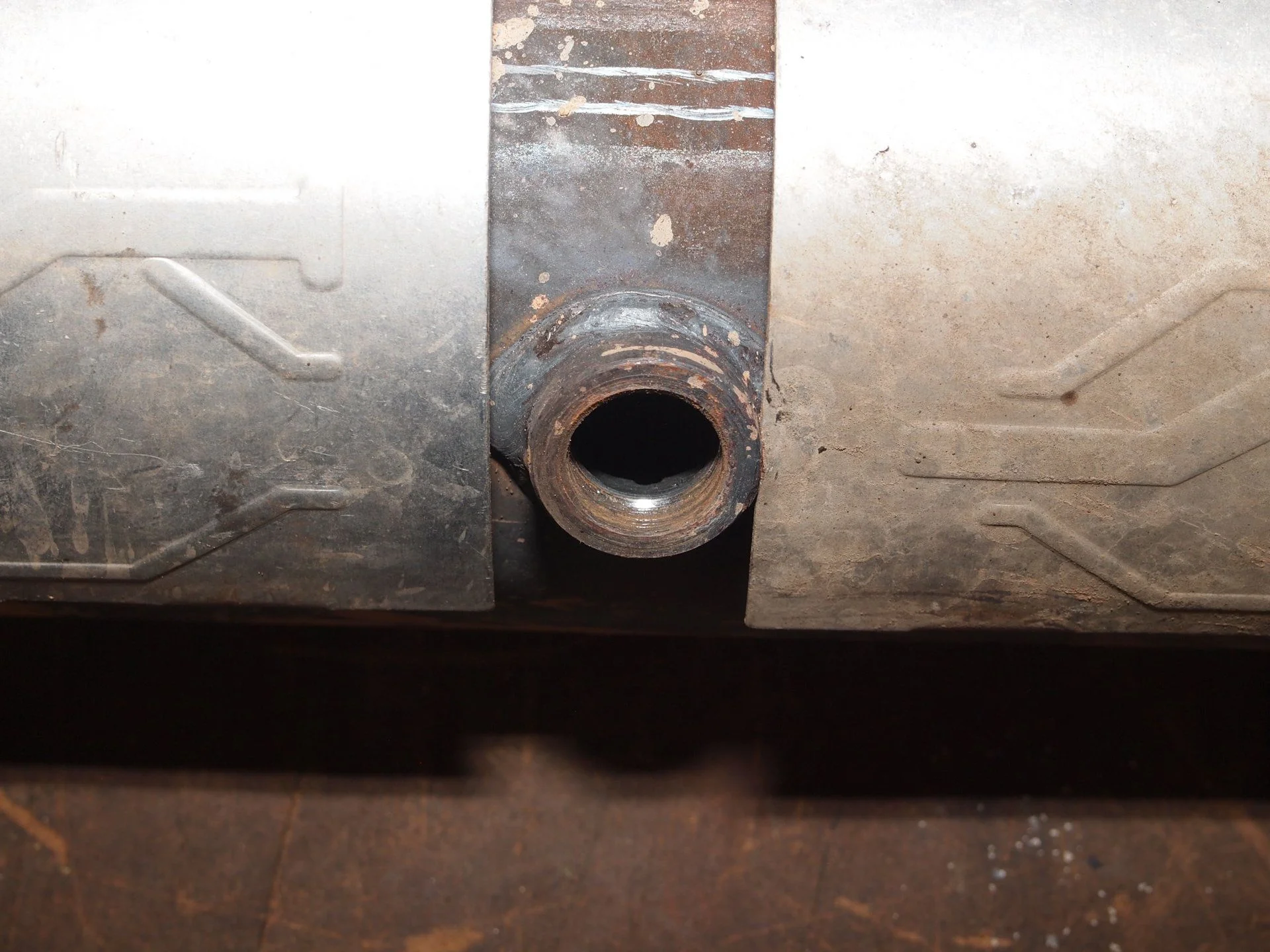

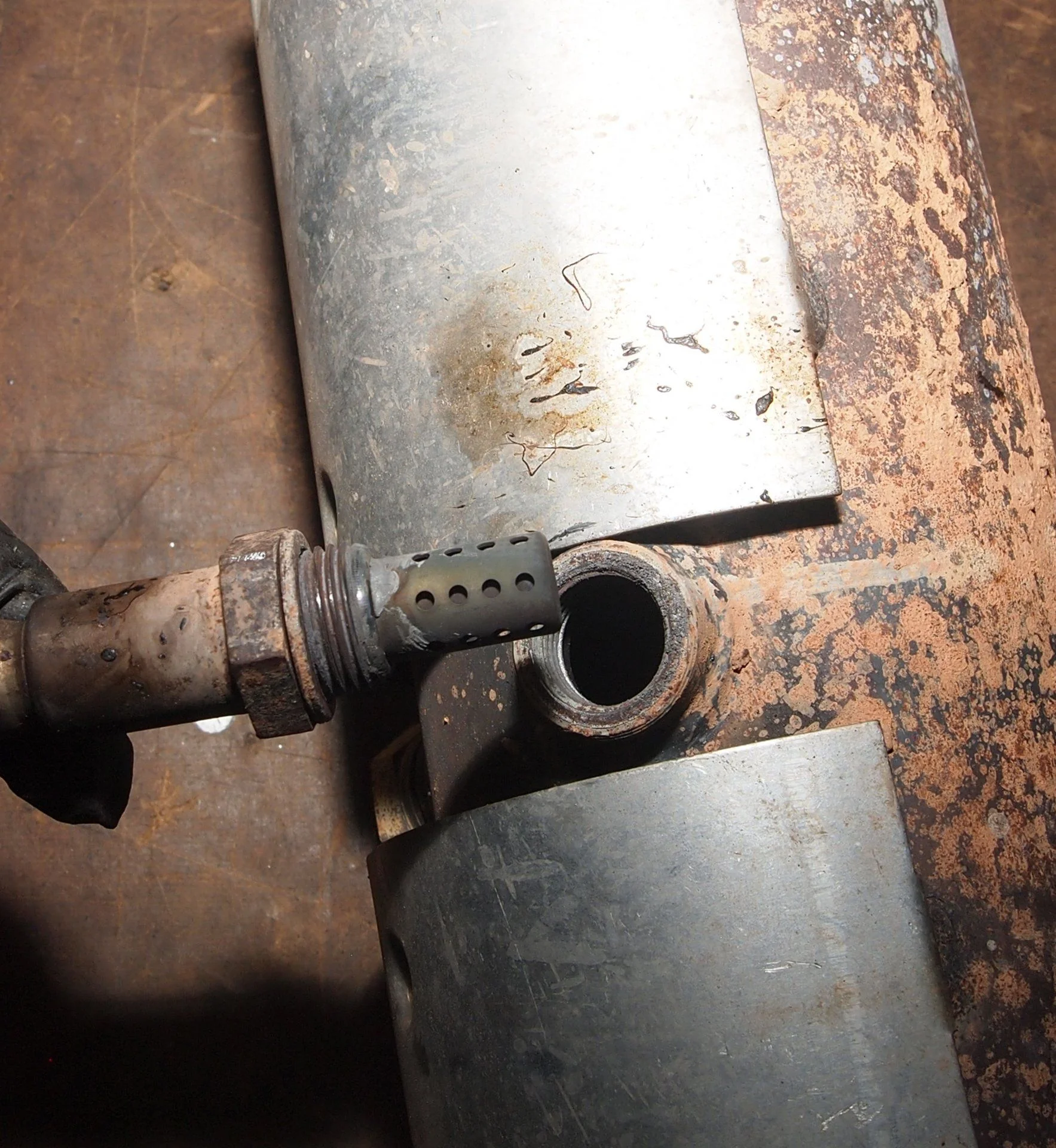

I'm looking at the O2 think what is this gray residue on the prob. I'm thinking my CAT must be clogged with gunk. So I scope it, it is clear I can't find and damage or clogs in CAT and it new. WTF why the P0430 DUH
More around other side. I was wiping with finger, seems like a thread sealant IDK.
So is it bad CAT causing the P0430 or fouling from air leak and contaminate on O2 sensors prob. ?
well both aren't helping the situation any, exhaust leaks can and will cause issues with the a/f and o2 sensors reading correctly depending on where the leak is. who knows whatever that goop is, antisleeze, rtv, the installers tears of joy knowing that he did the worst job possible, so I would consider changing the sensor as well. you may be able to clean it up but depending on the mileage it may be better to just replace it
I had manifold out so it was much easier. I had nuts welded on broken studs, but NO, it didn't help. I broke them even further trying to unscrew.
Ended up cutting them flush with flange and drilling out. PITA.
Oh yeah, I remember now seeing that picture of nuts wield on studs.
Sines the heat you created wield didn't break free. My impact and 3/4" breaker did break my stud free. I'm thinking I'll need to drilling out or new exhaust manifold. Bunch of nut bolts and gasket.
Some say you should not even touch and O2 IDK. But differently not slim like this.
You're likely right!
They did brake free and I learned to undo it by going forward/backward many times. I did this to one stud. But others I tried to just undo with force and they broke. So, you might be able to carefully work them out. If that makes sense? It makes sense to me now, but I broke 2. I can only say that it doesn't take much force to brake those using regular 3/8 ratchet.
I'll give it a try. But heat was your biggest aid, that I'm sure of. I've only a NAPP gas bottle. I doubt I can get red hot.
Okay, Note to self add torch to the list. $$$$$
