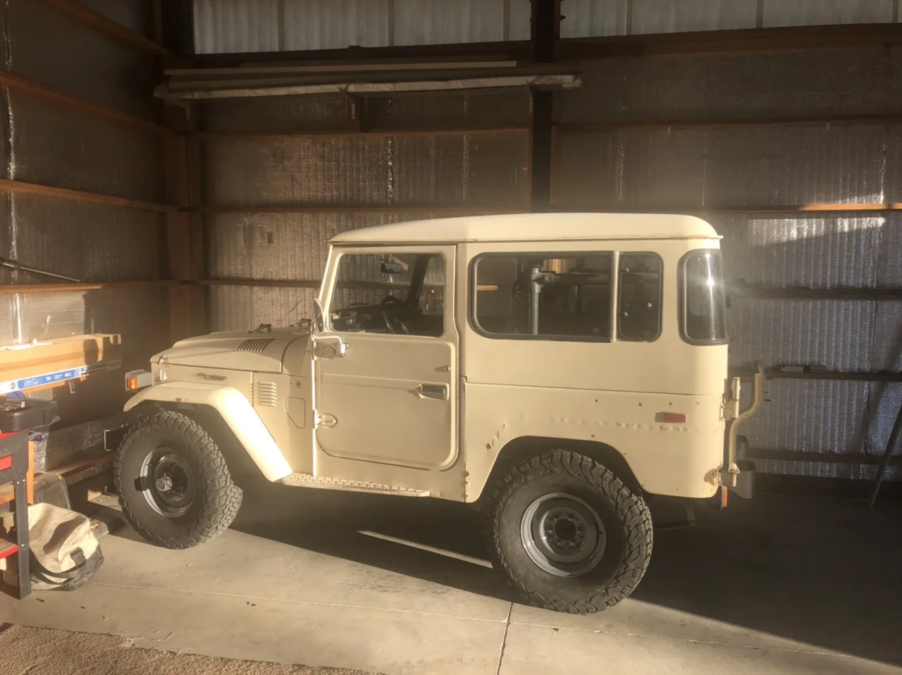

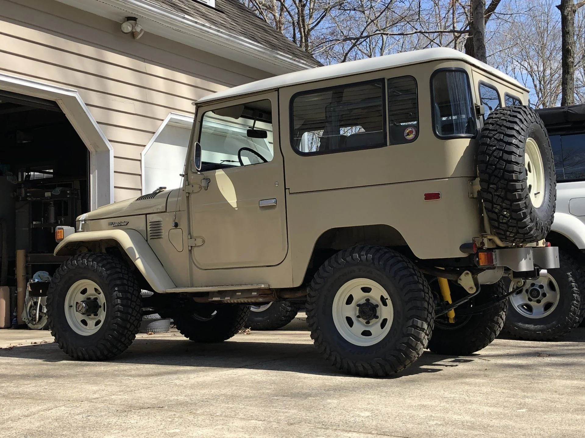

You can stuff 33x10.5’s on the early narrow factory wheels (I think theyre 5.5” wide) with factory suspension. Ive driven my good friends 40 with this setup and there was no rubbing. On road driving only, im sure this setup would not be goos for any off road driving.
Is it drivable with the 33s or does it rub terribly. Wanting to do the same to mine but need to save up some money before I can lift it and don’t want to buy 2 sets of tires. Looks great. I have an 82 also.

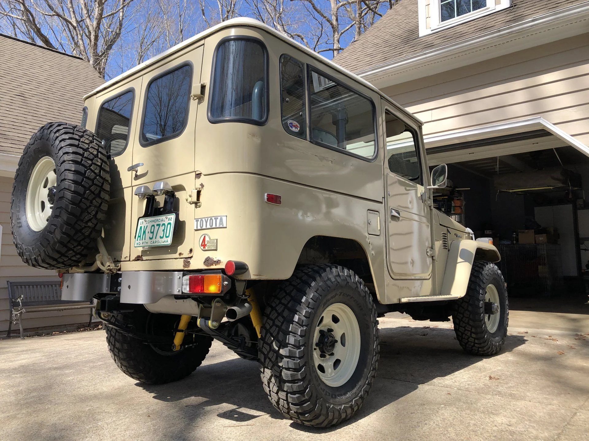

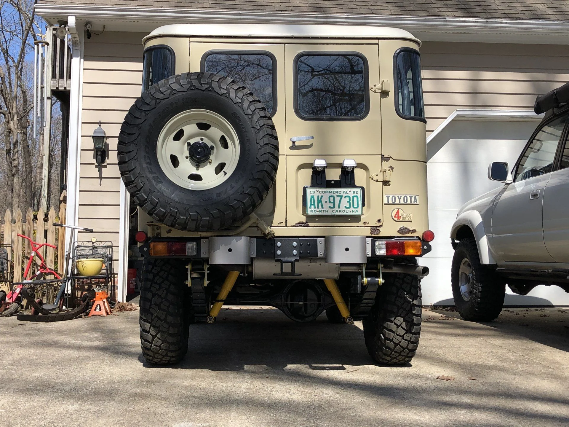

For what it's worth, those rear shackles are not factory pieces. They are extended shackles.
Thanks. I ordered some new 31x10.5 to run for a while and if and when I lift it I’ll get 33s and put the 31s on my 95 pickup.
The rust spots on your rear sill, did you treat those with a rust converter or just hit them with Fluid Film?
I coated the spots with several coats of penetrol over weeks of time and soaked the sill inside and out with fluid film.

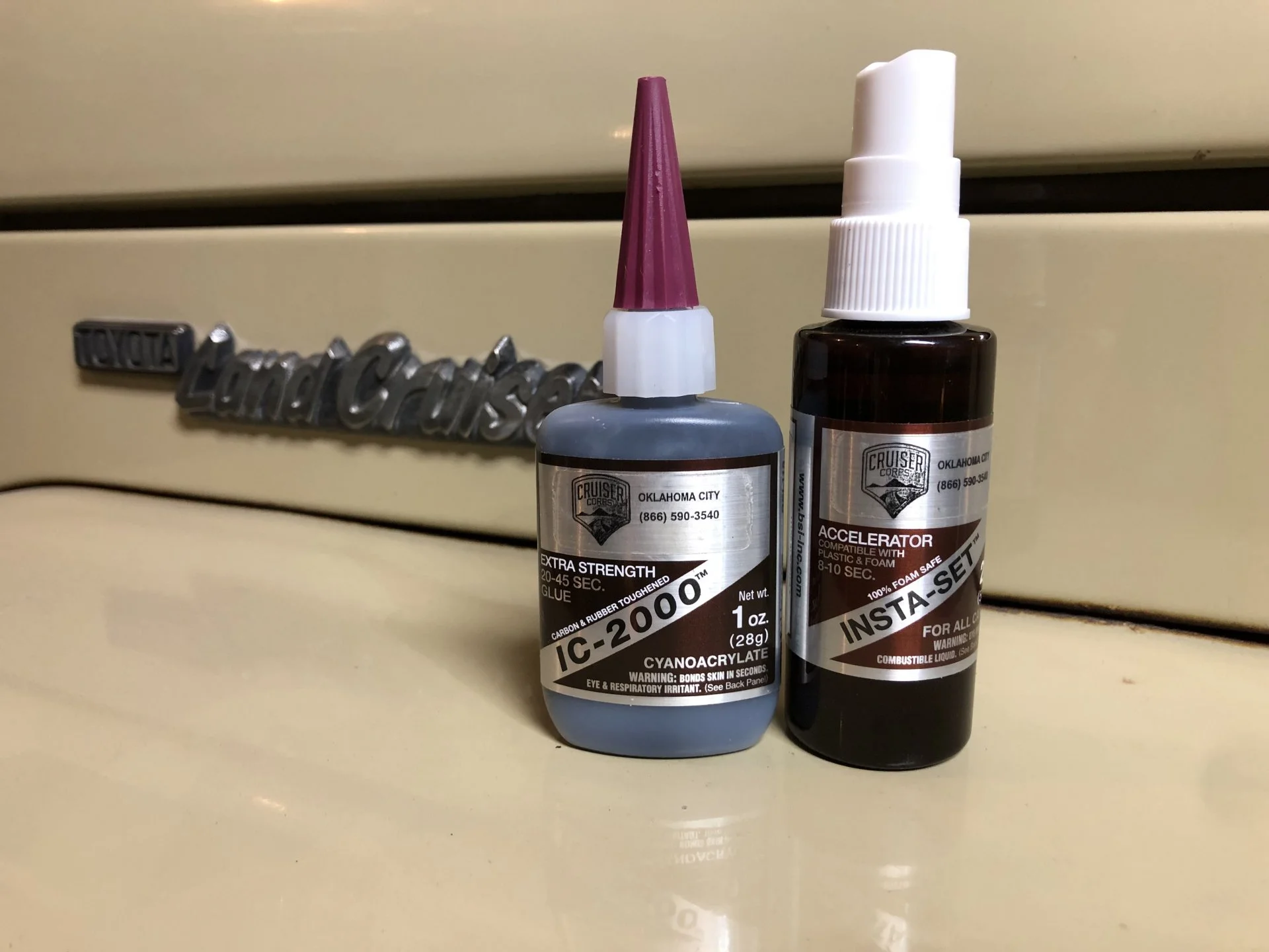

I was blown away by the ease at which the door seal (gasket) was installed using this product:
The door gasket went in in 15 minutes. All dry and ready to use. No clamps or binder clips needed. Here's how it works...It's essentially rubberized super glue. It's commonly used for gluing RC tires onto rims. I didn't even wipe the seal with alcohol prior to install. Just work a 6 inch section at a time. Spread the glue on the back side of the gasket, spray the catalyst on the door itself, press the gasket onto the door. Holds fast in 2 seconds. Just repeat this a section at a time until the door gasket is fully installed. Cruiser Corps sells the stuff. It can be bought on Amazon or direct from the manufacturer as well (Bob Smith Industries). Never again will I attempt to use the slow drying, messy 3M stuff. This IC-2000 is the best thing since sliced bread!
This stuff is amazing!

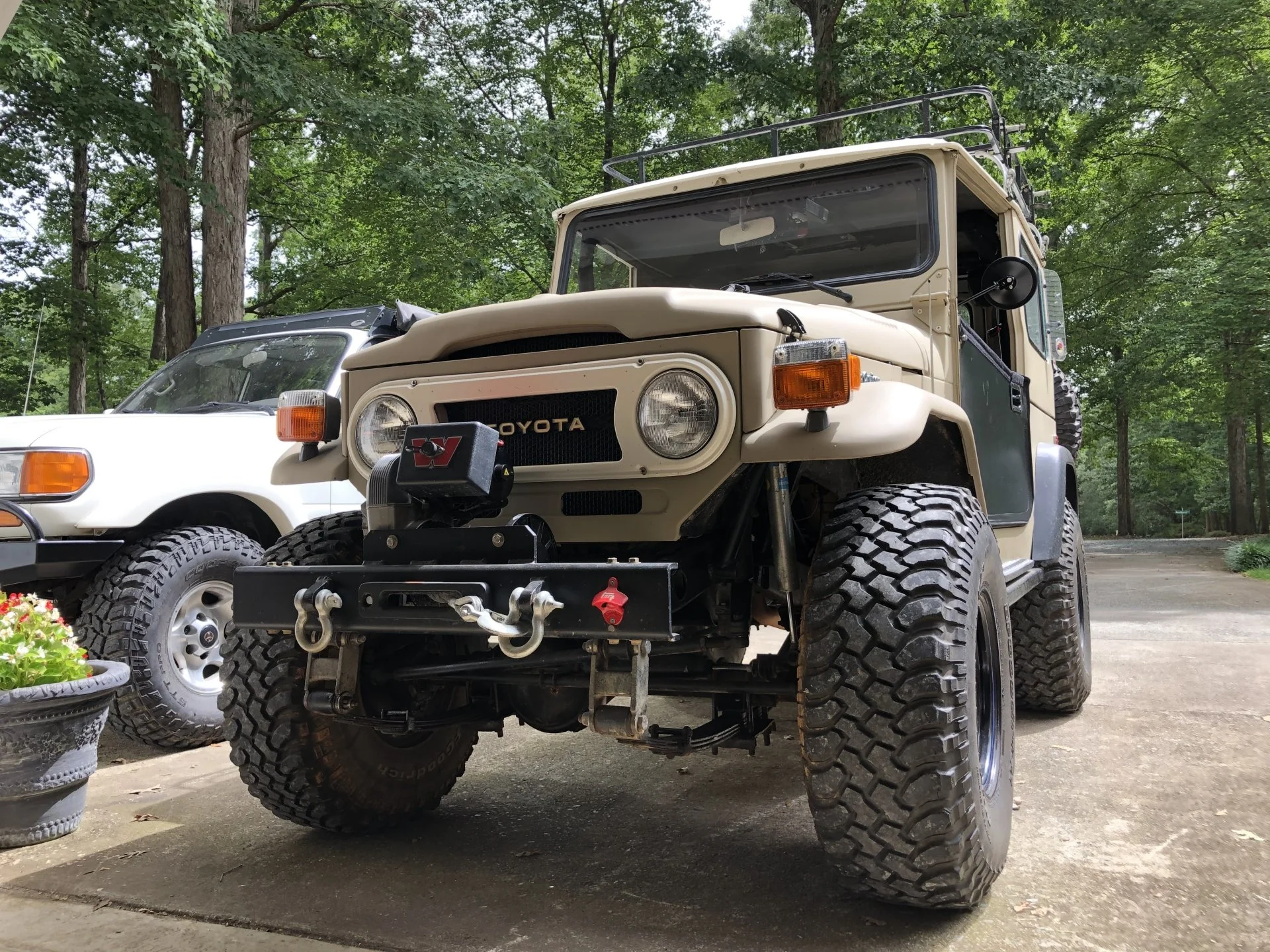

did you make or buy thoses fender flares?
Oh! You are asking about THAT truck. That one is called “The Crockpot.” Fender flares are from a heep TJ. 4” lift with leaves removed and 35x12.50 tires.
