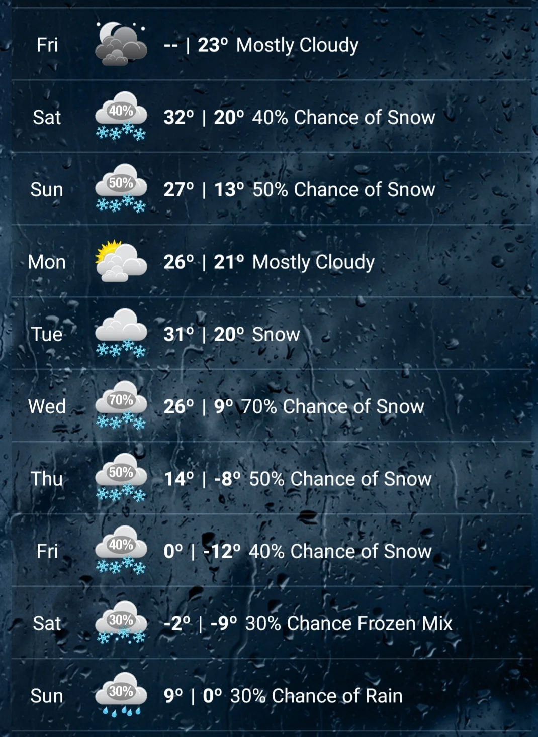

Yeah, I'm hoping the arctic weather moves in, we were supposed to get 8+" in the mountains from this last wave but high pressure to the south kept it further north. Tuesday to Wednesday is looking favorable for a significant snow event.
Time will tell.
I'll still be skiing this weekend.
If it does get cold.
The 10 day, I'm glad I moved 2 cords of firewood onto my back porch last weekend.

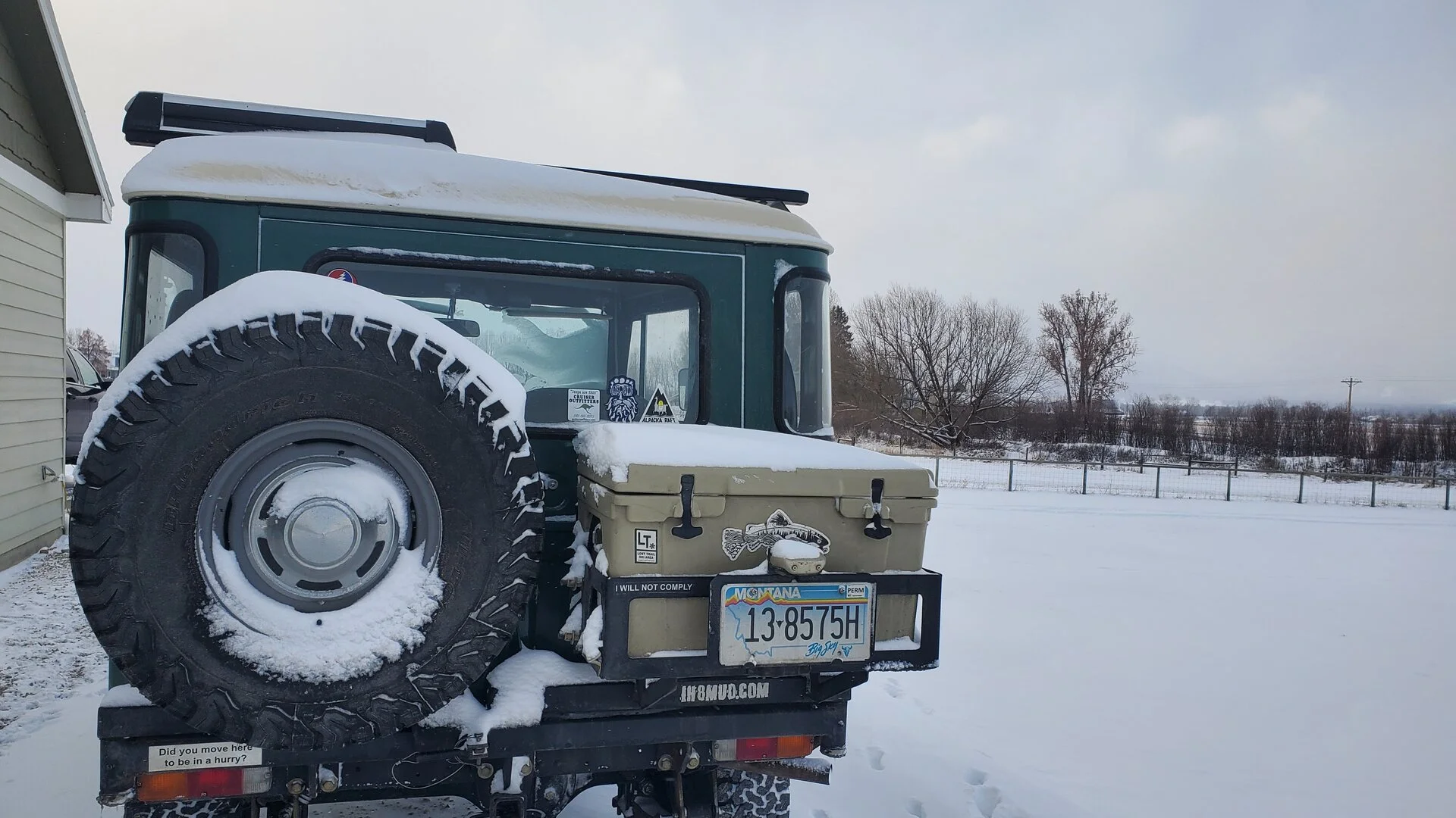

Using your Yeti to keep stuff warm?
Seriously, we did that to keep stuff from freezing yet still refrigerated.
Basically, I leave it bolted down year round, but in the winter I put all my food and beer in it when I'm skiing. Quick, convenient, and keeps everything from freezing.
And my buddies know where to find a cold one when they spot my rig.

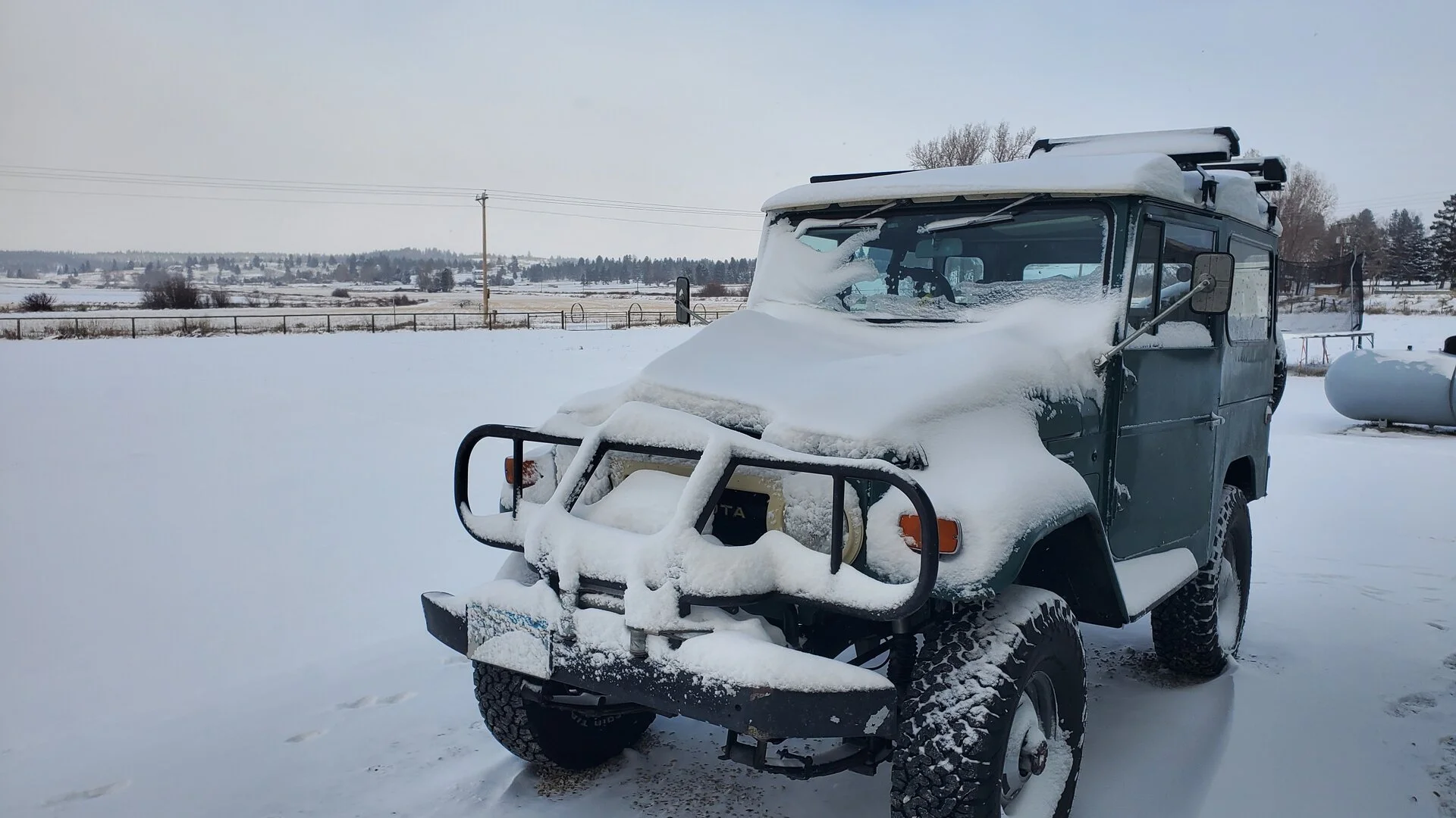

-33F this morning.
The 40 is dead.
Cardboard over the grill, heater on the oil pan and battery, and it will fire right up. Of course, if you don't have all the engine compartment tin, you risk freezing fuel lines....
Battery might have been on its way out already, this may have sealed the deal.
Shifting the transmission and pushing in the clutch was like working with a bucket of cold honey.
The Ole diesel dually fired right up though, I'll have to drive it up to the ski mountain tomorrow.

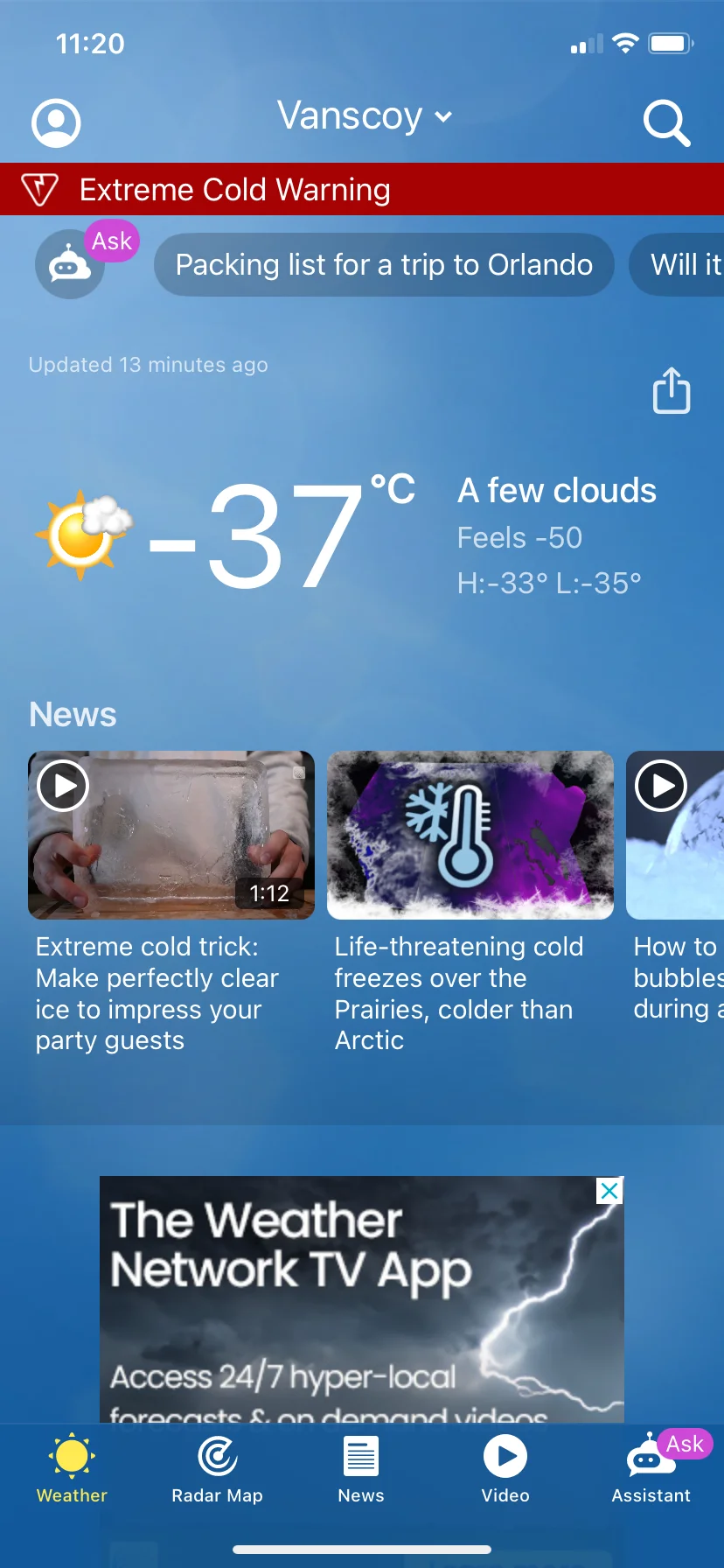

Currently -24

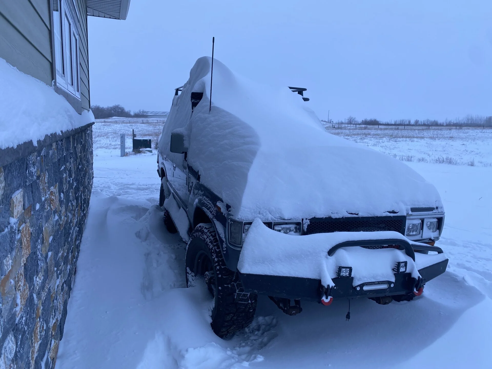

a storm rolled through here this week burying my patiently waiting 62(needs and engine rebuild). so i’m driving my little barn fire 40 as my daily. block heater and cardboard worked for me (also a new battery helps a ton). my heater keeps my window clear but my feet are sure cold. 🥶 i need some floor insulation!!
good luck getting yours going again
i feel your pain about cold honey. it feels like i’m turning 37s with no power assist. man things get stiff when it’s this cold.
