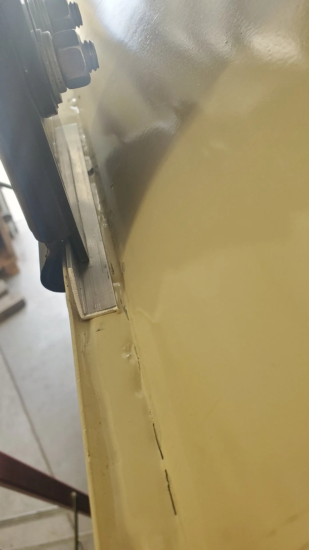

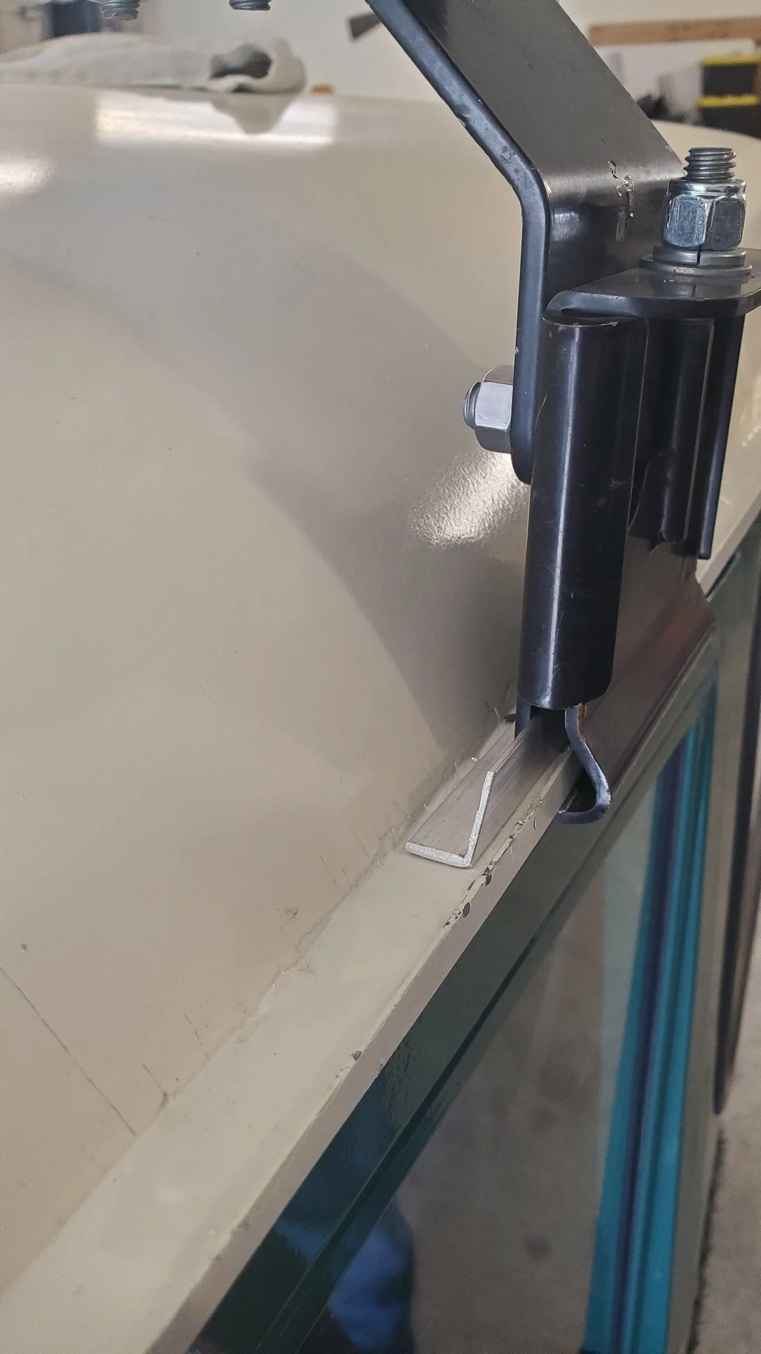

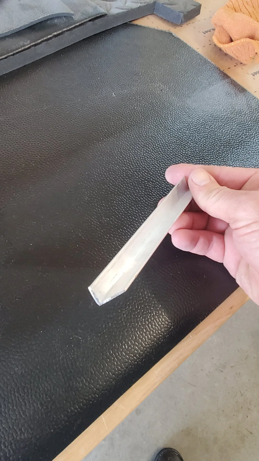

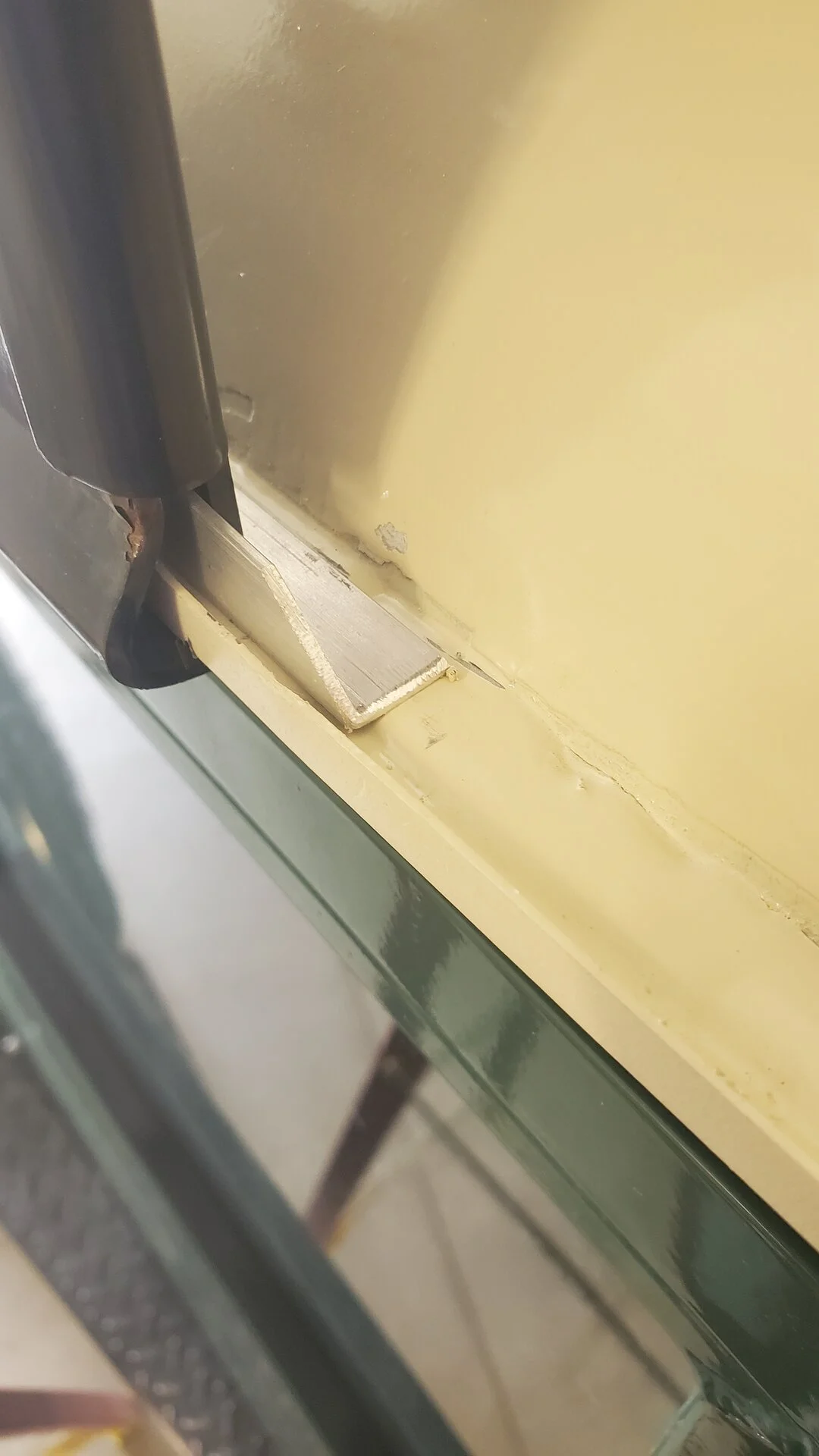

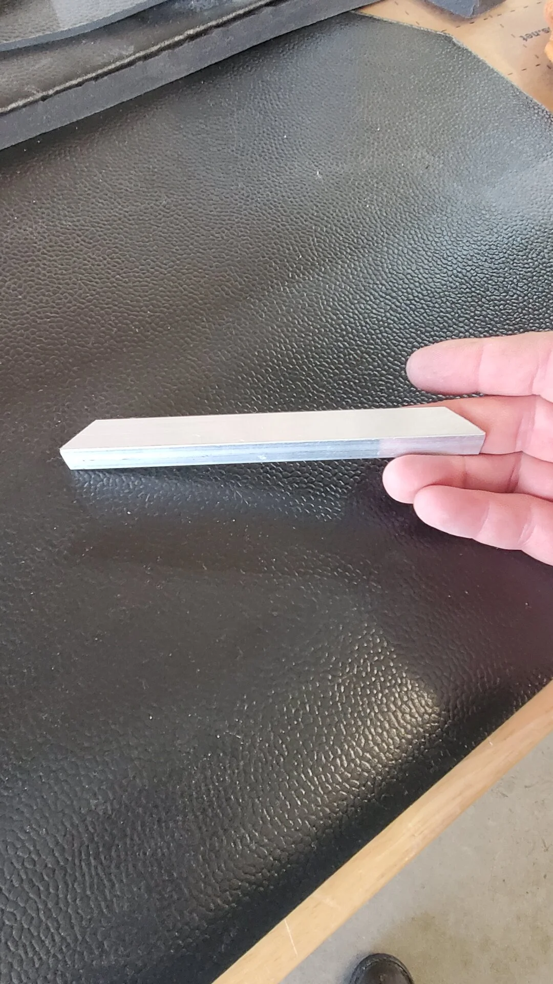

Hopefully it disperses the pressure across more are, more importantly more pressure on the actual fiberglass portion of the lip.
A bearing plate..Makes sense.
Maybe add a layer of foam tape or pvc rubber between the angle and the lip (if that gutter is not truly flat)?

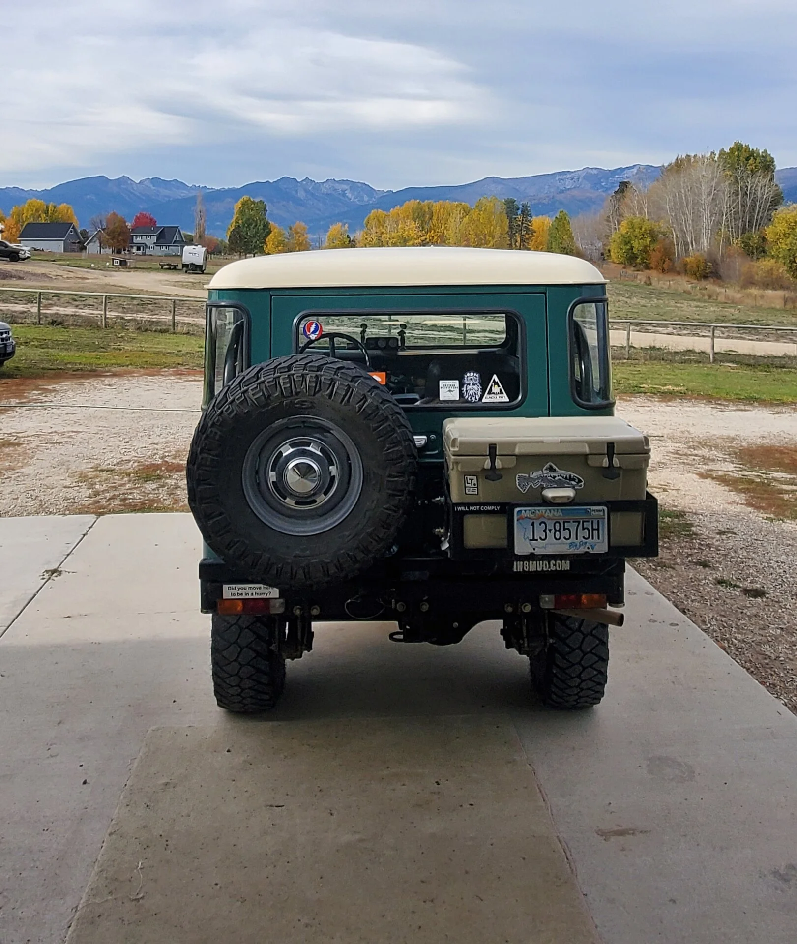

So did you end up w the Ko2’s? That last pic where you said done were the old Mt tires? The Ko3’s are trickling out and look pretty cool but sizes are super slim. I’ve always been a huge Bfg guy all my trucks have had the Ko2’s, Except my 93 80 had bfg 315 Muds and my 69 40 still has some old ass bfg 33x12.50 muds on now!
