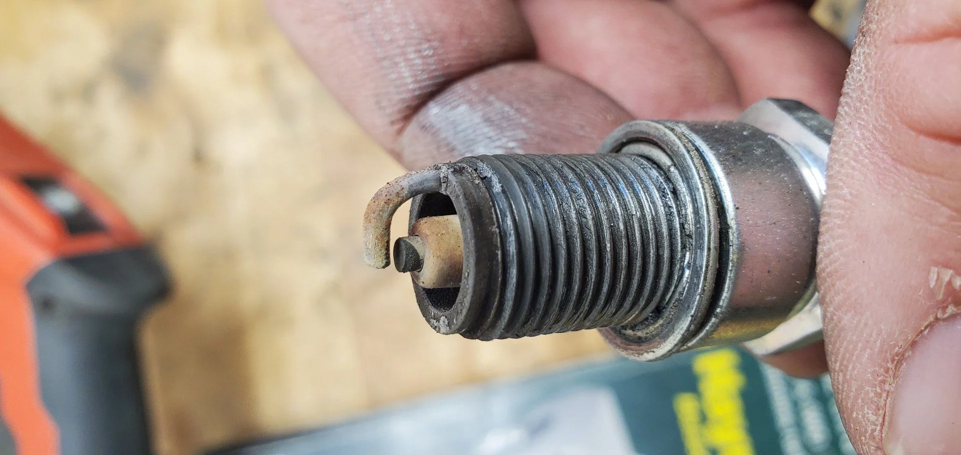

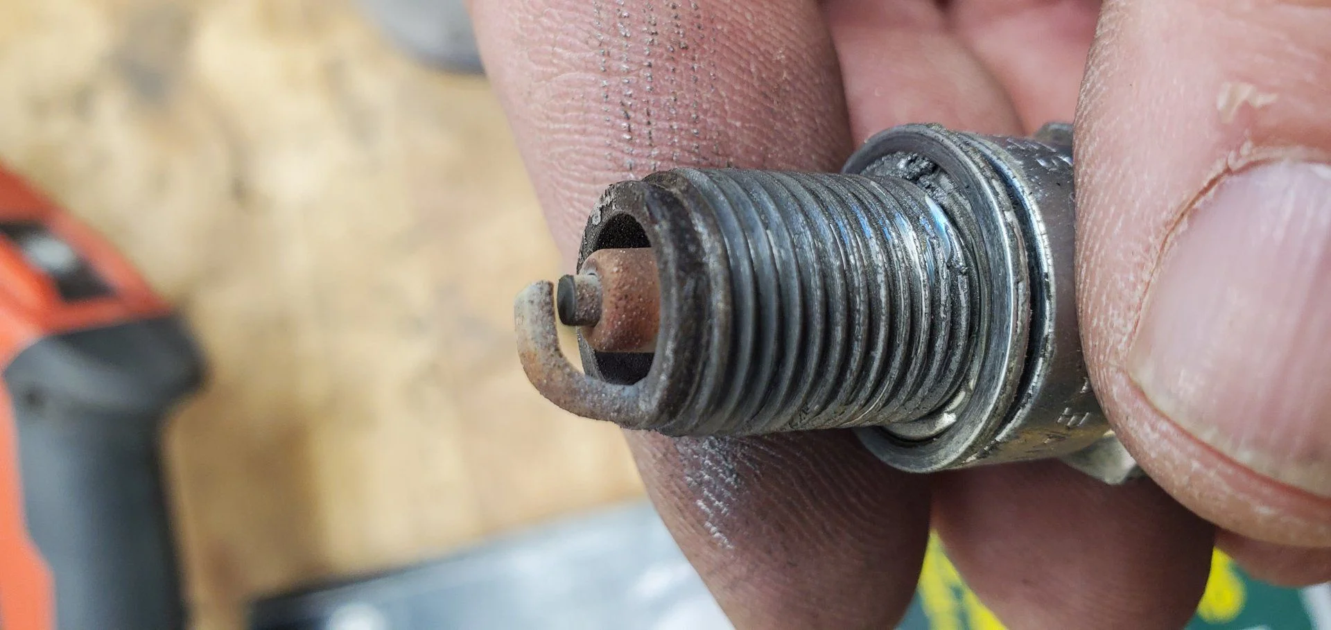

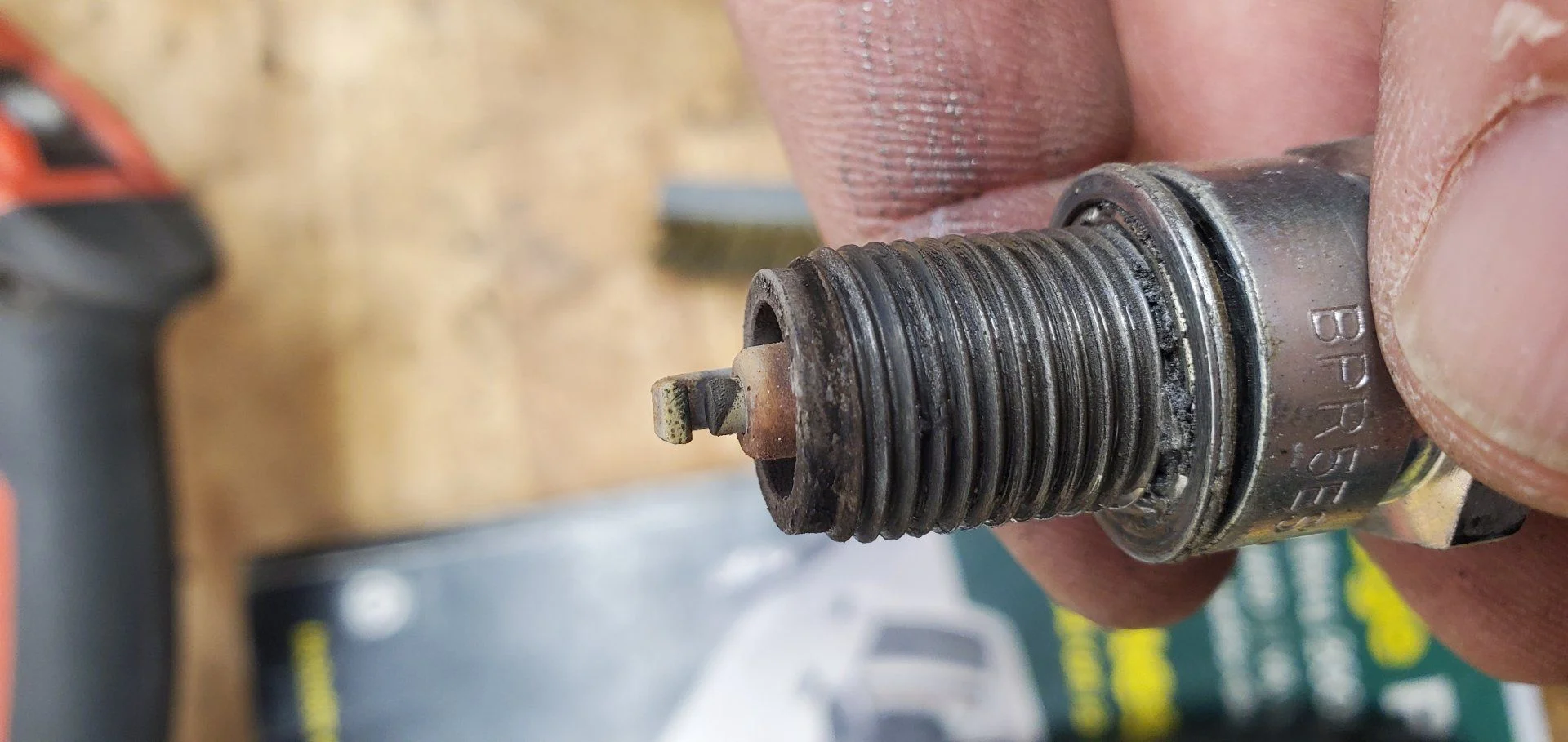

Cleaned the plugs today, didn't find anything alarming. Pulled the dizzy cap off and checked it out. I did find that all the tips were glazed over a little. A few minutes with a small file and they were as good as new, same with the rotor bug.
Here's some pics of a couple of the plugs.

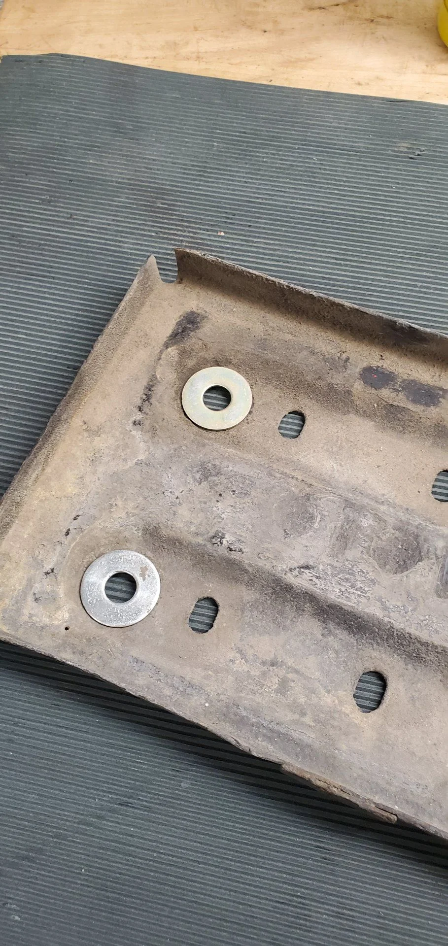

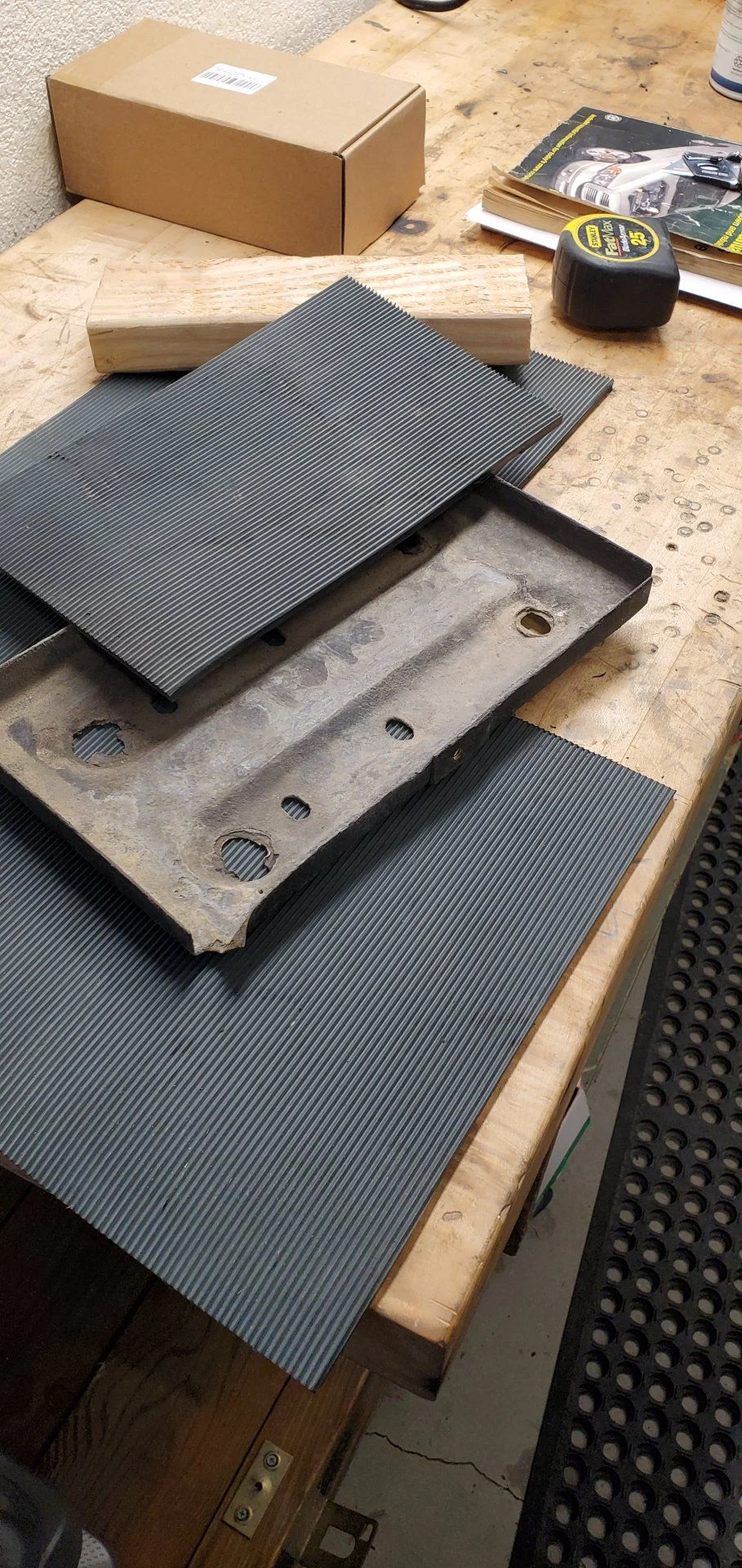

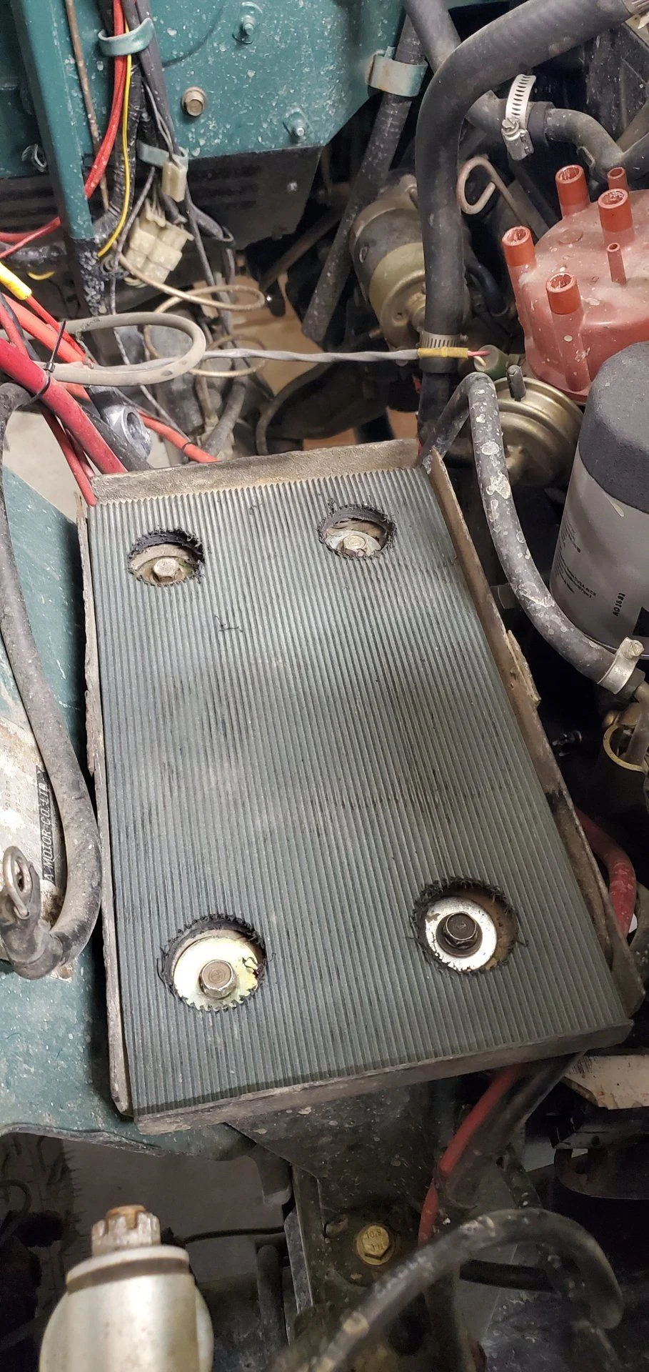

My battery tray has seen better days but it's not done yet, kind of a Betty White thing.
I added some fender washers to secure the tray to the tower, that resulted in the bolt heads sticking up above the base of the tray.
A little rubber mat solved that issue.

After cleaning the glaze off of the dizzy cap I did notice that the engine had some extra pep, easily a 1/2hp upgrade!
In all seriousness, cleaning the plugs and cap really seemed to bring the engine back to life.
Not that it was struggling to begin with, but it definitely woke it up. It's a heck of a lot more responsive and has a bit of kick in the seat again.

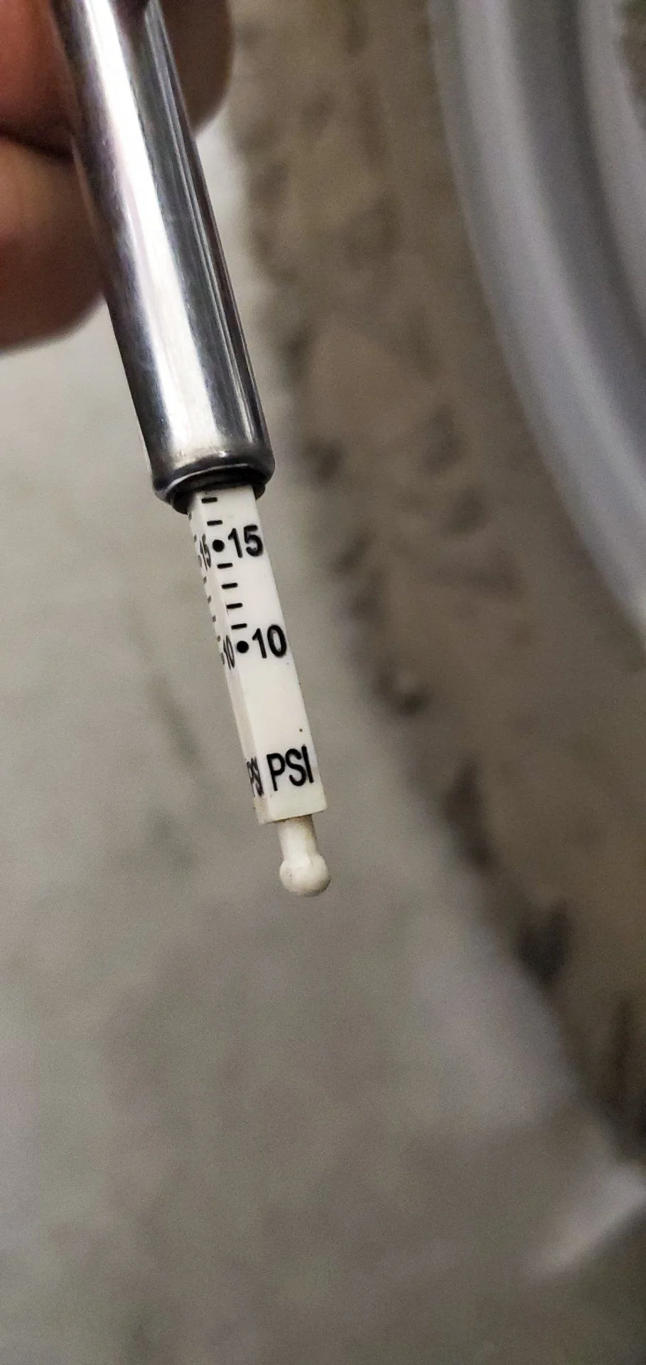

What tire pressure are you running in the razr's? Got mine on with ~36 and I feel like I have too much, only getting contact in the middle of the tire
I'm down to about 22 right now, might even drop em down to 20 soon. I had the same thing going on when I mounted mine.
Correction, how about 17 psi right now
