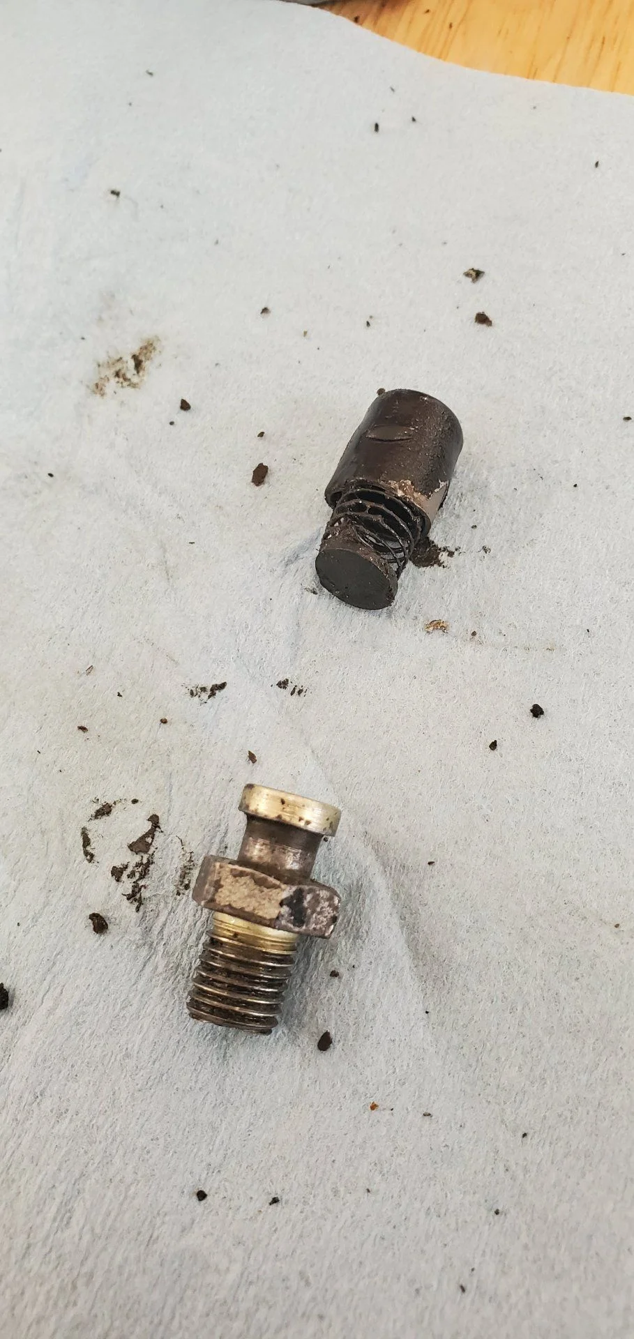

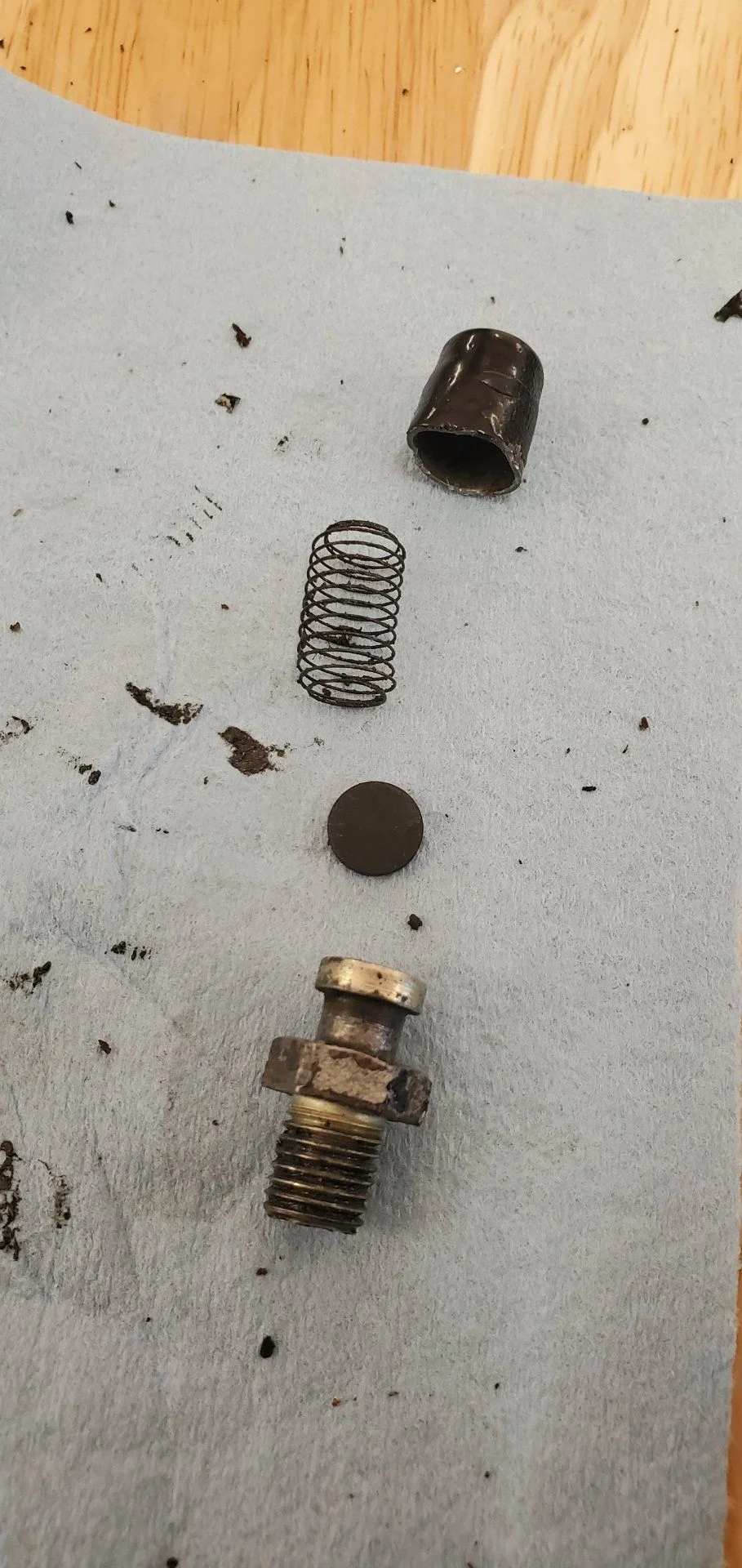

Here is the vent from the front axle. Sure enough there is a fine wire spring inside of the cap and a rubber disc that is held on the top of the nipple by the spring. I would like to think after many years of road grime and gear oil building up on that vent that it would get clogged or the cap seize up and render the whole setup useless.
