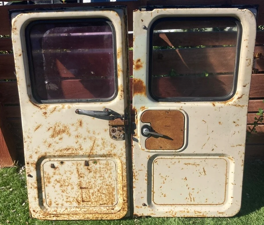

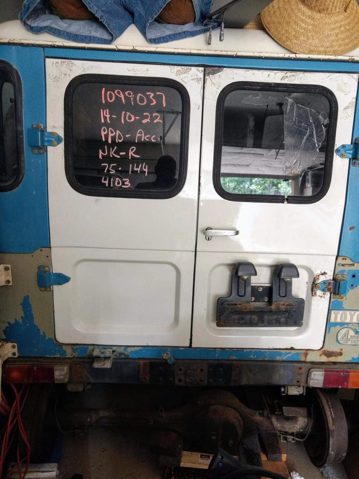

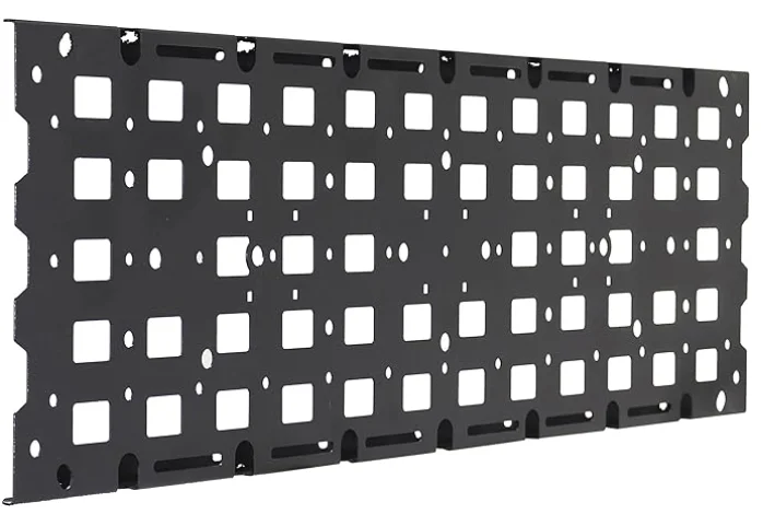

I got this idea in my head as I was thinking about where else to store/mount a Scepter fuel/water cans either on the inside or outside of the 40. I found this Rhino XRS rack plate that seems just about right to cut in half and split between the 2 ambulance doors so I wanted to see your thoughts before I try this. There's probably already the perfect idea out there I just haven't found it.
Obviously the rack mod would then allow for storage on the doors for a bunch of other things, I'm just wondering if it's worth drilling in to the ambulance doors to try this.
Thoughts?
Go Rhino 5950020T XRS/SRM Accessory Gear Plate Kit
I've seen a similar thing done by companies for jeeps and broncos, that actually utilize the stock holes and such from their doors, but I don't think I've seen anything for FJ40s.
Picture this plate cut in half mounted vertically to the ambulance doors using riv nuts along the sides of the inside of the doors. Would need modify slightly as well for the handles and such on the inside of the doors.

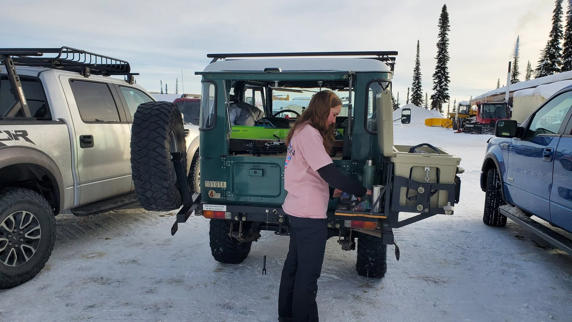

(not my picture just to get the idea across, taken from another mudder @MTZ FJ40 )

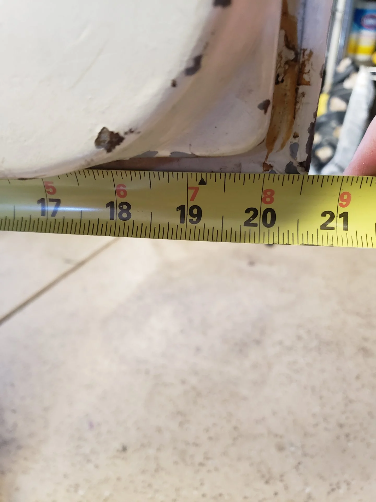

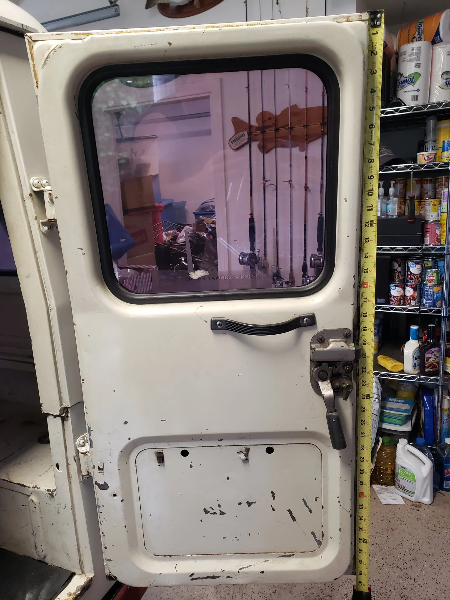

(also not my pictures but used for the measurements, thanks @Temecula40)

I like the idea and have been thinking of same type of thing to fold down from back of swing out. They come in handy for temp trail stops for lunch/repairs, its nice to have a quick deploy table alot more than youd think.
My daughter approves of the fold down table.
I’ll fourth the table idea Aaron. Leave the molle panels for the J**p crowd.

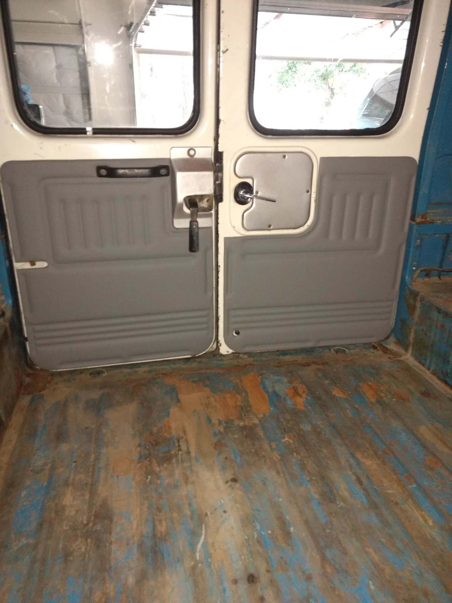

I'm assuming the door cards are something custom? They look nice, probably help with noise too.
There is a company out of AUS making the ambi door cards. They have a “store” on EBay. Pretty sure they have a .com as well.

Since it was brought again the door cards on my doors were made in the US. A thread few years back (2019) a member was looking for someone to install set and take pictures. Since my doors are off a wreck d troopy didn't mind drilling holes for the factory style clips. Late LX models and JDM mid wheel base 40 series had brown door cards on the ambulance doors. The handle cover was also brown.
