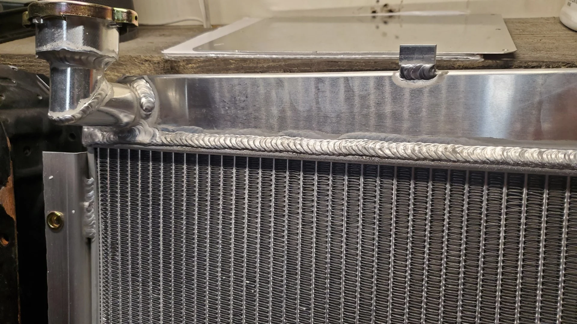

As a preemptive strike, i purchased an eBay aluminum 4-core radiator as a backup. The OEM one in there is old but holding water.
What are thoughts on theses? Obviously, i can’t tell anything internal, but the welds are actually impressive. I’ve seen worse welds on 3k mountain bikes.

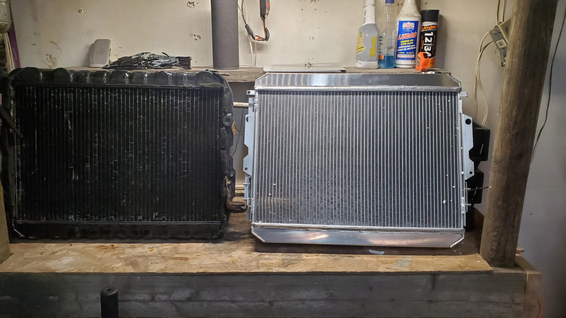

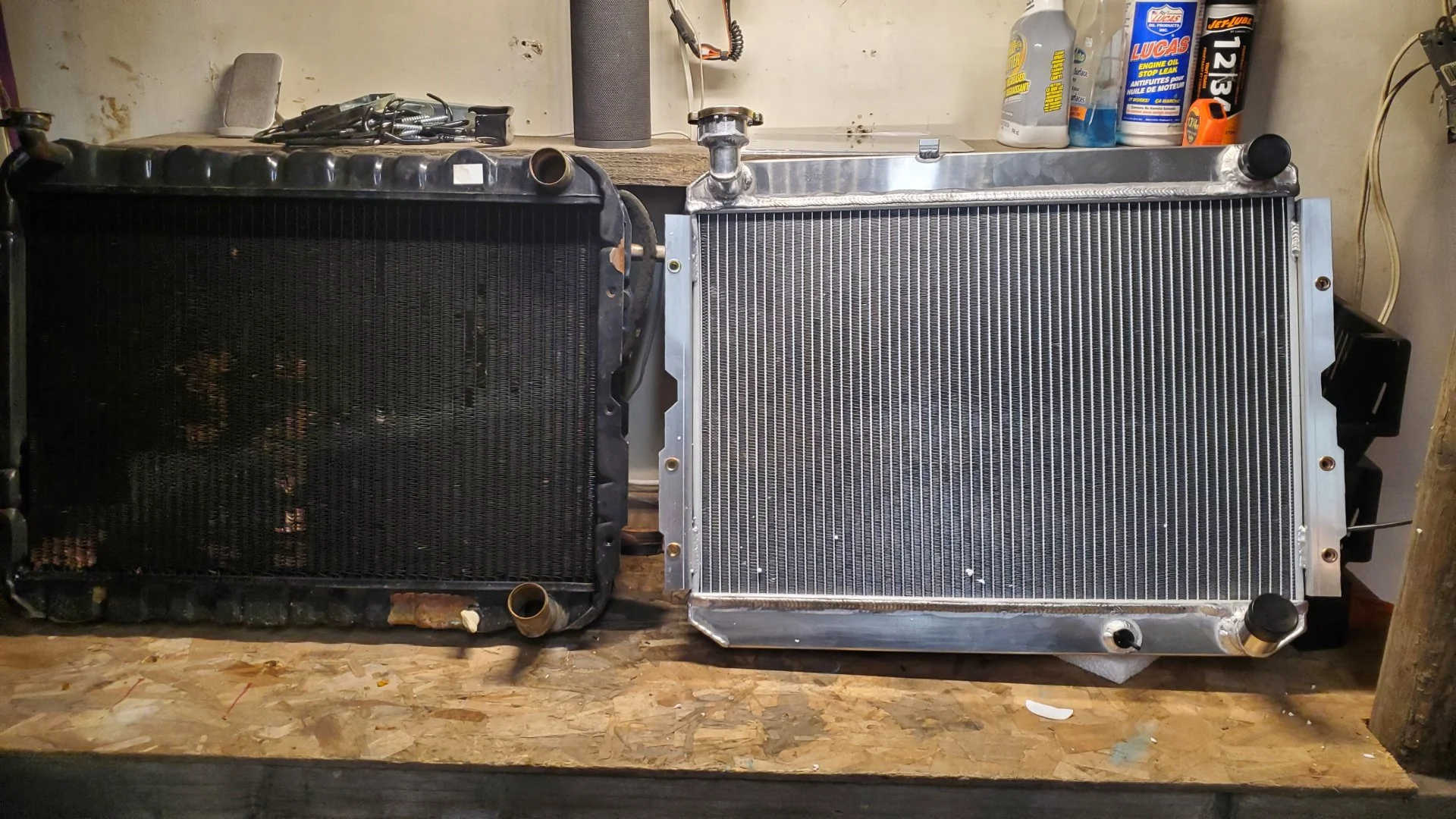

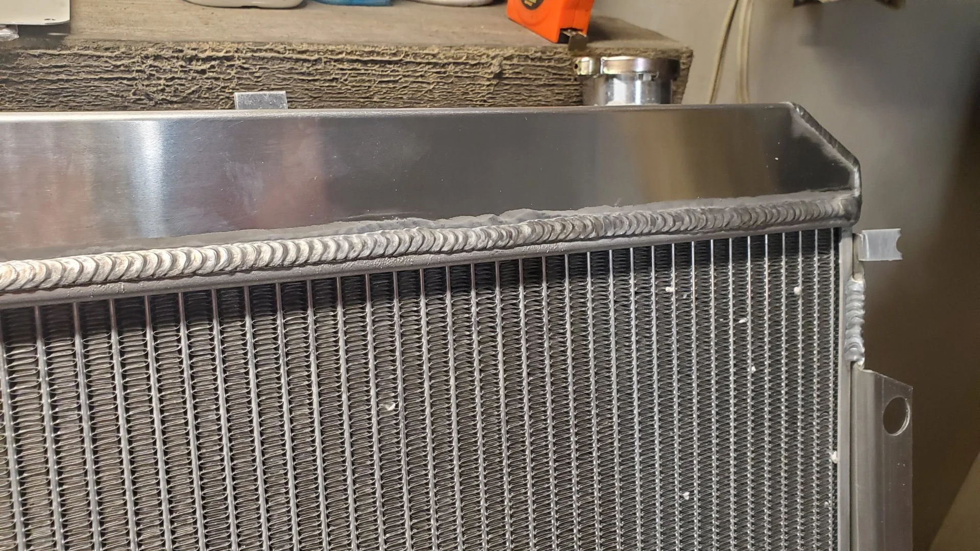

My eBay rad showed up today. Pretty fast from AU to CA honestly. Welds look dece. It's a tad smaller width wise but I'm sure it'll fit up fine. Will let y'all know how she handles once I put it in with a new water pump and thermostat. My 60 is pushing past the 2nd line toward max when I climb hills. I'm certain this will be an improvement.
What yall think. Should I paint it black? 🤔
