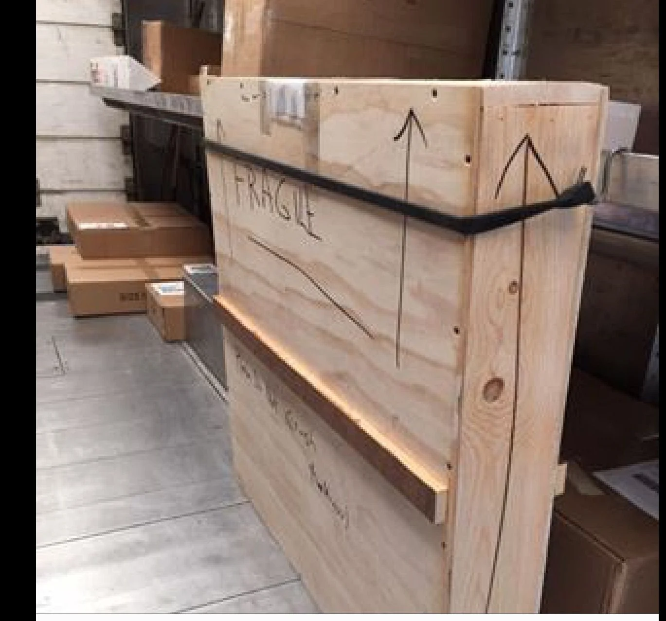

My route is a resort town filled with artists, this is a $20,000 painting that he sold from is gallery...his stuff does not get damaged.
Thats funny. I was thinking a crate too, but it is cost prohibitive for a $150 radiator. Still, I bet you didn't throw this box.
I agree that is overkill for a radiator, but they should have foam on the bendable parts and thicker something covering the core.

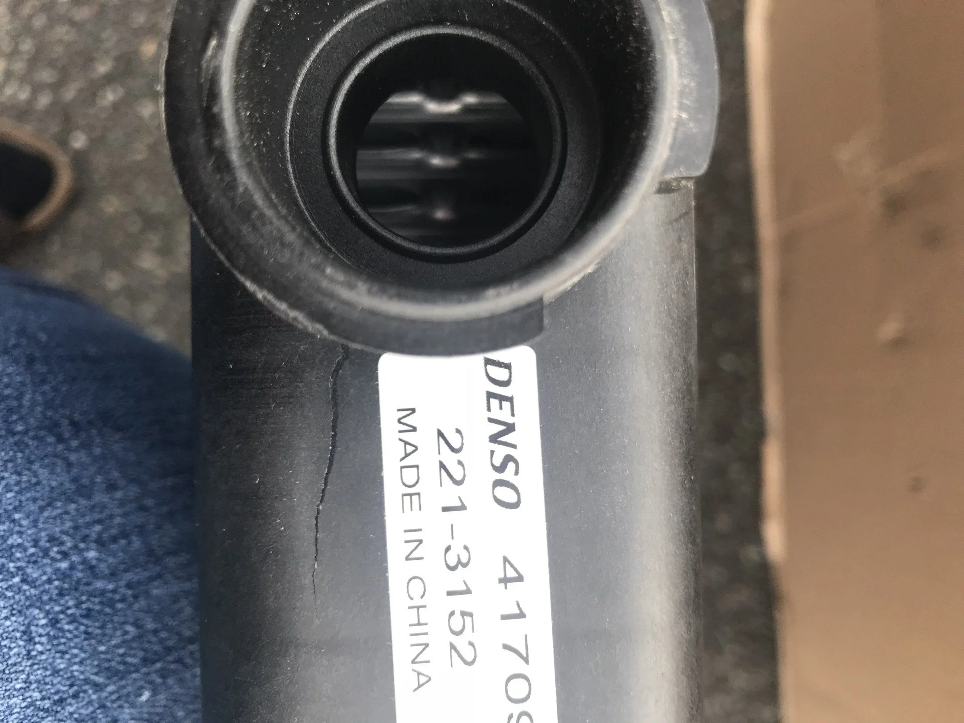

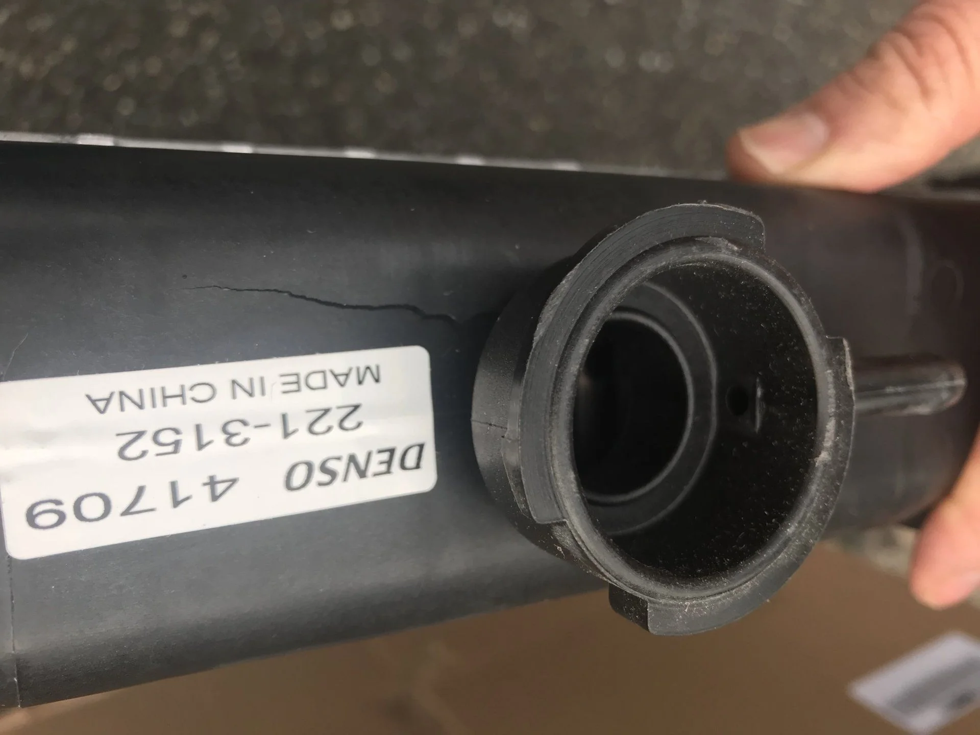

I did the Amazon merry go round as well , three Denso radiators. First two had broken thru the box in shipping (two day shipping) third one was in what looked like a better box. Driver suggested I open it before he left.
The fill cap was pushed into the tank. My radiator has a tiny leak, on its last leg.
