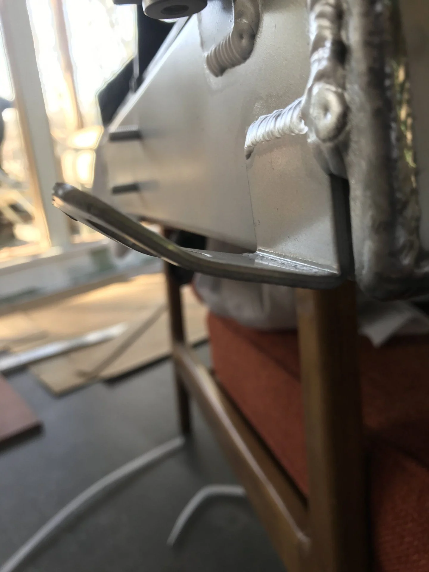

Received the new aluminum radiator, box was pretty ripped up in shipping. Mounting tab was bent, I have a extra radiator shroud , it doesn’t line up quite right.

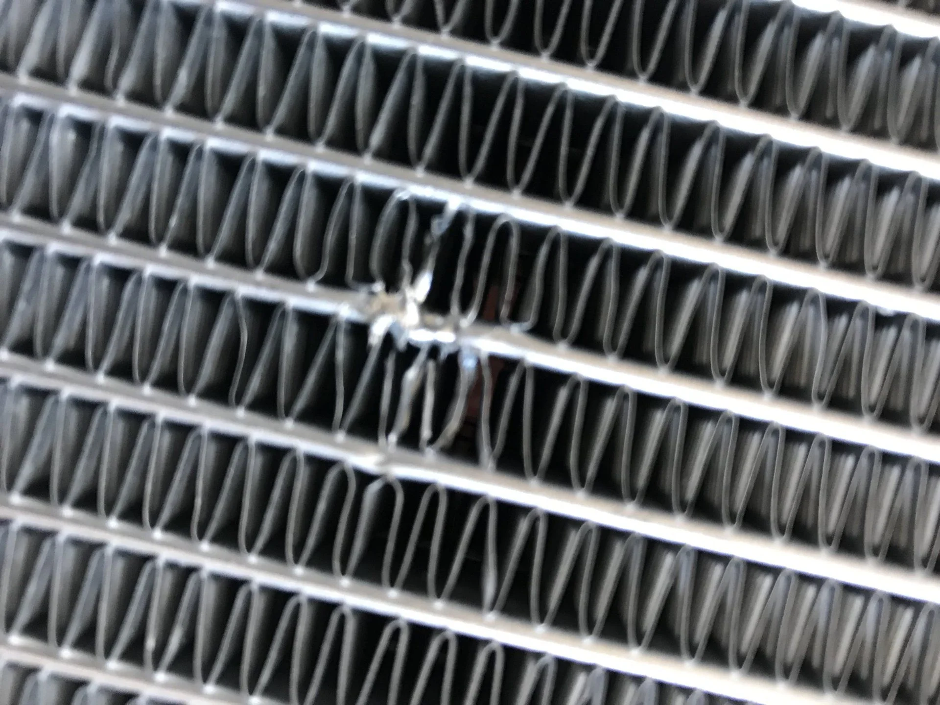

Decided to inspect the radiator, found a little spot where it looks like it was repaired.
Filled a claim with the seller, going to try another vendor and order a Factory radiator.

The slightly bent tab didn’t bother me on the aluminum one I received. I didn’t want to modify the fan shroud to make it work. So rather than waste any energy trying I just sent it back.

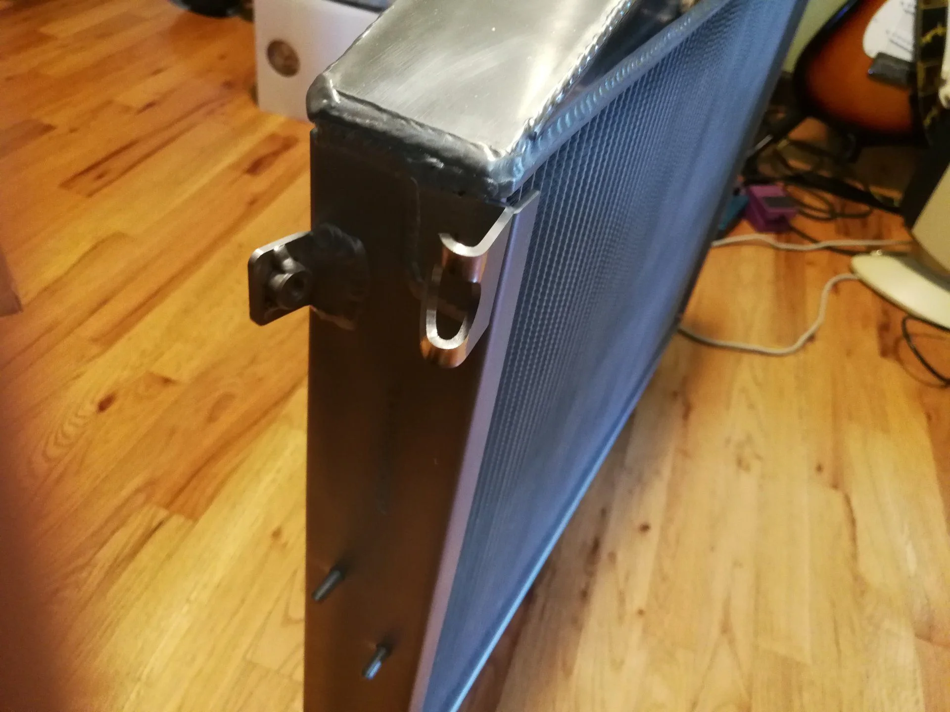

Ordered a 200 dollar radiator off eBay last week so I figUred id chime in with my results. Interestingly the box was not damaged at all but the mounting tab on the rad was bent unusually I believe it was shipped out this way. Either way ill be repairing it and using it, thing is massive otherwise impressed with build quality for the money.we'll see if it actually fits.
I had same experience with the eBay unit. Mine had the bent tab from shipping (easily bent back) and the fan shroud was a bit off in spacing on one or two bolt holes, everything still holds well so far.

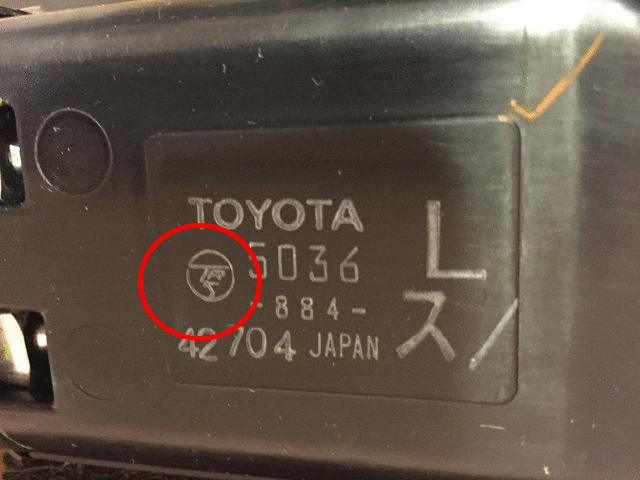

The OE radiator for just about every Land Cruiser built in Japan since the 40 series and maybe even before that was supplied by Toyo Radiator (a.k.a T.Rad). Compare your radiator markings with this one. If you want one, contact your favorite Toyota/Lexus dealership/parts supplier and order one.
The OEM radiator for just about every Land Cruiser built in Japan since the 40 series and maybe even before that was supplied by Toyo Radiator (a.k.a T.Rad). Compare your radiator markings with this one. If you want one, contact your favorite Toyota/Lexus dealership/parts supplier and order one.
Interesting, I've seen otherwise more recently are they still being manufactured or NOS?
They never stopped but I'm sure someday they will. They stopped producing the 80 series radiator. They make the LC200 radiator as well.

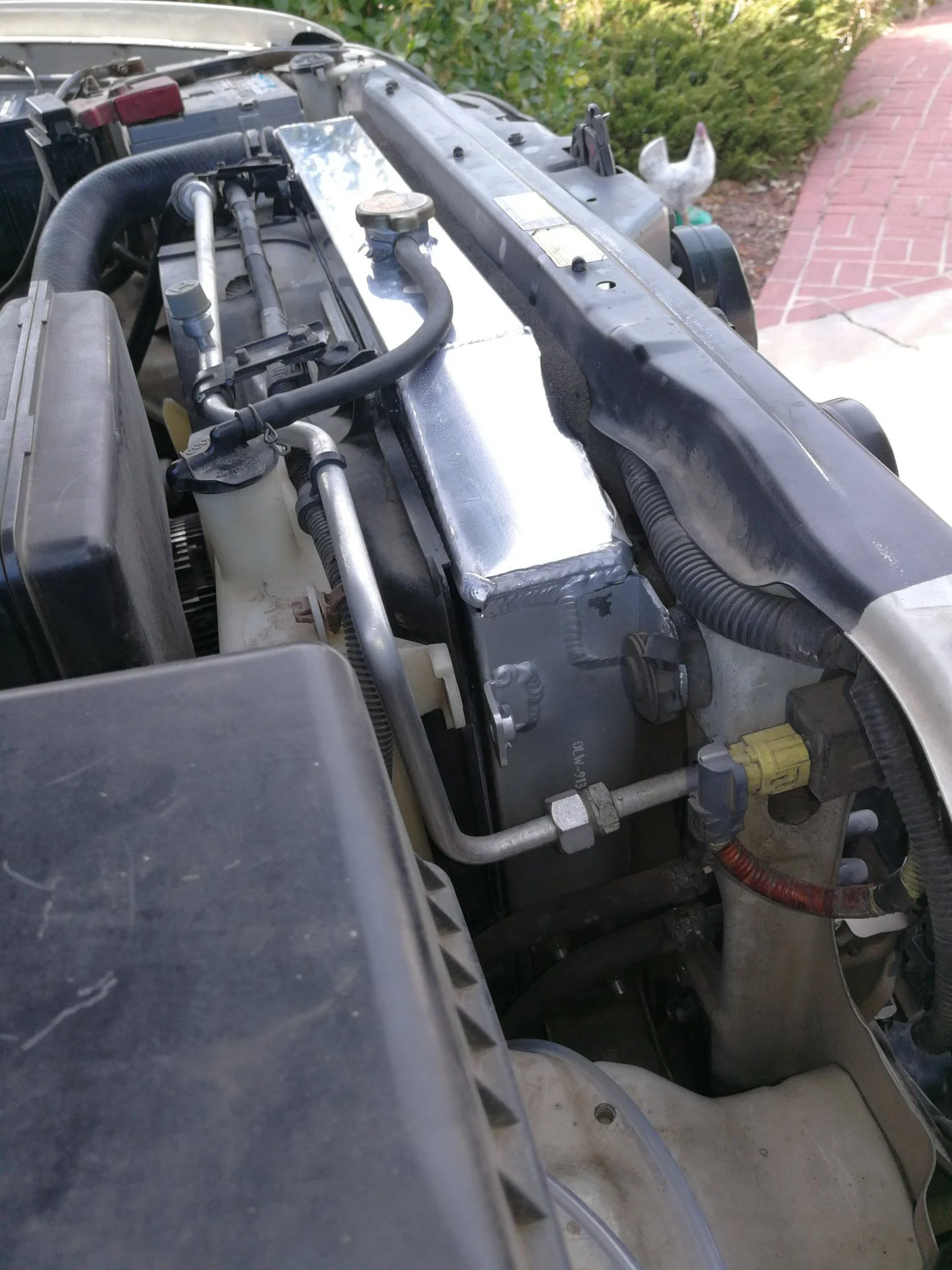

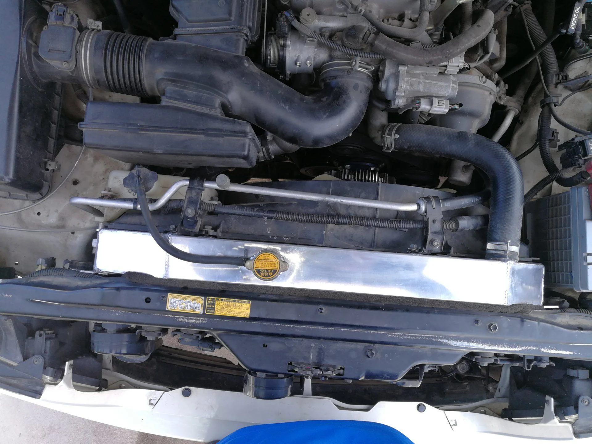

Installed my ebay aluminum rad, initial impressions are as expected and experienced by other members, not exactly good. The rad mounted in the truck very well the fan shroud does not, and the over flow reservoir does not, the ac lines do but require a small spacer. It holds roughly 2 liters more coolant and seems to be holding it in fine have not got around to pressure testing yet. I am satisfied with the price considered. If anyone is interested with the trans cooler the fittings are -6 AN with 37° taper. Hard to eyeball 37° vs 45° I asked the seller who contacted their supplier and was told that's what it is. Though I don't know that it's factual.
How do you like the all aluminum radiator so far
So far I have no complaints outside of whats previously posted by me and some of the other members. I did get a chance to pressure test the rad at ~18 psi and it help it for several hours, and I I did regretfully have to replace the hose clamps with worm style due to the lower hose not wanting to seal with my spring clamps not sure if this is due to a variation in water neck sizes or just a worn clamp, and struggled with finding a matching AN fitting for the trans cooler lines. ( I used straight barbed -6 aluminum fittings, 3/8" JIC also works ). I flushed the transmission thew the the trans cooler as well ("nominal" pressures), but everything is holding and leak free. I've noticed a subtle change in cooling capability as well, since its getting cooler here in the mornings it takes a few moments longer to get some heat going and to OT in temps below freezing im assuming this is due to the increased coolant capacity.
I would buy it again.
