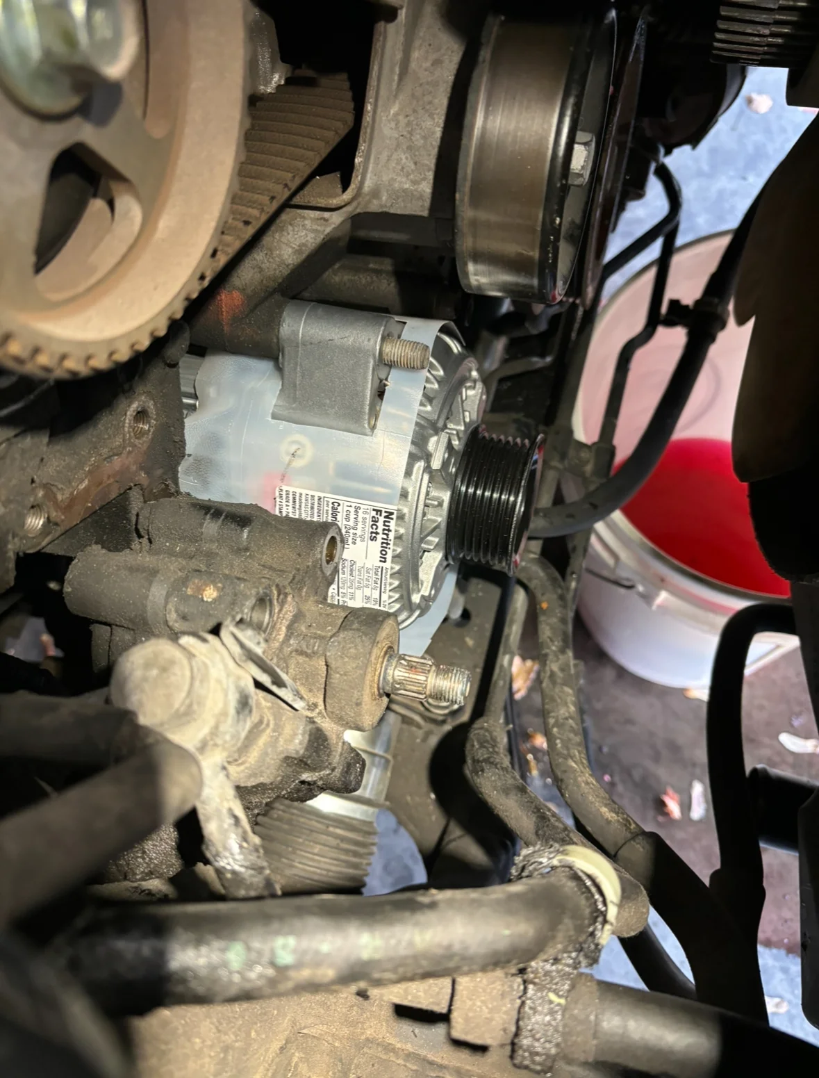

I also would recommend putting a shield on the new one cuz the power steering is guaranteed to leak right on it.

Why do you think the P/S pump is going leak? I never had a leaky P/S pump on any of my toy. The shield can cook the internals of the alternator. There is a built in fan on the armature to cool the alternator but with the shield, there is no room for the hot air to escape.

I had to replace my alternator due to leaking from the power steering pump. On my '06, the power steering pump is right above the alternator. Replaced both.
I would get the leak fixed ASAP before it ruins the alternator.
Similar experience, similar mileage - power steering pump went bad, soaked my alternator, then alternator went bad. Alternator (on both my land cruiser and 4 runner) made an audible 'whine' similar to the sound of my failing power steering pump. Also alternator gets worse in cold weather (mornings/evenings), and yes issue 'disappears' at higher RPMs. Which has something to do with how fast the brushes are/are not moving within the alternator. So you can 'limp along' on a failing alternator if you are on a freeway going 60-70mph, but you start losing it again as soon as you exit. I'd suggest replacing both 'while you are in there.'
