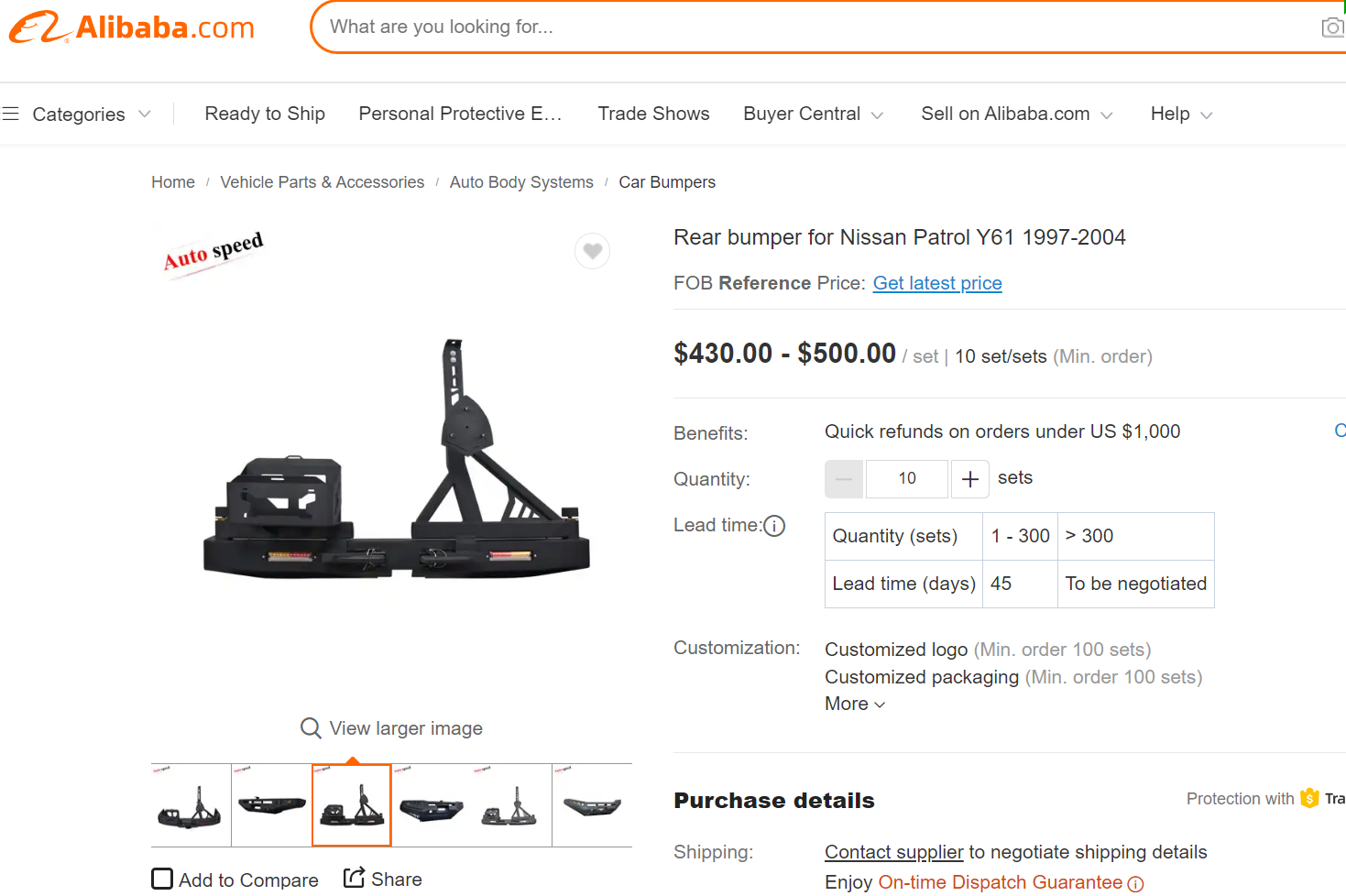

They use that same image for the "rear bumper" for like 14 vehicles. Chances seem very slim that the picture actually shows the product you'd receive. 13/14 are wrong, at least, lol.

Edit: I found the listing. I would 100000% not buy this. The departure angle, design, etc looks like garbage. The bumper probably flexes when you open the swing out. Take a look at the wing design lol

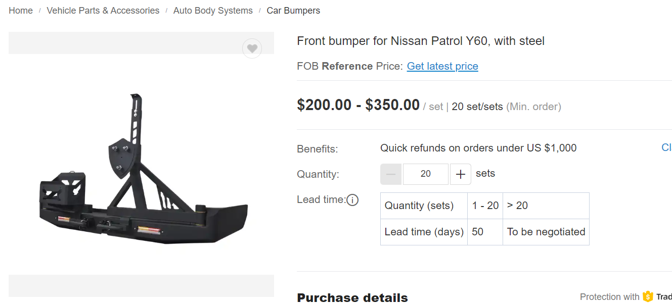

I assume we're talking about the one in this thread.
Hilux Vigo:
Patrol:
One size fits all, apparently:
Patrol 61:

Swing out design is the same in the other images, can’t imagine a massive variation in bumper design here. Alibaba is known to show products for other vehicles. I’d be curious to see the actual listing the OP pictured.
Still zero pictures of inside, or any details of the unit.
The one you linked is the same one I found.
