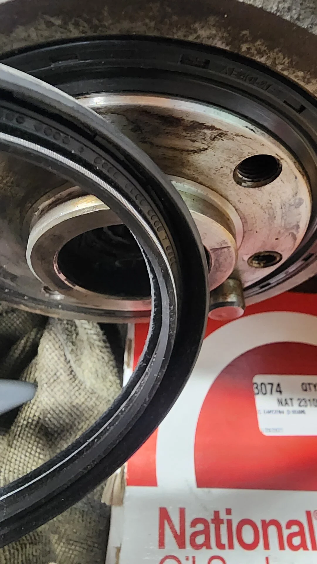

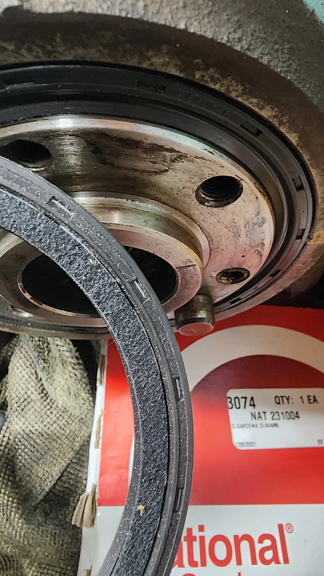

Got my rear crankshaft seal in.
Looks like the same size eyeballing it, but I have a felt ring on what assume is the outside (towards transmission) that is not on the original. To my understanding spring always goes towards pressure(in this case the engine).
Confirmation this is correct?
National # 231004
Scratch that, just found it's a improved design change that happened in 1985. Dimensions are the same, and spring does go towards engine.
Do my research before asking questions next time 😅

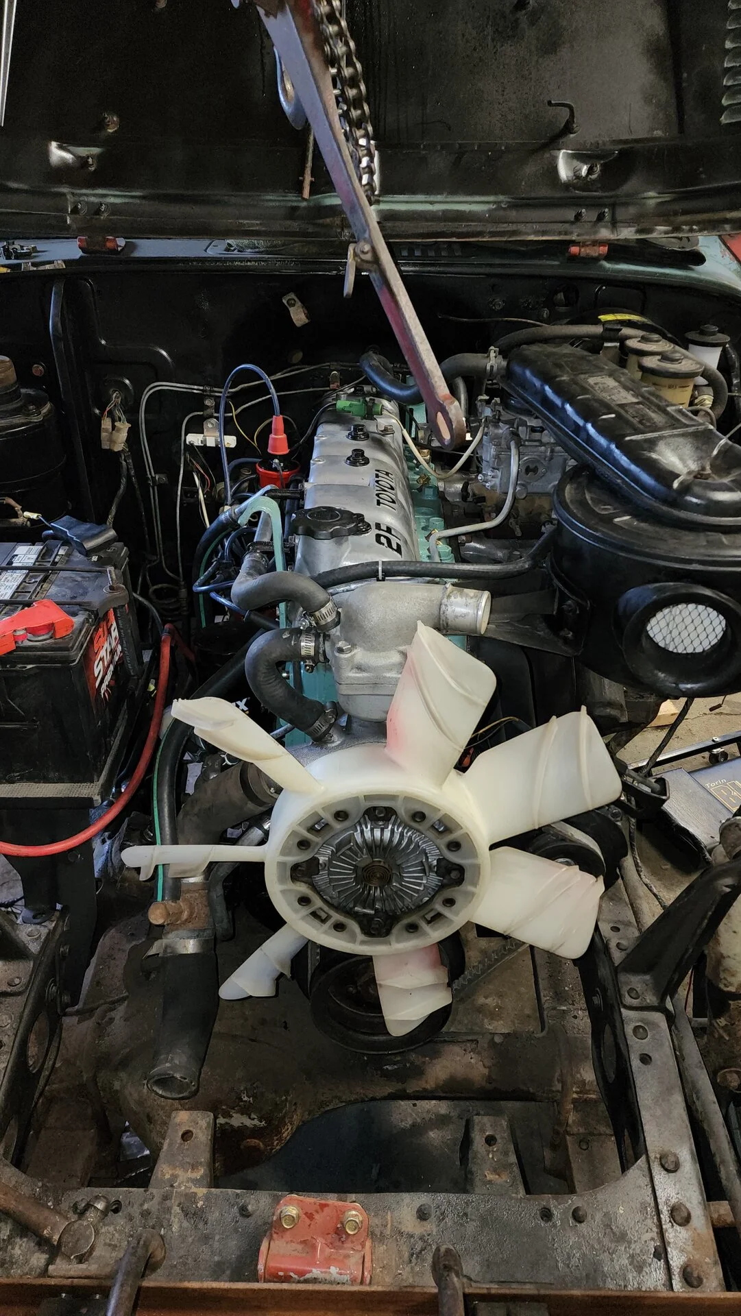

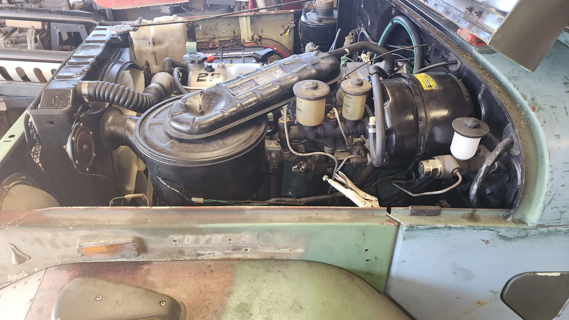

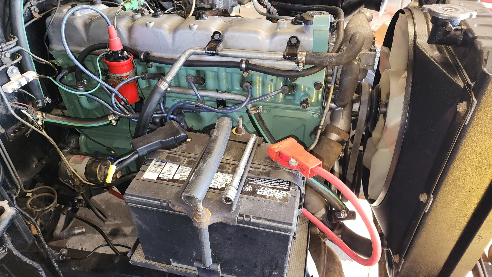

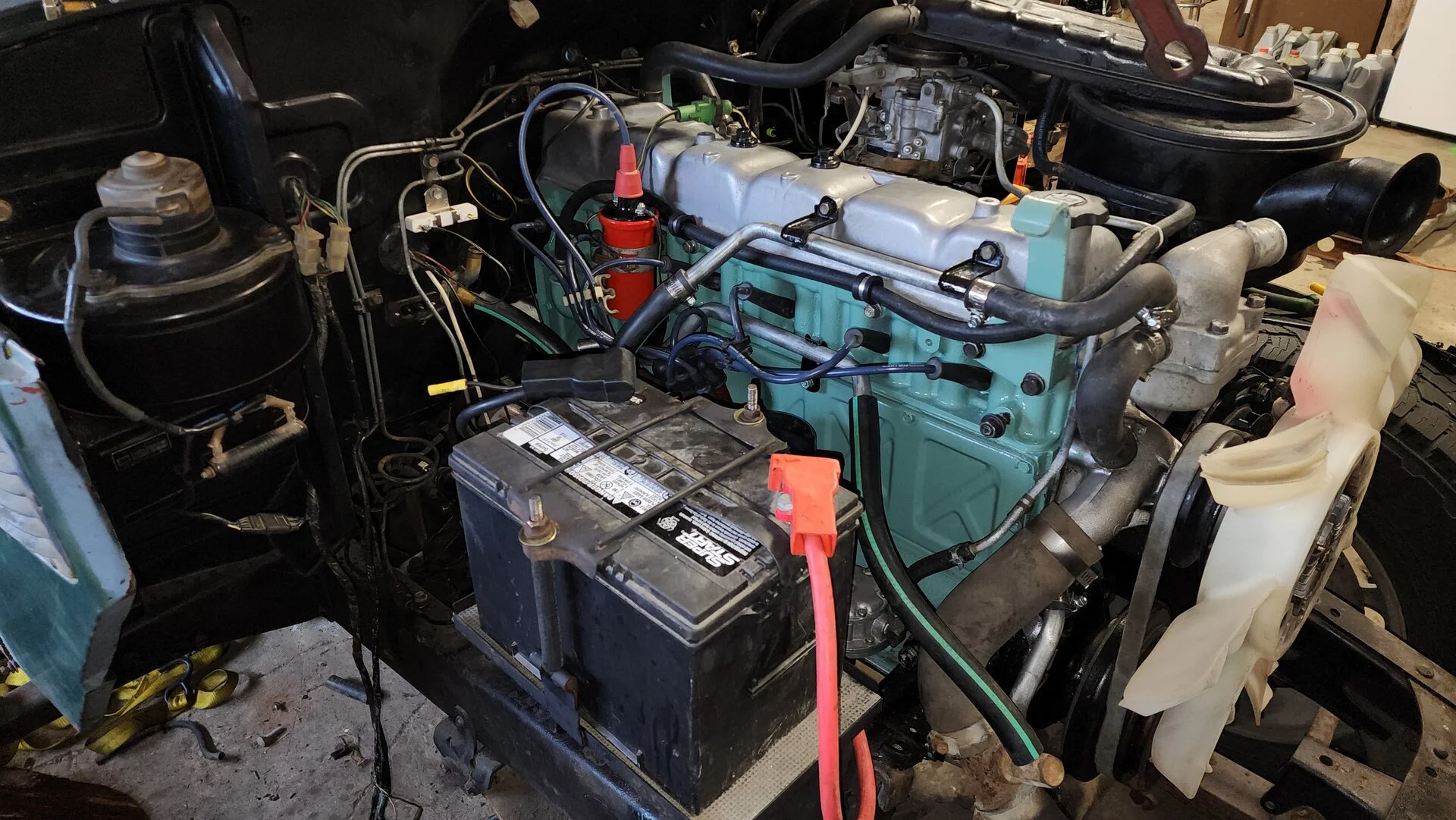

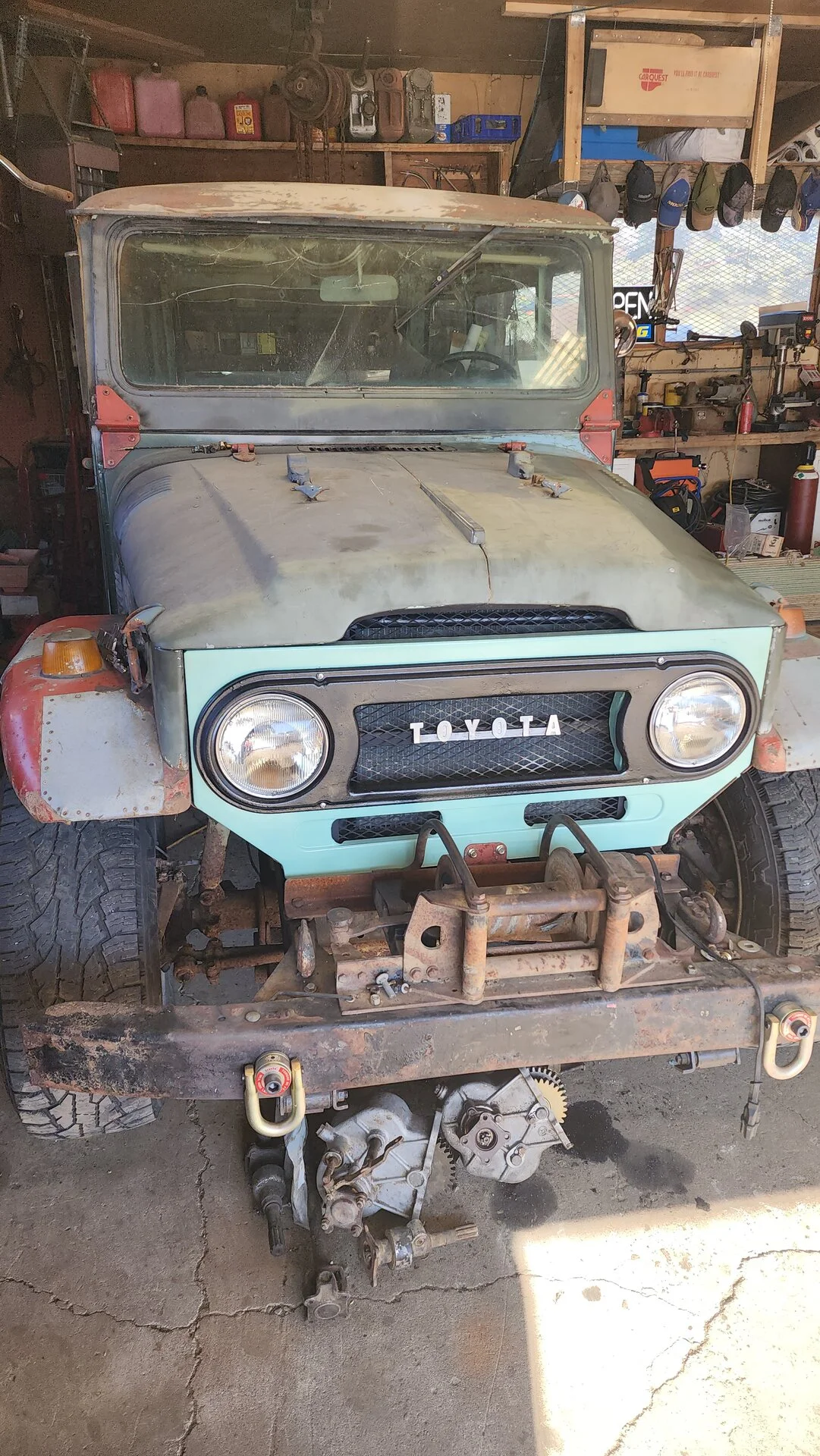

Well the 2F is nestled in...

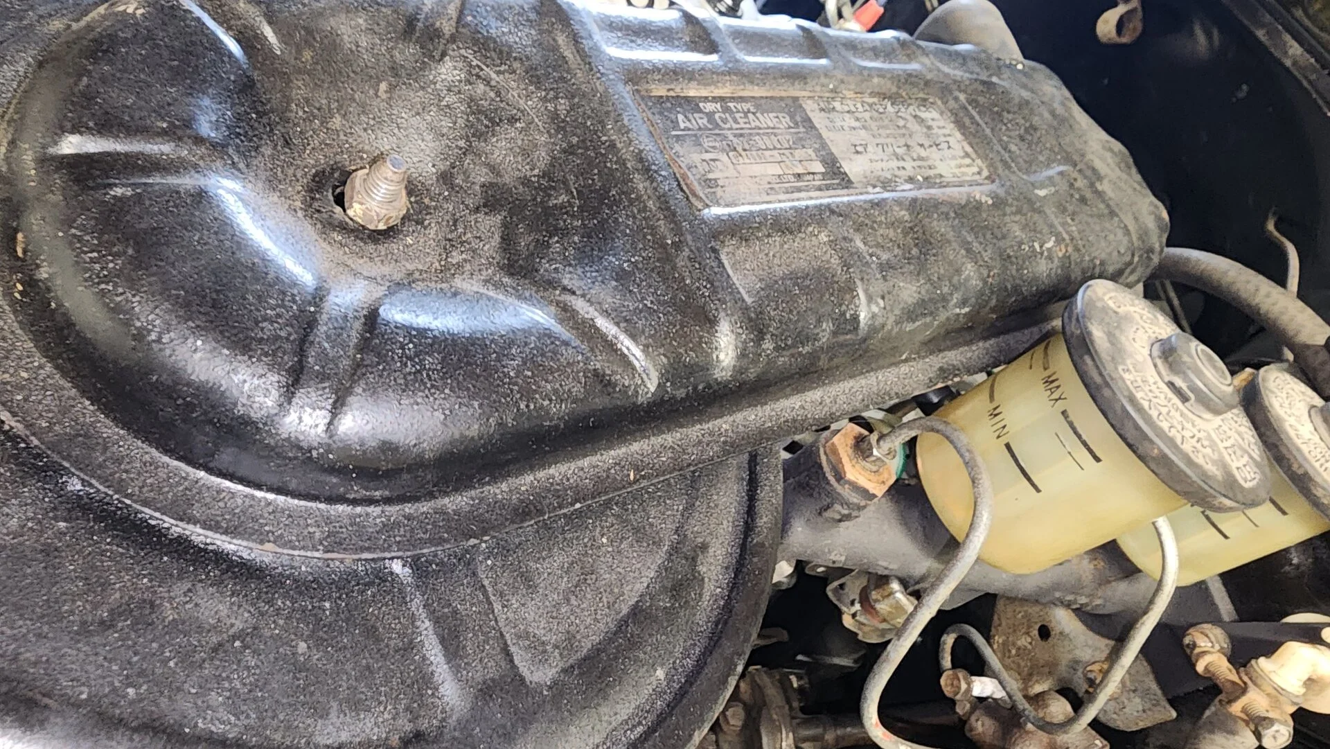

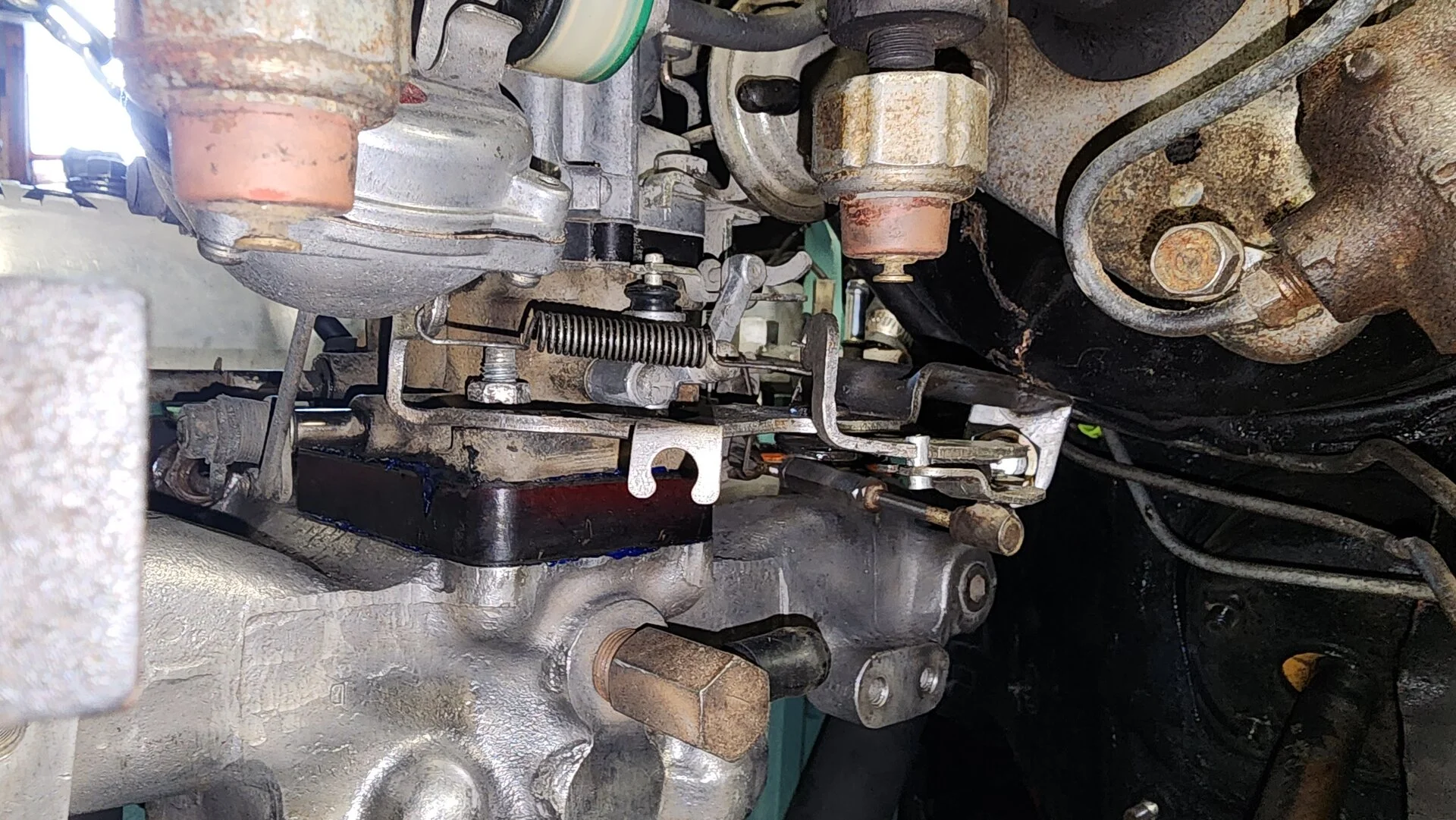

Some very toit spots I'm going to play with around the throttle linkage/breakbooster and air filter/master cylinder.

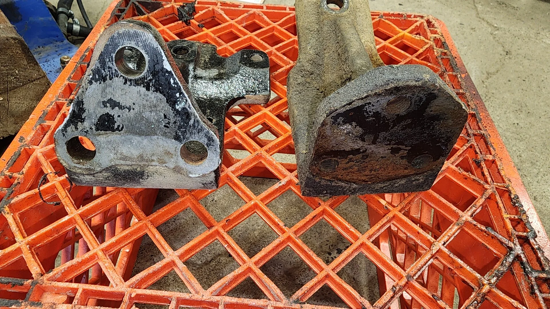

Also, engine mounts are slightly different, so I'll be drilling the old mounts out to accommodate the bigger bolts tomorrow.
Love the color of the engine, and the bib. Send it!

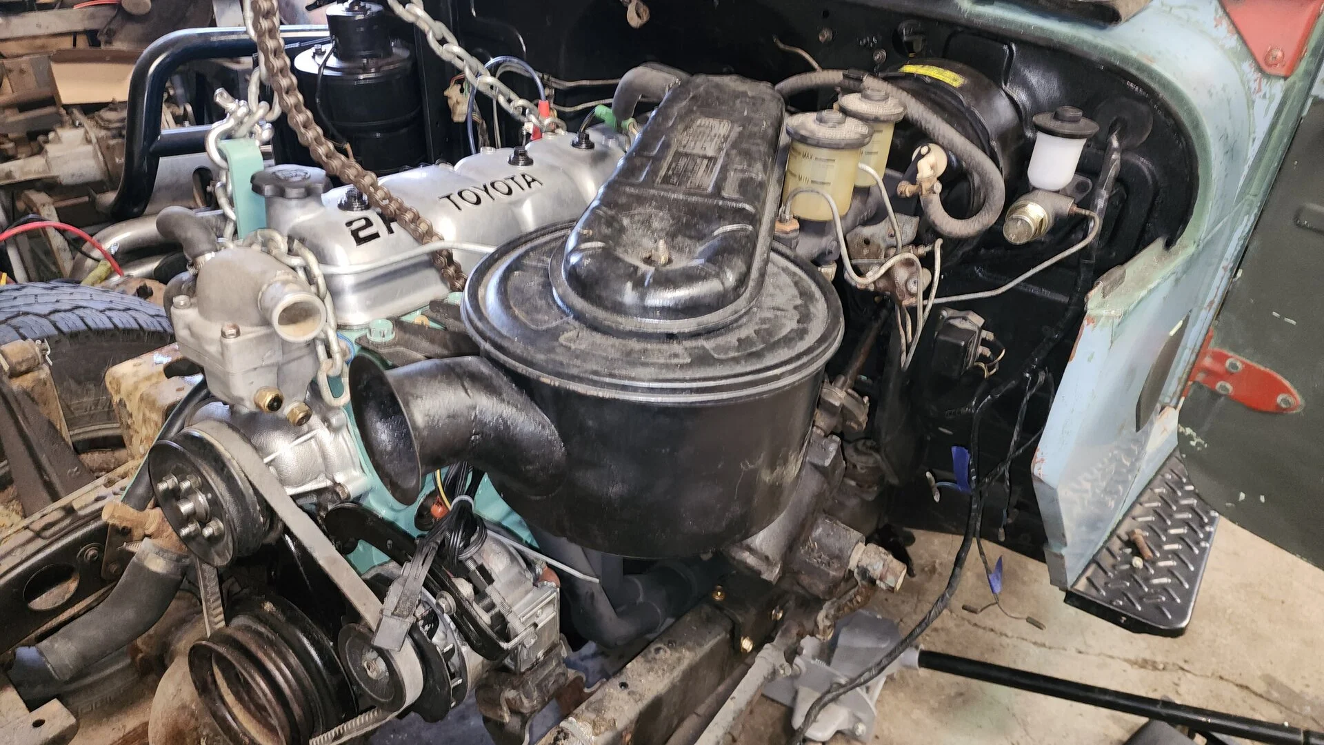

2F install
Well, it's in completely. Ended up removing the nipples on the original mounts bushing to match the flush later year mounts off the engine. Bit of tinkering and finishing things as I move towards to radiator.
Really getting excited to fire it up... 🤞

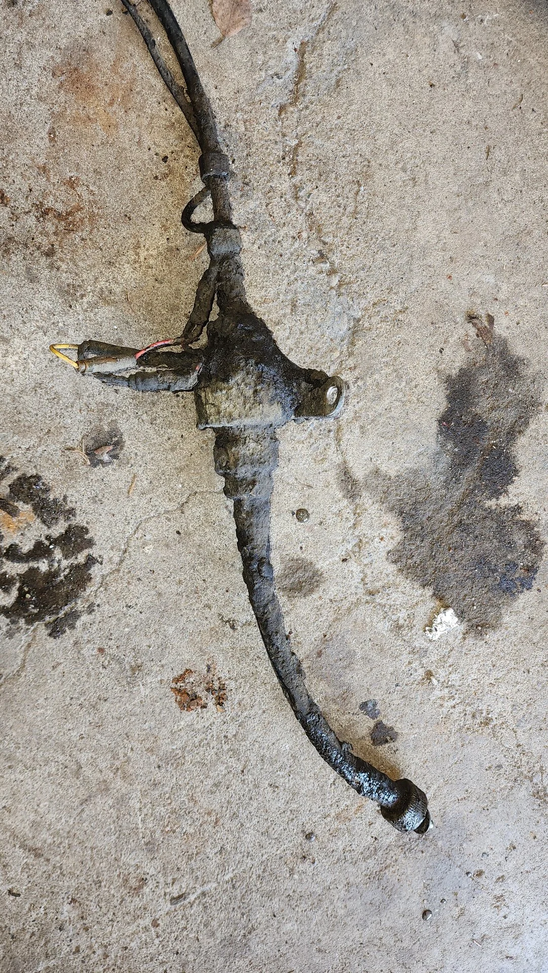

Went out to my yard and pulled two speedometer cables.
The 76 won't work because of the 'clip on' connector.
But the 71 will (I think) I'm having issues identifying this harness attached, reverse switch??? Any help appreciated, sorry it's not cleaned up yet.

Engine is ready for a test run however I will be doing another once over before I'm ready to fire it up.
Wiring is 90% hooked up, and verified functional minus the taillights.
Still have the fenders and fuel tank door to address ono major body work...
Overall getting there.
Speed generator, wires are connected to "computer" under dash. It's an emissions thing. Most just remove it and run a longer speedo cable. The 10" speedo cable is NLA, but I have found Toyota PN 83710-12461 works and is about right length (it's from a AE9 Corolla)
Thanks for the info!
I ended up finding out the cable before the 'speed generator' was too short by its self, so I have the entire assembly in right now just unplugged. The two wires are alternatively connected to the reverse switch on the 4speed.
Likelihood of me swapping to another speedometer cable in the future is high, but it works for now.

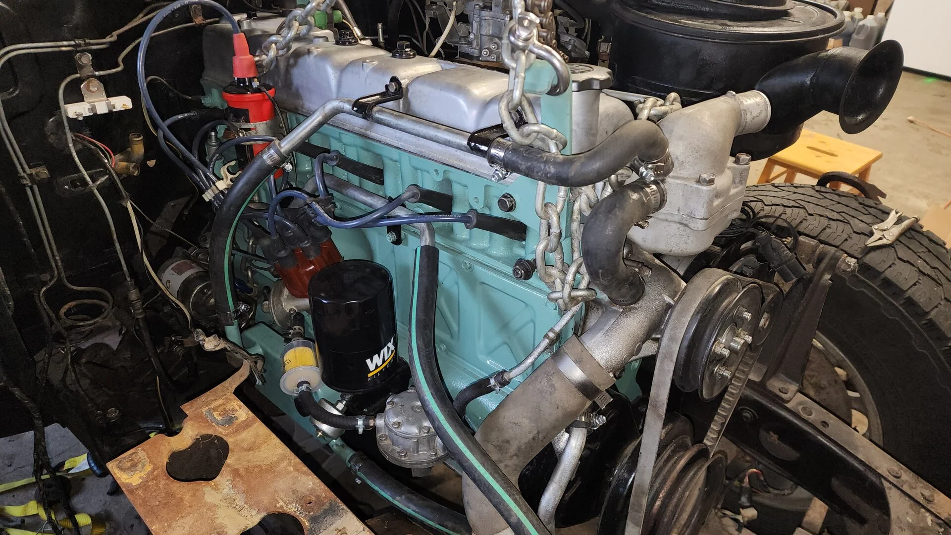

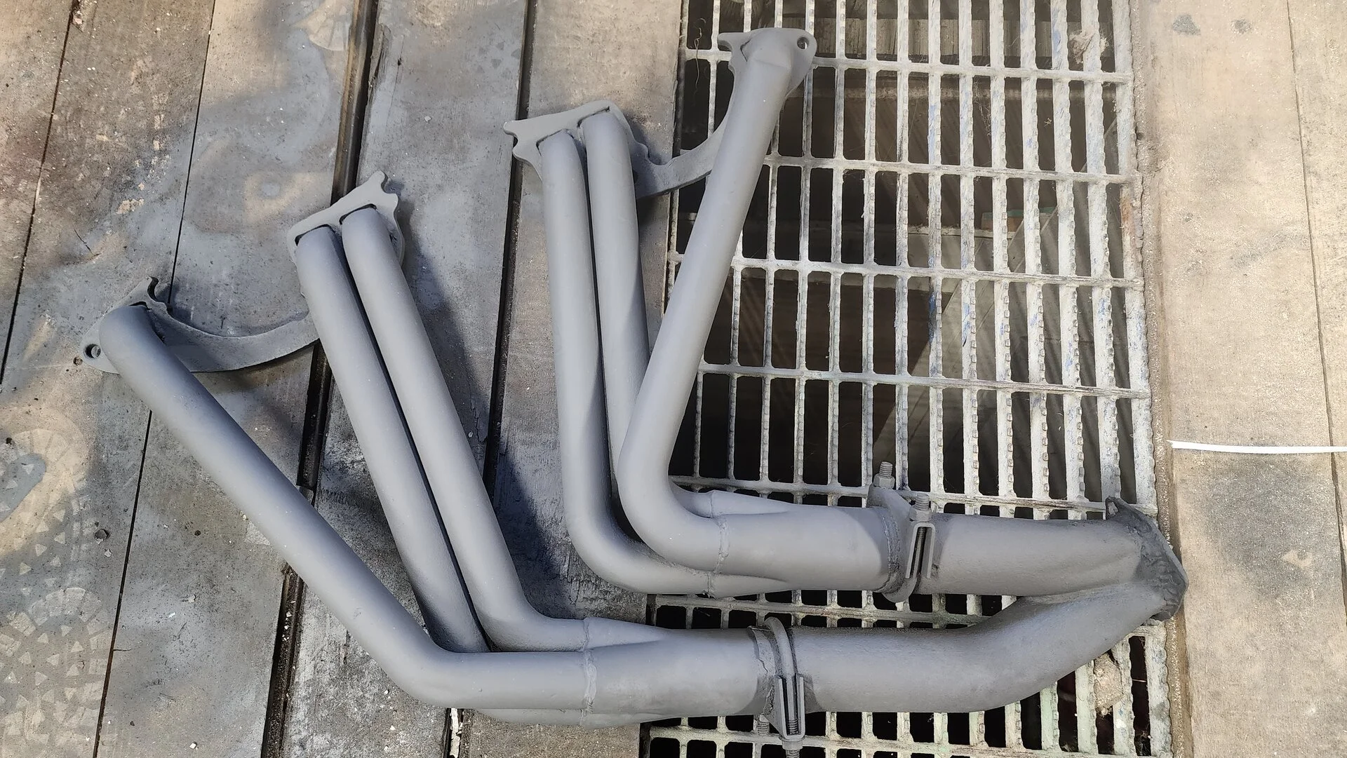

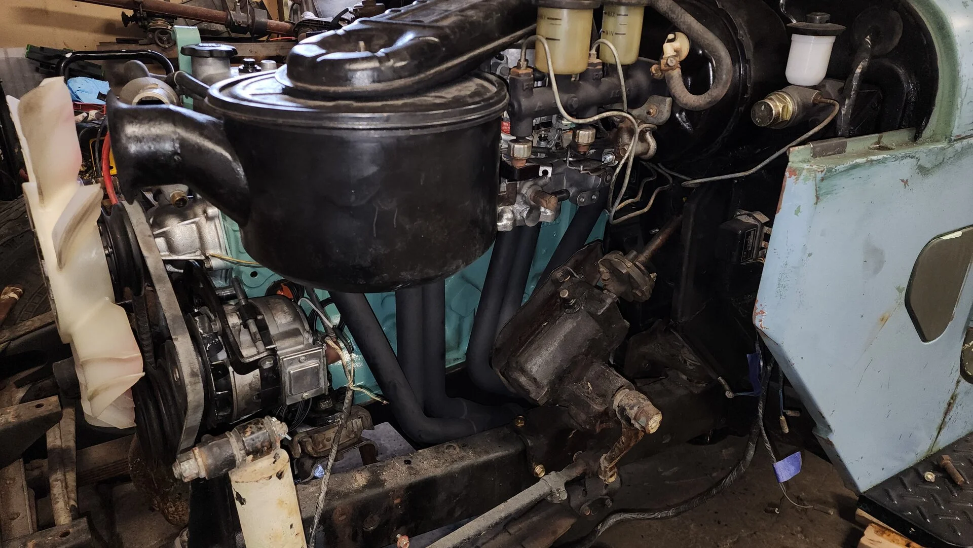

Any ideas on the manufacturer of the header I'm using? A modified/split Mark&Downey?
Someone on a Facebook post asked on my PTO clearance with headers, had to make some modifications, luckily it's a 3 piece header so I loosened the lower collector and was able to move it to clear the PTO shaft. It's tight but doable.
