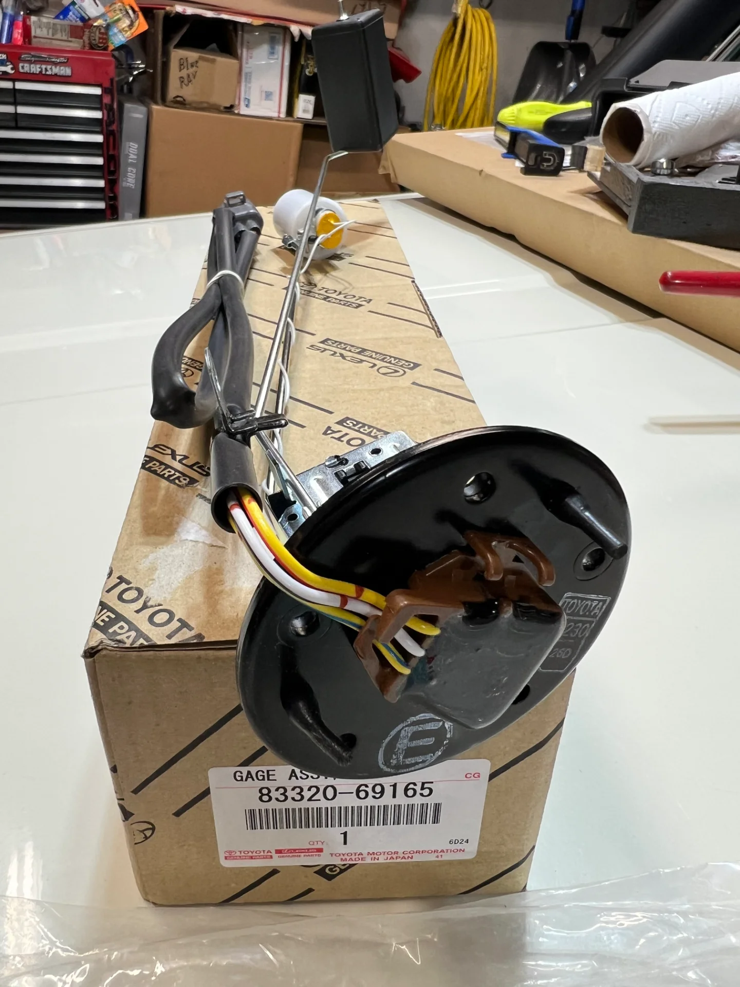

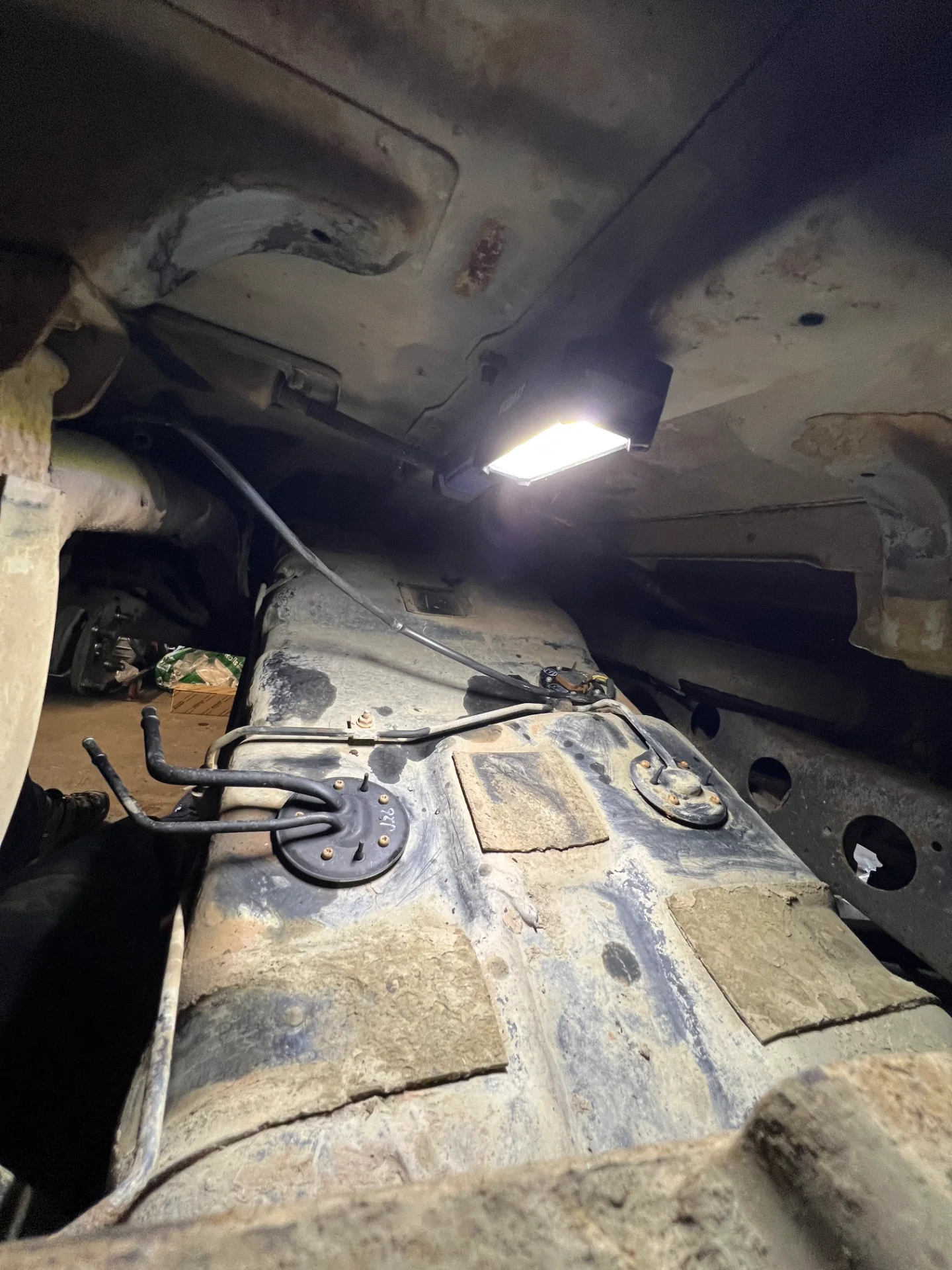

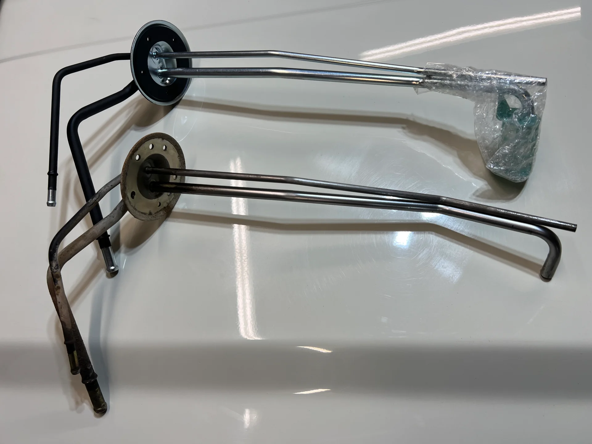

Finally got around to replacing the front tank fuel pickup and level sensor. Didn’t see anything obvious that might cause the hesitations I sometimes get under full throttle climbing hills. The pickup filter was missing on the old one, don’t know if I knocked it off when I removed it or it fell off by itself over time 🤷‍♂️.

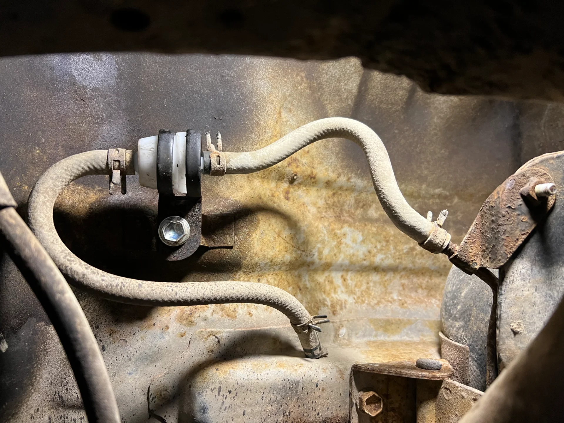

I did notice that when I removed the breather line on the front top drivers side of the tank that a lot of gurgling sounds happened for a bit. So something in that system was causing the tank to pressurize. Replaced the one one way valve for the breather but it seems to be working. Will see after I drive it some if it still gets pressurized.

Ugh, no access hatch to get to the sender/pickup?
