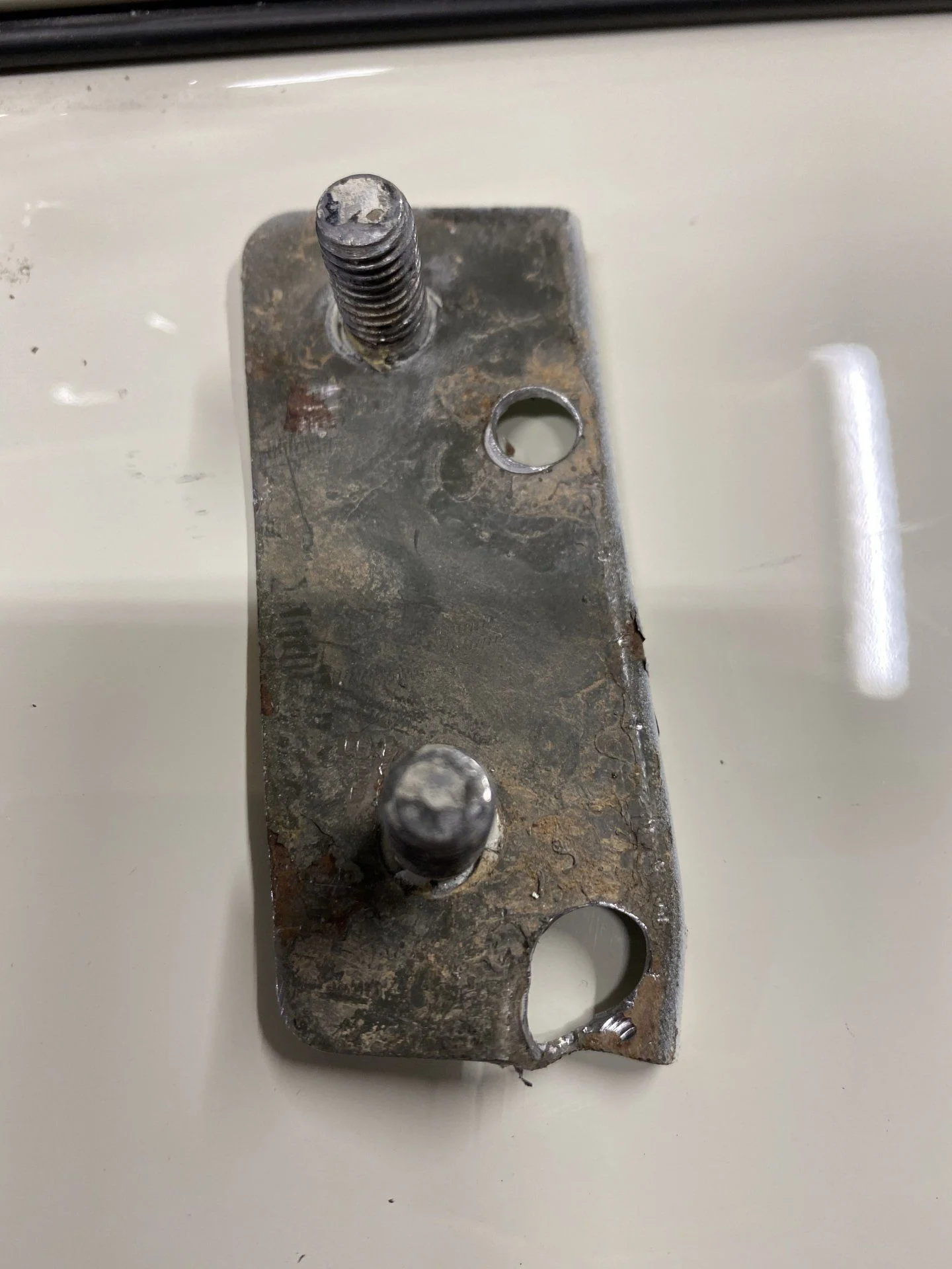

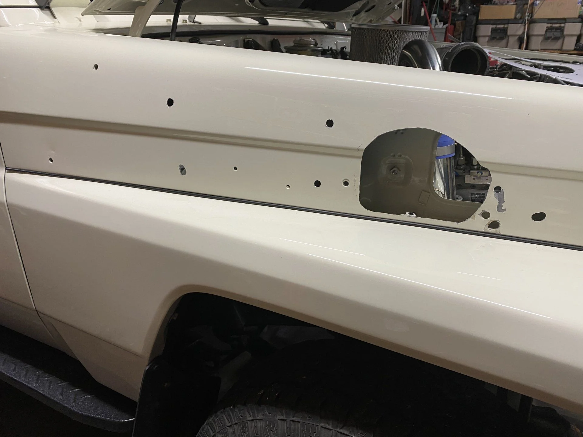

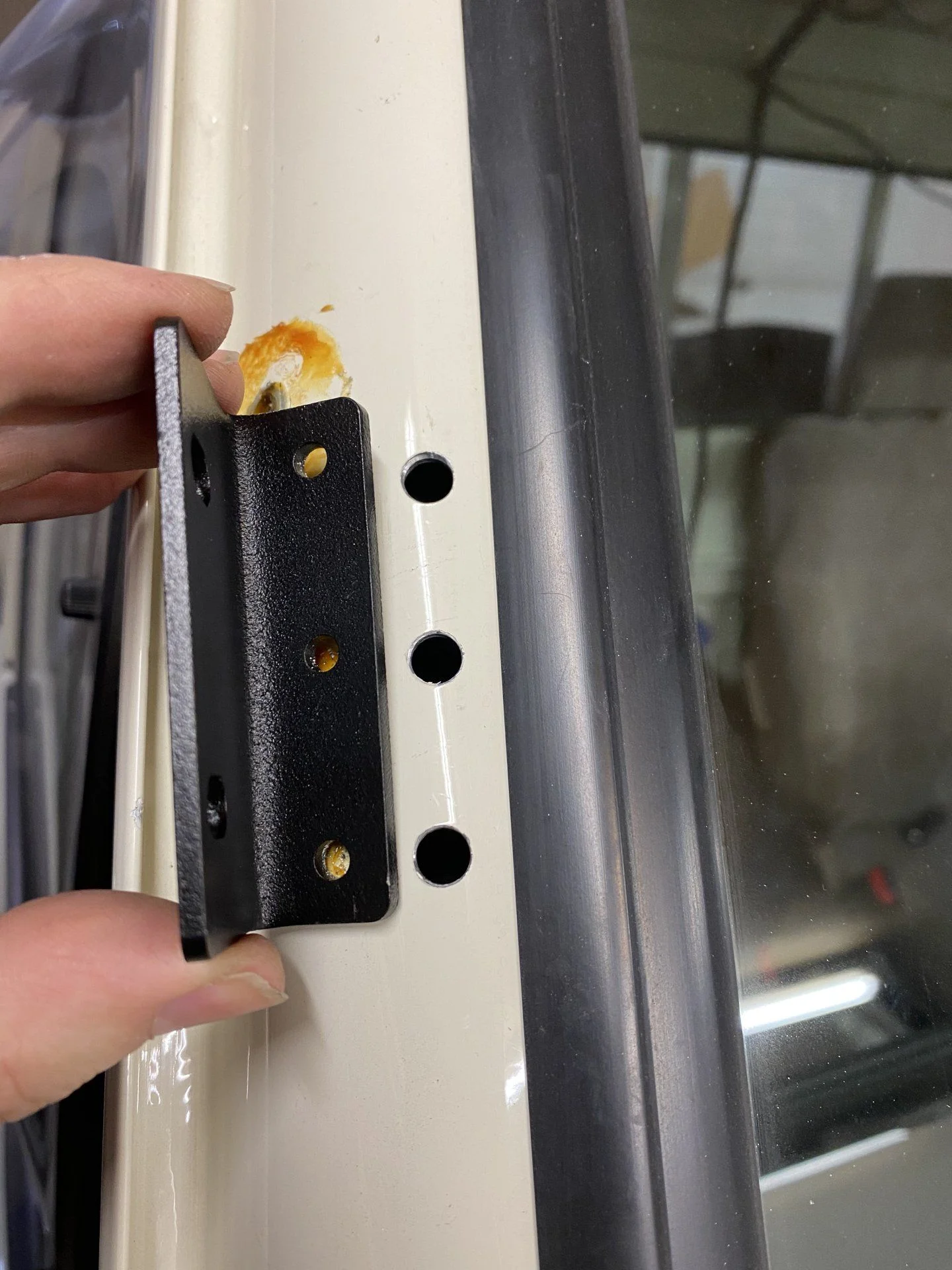

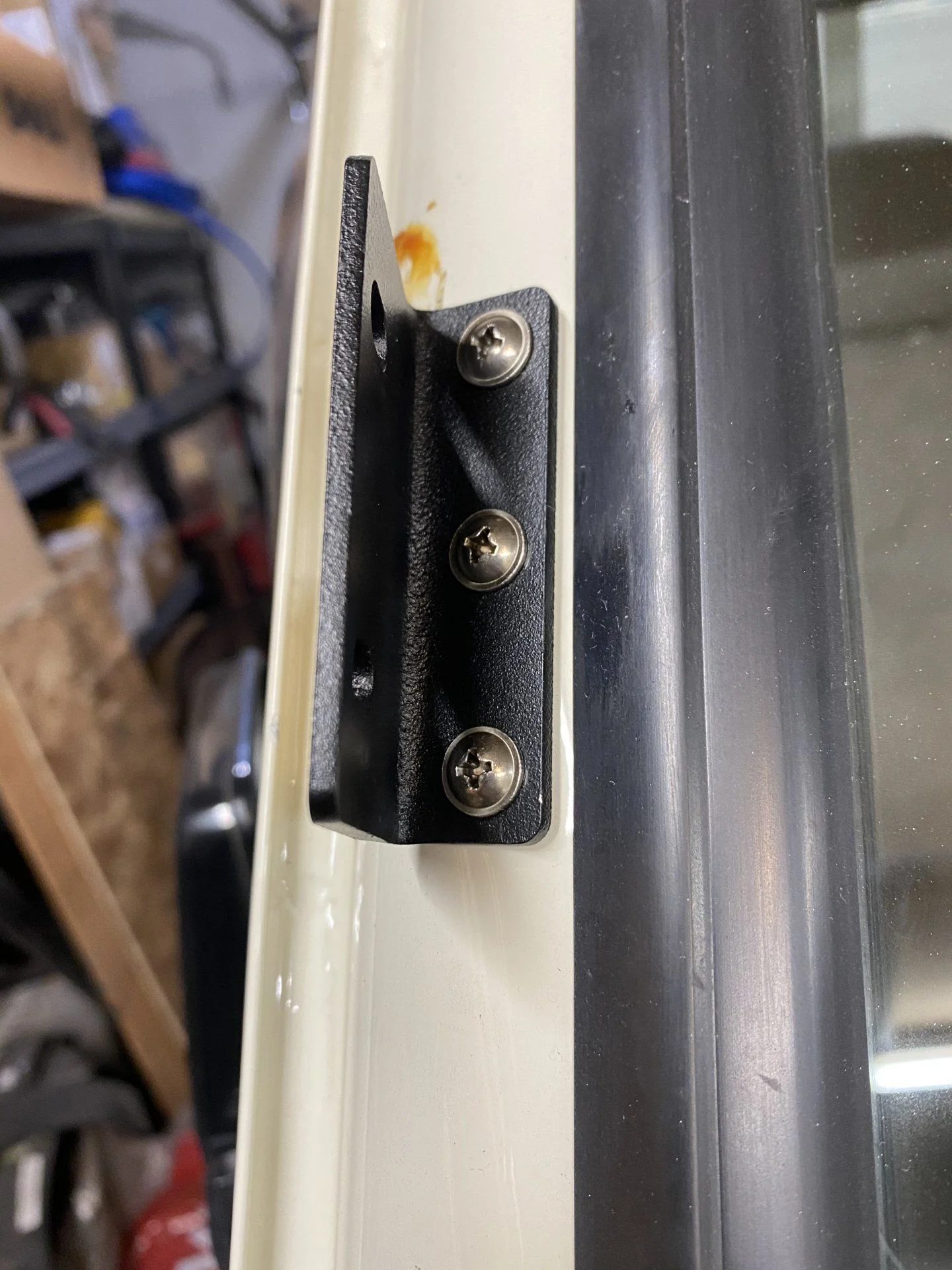

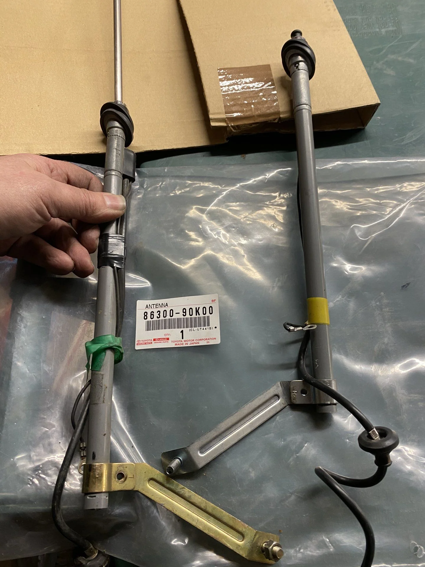

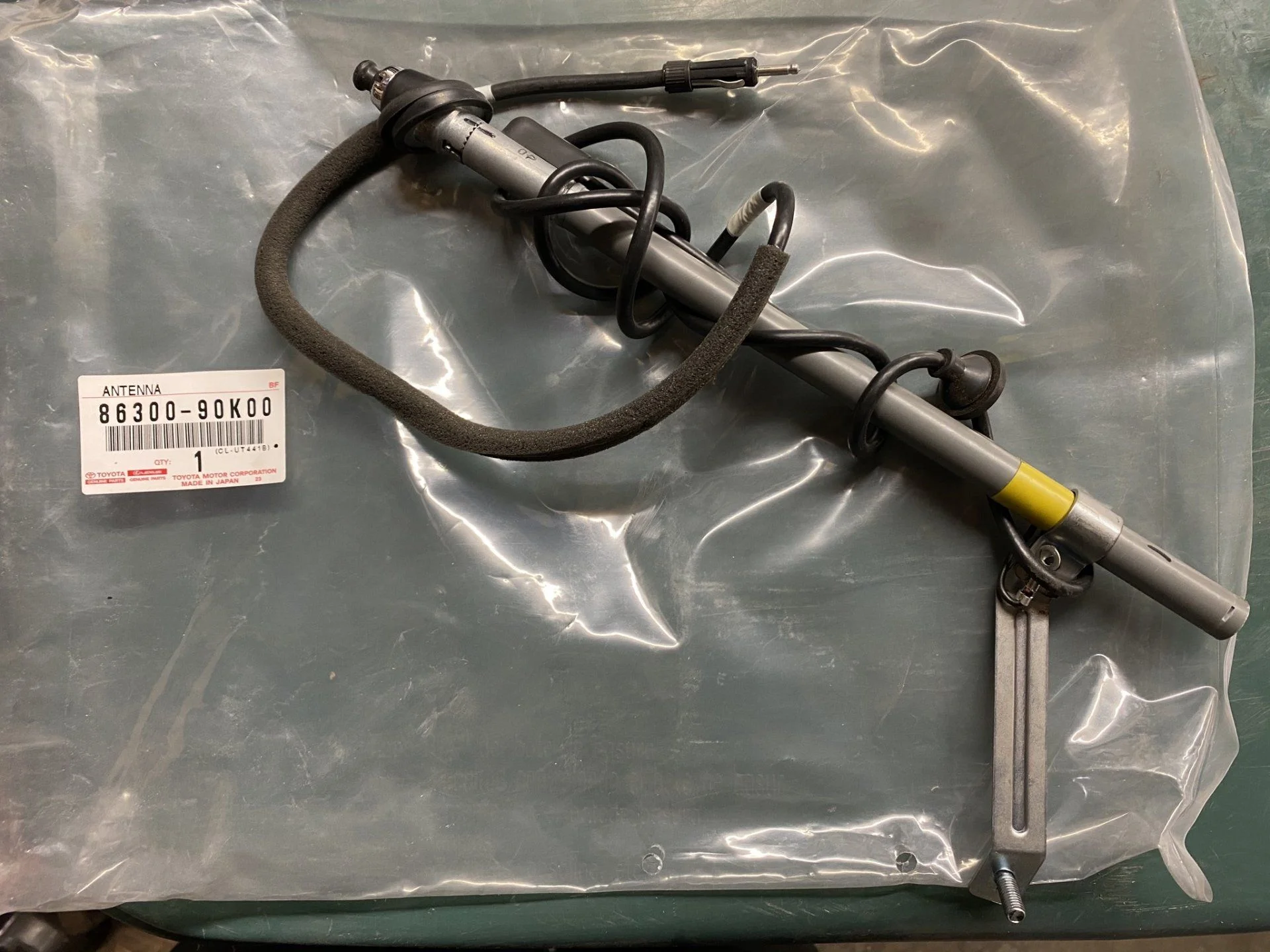

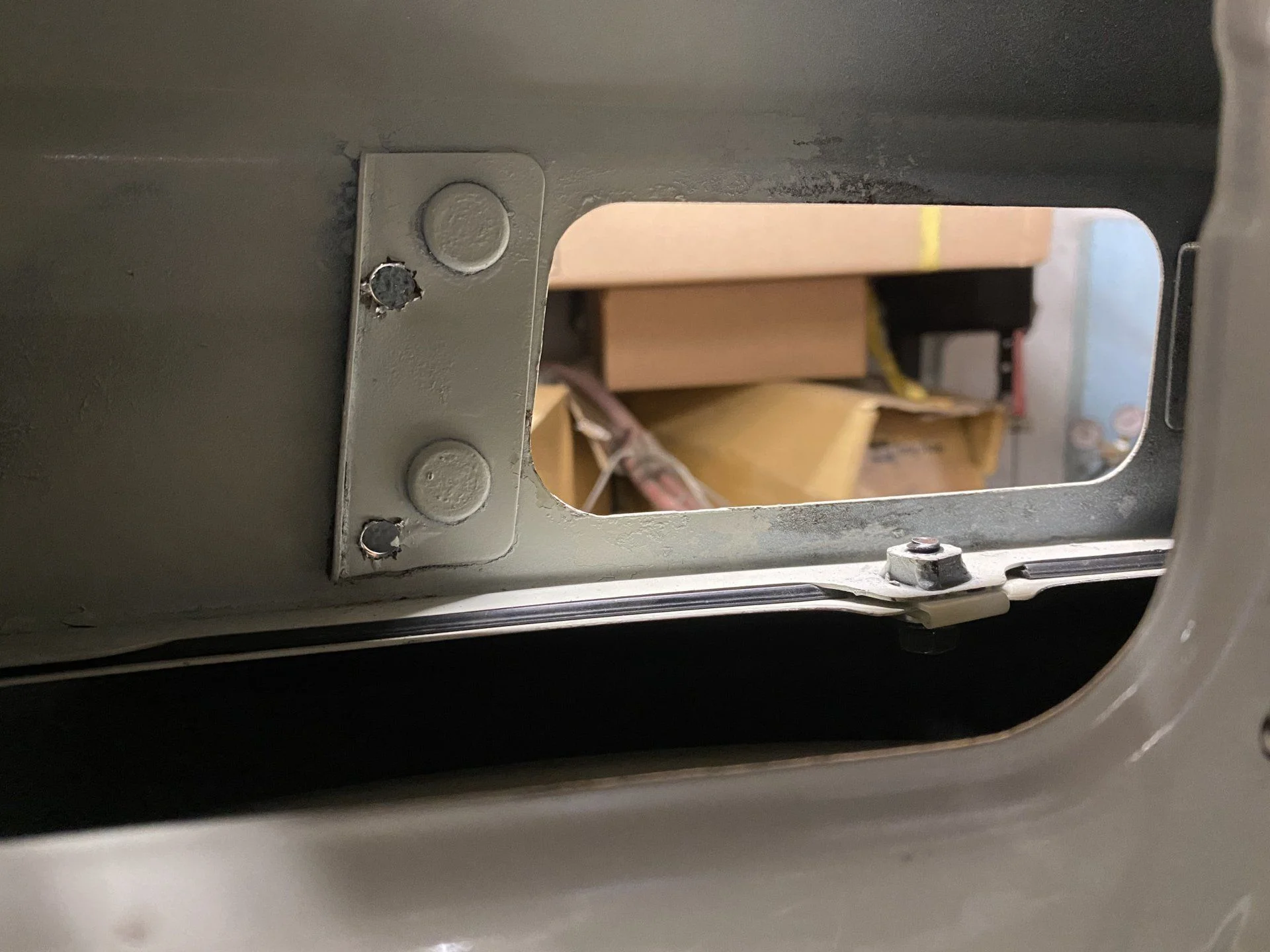

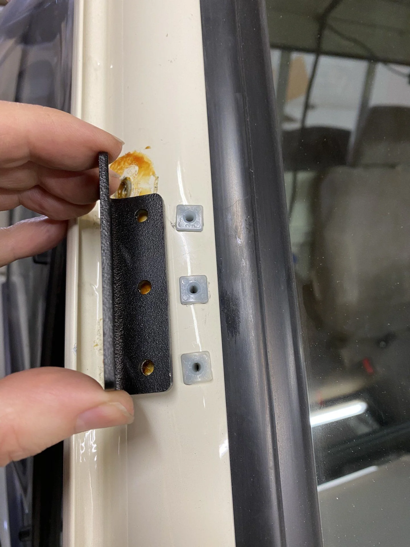

Got a little package from Steve Jackson, thanks. The old antenna from the BJ70 I had was kinked and been wanting to replace it and put it in the ute. In the first picture you can see the difference between a rhd and lhd antenna. You have to change the foot piece. Didn’t spend any time trying to figure out how to adapt a rhd one to lhd since I had the old antenna. Sure was fun installing that without loosening/removing the upper fender. Hopefully will not have to do that again.
The bolt on the arm needs to be reversed on the rhd arm.

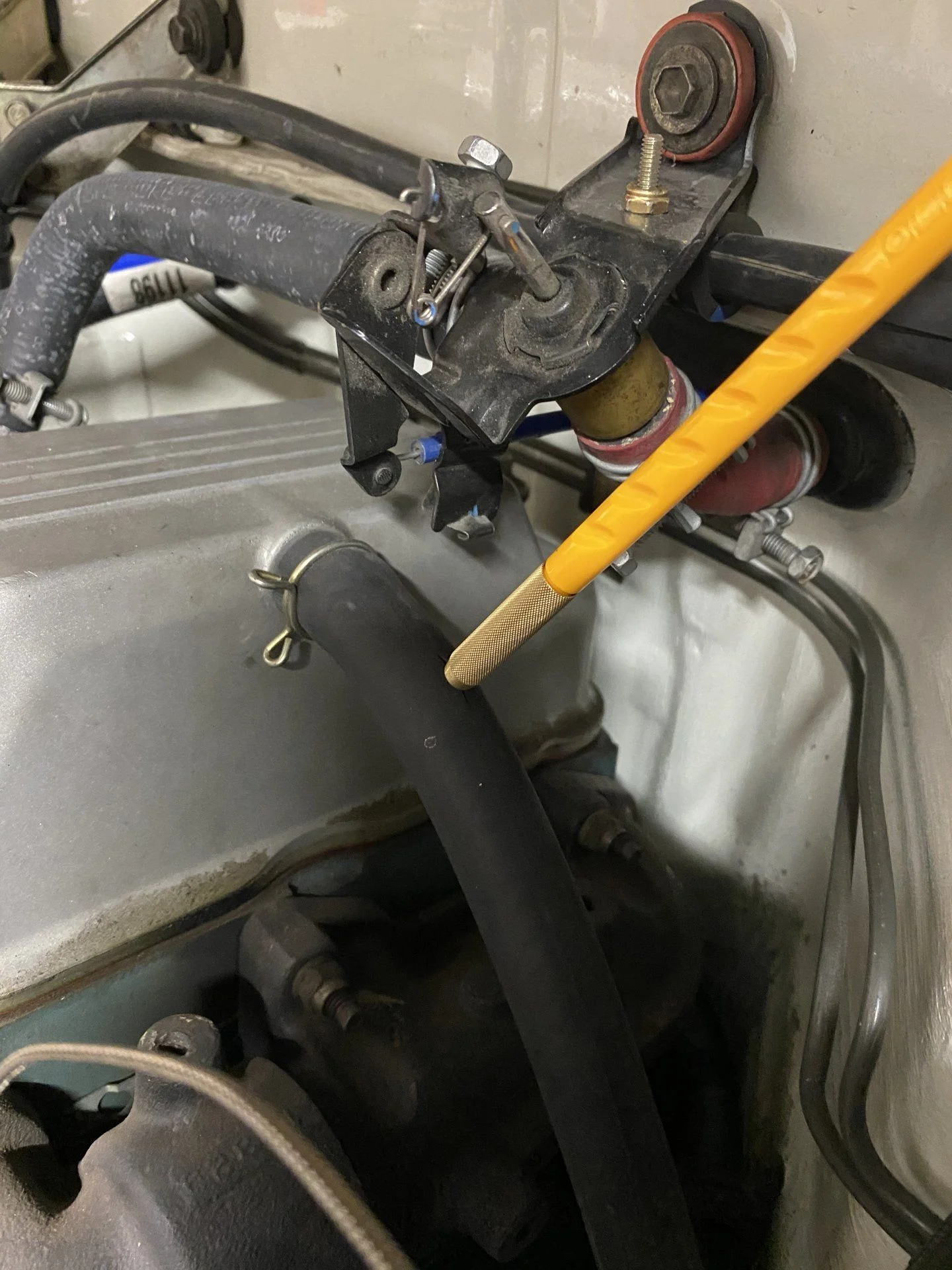

For those who plumb the crankcase breather overboard and live in cold climates, consider doing this little trick used in aviation, cut a slit in the hose close to the crankcase breather outlet. This will provide a relief if the hose freezes closed.

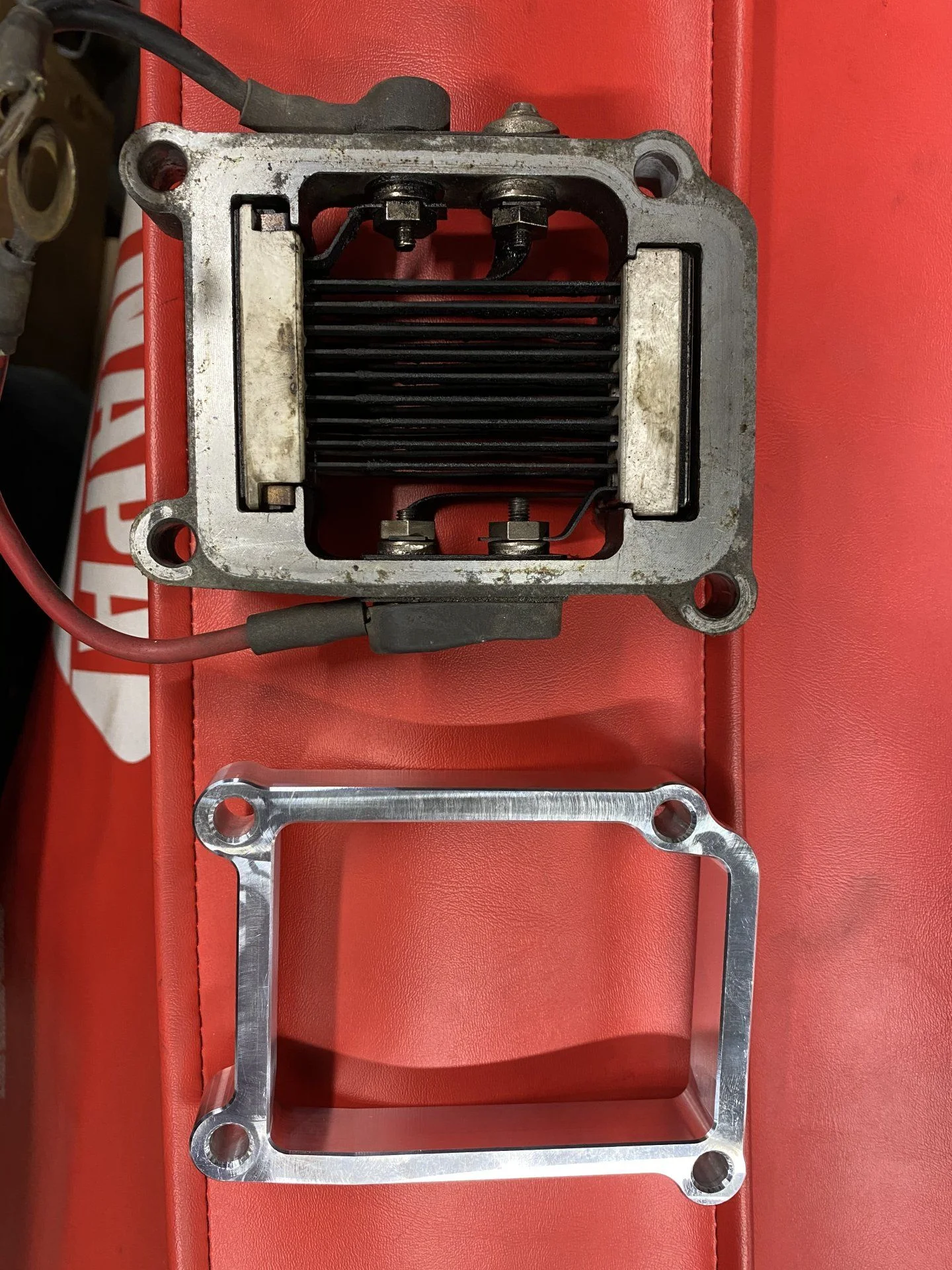

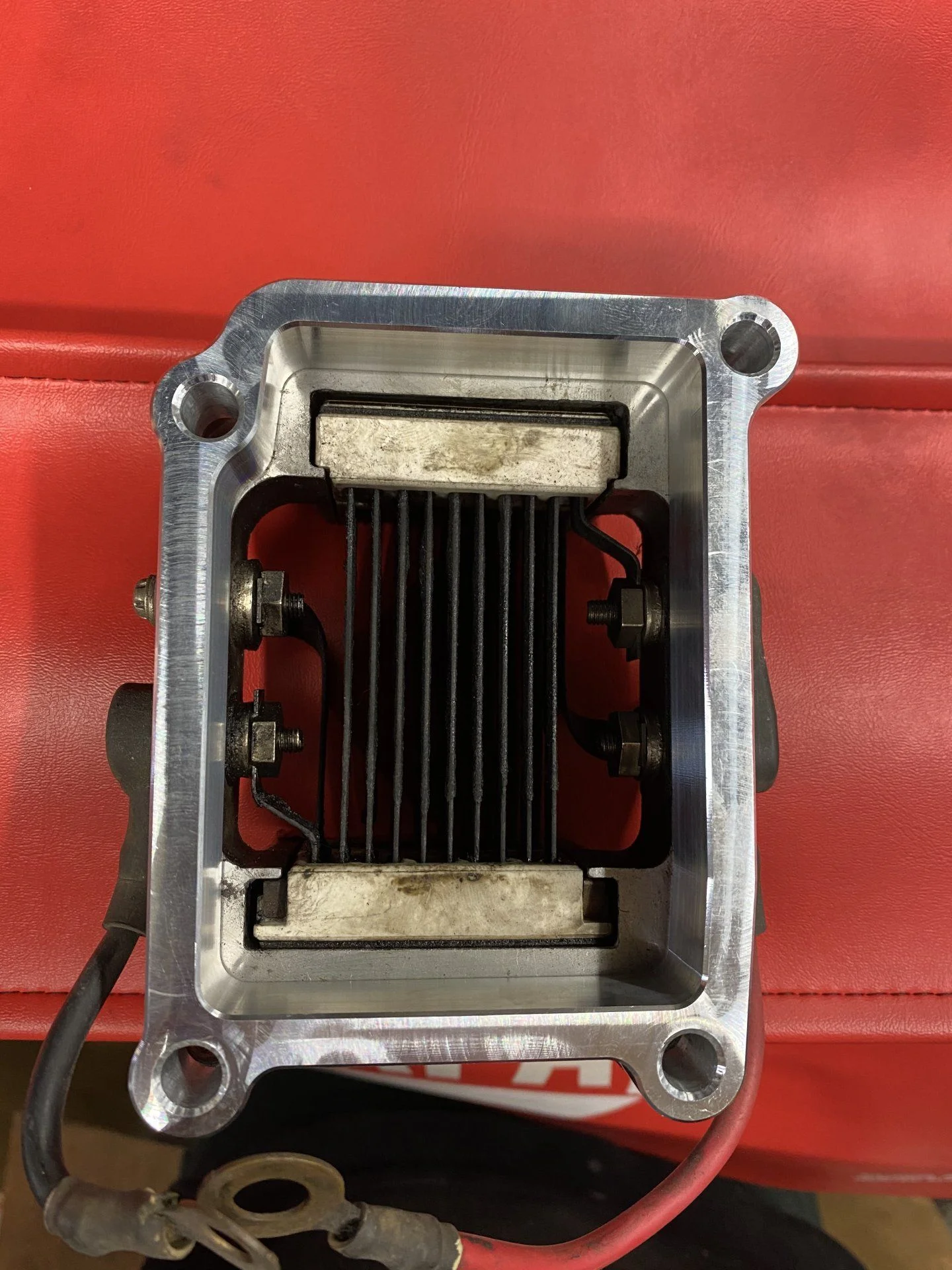

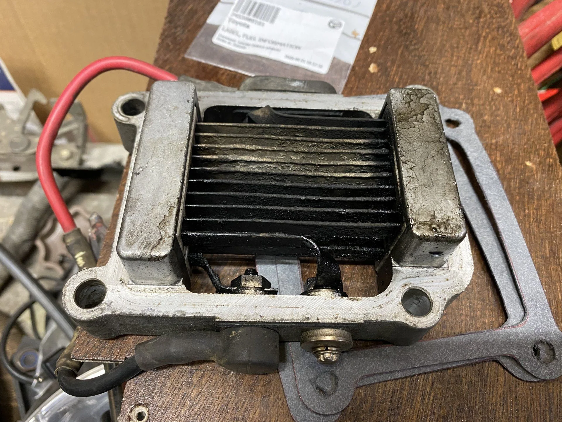

Replaced the 12HT grid heater with a aluminum unit made by one of our members on here(ukaviator). You can see the difference in opening between the two. Took it for a drive but my but dyno didn’t really register any improvements, but egt May have dropped just a tad. Nice unit.

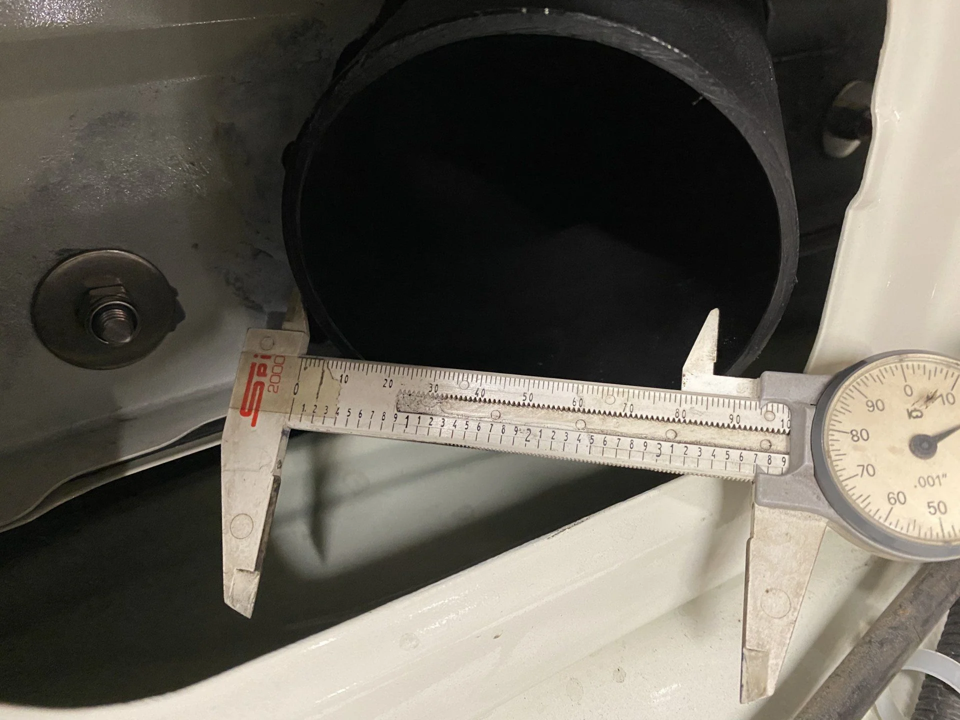

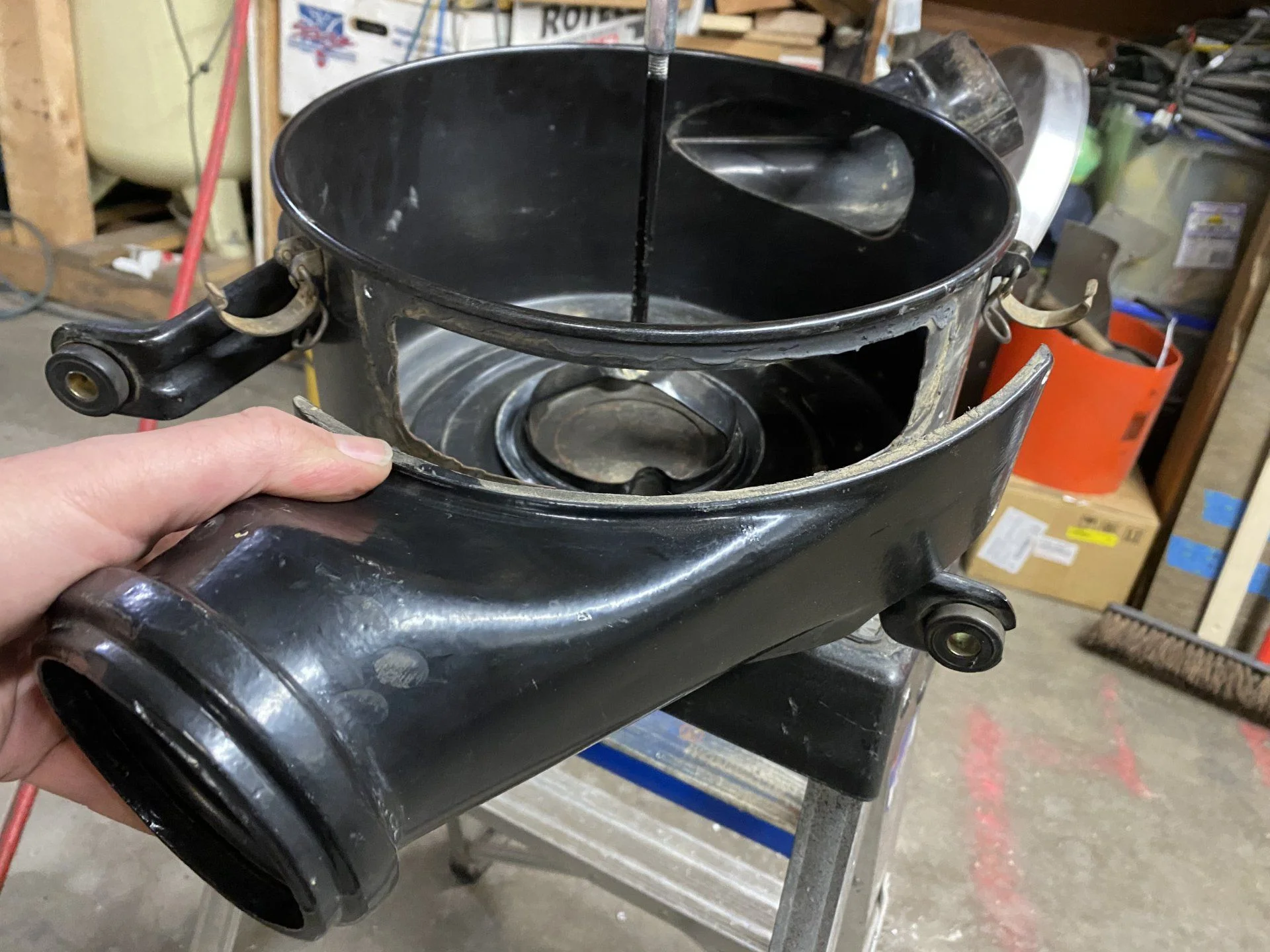

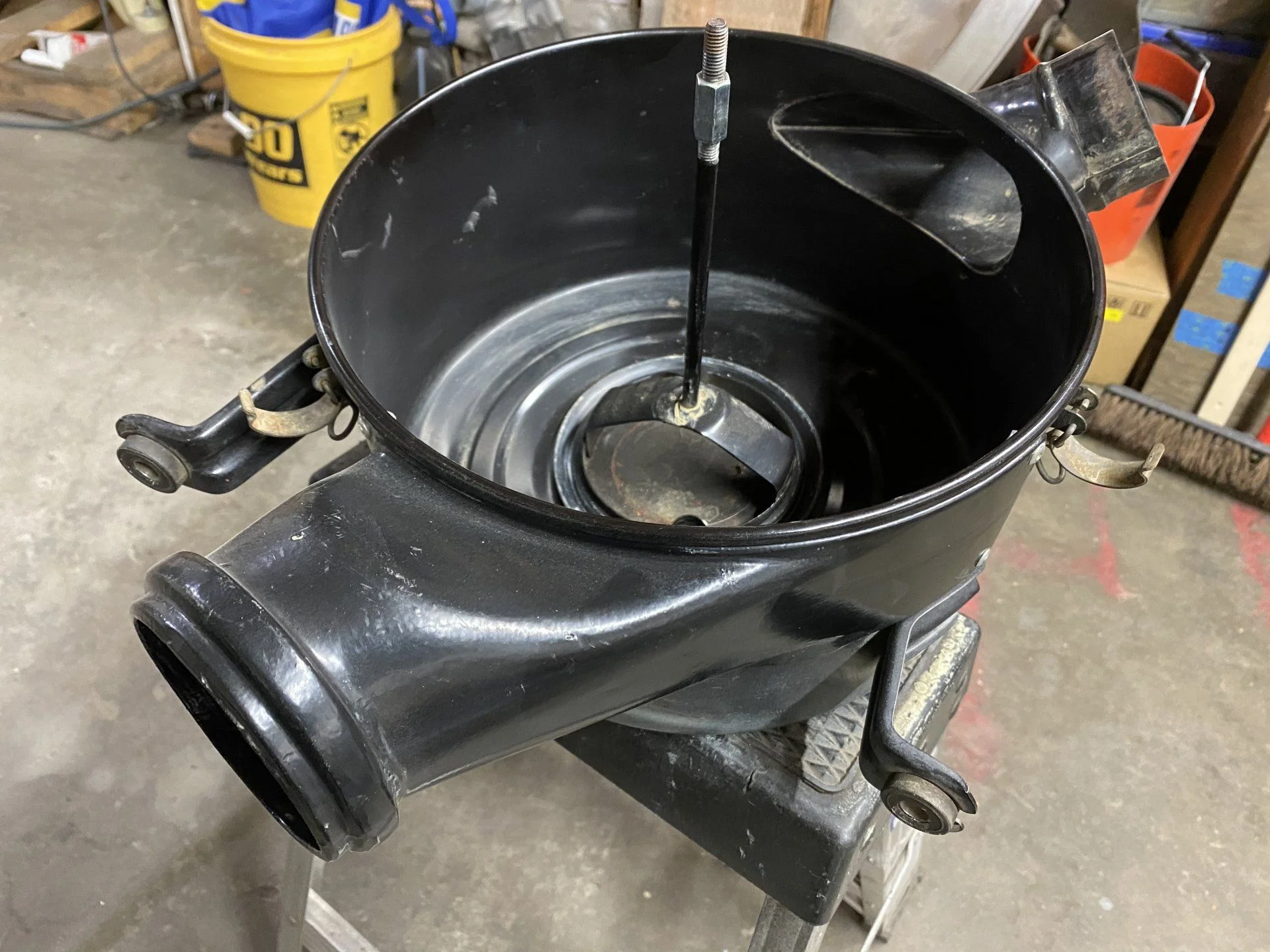

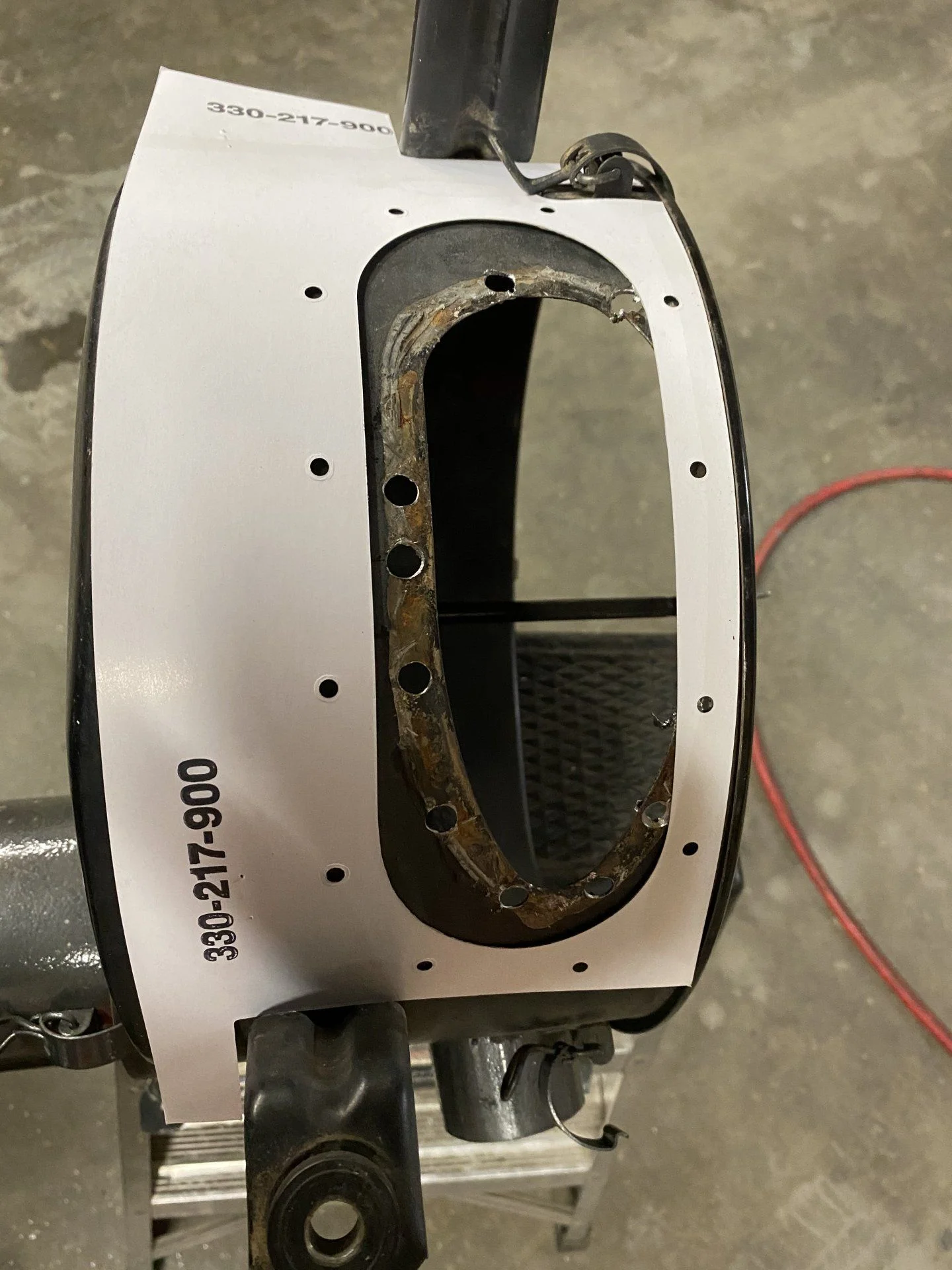

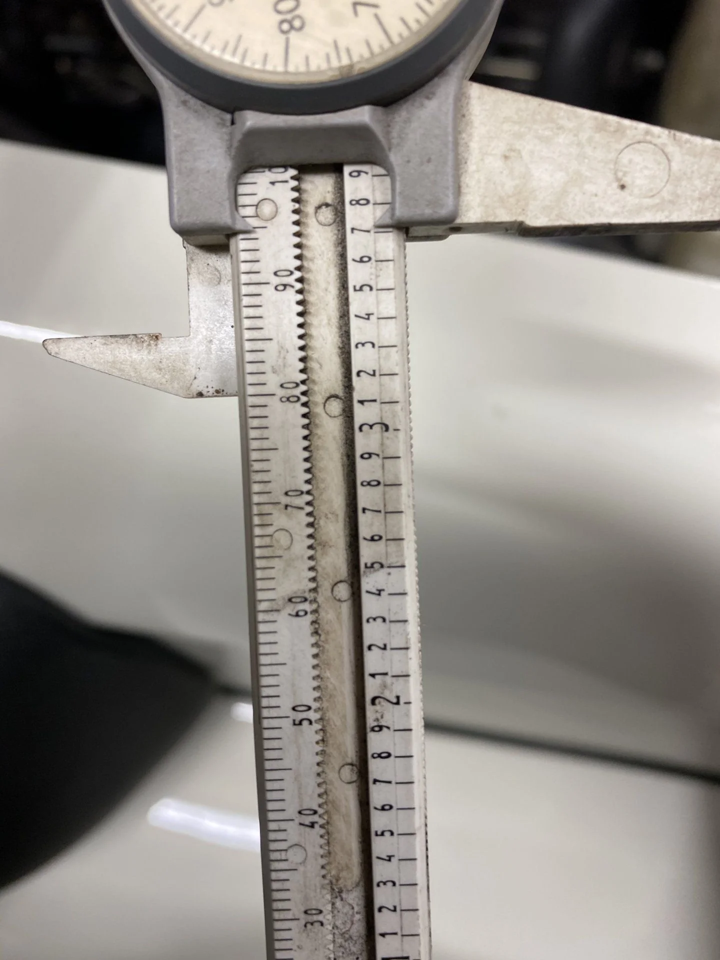

If you have been following along you will remember me coming to the conclusion that I need more air intake (size). The 3” intake I made out of 3” exhaust pipe. Was a bit of work and definitely heavier than the factory plastic snorkel. Was going to build a 4” snorkel but decided to try the Safari Airmax which I was under the impression of being a 4” snorkel. I got the only one that was still in stock in the US - got through Cruiser Outfitters. Unfortunately the I.d. at the narrowest part is 3.7”. Oh well.
