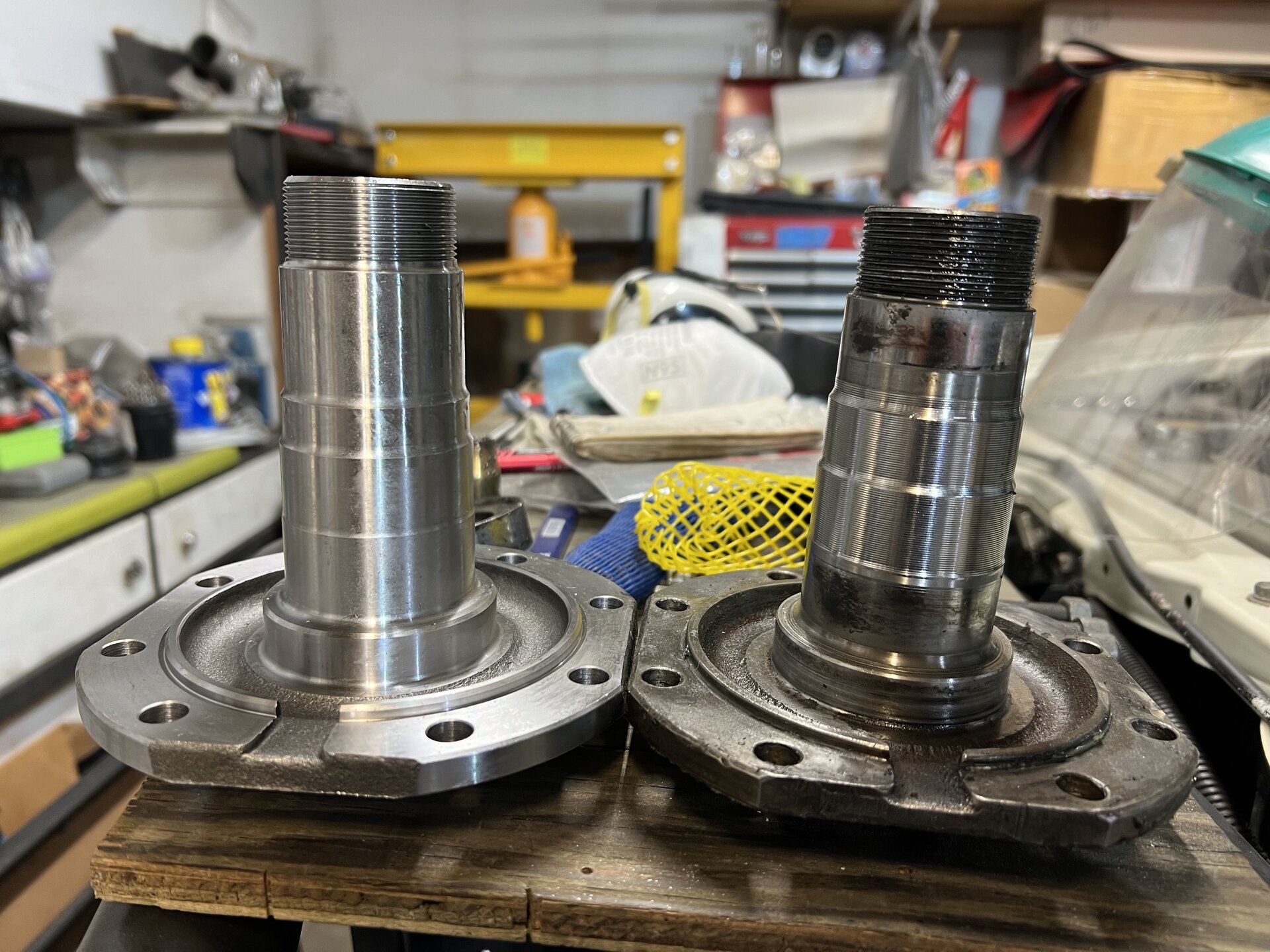

The locations of the shoulders in between the bearings doesn't make a difference, just a difference you'll see along supercessions as well as different manufactures.
So long as all the critical spots are the same (which it appears they are), you're golden
PS, yours were hammered and definitely needed to be replaced :D

What about the difference in where the outer bearings sit? To me that seems to be quite a difference 🤷‍♂️

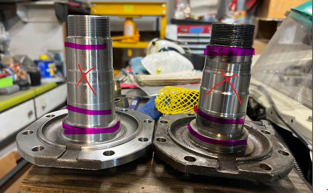

I guess I'm not seeing the difference you're referring to?
There is NOT a shoulder under where your outer bearing was running, that is wear on your old one.
The shoulder below (inboard) of the outer bearing is in a different spot, it's meaningless as it will occupy the space between the bearings and has zero impact on well, anything.
The only bearing shoulder is the bottom against the surface the seal surface for the inside face of then inner bearing. The outer is located by the wheel hub itself and there can be variance. I'm 100% confident it will install and function 100% the way it's suppose to.
Did you look at the tape measure pictures? If I understand you you’re saying that where the outer bearing sits doesn’t really matter as the hub hold those in the proper position?
Yes, I'm looking at the tape measure, but it means absolutely nothing because that is obviously not where your outer bearing has been riding for decades.
Look at where the outer bearing will actually rides when it is inside of the wheel hub (red arrow below) Much higher than when you just drop it on.
And the new spindle has MORE range for the outer bearing to ride on the spindle, again which is ONLY dictated by the wheel hub. Install it.
