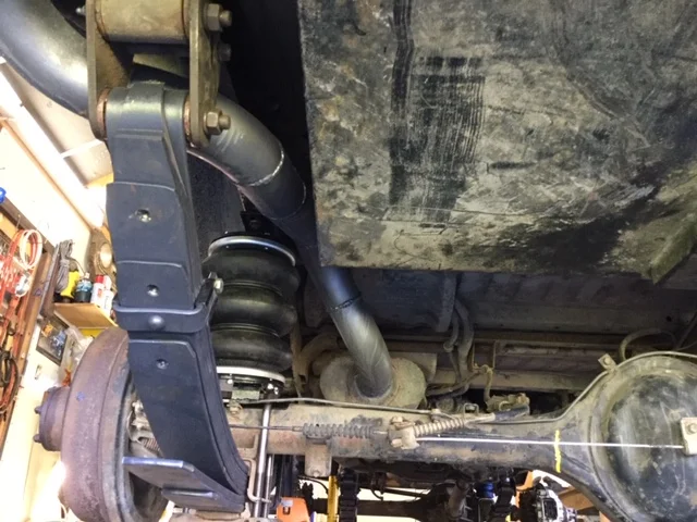

Look up BOSS airbags. Best way to pick up the back end. Least expensive. Easy to do.
No modifications needed to anything else. I have OME lift with heavies, so I got the 3 bulb
airbags. I’d recommend for you the 2 bulb airbags. Do a Search here on 60’s forum there is
a very comprehensive thread. Not only lifts your back end, it will improve handling since you
aren’t dragging your back end low. A pic of mine with heavy springs.
Nice, how do you like them off road? They don’t feel like you’re riding on bump stops? Or do you mostly deflate them for driving off road?
Never deflate airbags and run them. It will damage them. Because these are 3 bulbs and only get pulled about 2” max on spring extension I run 15 psi at most with a fully loaded truck. That’s 38 gal long range tank plus 15-20 gal extra in cans, 10 gal water in cans, tools gears etc.
Running around town getting groceries I run 3-5 psi. Offroad they are a dream, no bouncing or rear end kicking. Speed bumps at speed-well, you are on your own!
I was skeptical for years, but on a trip up north late one year I picked up 2-300 lbs of mud up under the rear bumper. It sagged so bad the inner fender wheel well edge cut the top outside of my tires. It was kinda scary. Now it doesn’t matter, the truck stays level and handles like it should.
I also replaced my front bump stops with SUMOSPRINGS blue. They are kinda poor man airbags. But they really smooth out the ‘nose dive’ especially offroad because the diesel is heavy and sometimes a bit of forward motion is necessary. Can’t always just crawl.
I’d suggest to buy SUMOSPRINGS but they are probably more than or equal in price and just more of a helper than a solution.
