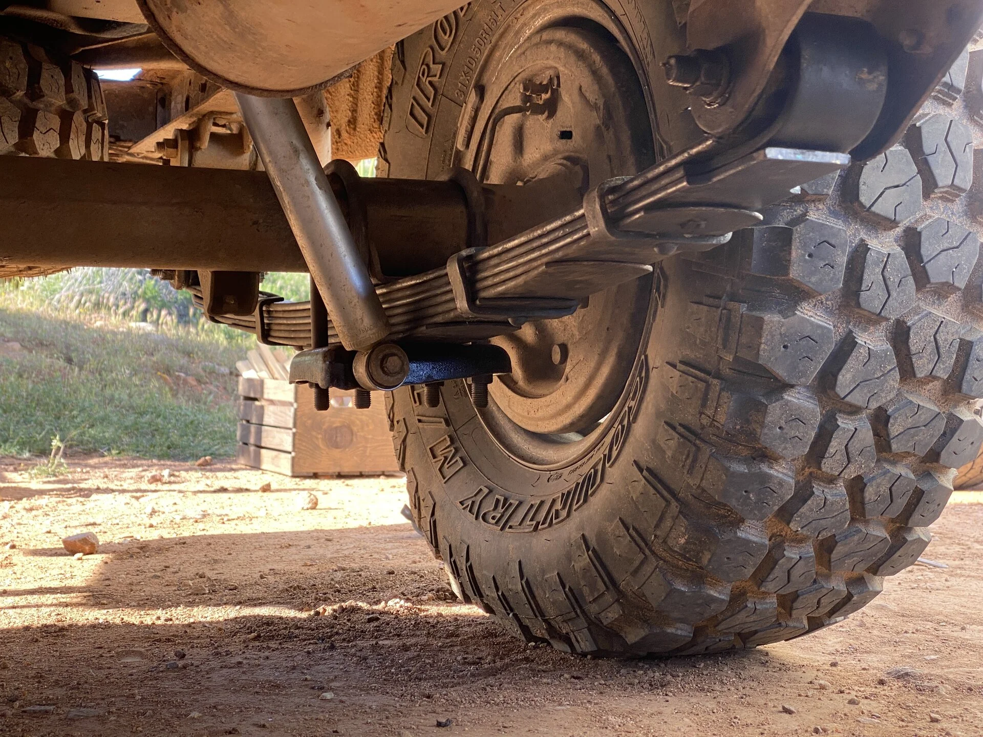

For anyone curious here's a photo showing how flat those springs from General Spring were:

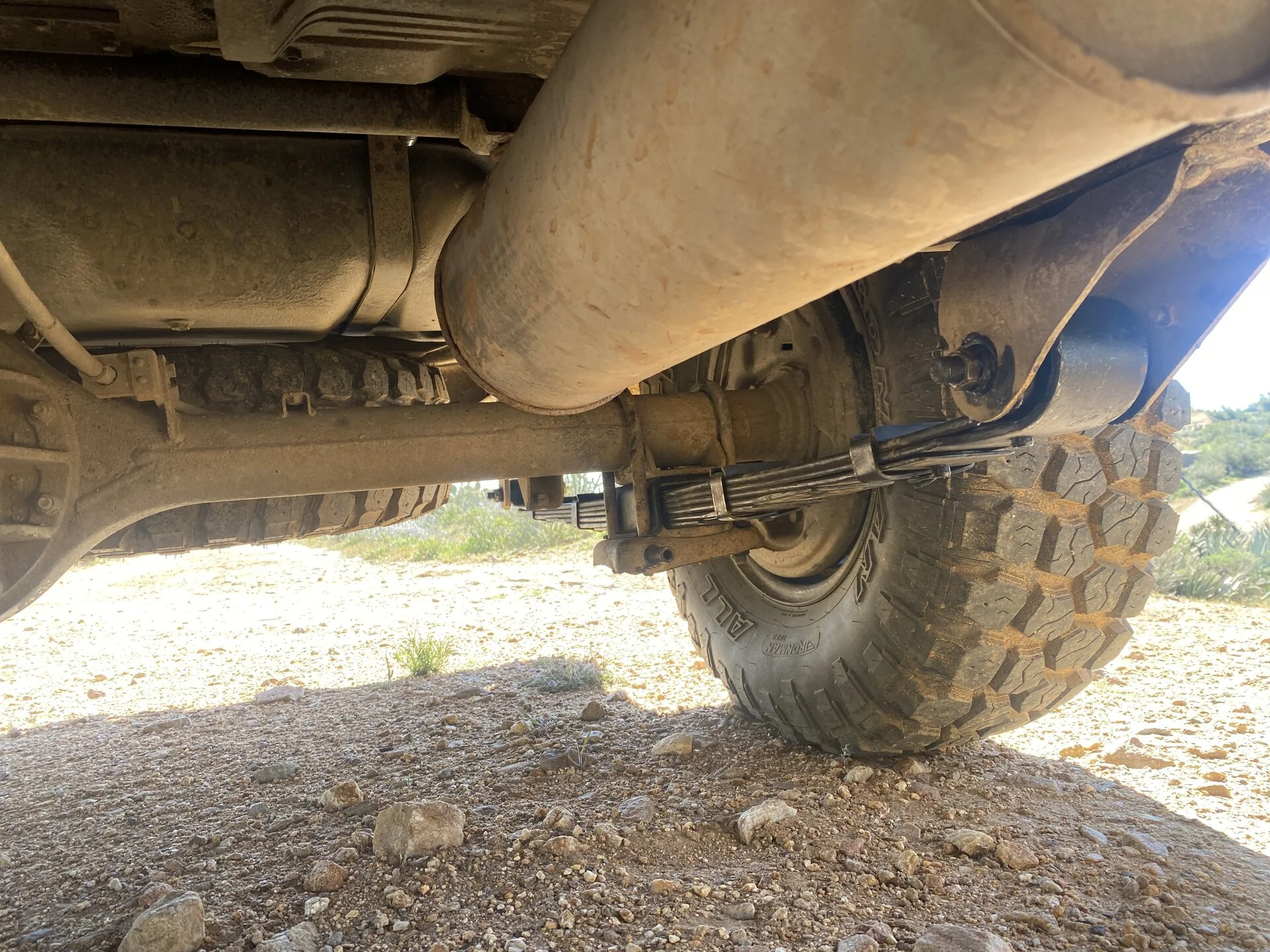

And here's a photo of my original toyota springs with the OME leaf added:
Much, much better.. Just gotta cut the excess threads off the u-bolts next.
