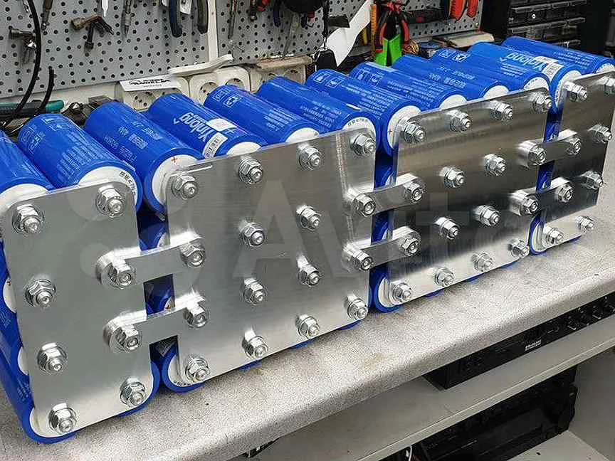

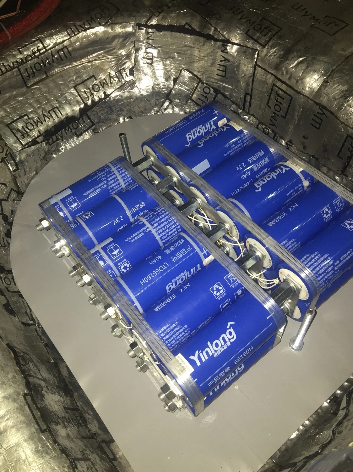

Complete new batteries for my rig.
Lighter, smaller, better.
It is a lithium titanat 45Ah 66160 batteries.
Buy new from china.
Weight of 12 pieces is a 15,5 kilograms. Weight of 2 stock 105d31r batteries - 45 kilograms. -30Kg from front of car.
5 hours balancing

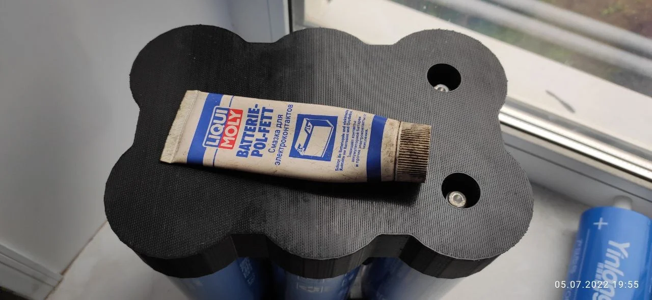

Some aluminium connecting buses, some lube
And battery ready for install

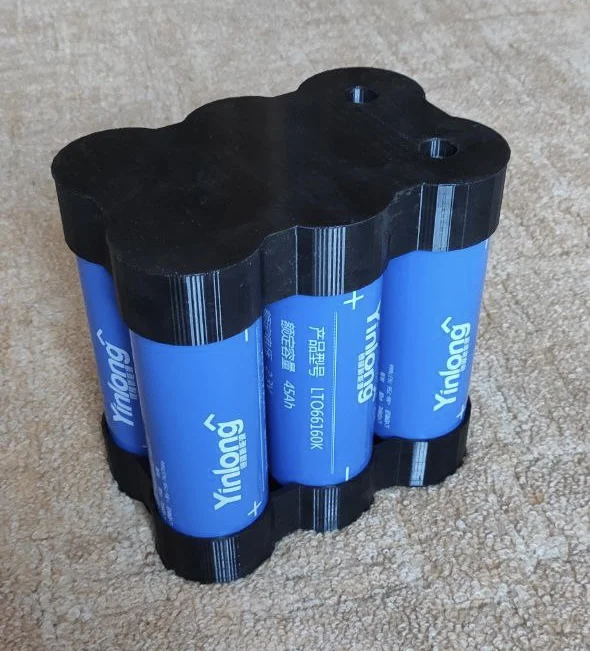

There are many ways to make complete batteries

It’s a main power on Hdj80 twin batteries setup

30000 cycle of recharging, works from -35’C to 60’C, can give more power then AGM, calcium and other regular batteries.
I pay for 12 pieces 490usd, 20 usd for cases and 10 usd for aluminium bus.
Good quality 105D31R/L batteries costs about 230-250 usd in our local shop.
Price of titanate is not much more. But less weight, more power, more reliability.
Put batteries under the hood.
So little and so powerful.
I think two batteries in a left tray is a better way.
So. It’s amazing.

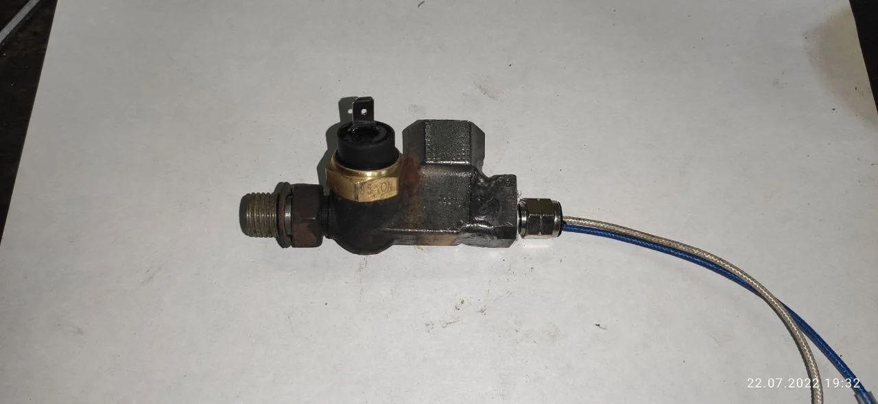

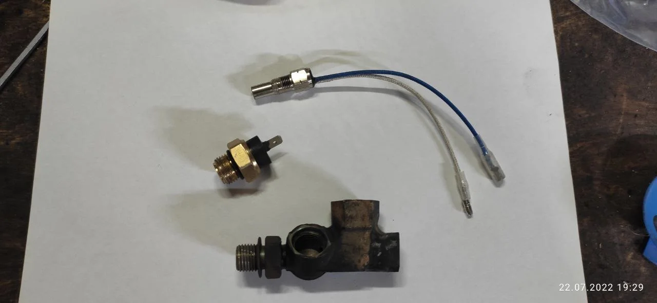

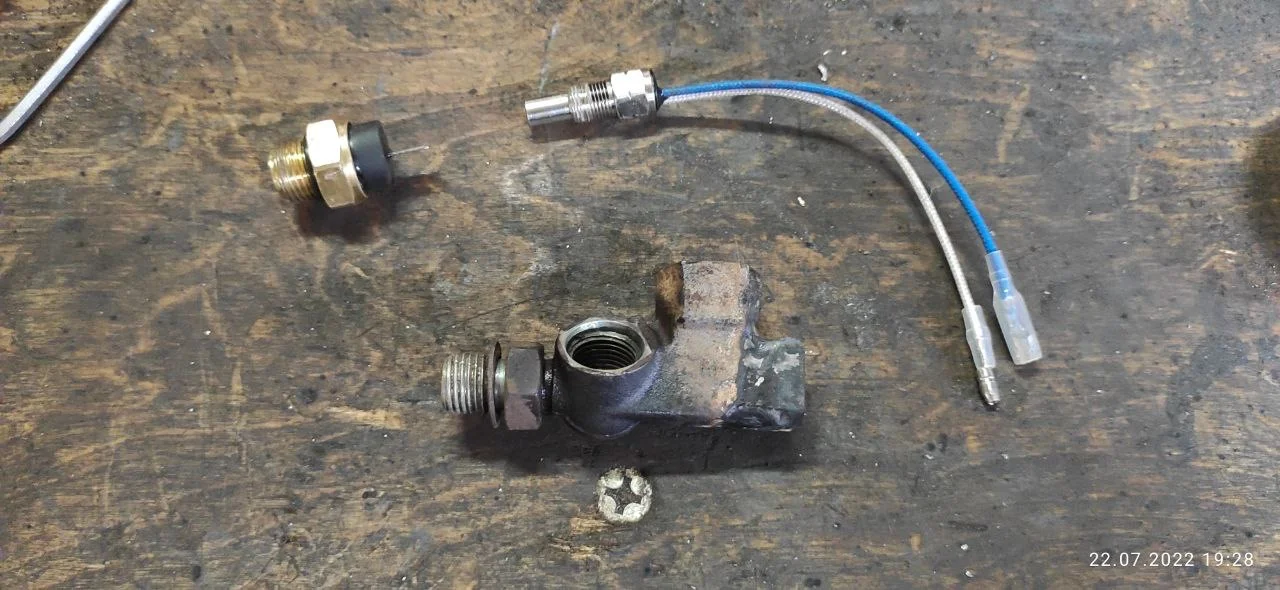

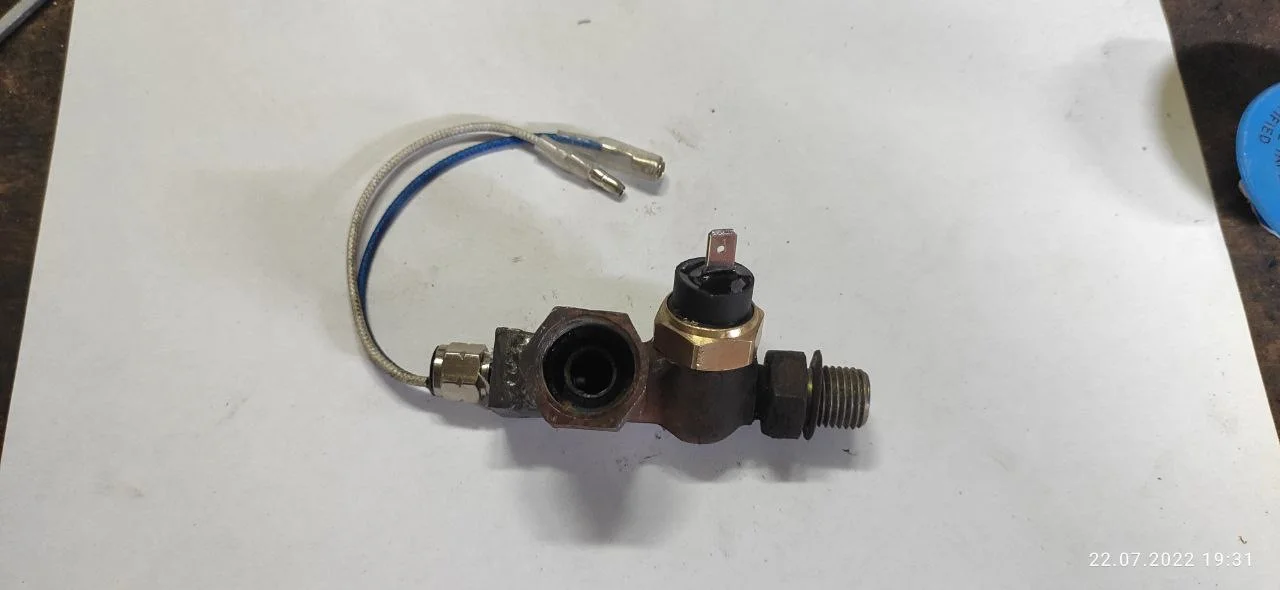

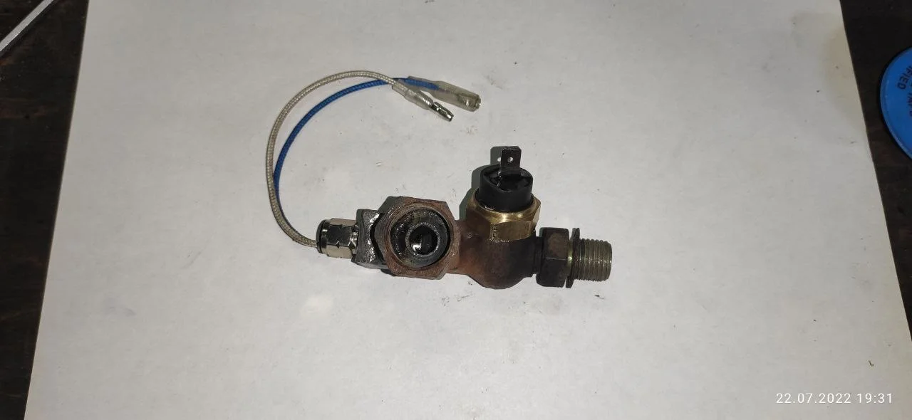

Modify a442f oil cooler tube union outlet. Add trans temp port and install new 85’C temperature switch for trans cooler fan.
