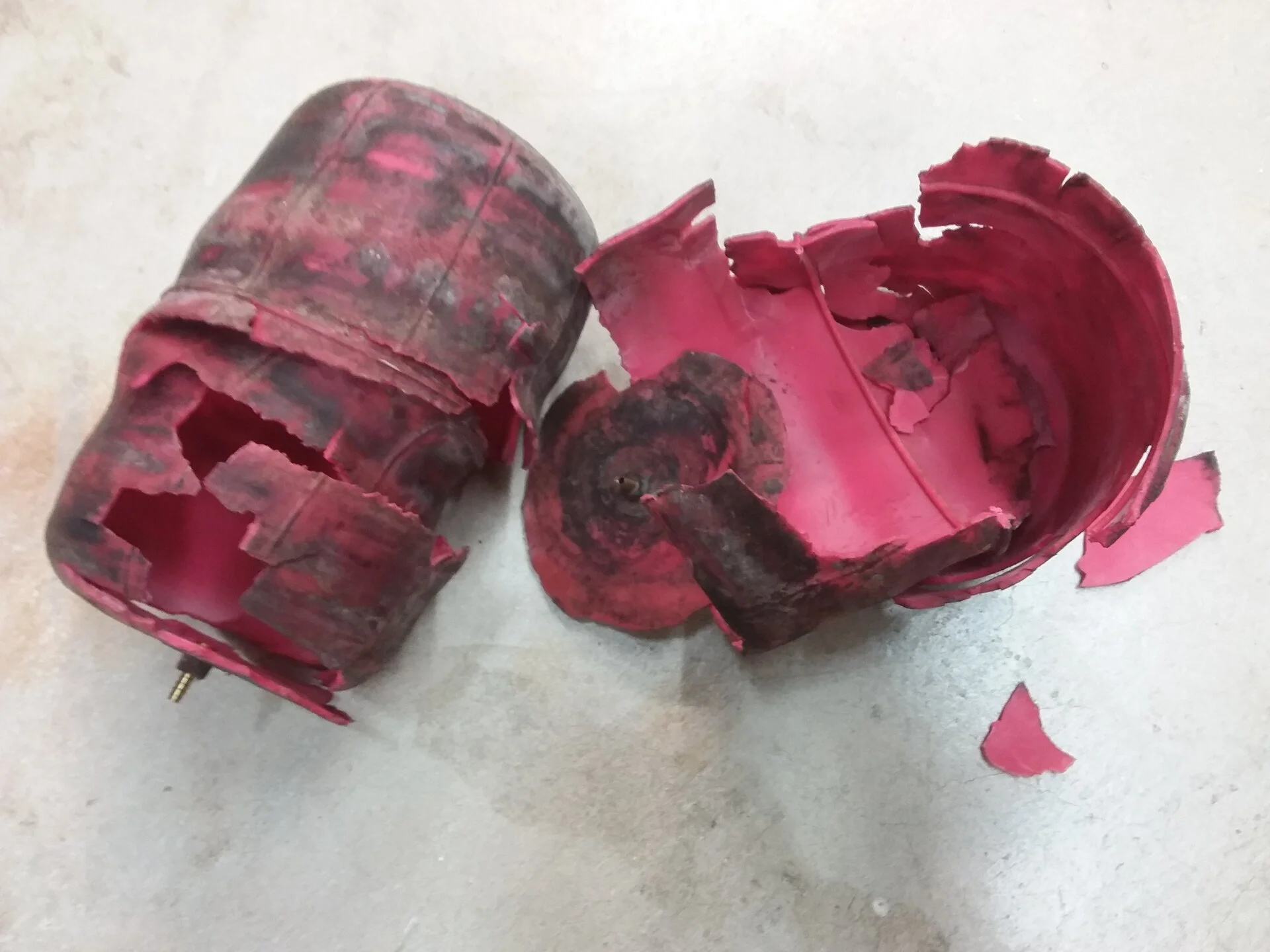

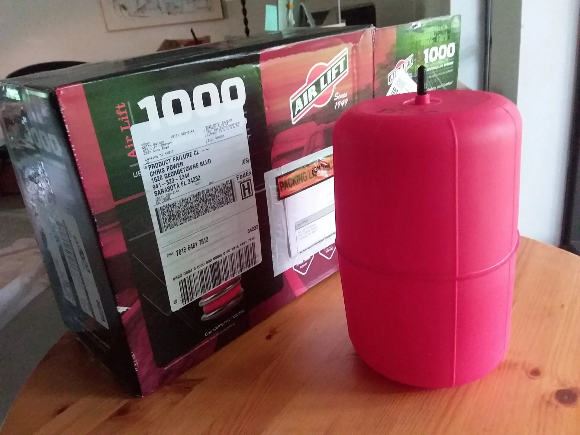

I have the standard version 60728 with 866 springs and 1" spacers. There is a ton of room above the bags, even with stock springs. Seens like they should include a longer one as standard for 100's rather than this one. I actually received a replacement set in the mail today since the original pair installed about 8 years ago totally crumbled to pieces. Thank you Air Lift for your lifetime warrantee
I have the standard version 60728 with 866 springs and 1" spacers. There is a ton of room above the bags, even with stock springs. Seens like they should include a longer one as standard for 100's rather than this one. I actually received a replacement set in the mail today since the original pair installed about 8 years ago totally crumbled to pieces. Thank you Air Lift for your lifetime warranteeView attachment 3385093View attachment 3385094
What did you do with the rubber bumpers in the spring? Did you leave them, or did you have to cut them? Do you need a puck with your install?
OEM Rubber bump stops were removed, per installation instructions. No puck was used.

Good to hear they stand by the warranty. Given you've gotten 8 years out of them and are replacing with the same set, is it safe to assume they have been doing what then need to prevent sag even though they have a big gap over the bag? Sounds like a similar setup to me except I only have 15mm spacers. Even with the heavy springs I get a lot of sag when loaded up and towing.
They are meeting my needs at maintaining height but I am actually slightly stinkbuggy to begin with when empty and no air in the bags. If I were to buy them again I would investigate the longer version hoser mentioned just for more flexibility.
