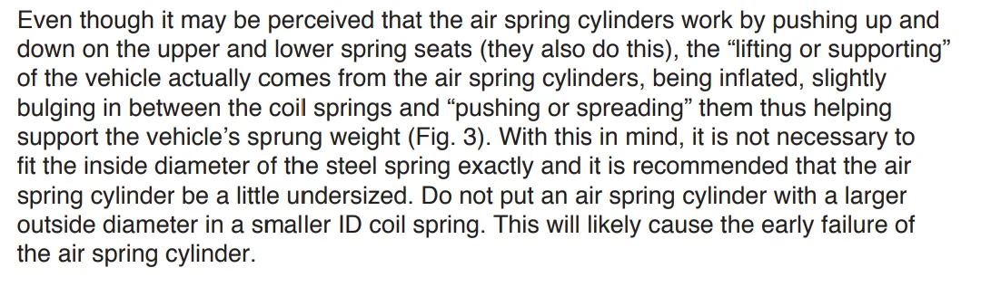

Well it turns out I was wrong in my thinking, and it's ok if the bag is not the full length of the coil. The excerpt below is from the installation instructions for the Air Lift brand universal fit kits. I had always thought the bags functioned by stiffening the springs via bulging between the coils wraps. However, reading other opinions on the internet convinced me I was wrong and it was about the height of the bag. Apparently this is another reminder not everyone on the interwebs is true (shocking)!! 😂
Seems coil internal diameter is the most important factor for function. Height is important so the bag isn't TOO tall. Later in the instructions it states it is better to have an under-sized bag, as over-sized will fail prematurely. It also states that the plastic pucks are there to protect the bag ends from puncture, not to "fill in" gaps. That likely explains why the universal fit bag (60925) that seemingly should fit based on measurements of the coil looks like it's actually shorter than the recommended bag for the LC. It comes with 2 pucks for each side, to protect the two bag ends in case it touches.
Given the recommended kit doesn't appear to come with any pucks, I'm now considering if I should get the universal option for the added protection with the pucks.
