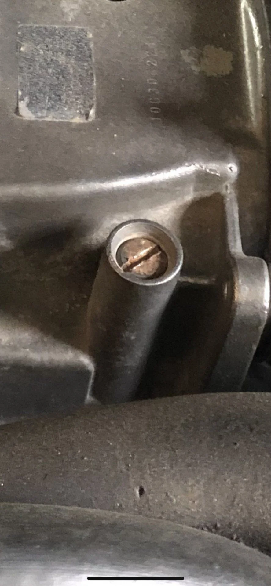

Does anyone know the function of this screw? It is similar in appearance to the Golden Screw on the throttle body, but the FSM does not mention its function, just identifies the chamber that it is sunk into as the "air by-pass passage." I also find only one thread on Mud that mentions it. When I bought my truck the screw was not seated all the way down nor screwed all the way out. I have read that the throttle body Golden Screw is not designed for user adjustment, just for factory calibration. Thoughts?
Context: I am chasing down a rough idle (which has become a high idle after the installation of a new fuel pressure regulator). The steps I have taken during the process are too numerous for this post.

Going to follow this thread. I've never messed with mine, but had always assumed it had something to do with calibration of the AFM.
I've read in the past that folks who have put bored out throttle bodies on have removed the AFM cover and actually adjusted the mechanism inside to compensate for the increased airflow. Had wondered if this screw would accomplish the same thing or no.

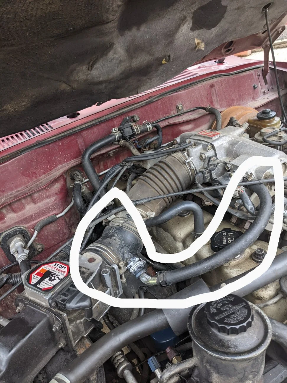

Your intake tube looks worse for the wear. the silicone on the nipple looks sus.
Well well....Ive torn my engine compartment apart several times and not once did I notice the screw you just pointed out! Learn something new everyday. That being said I doubt that is where you want to look for a fix.
Regarding the ability to adjust the brass screw in the TB....everyone does it. I do recommend installing a new O ring on it as the one thst is there is likely old and cracked and can let air in.

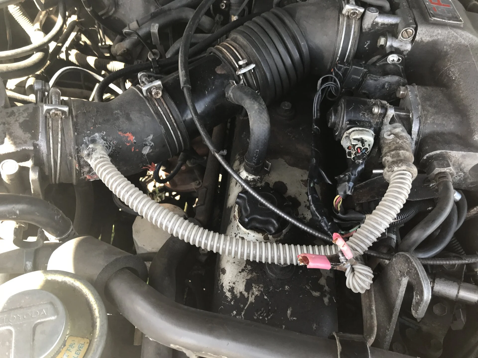

Not necessarily Toyota's name for them, but: Intake ducting & idle air valve supply hose
Where are you located? I may have one. But have you checked City Racer or Cruiser Teq?
Pretty sure one or both have.
Obviously I need the same part. Have been using a thin medical oxygen hose and lowered the high idle by clamping off enough to reduce airflow.
I would second what @RevISK suggested, but I'll also add that the factory tube is also completely unobstructed, so there's another problem there causing your high idle, whether it be a leak where your current tube is connected, or something else out of whack in your system. So if/when you find an OEM or OEM-like tube to replace it with and once you make sure there are no leaks there, be ready to continue chasing the cause of that high idle.
