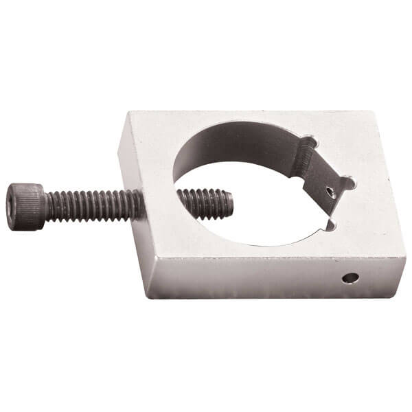

Another simple solution to keeping your nuts tight would be to use what's used in aviation, and race cars. Just buy the jig to be able to drill all your nuts for safety wire. Once those holes are drilled you just simply thread and twist the safety wire between each nut and tie them all together with stainless steel safety wire. You can buy this complete setup for less then 100 bucks.
Here's a Link to where you can buy a one pound roll of aviation grade safety wire. along with safety wire twisters, and the drill jig.
Better yet, drill the nut AND stud for safety wire. The prevents the nut from backing off and the stud from backing out of the knuckle. Torque to spec, and then tighten to align safety wire holes. Much like a ball joint or tie rod end cotter pin.
