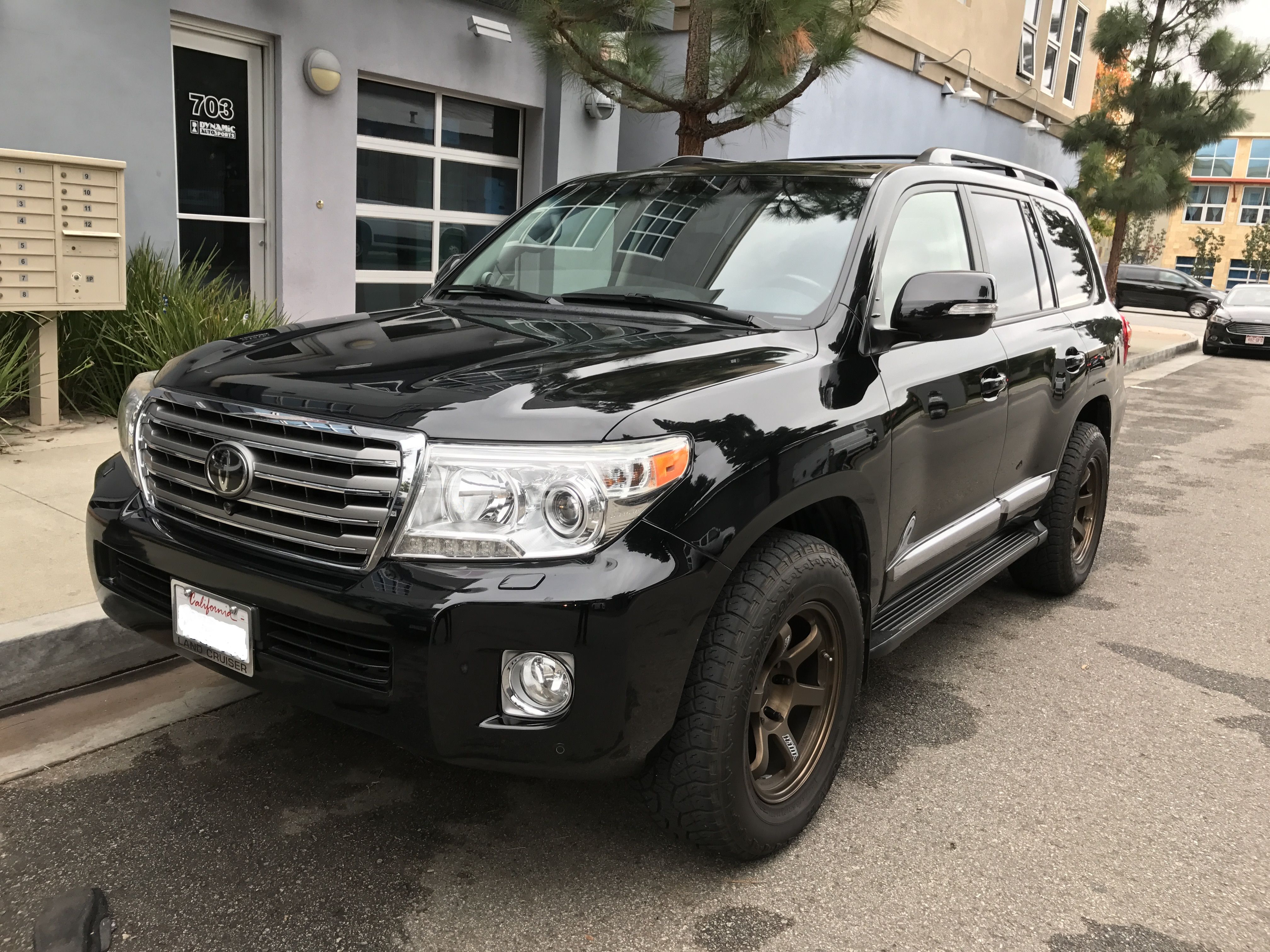

Just installed Method NVs with Falken Wildpeak ATW3s in 285/65R18. Very minor rubbing at full lock, but hope that goes away with strut spacers.
You don’t have a profile shot down the side of the SUV by chance do you? Just wondering how much the tires stick out pass the fenders... any trimming?
Thanks
It is very nearly flush. Tini protrusion. I had inner lining rubbing on full lock and only in reverse. I dremmelled that part of the lining.
Will those tuck correctly at full articulation? I don't have enough experience seeing how the axle and wheel travel in the wheel well when fully compressed to know, thus curious. It looks fantastic!
