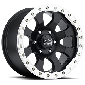

I like the Eagle Alloys seen here RWD/SUV Truck - Eagle Alloy Wheels MADE IN THE USA
