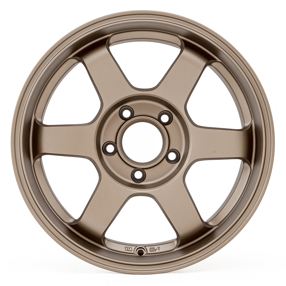

Anyone familiar with the Varrstoen VTX Terra? available in 18x9, 5x150. load rating isn't listed on their site...

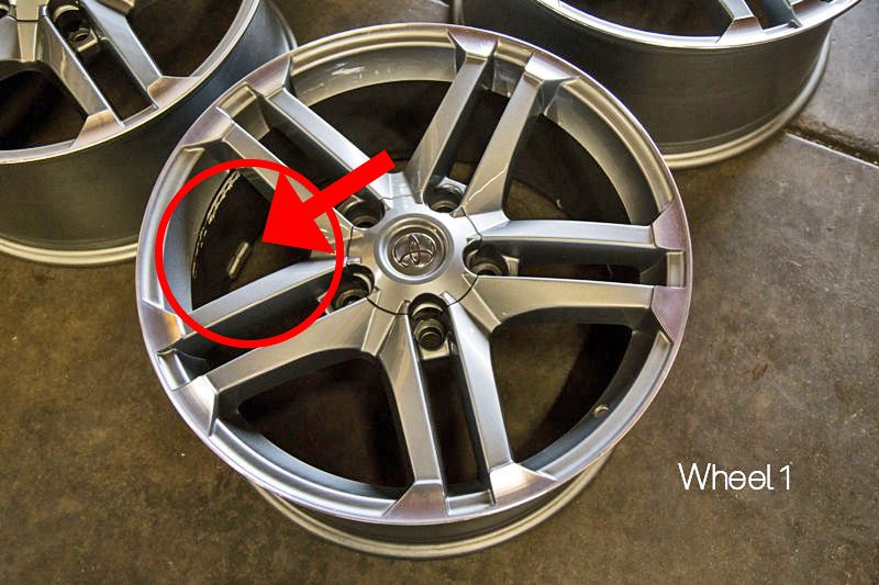

Listing states that the centerbore may or may be larger than the spec and may require a center ring, says wheels are blanks with lug pattern cut to order, and, if your pic is from their listing, then very odd to see weights on wheels represented as new (genuine or fake):

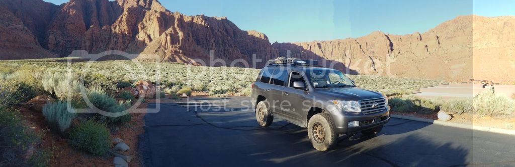

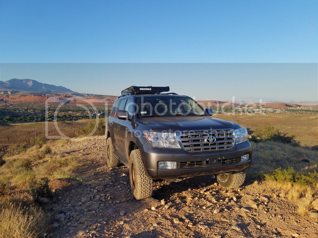

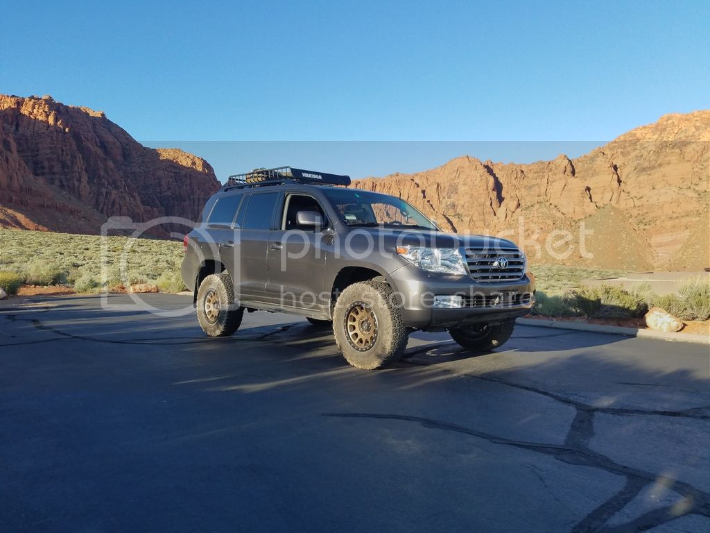

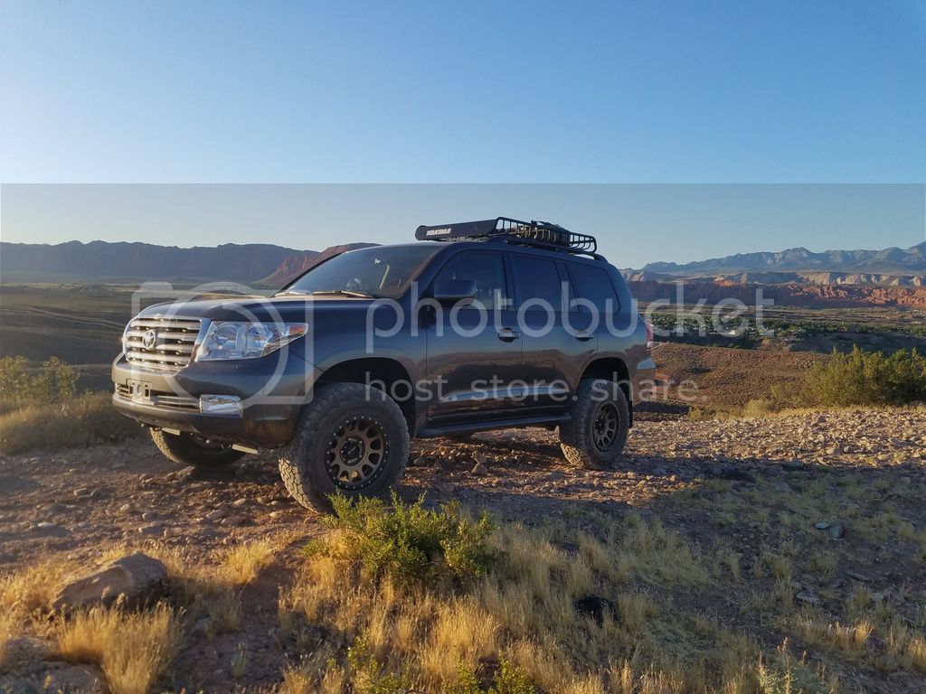

Was struggling with the looks of the 275/70-18's BFG KO2's on the stock rims. So I cowboy'd up and went with the Method NV's. Went down a size to 17" rims and running 285/70-17. Tried the 315's but they hit in all kinds of places. (BTW HATE the Yakima rack but needed to carry a few gallons of gas as we are hitting White Rim Trail in a few days).
Are you running a Tundra suspension in front and rear spacers? Or are those wheels just a crazy-wide offset? If neither of the above, it would have to be darn near zero offset...?
OME all around, no spacers. And not running SPC UCA's yet, the camber is off giving them the illusion of flaring out at the top. The SPC's will fix that. I just bought the rig about 2 weeks ago and ran out time to get them. Only was able to get the lift and Airbags on. We are on a week and a half road trip, so my time was cut short.
The offset does put them about 3/4" out in the rear on the drivers side and a shy less then 1/2" on the passenger side. Thinking of adjustable pan hard bar to re-center the axel.
I really like the color but am concerned about the offset.
Had to do a little magic with the heat gun, but not to bad.
Yes sir, good eye.
17x8.5 | 5x150 | 0/4.75
OK. That explains the look... Because on my Rock Warriors, at +50 offset (stock is +60), even adding 1.25" spacers all around doesn't stick out nearly as far. Nor does 20... So figured it must be close to zero.
I see it barely misses the rear well when one side is stuffed...but what will happen if you fully stuff on a hard bump or hard landing where both sides go straight up...rather than leaning inward as in the single-side stuff?
Not sure it's a problem. Being as how they are pretty much stock size in overall diameter in would imagine the bump stops would stop the upward travel. And I'm not a Baja runner... Lol
