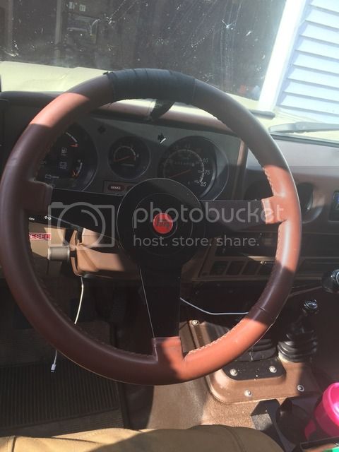

I just installed a late 80s Corolla wheel, needed some mods but easy enough! Love the smaller diameter, thicker, closer to driver and the fact that it's a Toyota wheel!

digging the Corolla steering wheel .. all stuff works with it ..? horn, and turn signal ?
Yes, with the small mods it's all in order. just drove for 4 hours today, loving it.
With the wheel 'backspacing' it now feels like my lights are on high, since the light and washer switch is about an inch further away. :)
