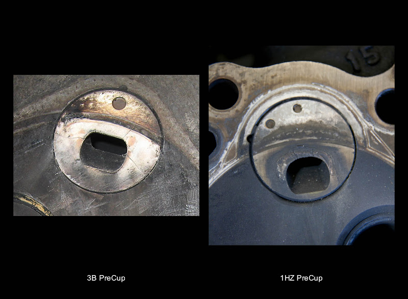

cracked precups like yours are very common, and most shops like you stated wont change them.
they can easily be knocked out with a punch down the injector hole like you stated, the head milled and the preco's installed and checked to see how proud they are, i believe they are allowed to be up to .002" or .003" proud but your FSM will confirm that
we mill most of our heads with the preco's in, it involves a good tip, a little oil/atf fluid/crc on the preco and the right speed. allthough i have had to use a surface grinder on a couple of larger heads.
have you checked the head for straightness/warping yet to determine if it does need machining? also are you going to have it crack tested?
also a little off topic but can anyone point me to a thread where a 1hz has had the precos come apart and kill a motor?
Most of the destroyed engines from dropped precups that supposedly litter this forum are 3b's.
Have not seen a HZ yet on the forum destroyed by a dropped precup....
Well if the 1HZ is immune from precup droppage then run the cracked ones, by all means. Everyone here is correct, indeed I can't seem to find a 1HZ on the forum :hhmm: that was destroyed by such...
Still from your pics if there is a difference in block overhang between the 1HZ and the 3B its very slight.
As for the milling, are you sure your head was cut and not ground? (or sanded)
Once again this could be part of the difference between the B and HZ, on the HZ every shop said to mill (with a cutter) they would need to come out, we did a basic scratch test on their base and the metal is MUCH harder than the surrounding steel.
Good to know about actually being able to knock them out. I was concerned to just give it a shot since I've also read that the most likely place for heads to crack is from the pre-cup hole.
The recession or protrusion on the cups can measure +- 0.0016" So, pretty much flush. :p
I don't have a straight edge that I trust enough to check the length of the head for flat, will wait and see.
As for a story of HZ cups coming apart and affecting the motor, I can not find any evidence of that. I did come across one mention that someone thought they were loosing coolant through a cracked precup and head gasket, but that was not backed up with anything.
How is it that the sort of guy who would stress about the process used to resurface his head would reinstall it with cracked parts?! I don't follow the logic.
Now now, I was just curious what process was used to level the head on the B. :)From Doorslammer's response above it sounds like the HZs cups can be cut as well, but from the sounds of it most shops don't want to risk their cutters.
As you mention, there is only a tiny bit of difference between the HZ and B cup profile though.
To me, if I have to level or machine the head, I would want to pull them, just don't like the idea of cutting dissimilar metals together like that, especially when the clearances are 0.001" Not to mention that a cut would remove material from an already weak cup.

For comparison, here are the 3B and HZ cups side by side, the 3B pictured is amaurer's pic from his engine.
There are actually a few more subtle differences than I thought.

Past that, I just heard from the machine guy; the block is fine but the head is checked all over the place, between the valves, inside the pre-cup chambers, etc.
He said none of them are "cracks" but they are checked.
:censor:
He is a particular fellow (why I went with him for the work) and he does a lot of small and mid-sized diesel work, he says that most shops ask him not to bother magnufluxing the heads since they "don't even want to know" he said there is something to the "they all do that" mentality but it's not really the way he works, and it's not the way I work either.
Any opinions on the checks? Do they truly "all do that" or now am I really screwed?
(the way this year has been going, I'm just going to assume that I'm really screwed) :censor:
Basically every set of valves has these little cracks between them, none of them even get close to the valve seats but they are there.
A few of the pre-cups have little cracks that head into the cylinder area.
The machine guy says that he has virtually never seen a diesel engine without these same cracks (and he has seen a lot of engine heads) 95% have the same thing and nothing is done about them.
Doesn't change the fact that they are there though.
Anyone else have experience with these kinds of cracks on the HZ?
I don't see many opened 1HZ down here .. ( still rolling never opened ) but plenty 2H and all with that kind of " cracks " ( I wouldn't call as is ) and still doing the job day by day .. not even with clean oil of carefully drivers thinking with it's the best oil or waiting for engine to warm up before rev up to the limit ..
My 2H looked worse than that and was leaking into comb. gas into coolant system. I don't envy your position at all. It's tough to decide on what to do as I'm not sure welding and machining can be done or would hold up.
Best of luck...
If your guy says run it(the head) throw it back on,at least its one of the easiest parts to swap,you can get them new,just factor in a new head in the next 12 months or so,you can still get even 2h heads new,12ht you can not :(.
