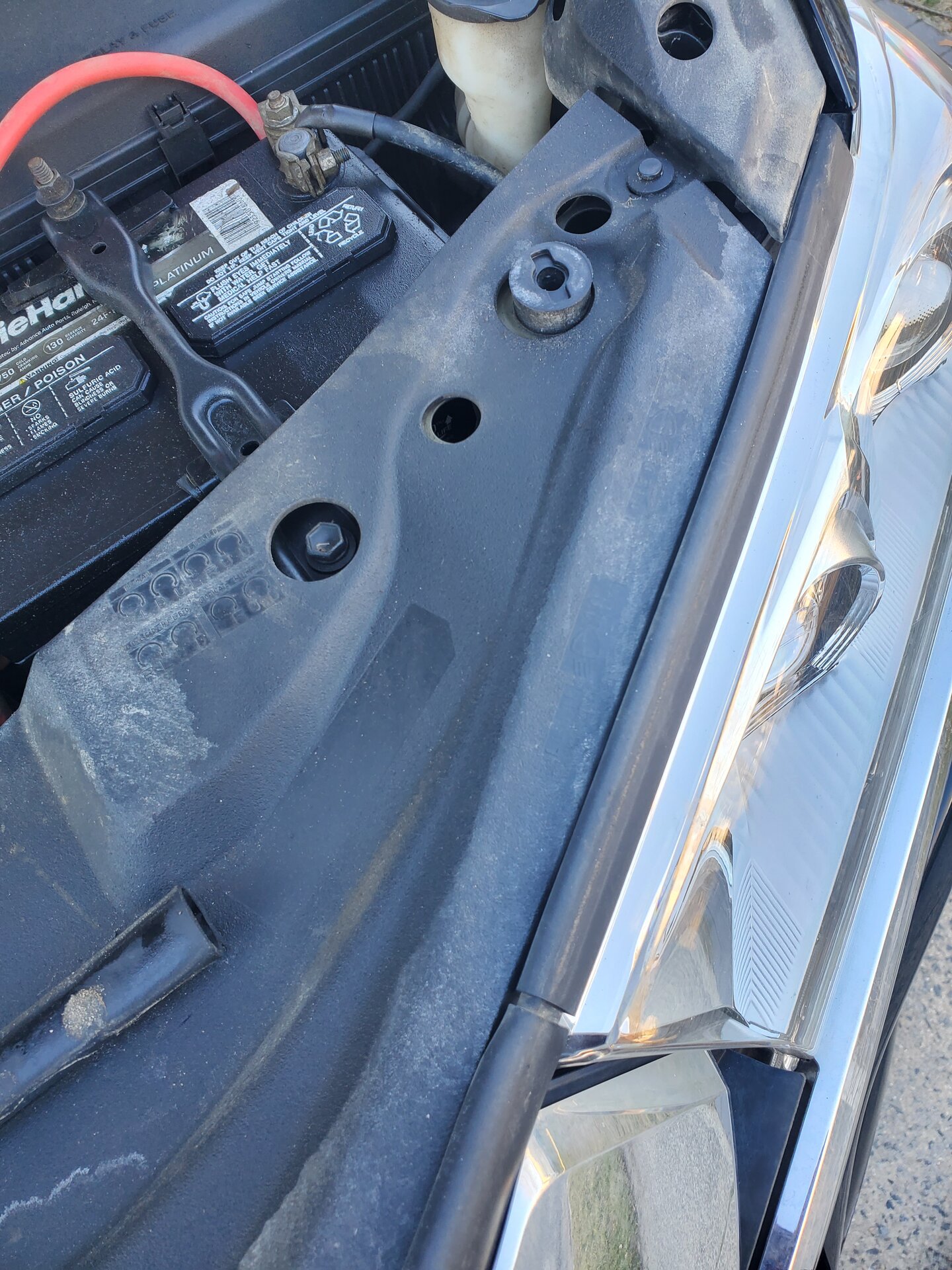

does anyone just do the manual adjustment under the hood with a screwdriver?
After learning my lesson years ago, only use that option to align the 2 headlights to each other.
depending on amount of lift installed, it can be easy to over extend the adjustment and will require replacement $$$$. Better to adjust the linkage and fine tune with the screws.

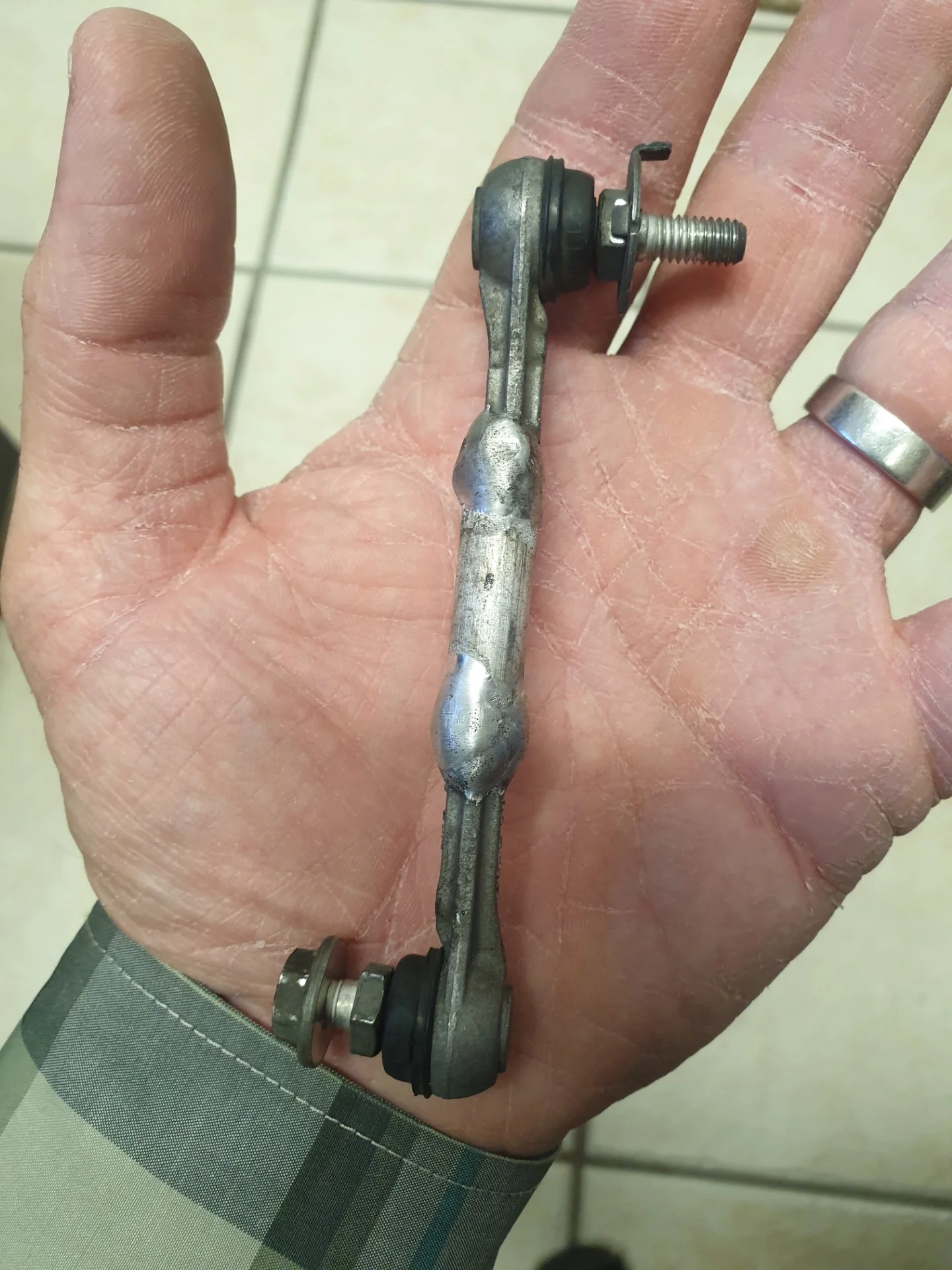

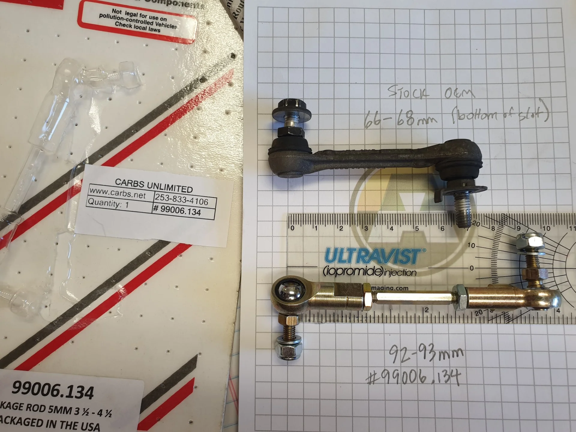

Stock OEM arm was bottomed out in the slot. The carb linkage noted above is pictured below next to the OEM linkage. I have no complaints at all with the carb linkage but I am going to tinker with another option. The studs on the carb linkage are a tad small compared to the OEM part. 92-93mm center to center places the headlights in spec per FSM on our 2019 with TJM PACE system. suspension

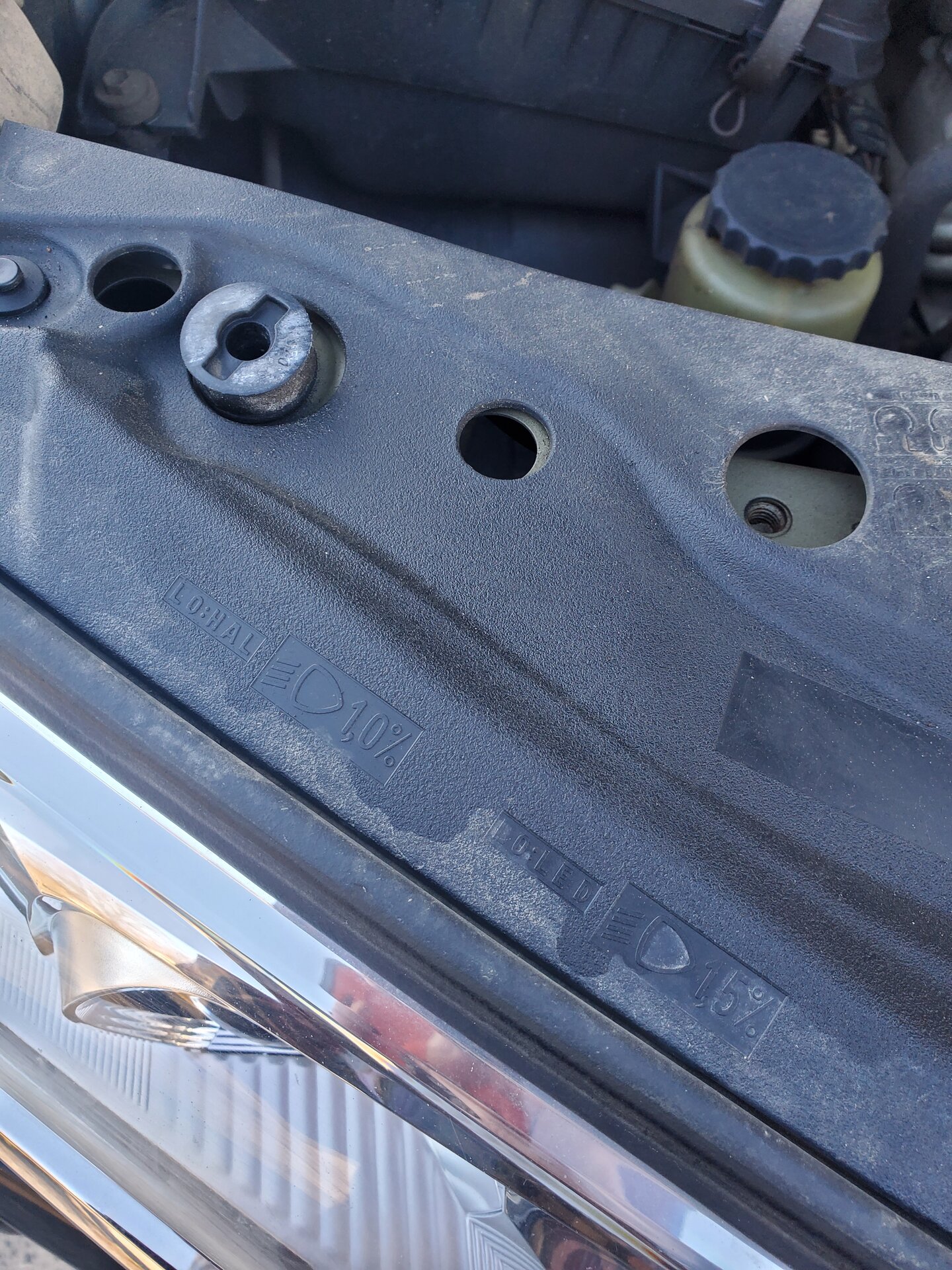

Well my drivers side adjusts and my passenger side (Right) does nothing.
Edited: Passenger side does move! Local Toyota service tech suggested taking an 8mm socket on a palm ratchet and gently turn the adjustment on the low beam side counterclockwise until it stops. He stated to only use my index finger, middle finger and thumb while rotating the ratchet. He said someone (PO) likely tried to rotate the adjustment screw too fast causing the gimble inside the headlight assembly to jump.

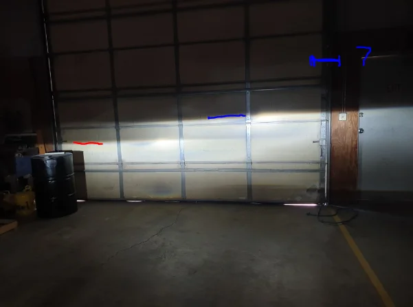

I followed his instructions and was then able to go back clockwise and adjust the passenger side down. the photo below is what I was starting with at 16.8 ft. Driver side (Left) was 38" to the cut off (Red Line) and the Passenger was knocking the Racoons out of the trees at 50 1/2". Quite a difference. I lowered the passenger side to where the cut off is at 41".
27mm extension nets a 2" lower cut off on the headlight at 3M or roughly 10 ft.

It's a pretty simple adjustment and not much to go wrong. I've had the Weber on mine for a couple years now since TJM hadn't started importing theirs yet and I have no complaints. If I were to buy one again now I'd probably just get the TJM one since it was made for our cars.

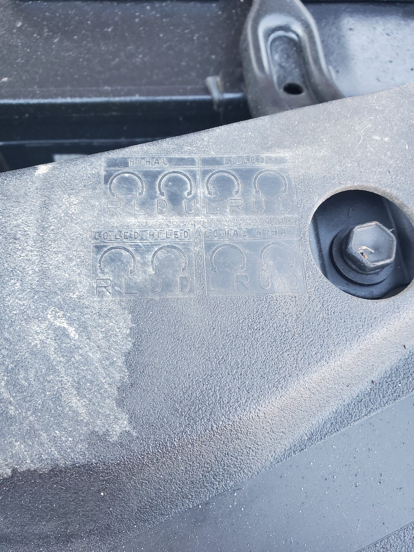

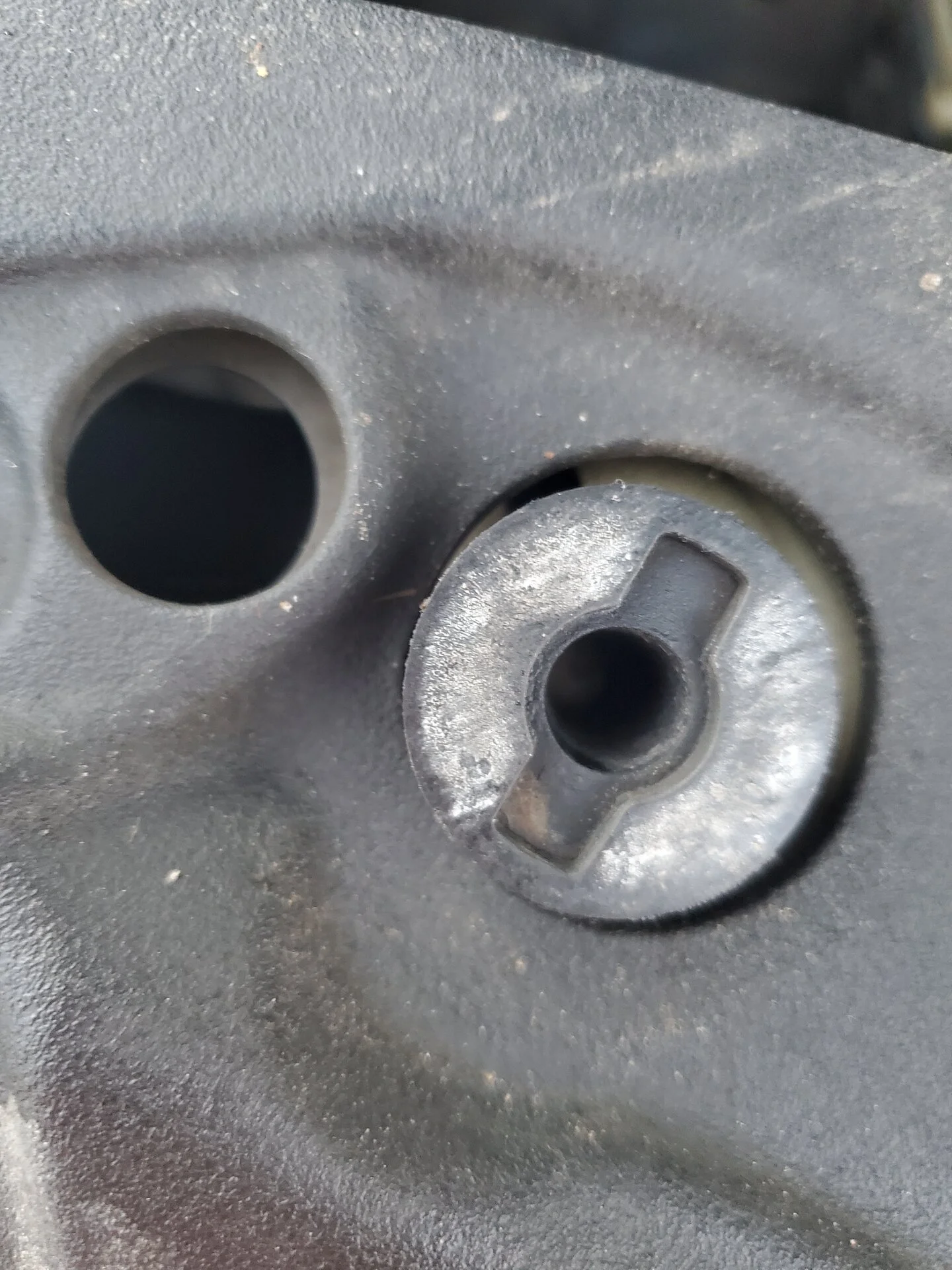

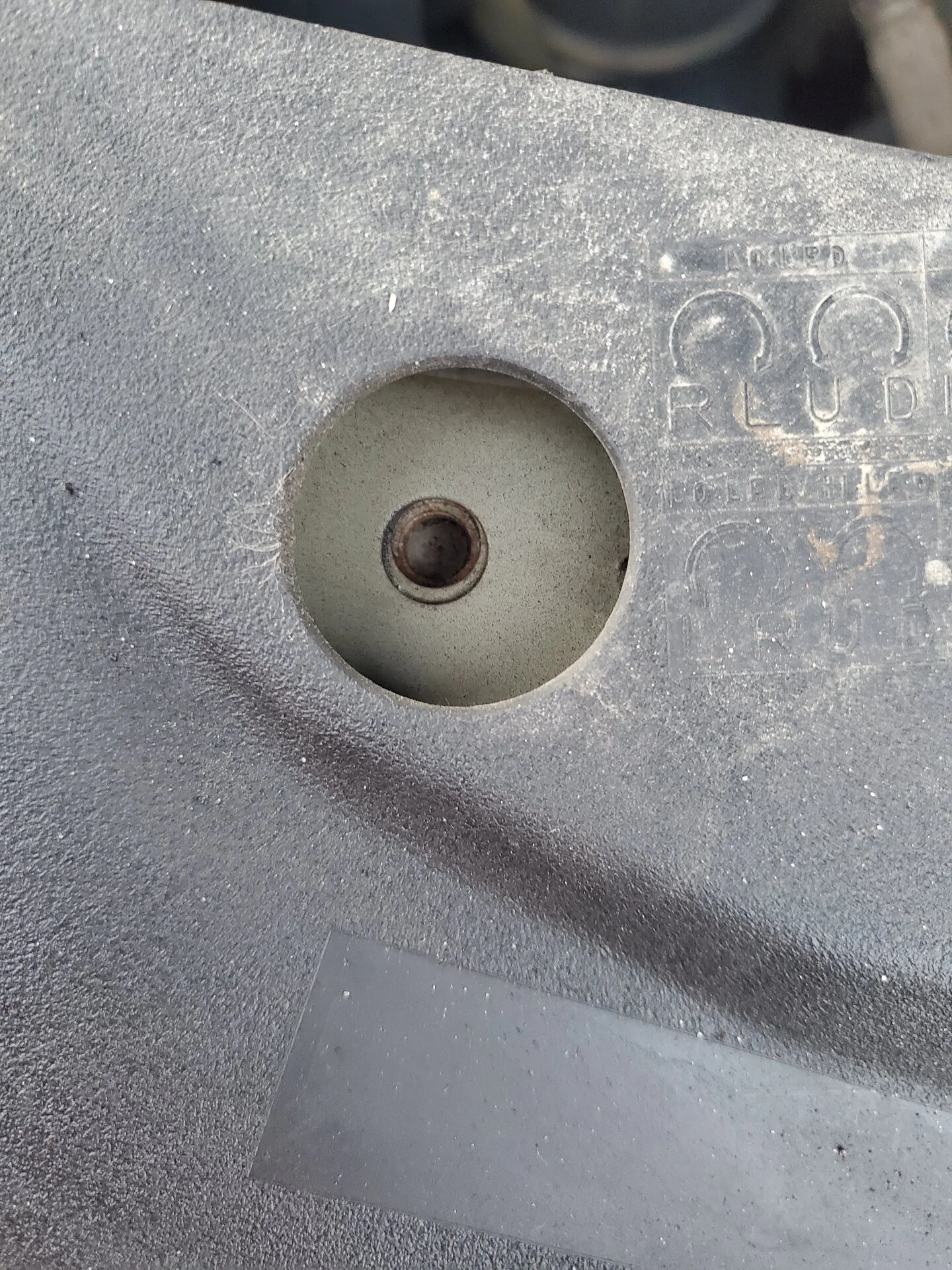

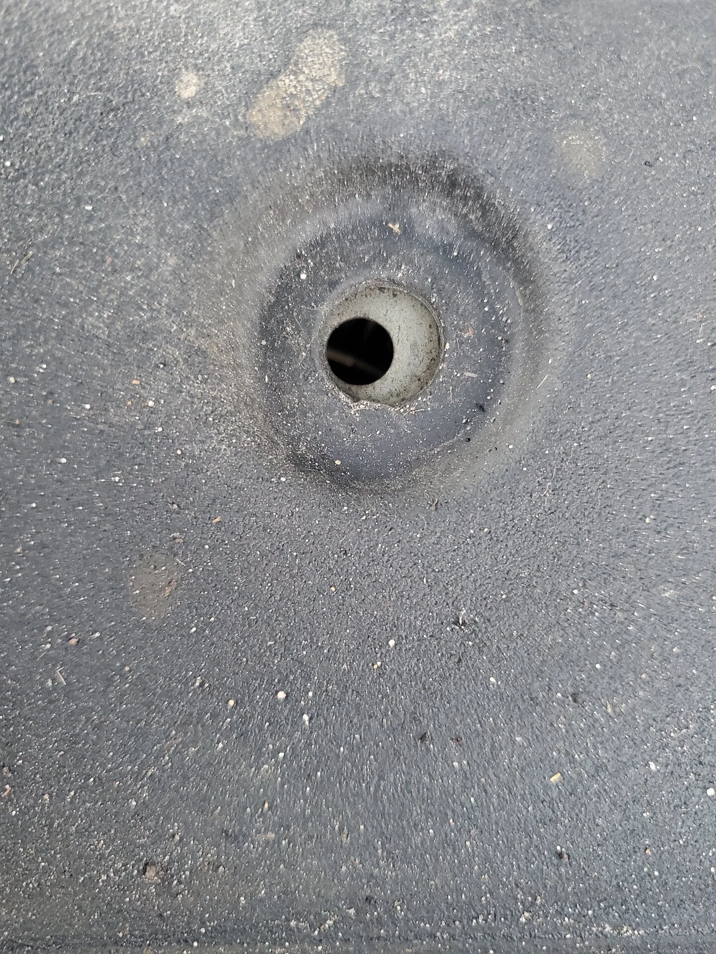

Back to this.....added the linkage out back, on an 18, is the adjustment for the headlights under this plastic shroud? These markings seem to indicate yes, but hadn't pulled it off yet
