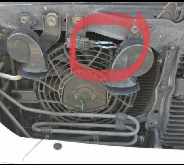

I needed a hands-off method of activating the A/c condenser fan retrofitted from 98-02 100 series. I bought a used fan off a '02 on ebay. If you go this route make sure ALL mount bushings are included, unlike this one shown below.
It took about 10 minutes to mount the fan. On the LX, access is much easier and all you have to do is take off the horns. I chose not to drill the hole on the frame for a side-mount bracket. The fan seems solidly mounted with the other 3 points. There might be a fatigue crack on the plastic at some point, but I guess we'll see.

I routed the pressure switch wiring through the firewall grommet next to the battery and into the DS fender, then down to the switch. I cut off the plugs that are supposed to go to the light-bar and then used marine-grade butt connectors at both ends.
The finished product, works almost exactly like OE. Assuming the relay is of reasonable quality, this should be good for several years.
