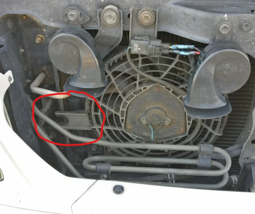

Waiting on the last few parts to do this install. For anyone that has done this mod and not drilled/installed the bracket support on the left side of the fan - any long-term issues leaving the red circled mount hanging??

I did this mod on my 98 because my winch controller blocks part of the AC coil. I used all oem parts off a 99 at a salvage yard and wired it into the main fuse box ( that was a pain.). Zero issues with the fan mounting and it works perfectly
