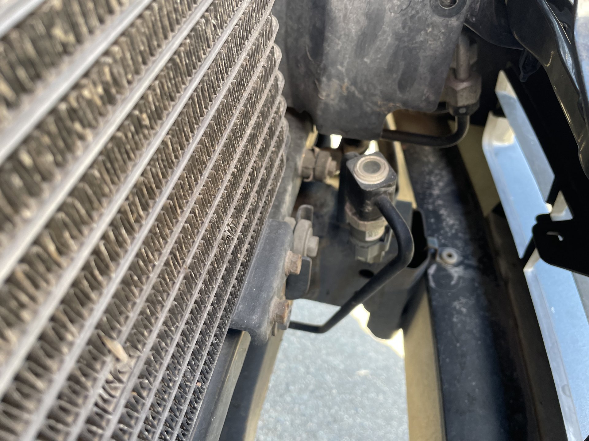

I thought someone posted a pic of it once. There's an empty connector in the front by the AC lines going into your compressor. That connector used to connect to a factory e fan but Lexus/Toyota didn't feel the US gets hot enough so they saved moneyOh ok that makes it easy do you know where under the hood its located?
I'll try to snap a pic for you when I leave my WFH deskThank you I will follow the line from the compressor.
This@Biga27110 It’ll be the cylindrical thing on the driver side, behind the bumper, inside the frame rail. It’ll have a glass sight on top to view the refrigerant through. Below, there is a plastic connector with 2 wires coming out of it. That’s where we’re adding 2 additional wires. You’ll have to disconnect the connector to add the new wires.

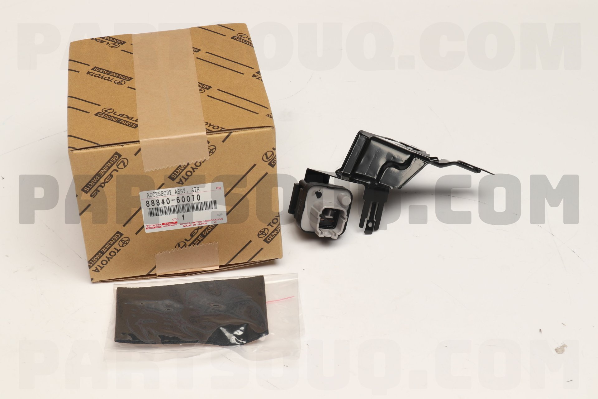

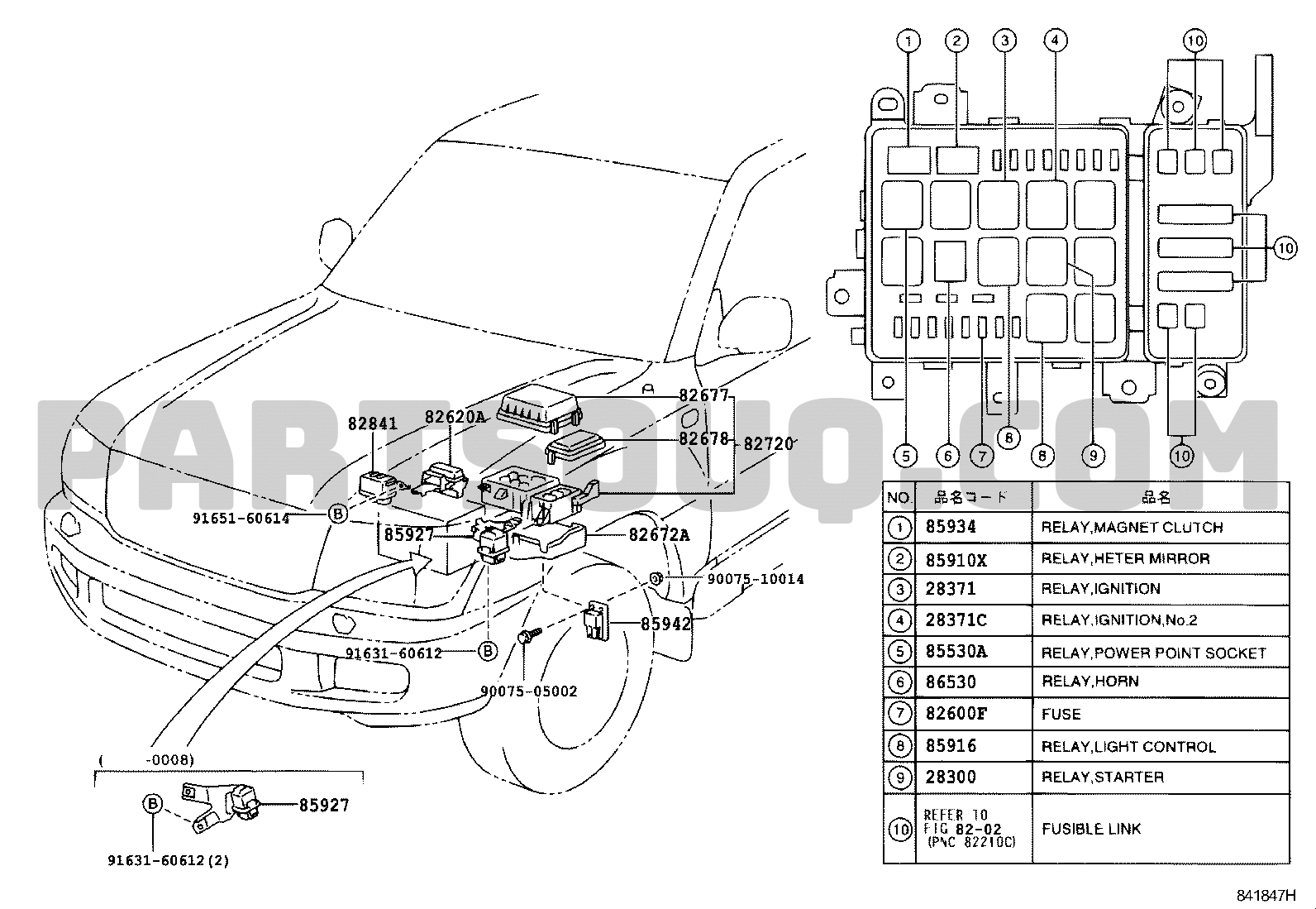

what is the connector part # for this one?Im trying to search partsouq for the possibility of doing an OEM integration as well. I believe i found the part number for the OEM AC fan relay for the pre 03.
8863060090
