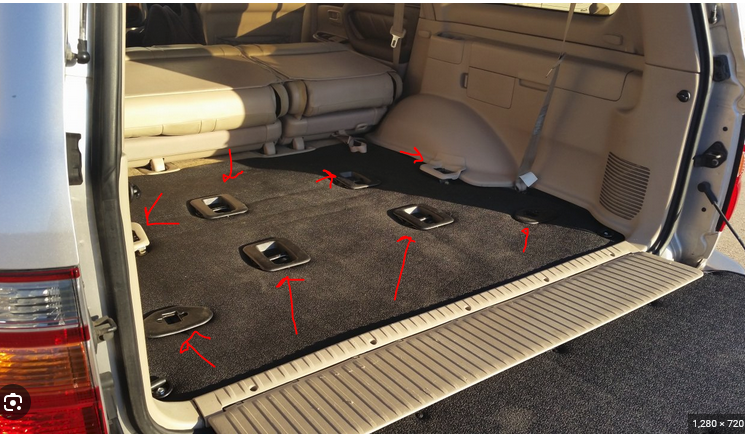

Look in the rear of your truck, if you have these:
it's just a matter of finding seats. If not, which is possible but highly unlikely for a US truck, it's a lot of work adding all of those anchor points (cutting floor, welding, don't know if those are available stand-alone anyway . . .)

It's a European truck and it hasn't got the seat belts and anchor points.
Guess I would need to continue my search for a truck that does have them.
