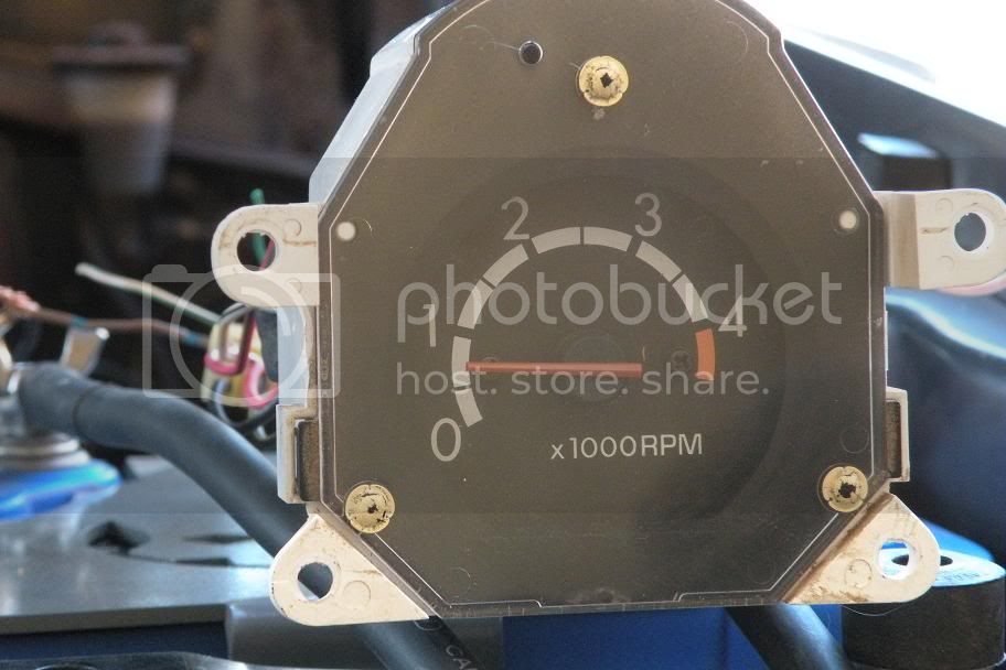

The first photo is of the tach working on the 4HE1. I’m using the optical tach to verify the reading. If your tach worked properly on the original engine, no recalibration should be required with this setup.

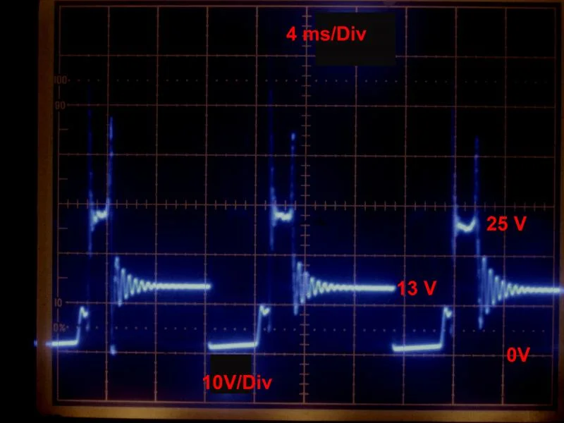

The second photo shows what the original signal from the 3FE igniter looked like and the third photo show the signal produces by the ABS sensor.

The ABS sensor (the two wire type) is a variable reluctance magnetic sensor. Variable reluctance sensor - Wikipedia, the free encyclopedia It is a coil wrapped around a magnet. One end of the magnet is positioned close to the flywheel edge. Every time one of the notches that I cut in the flywheel passes by sensor, it changes the magnetic field thereby inducing a voltage in the coil. You can see these induced voltage blips in the second scope photo in Post 2 of this thread.

As far as the circuit, when the magnetic field is steady while the unaltered portion of the flywheel is passing by the sensor, esentially the coil has 0 volts across it. Since one side is connected to 12V, the tach sees 12 V, same as it would when the points are open in a conventional ignition system. As the notch passes past the sensor, a voltage is induced in the sensor, negating the 12V and the tach sees 0V (or close to it). This is the same as when the points are closed in a conventional ignition system. When the unalter part of the flywheel resumes passing past the sensor, you get another pulse of opposite polarity to the first but we don't care about that one!

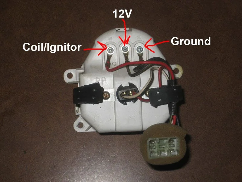

I've had some questions about exactly where to connect up the ABS sensor to the OE tach. If you look at the back of the FJ60/62 tach, you will see three connections - see 1st photo. The connection labeled Coil/igniter connects to the igniter on the FJ62 and to the wire that goes from the distributor to the coil on a FJ60. The connection labeled 12V supplies power to the tach and should be at around 12 volts when the ignition switch is in the "Run" position. The connection labled Ground goes to a ground.
1st, verify that you have 12 volts on the 12V terminal when the ignition switch is in the run position. Verify that the Ground terminal actually connects to ground and finally, make sure that the Coil/igniter terminal is no longer connected to anything in the engine compartment. Connect your two-wire ABS sensor to the Coil/Igniter and 12V terminals of the tach. If it doesn't work, try reversing the two ABS sensor wires.
You can run your own two wires from the tach to the ABS sensor or, if your original wiring harness is still intact, you should have both 12V and the wire that connects to the terminal that I have labeled "Coil/igniter" available at the connector that used to plug into the igniter (See 2nd photo) on the FJ62. I don't have any documentation on an FJ60 but there should be an equivalent connection somewhere in the engine compartment.

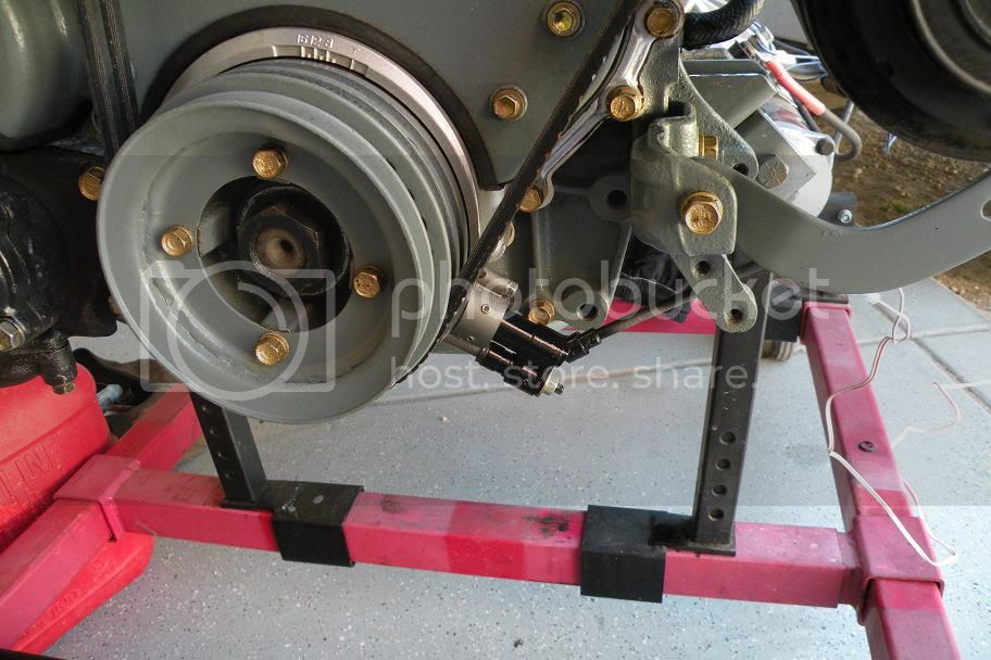

Thank you very much for posting this info, it really helps. I'm installing a 4BD1T Isuzu and I'm using your idea of the ABS sensor only I'm using it on the harmonic balancer. This is a much cheaper way to integrate the factory tach than buying a signal translator for $100 or more.

This is such a simple method for utilizing your factory tach. I went to the local self serve junk yard and I got an ABS sensor from a Buick and it didn't work even though it had two wires. I then got one from a Ford Explorer and it works perfectly! It only cost me $10 for this setup but I did have to build the mount for the sensor and I had to mill three notches into the harmonic balancer, but that only cost me my spare time.
