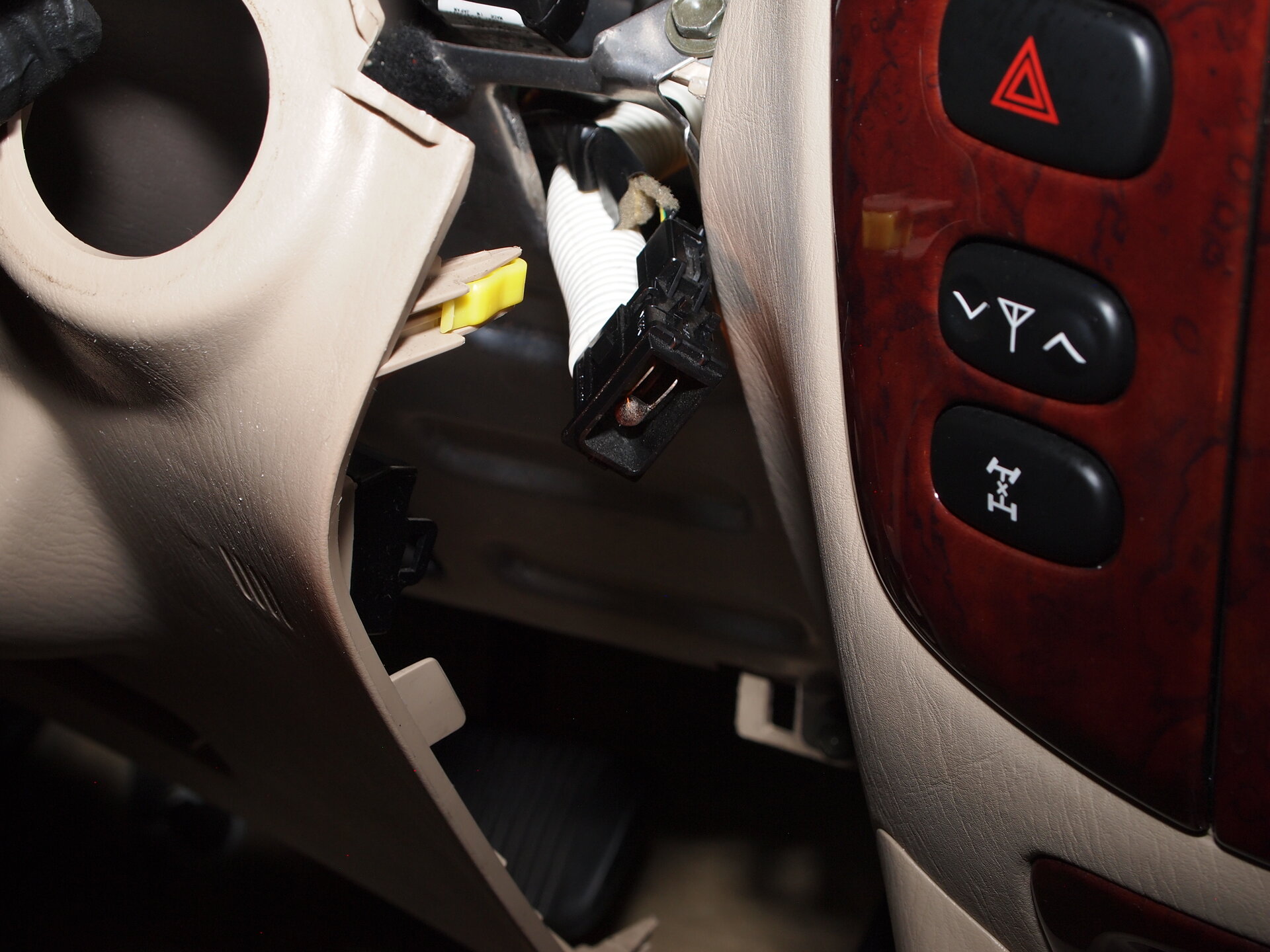

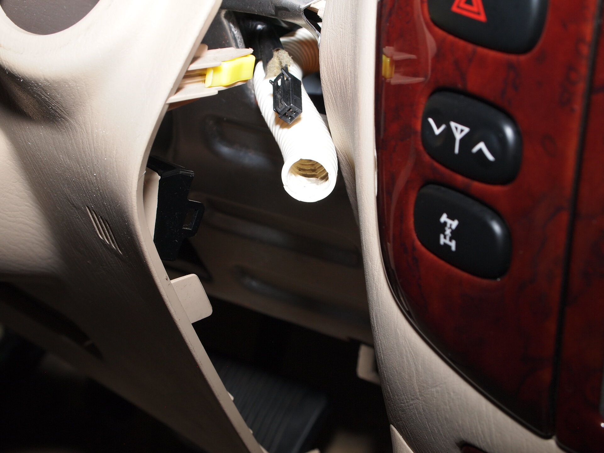

There should be a hard ribbed plastic hose (mine was white, 99LC) that connects to the temp sensor, and an electrical connector that plugs into the sensor as well.
I would look up around the ignition, and over kinda behind the climate control areas for them. Might be tucked up outta the way by someone who was in there last?
