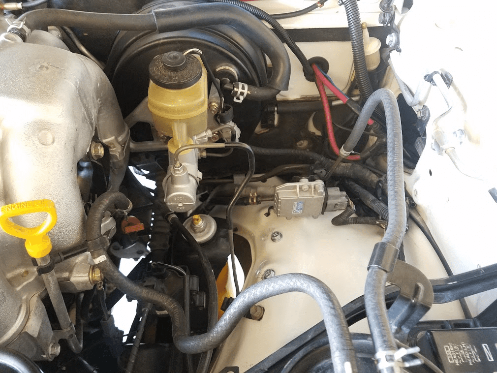

I did the abs/LSPV delete, pretty much replaced all of the hard lines, and put in new slee braided lines. Also all new calipers.
When I went to pressure bleed the system, I'm getting nothing out of the rear brakes. I cracked the master cylinder fittings to bleed them and got some air out. Still nothing to the rear brakes? Wtf? I cracked the first tee (where LSPV was) and getting nothing out of there. What am I missing?
