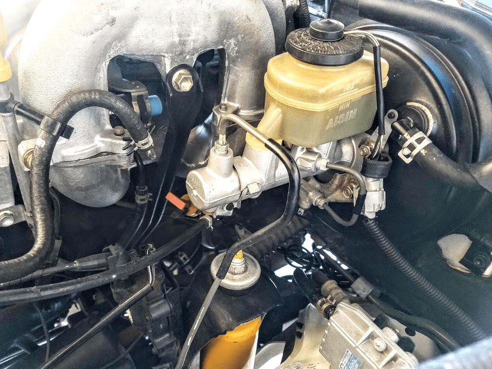

I did this mod a while back. Definitely worth it. Much better stopping and feel. I however added the proportioning valve. I have marked off settings for towing or not towing the boat. To be honest it was scary towing the boat before I did this.
Finished 1200+ miles testing that included 400+ miles of dirt. The brakes on my setup without a proportioning valve feel and perform fantastically! YMMV

Nice work Phil! I'm getting tired of looking at that ABS light after my part time kit last year. Getting ready to rebuild all the calipers and flush the system. Nice to see how easy it can be to delete the ABS (assuming you have that front OEM 3-way fitting). I'll need to do some work and figure out the front lines without that fitting. It'd be good to reclaim that fender for a new fuse block setup.
Regarding the plug under the master cylinder. Do you see any reason I couldn't use an AN3 to 10mm fitting with an AN3 cap?

Could this fitting be drilled and tapped to accept the passenger side hard brake line?
youve got the front of the master going to the front brakes and the rear to the rear. is that correct?? as ive always understood it, the front of the master goes to the rear brakes ect.. am i missing something?? im assuming the volume and/or pressure of fluid is pre-portioned for each axle from the master directly, before it gets to LSPV..
anybody have input on that???
i did just delete my abs and routed lines the same as in this picture and i dont seem to have and issues. i did second guess it the entire time i was doing it..
Front to the front and rear to the rear and my results are excellent
Deleted my ABS in a similar fashion. Also deleted the LSPV. It stops like a new truck now! Definitely worth the time and effort (which honestly isn't much). The only issue i had was that i couldn't reuse the 90 in place of the LSPV. No matter what i did i couldn't get it to stop leaking. I used a coupler and have had no issues.
