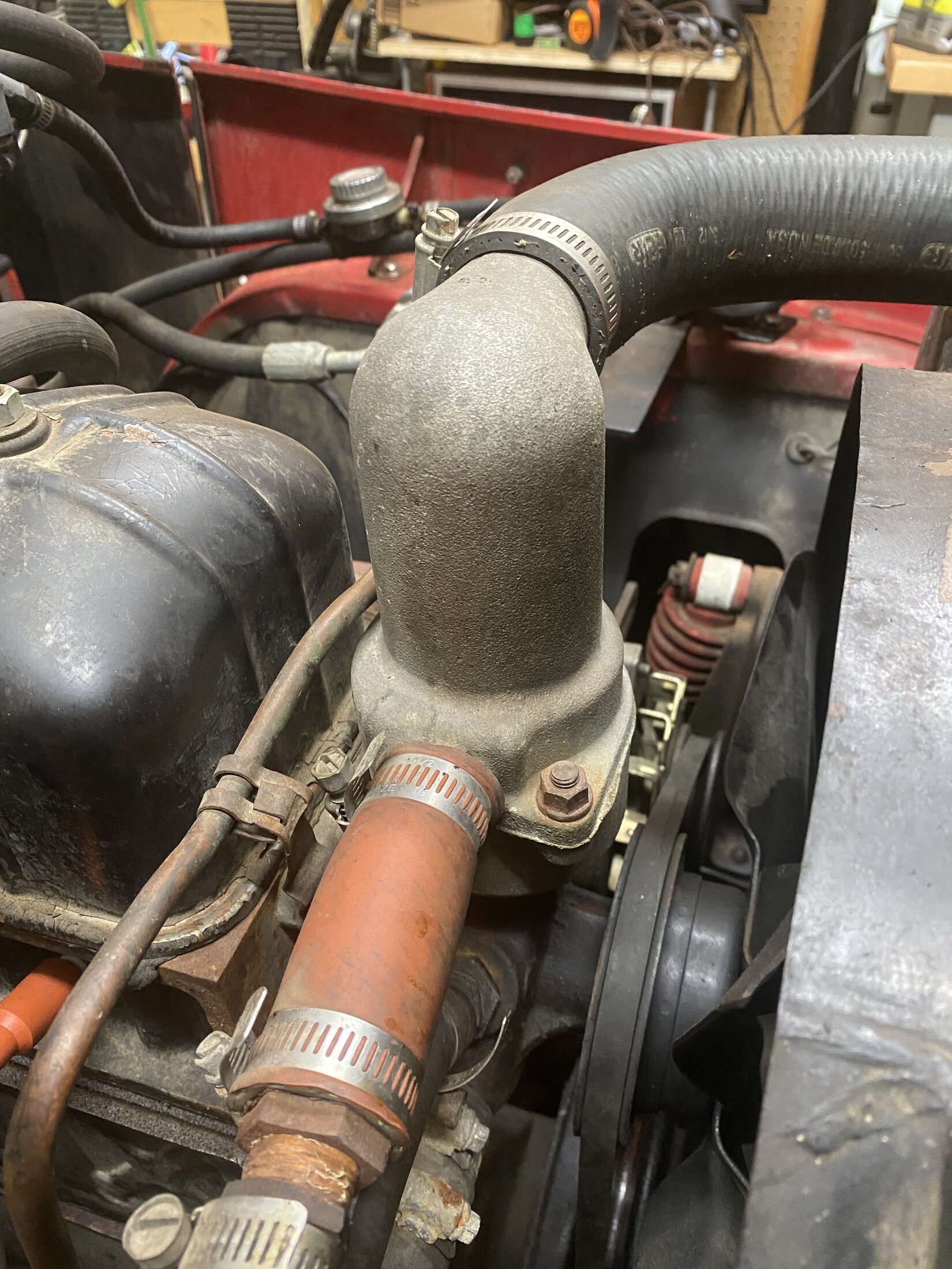

1964 FJ40 with 1F. Toyota has 25% off right now so if I’d like to go ahead and order the radiator (16400-49356) as I have a slight coolant leak somewhere.
I may as well do the water pump, thermostat, and hoses/clamps while I’m doing it. Does Toyota still sell these parts? I’ve seen them on the different LC vendor sites.
What gaskets night I need while knocking this out?
When I did my '69, I swapped out the metal fan for a safer, plastic 6 blade. New belt. I replaced the thermostat and housing, as the bolts were corroded. New gaskets for pump, housing and thermostat. Fipg for waterpump gasket. Added an overflow as the new radiator could accommodate one. Added new brass drain valve to radiator as the new one just had a cheesy plastic plug. New block drain plug. All new hoses, all new clamps. New heater lines and heater shut off valve. Might as well while it's drained. I rebuilt my rear heater too. Might take out your cores and clean, flush, pressure check.

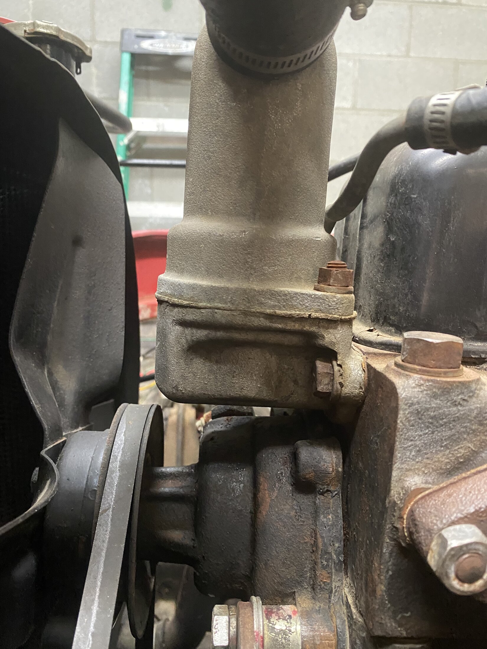

Do you have the original early water pump with the long coolant pipe? The water pump block gasket is NLA but I think @red66toy is looking to repro them. The plate gasket is the same on the both early and late versions. Available from Mr T.
The hose clamps are still available from Mr T. All sizes. They do not match the early design 100% but they look the part as they are still the banded style with a phillips head versus a slotted head.

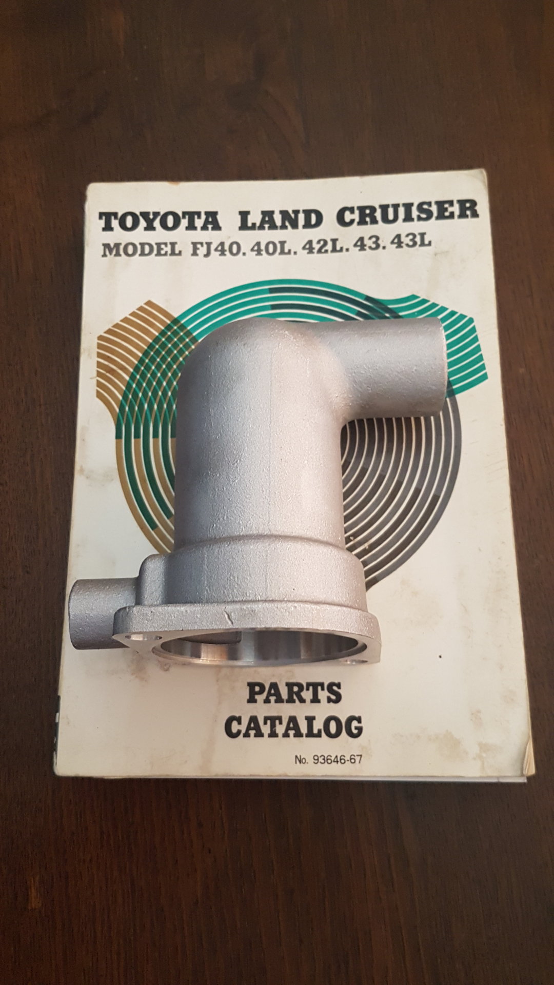

Lets see what else.... thermostat is still available from Mr T. Do you have the high hat top thermostat housing or the shorty? Short gasket is still available. High hat is NLA but you can cross reference the part number and get one from a early forklift. Or just make one.

Original water pumps are pretty hard to find. If yours isn't leaking and working well I would just leave it alone for now. Replacing them on the early F engines is very easy to do with the radiator and thermostat housing in place. I have done it like 7 times in the past few weeks. hahaha. So if it fails after you replace all the other parts, its really not a big deal.
@andybudge makes a repro early thermostat housing if you need one.

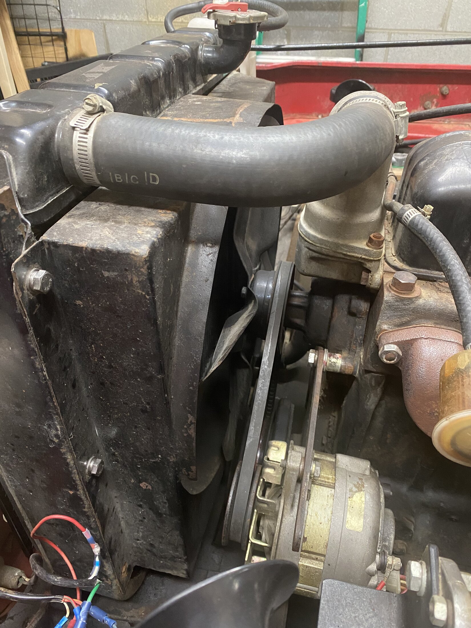

Thanks for the info! I’m not having temp problems, but I think my water pump might be leaking as I can see coolant below it sometimes…normally only on hot days. The FJ40 stays at 150-160 and might go to 180 when first turned off. I think I’m just going to replace the water pump while I’m at it.
The issue I’m running into is finding the specific Toyota part numbers that will work on my ‘64. The Toyota sites don’t go back that far and I haven’t found any definite answers on the parts I’d need for my year (which would be the same as your ‘65 in theory).

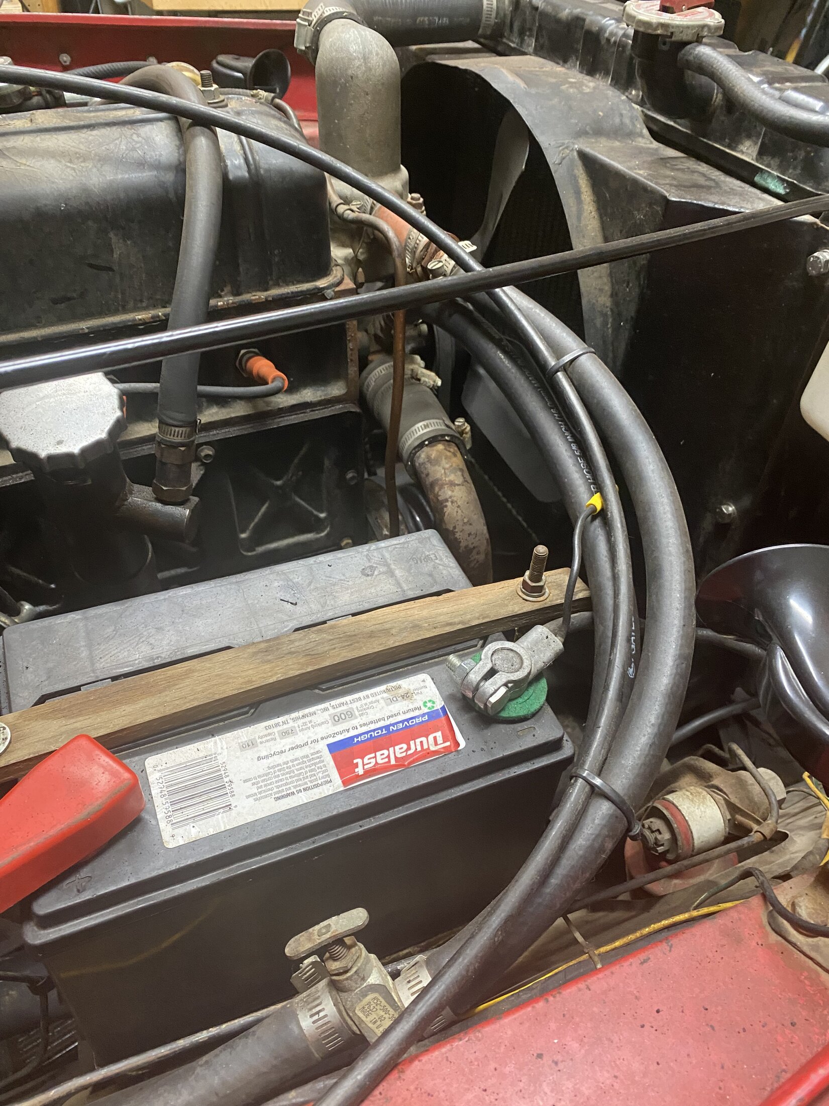

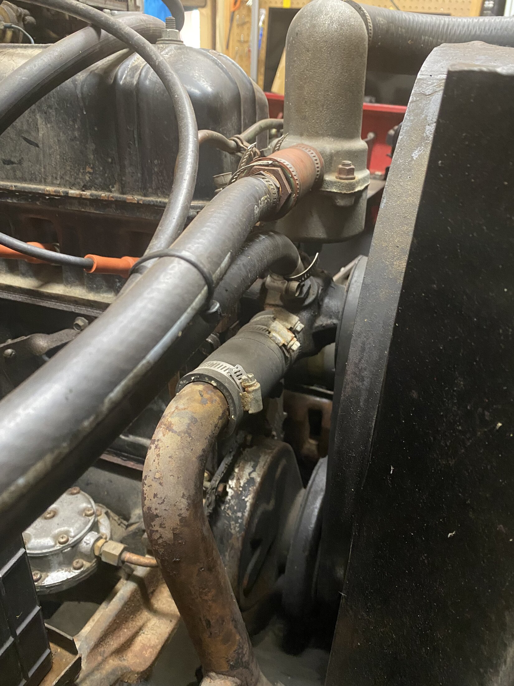

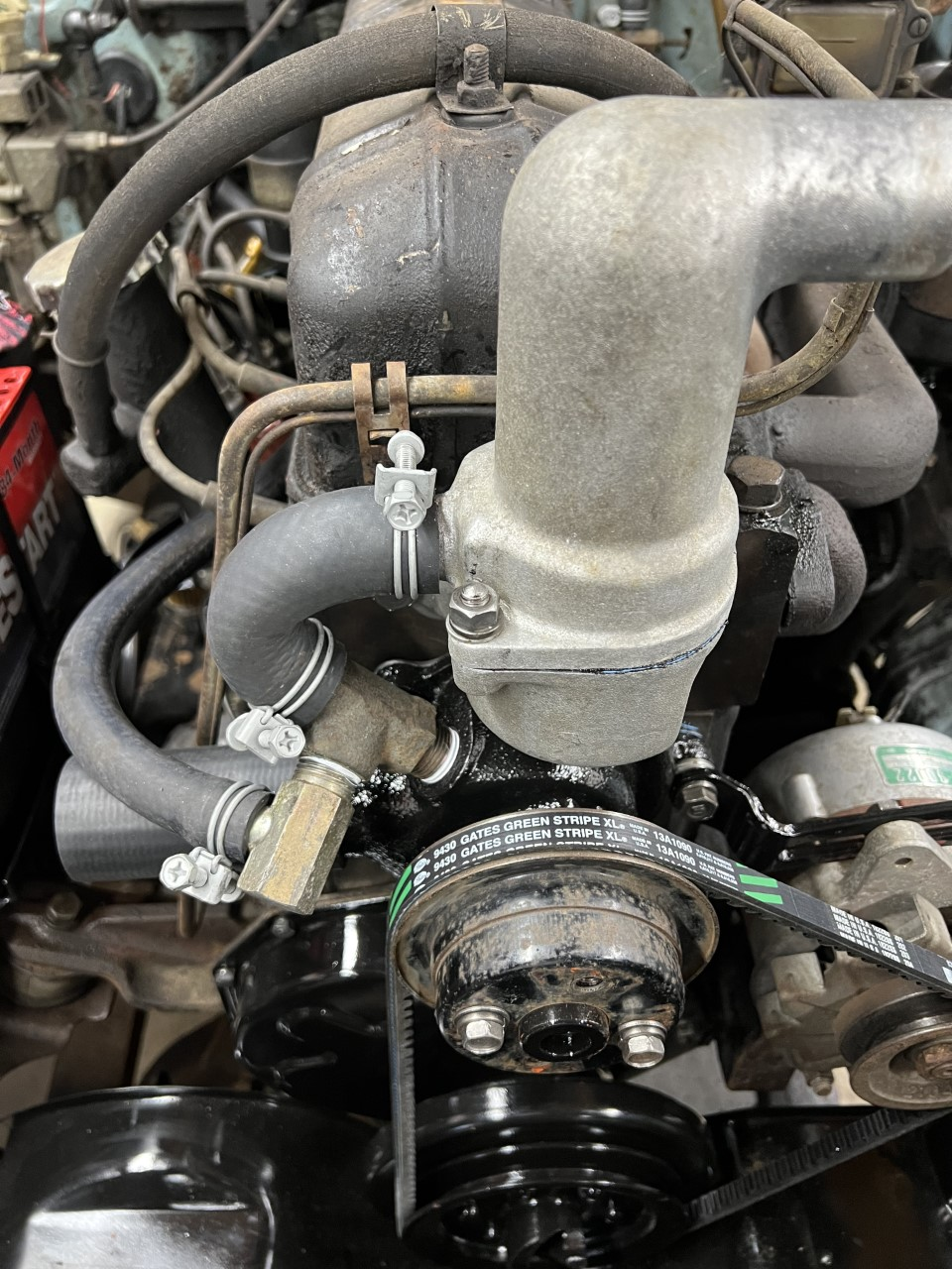

Nice, you have most of the OG setup. Where do your heater hoses route?
I took a bunch of pictures including part numbers in my build thread starting here: PNW 67 Patina Blue - https://forum.ih8mud.com/threads/pnw-67-patina-blue.1289865/page-4#post-14699293
I didn't write them down but you should be able to pull what you need from the posts from that point onward.
