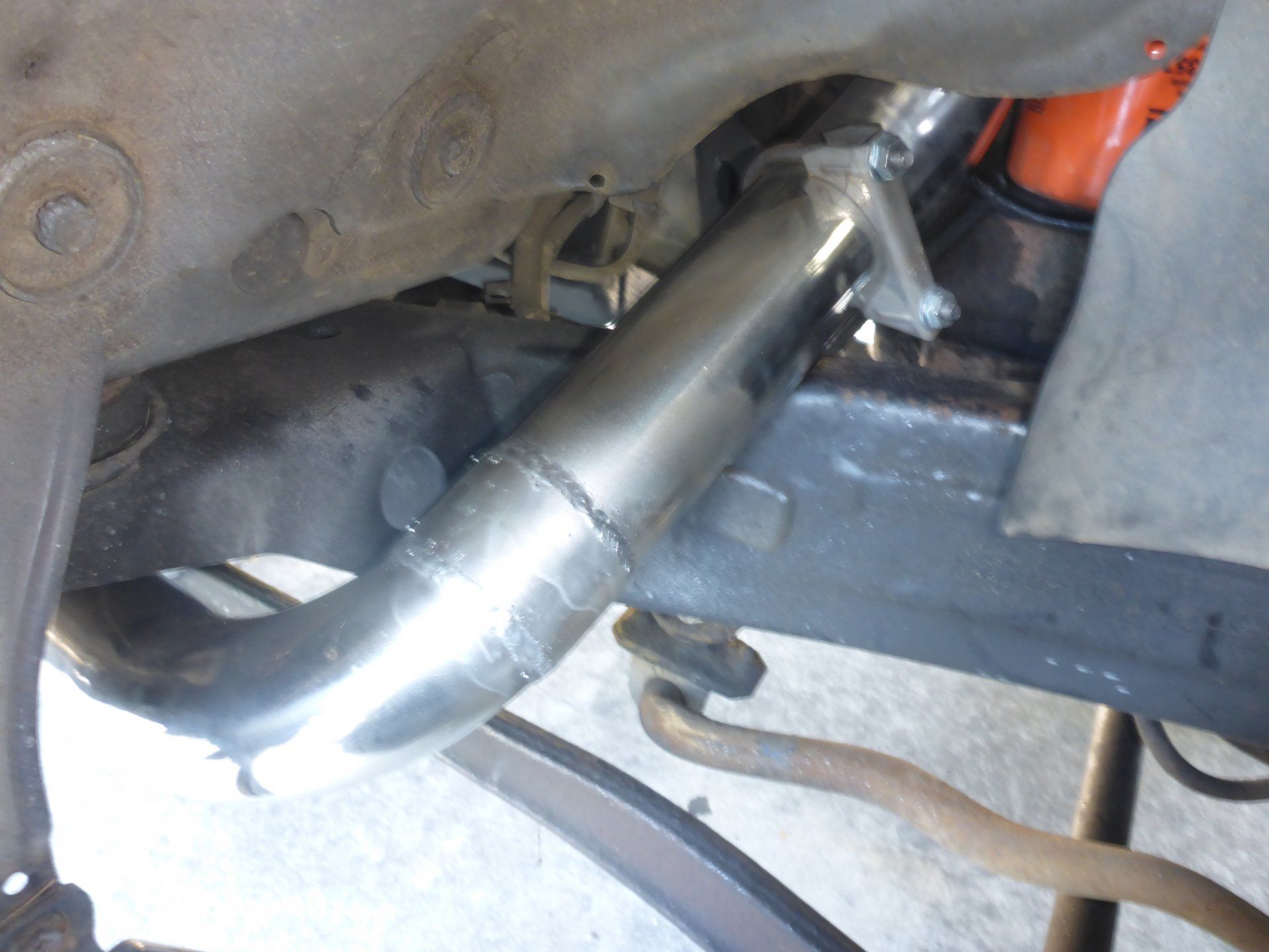

Working on the new exhaust. Thought I'd go this route. Hope I have enough room. We'll see.
Well, another project to check off the list. 2 1/2 inch exhaust. So as mentioned above, the V-band idea did NOT work. Too little room. Cut the band off and welded directly to flange. Initial thoughts, I would say it's running cooler, maybe 50-100 degrees cooler. The Jones resonator and short pipe is louder but, I like it. :D The new turbo is producing 13 lbs of boost on the meter. The old one was 10 max. I bought a manual boost controller because the listing for the turbo said it had an 8 lb wastegate??? Now at 13, not sure I want or need more.
Jimmy, really nice work on that exhaust! Just curious, if any other 70 series owners out there have come up with a "exhaust / rock slider" work around. If anyone has any pics they can post or links to projects they did that have sliders on the right hand side of the vehicle that don't interfere with the center section of the exhaust.
