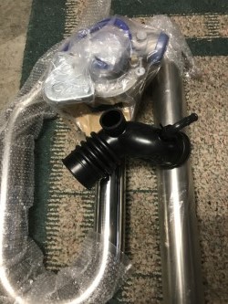

A few more pieces of the next project arrived this week, a few more to get, but, now we're off to New Zealand for a 3 week OIL trip. I'll get to look at all kinds of 70's there and may even snag an idea or two for mine. So this project will have to wait a little longer!

Jimmy, nice CT-20! Is that new-new or rebuilt?
