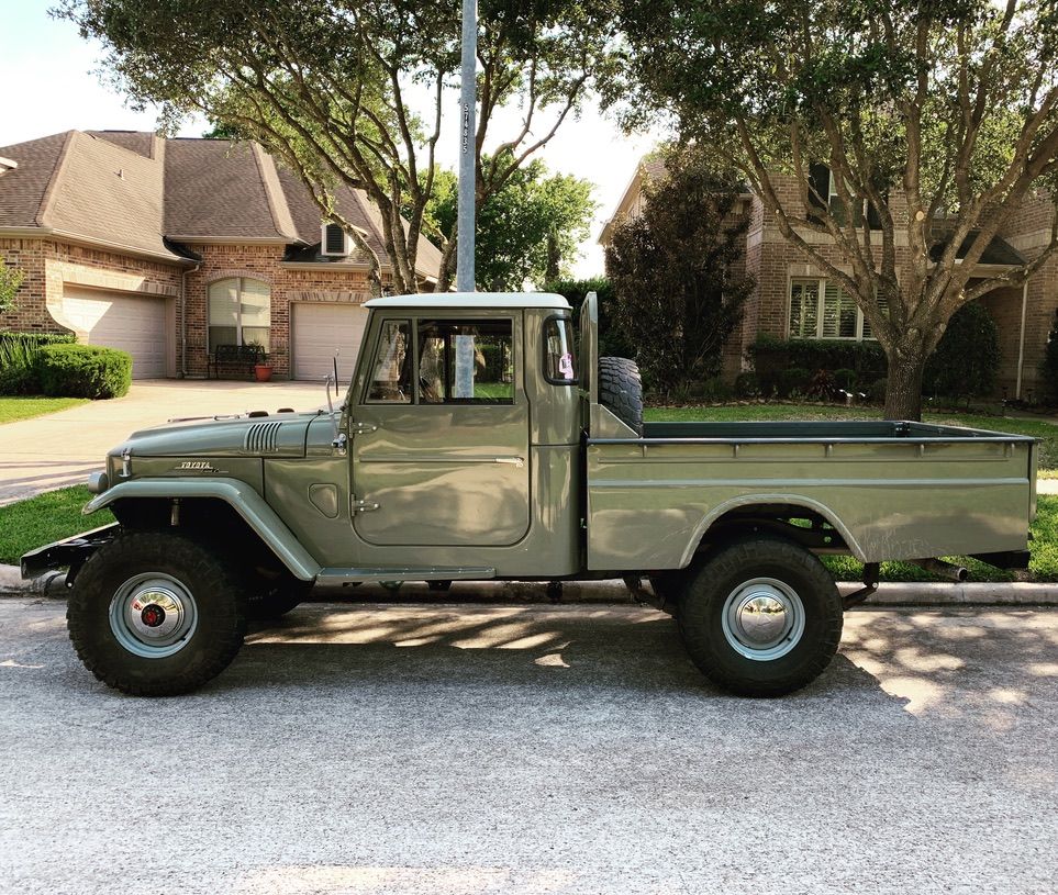

New '76 FJ55 owner here. Not sure what to say. I have a '76 FJ40 and '65 FJ45, so when the opportunity presented itself to pick up a wagon I had to jump on it to round out my heard.
I know, PICS (old to new)
1965 FJ45lpb:
