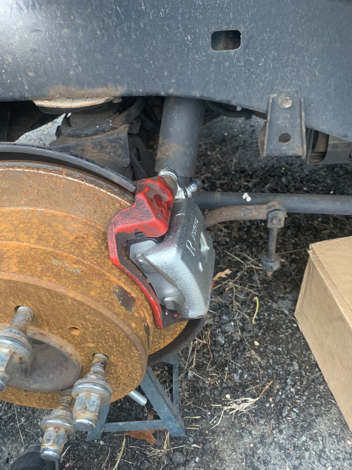

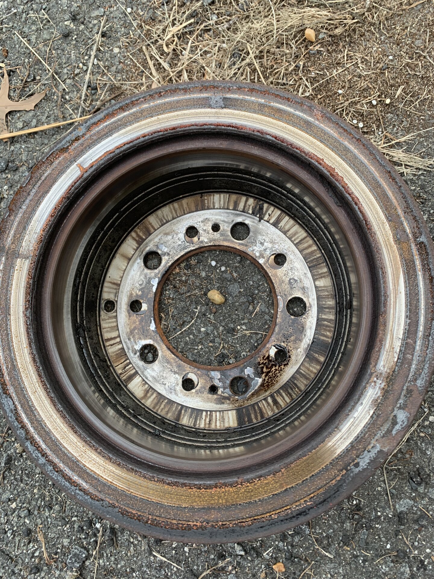

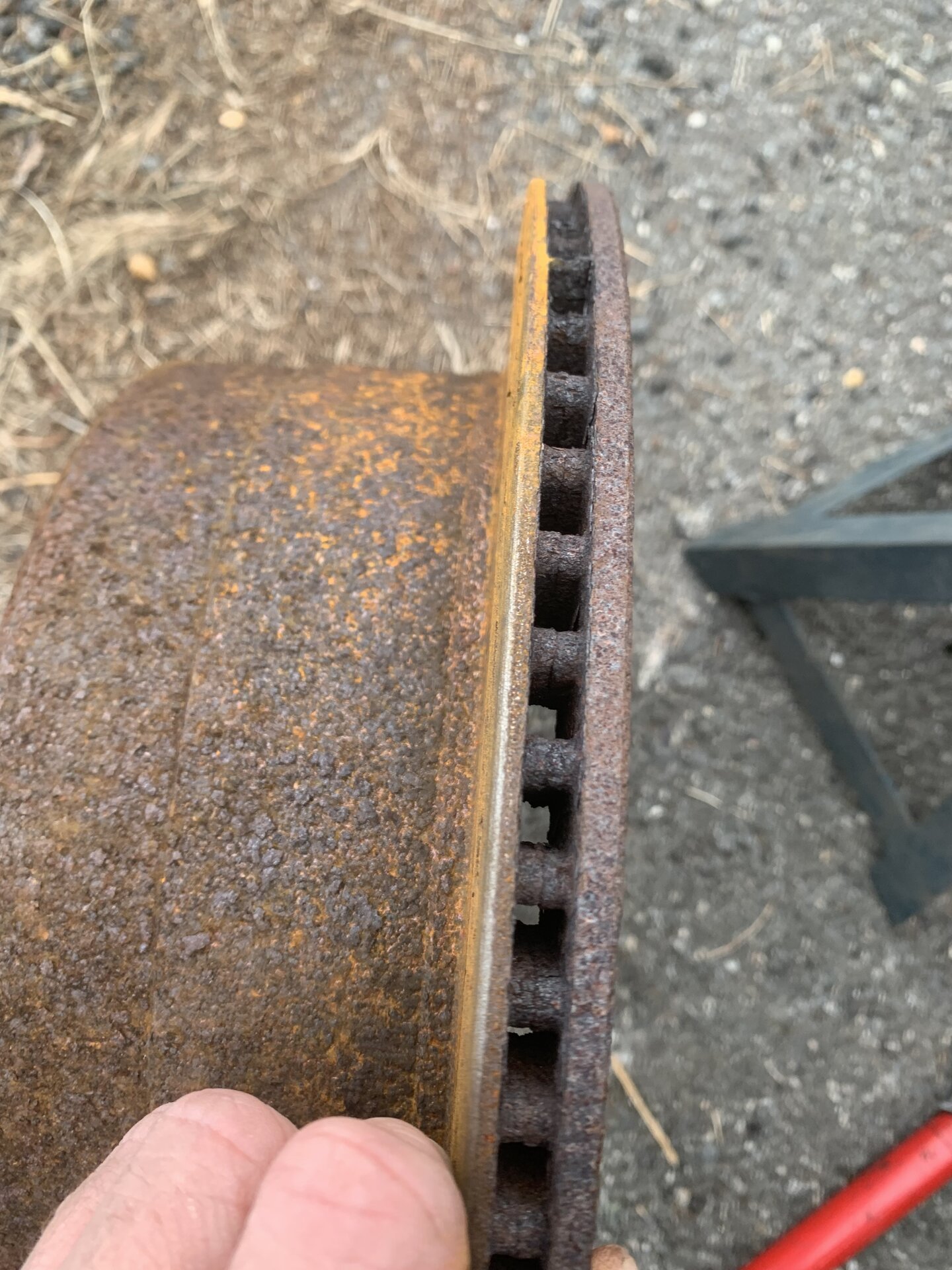

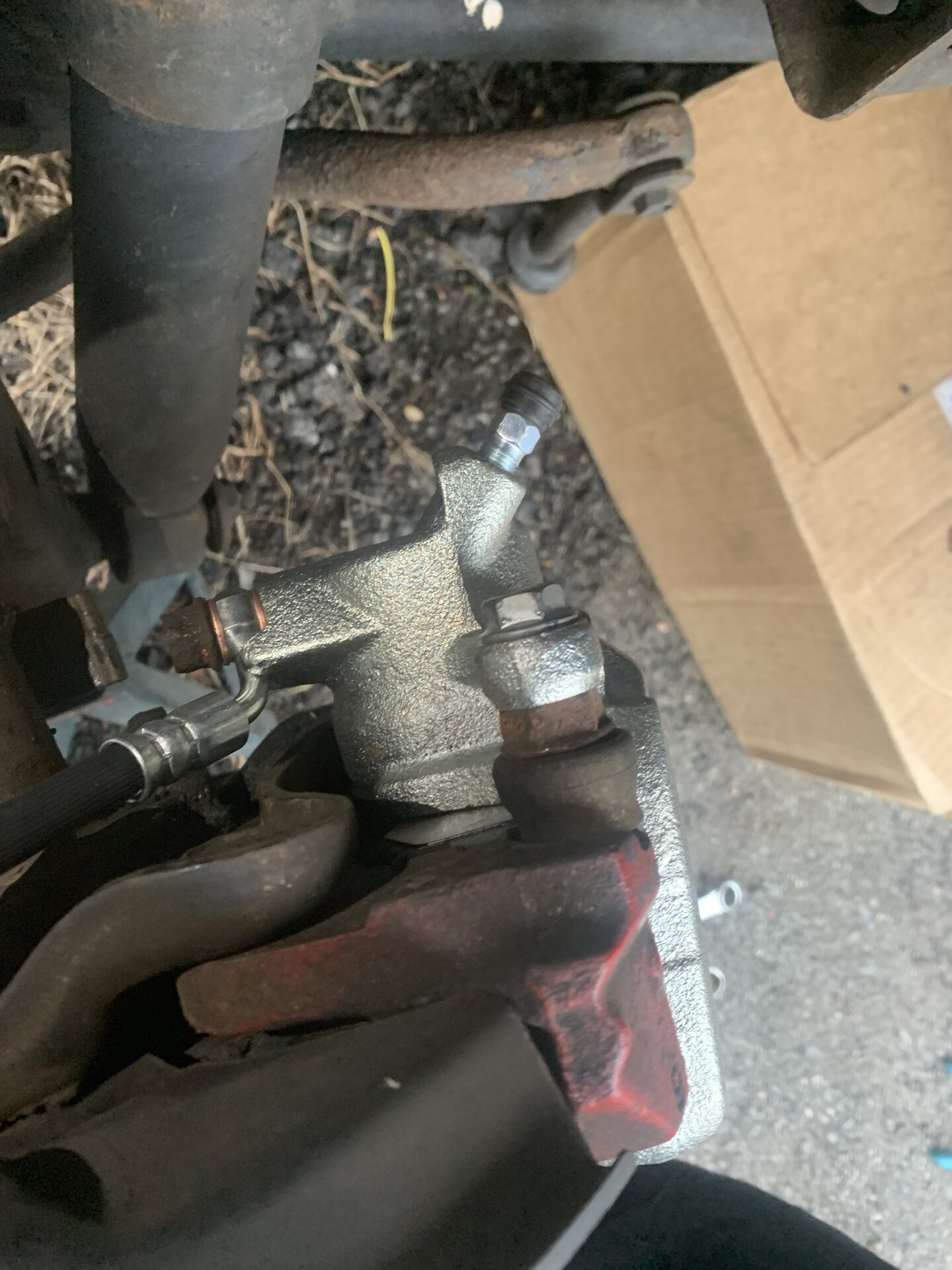

Hard to tell but the rotor is almost completely smoothed out and not even a cm of metal left thickness wise.
The outside pad just fell off at some point.

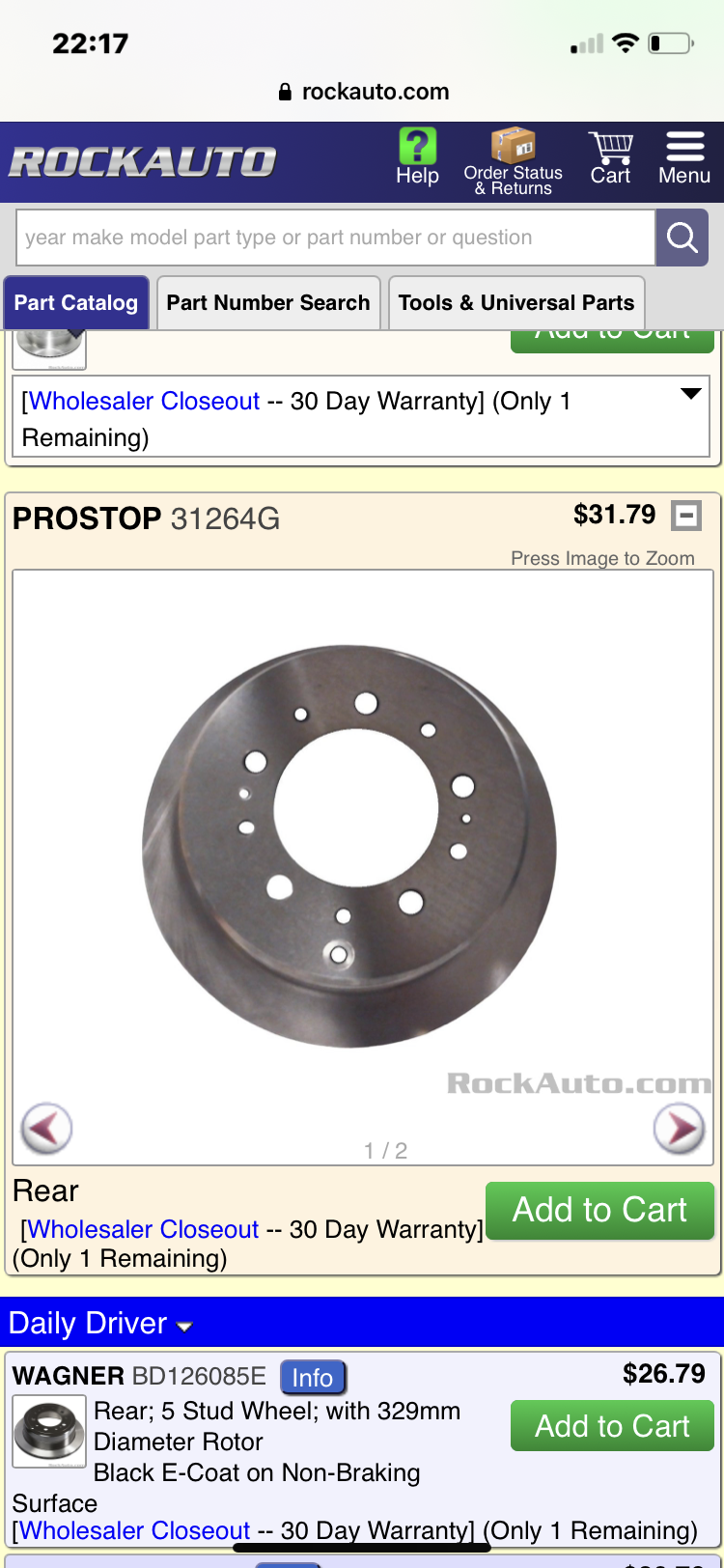

This is on order now:

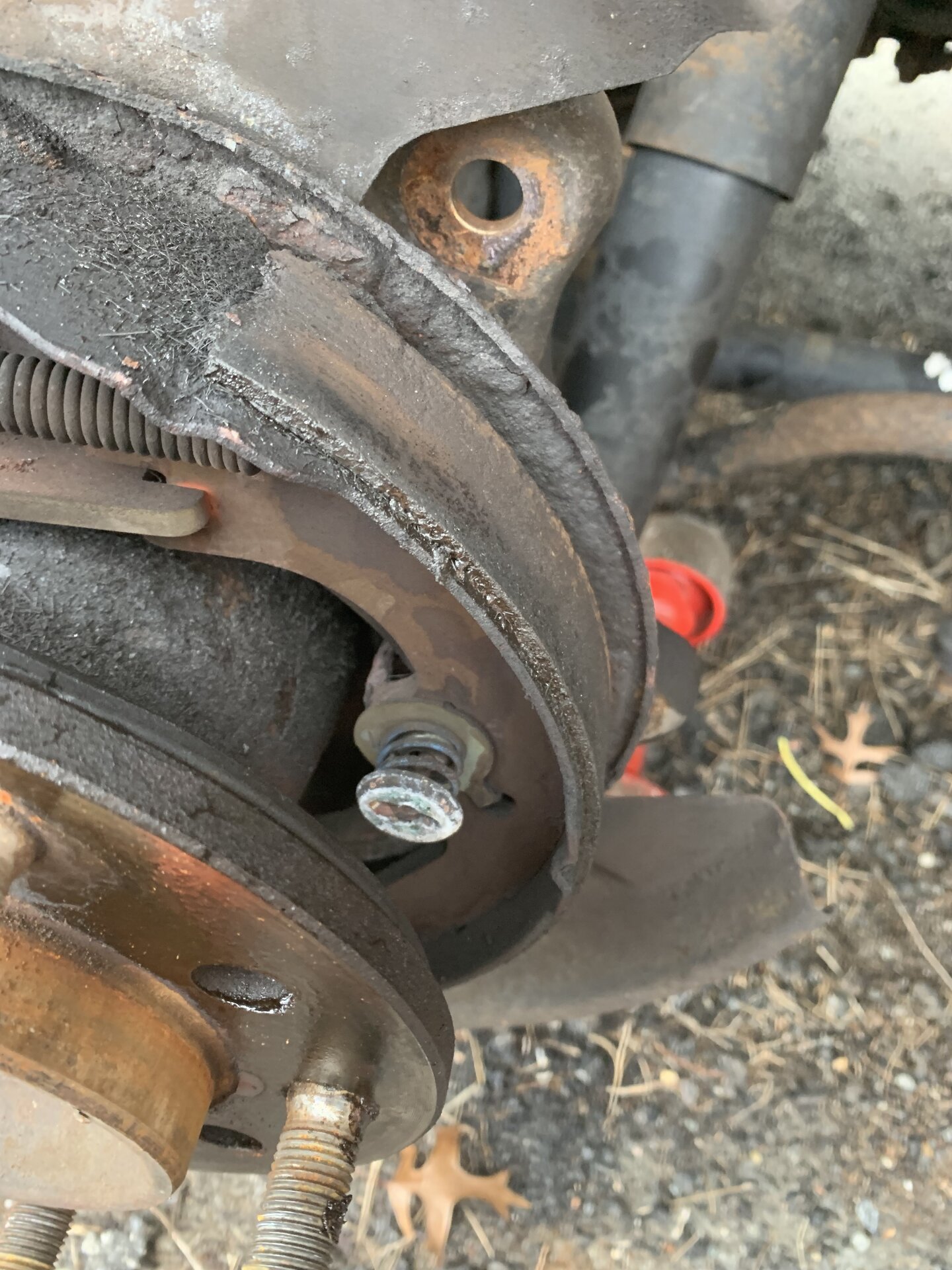

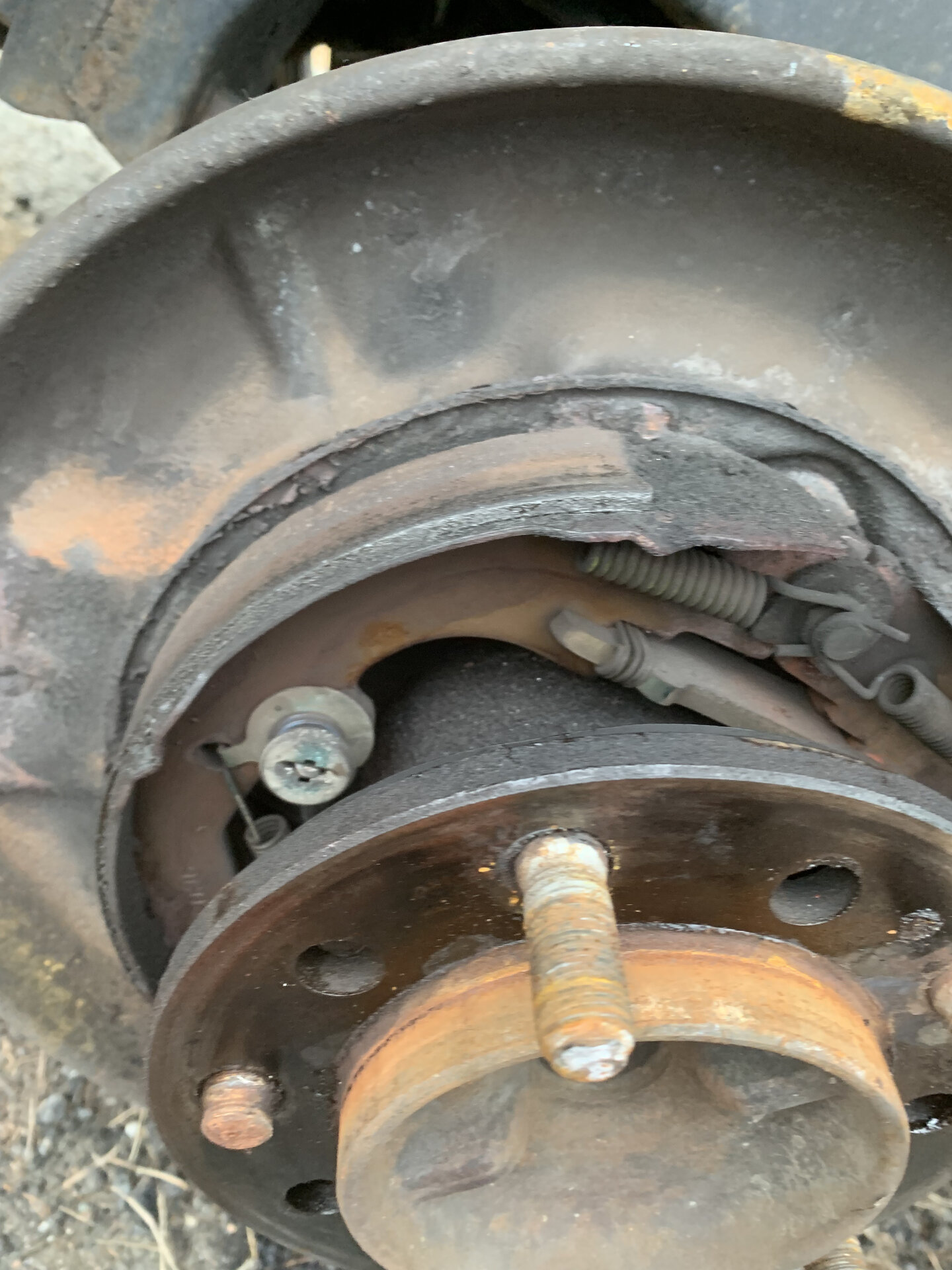

Got the rotor off. Parking brake shoes look like this, but I’m hesitant take it all apart.
Biggest issue is I can’t get the calliper piston to go back in to set it in place. Tried using my massIve C clamp that I use and it didn’t budge.
Aside from buying a new caliper, any suggestions?

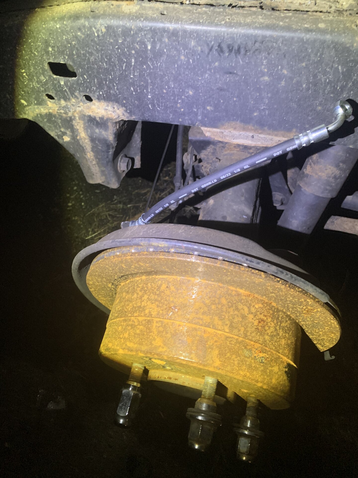

Month later and the cruiser is still on jackstands. Need a second vehicle desperately so I am pushing to get this done.

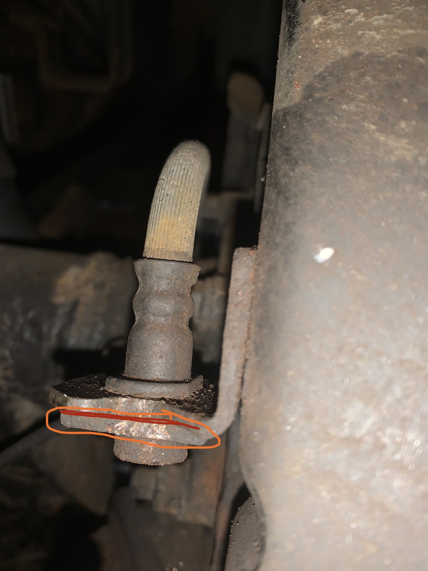

I bought a new rubber brake hose to go on, but cannot get the clip mount thing to come off to remove the old line and install the new one. Any tips?
You can try an inexpensive alternative in compressing the caliper piston using this tool from O’Reillys: Caliper Tool
But before you do that have you tried to relieve brake line pressure from the bleed valve?
Is it because of the rust that the clip have binded to the other part? If so you can cut that using a grinder cutting disk or any cutting tool of some sort and replace with a new one.
Yes it looks like the clip is rusted into the piece on the metal backing plate. How would I mount the new one if I cut the mount off?

Don’t cut the stationary part, just the removable clip. You may need a more precise cutting tool like a rotary hand tool (Dremel or a different brand) you can get cheap at Harbor Freight. Once off, clean the rusted surface with steel brush either by hand or using a rotary tool again to make it easier and apply epoxy primer/paint to mitigate rust.
Oh good call. I think we have a dremel somewhere, will try it stay tuned
So I understand, you’re saying the circled orange part is the lock tab itself, and I cut along the red line to separate correct?
Correct. The oem looks like this

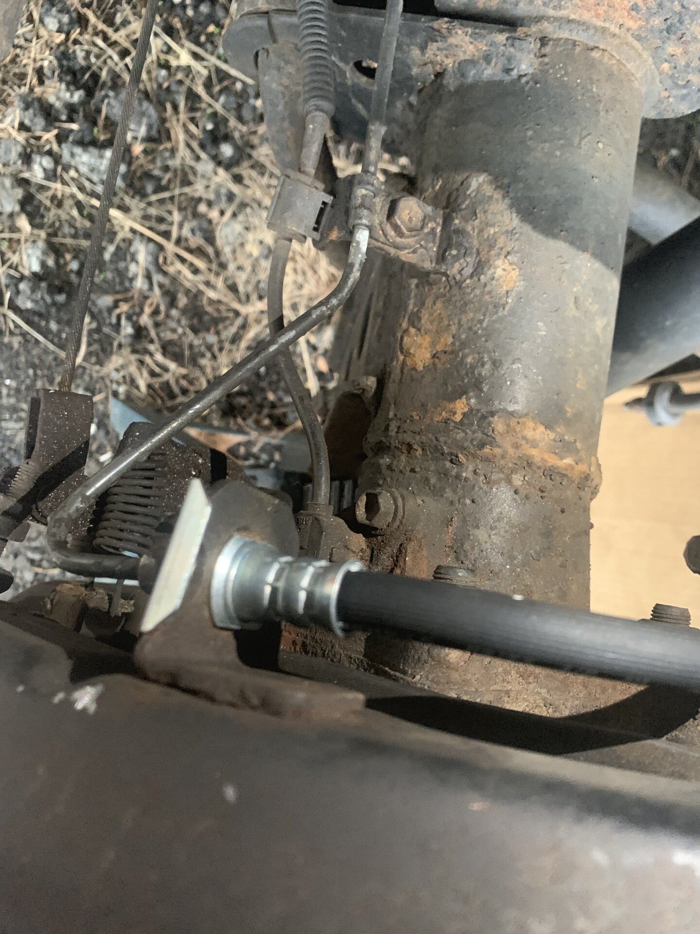

So 2am progress update:
Got the old clip and line off finally
Of course the new one doesn’t have the clip included with it…but it looks nice
And of course the caliper mounting bolts don’t thread into the new bracket. I don’t want to use the old bracket beside then I’d have to mess with the slide pins…so we’ll see what I can find. Have to source a clip too, and by Saturday because I really need this vehicle back on the road
