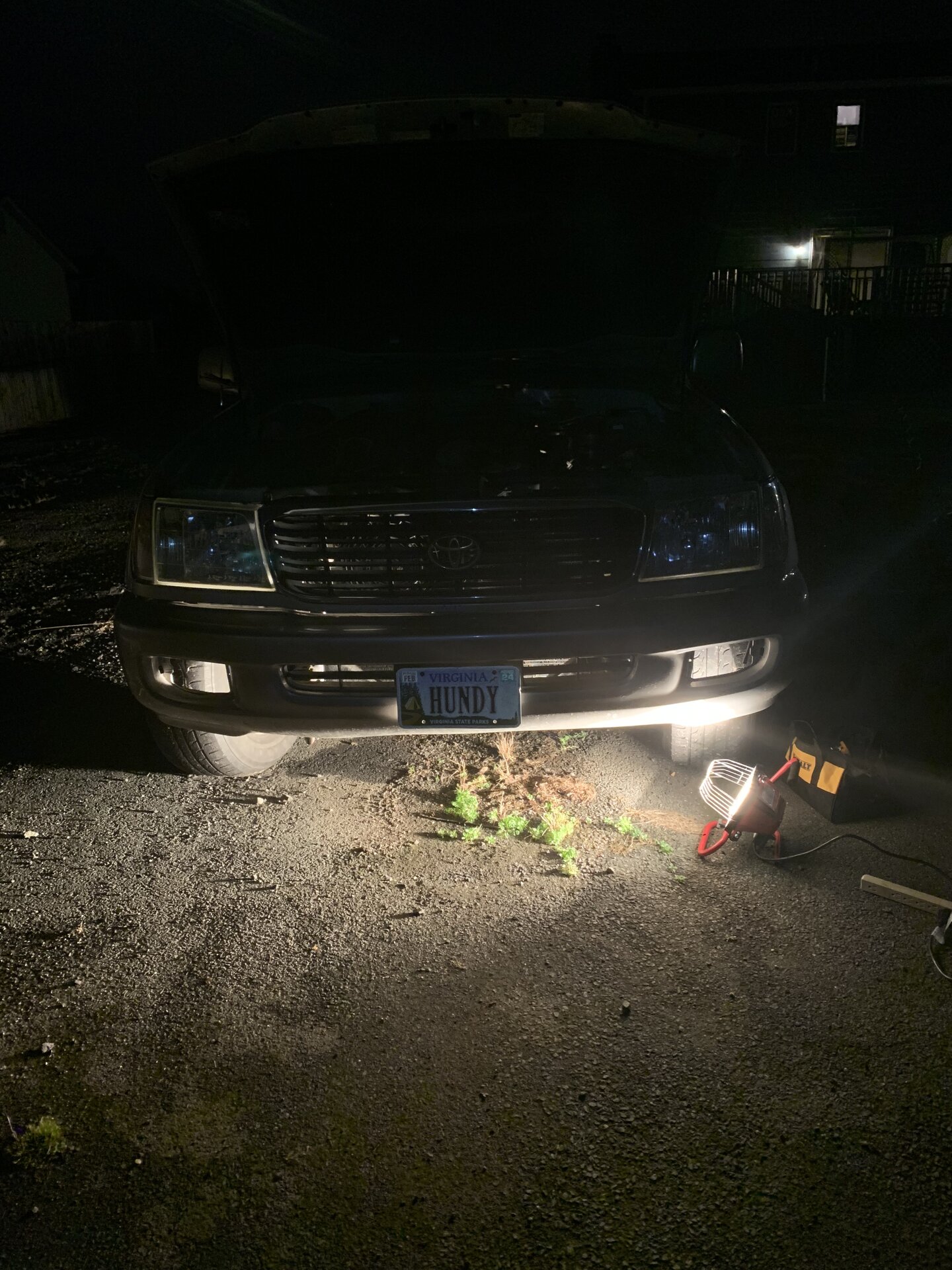

Work space- trying not to shine my walmart work light that was making heat on this 30-40 degree night into the neighbors windows proved challenging, but I perservered:

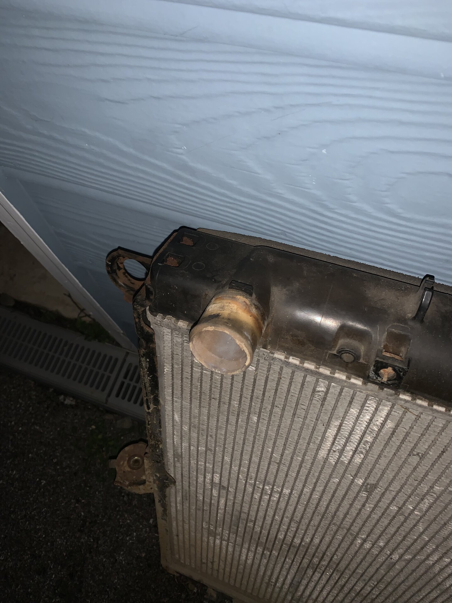

Got the old, brittle crusty radiator. Remember back in March when the alternator saga began and I found a hairline crack under the cap and slathered it in JB weld?

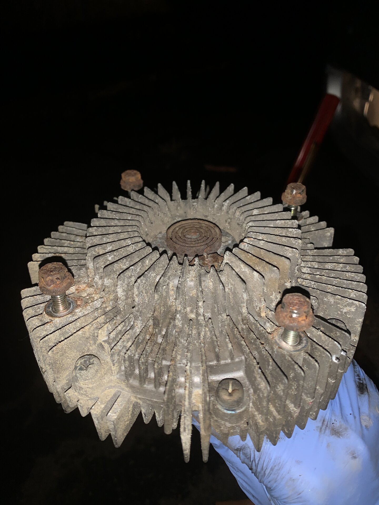

Fan clutch after a 20 min battle, had to use a soft mallet and a few breaker bars to get it free:
Moar:

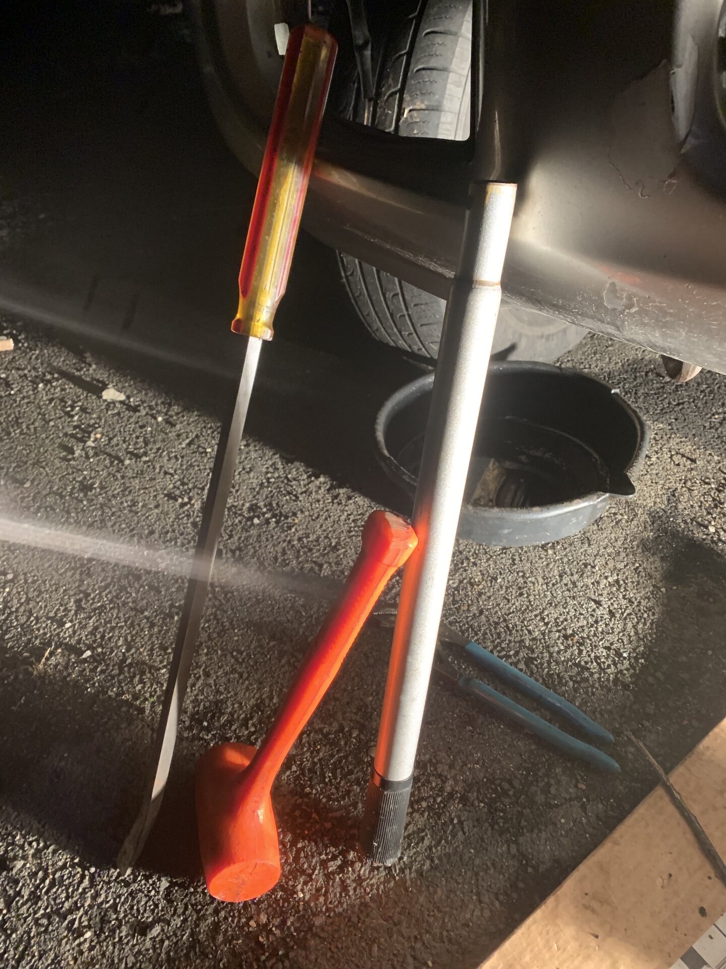

What I ultimately used to break the fan clutch off- I got the nuts off using the 2 wrench method- 1 boxhead/crescent head holds one nut, and another loosens the other.
Said fan clutch, I bought a 4seasons replacement to go on. The resistance of the new one vs. the old is night and day, old one spins freely new one doesn't hardly budge.
The bolts that held the fan in came out surprisingly easy with my DeWalt impact driver, not even an impact gun. Thankfully just the heads were crusty but the body was unphased. I bet this fan clutch served through 7 presidential terms in office.

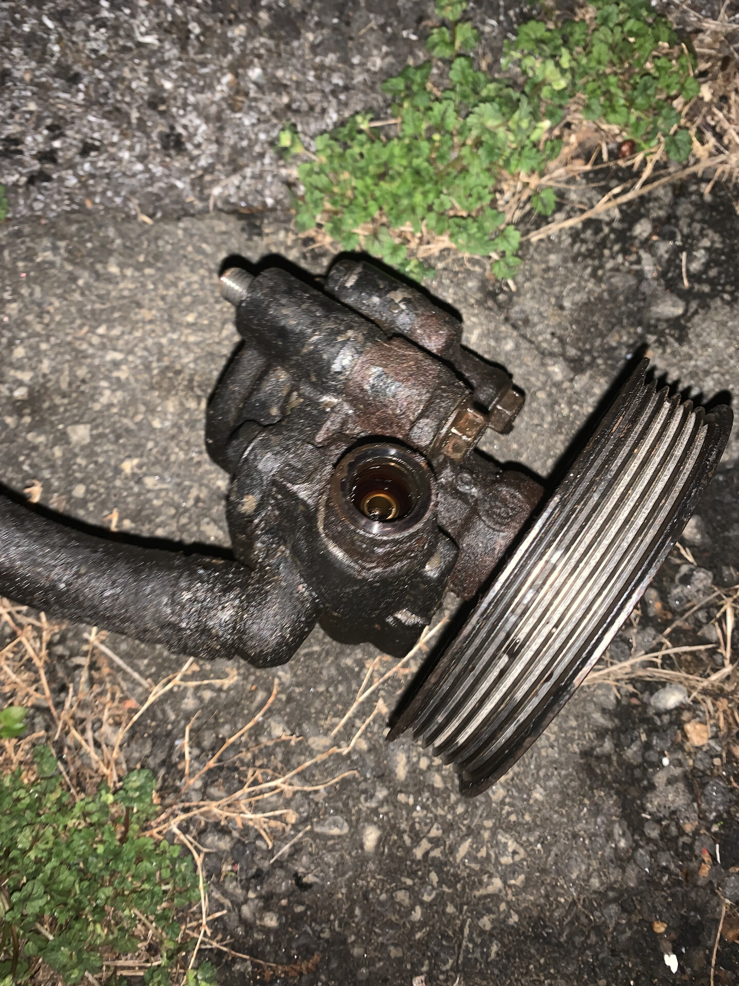

Accursed pump itself, note the abysmal condition of the soft line. The replacement line I bought an inline filter for.

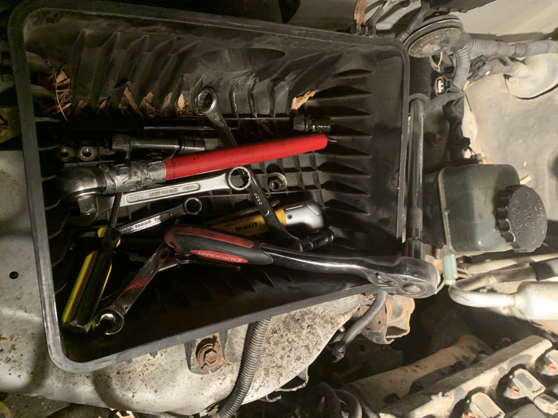

Bonus - realized the air box makes a nice tool and nut holding station.
