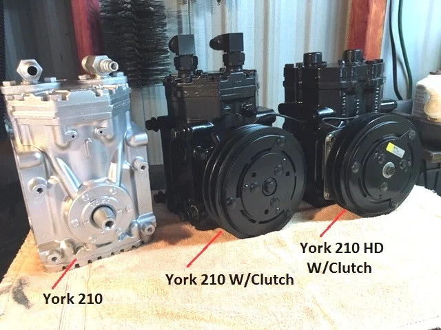

Eye sore or not, a York’s output is only necessary for those who NEED to run air tools in the great outdoors. It’s overkill for the vast majority.

Have 3 sitting in my shop right now and one on my Early Model Bronco......that I've used around the Ranch for many years. LOTS of air.

I have mounted underneith, in the rear, an extreme air magnum that will do all that. The York puts out magnificent CFM that you don’t need. Sell it and use the money to buy an electric pump and have room to install a food warmer over the manifold. Oh yeah, and enjoy better access to the engine ancillaries.

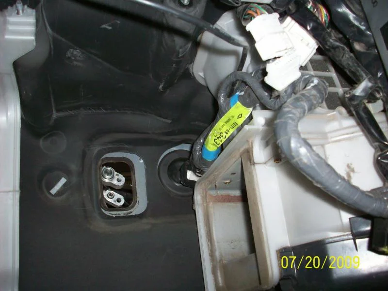

Pic of where the evap meets up with the hard A/C lines in the engine bay. To the right is the blower compartment where you'll find all sorts of debris and sometimes mouse nest!

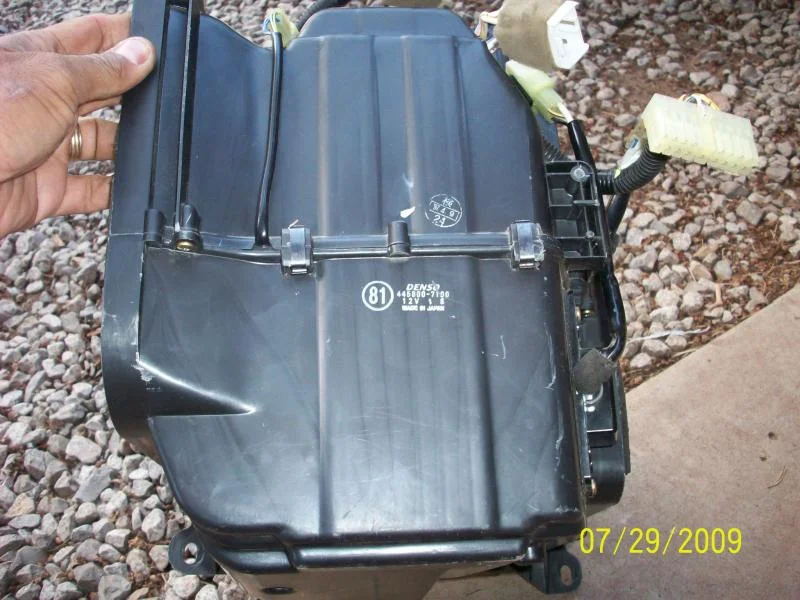

Second pic is of the cooling unit as it sits in the vehicle.

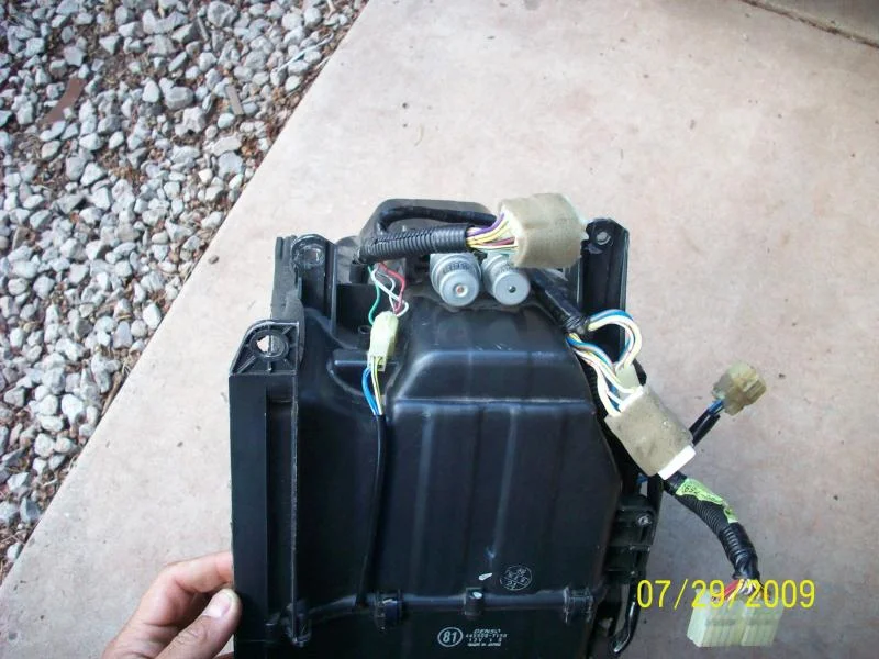

Third pic shows the clips and phillips screws that keep the two halves together.

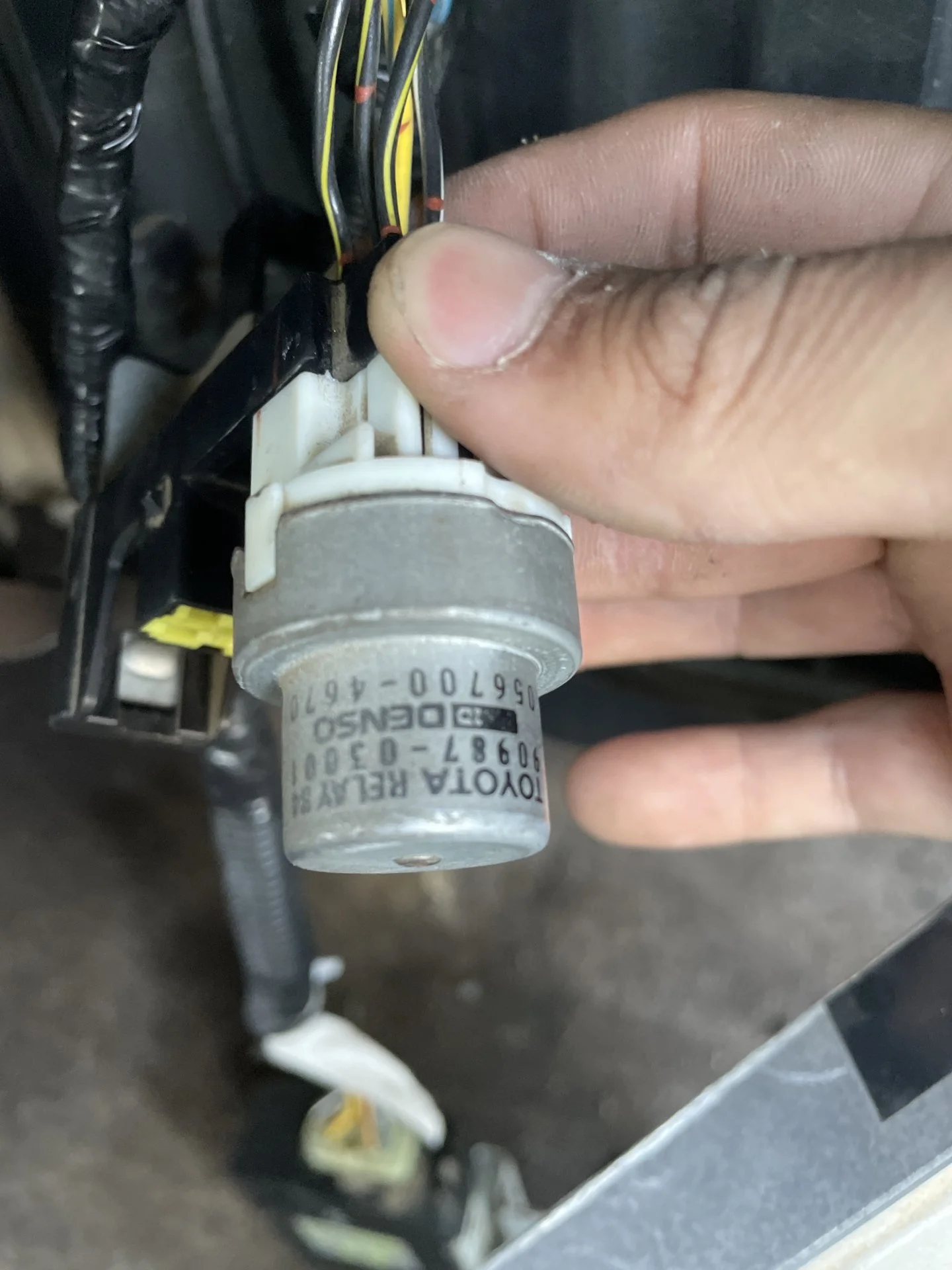

I seem to be missing one of the relays located on top of this unit would you happen to know what relay this is?
