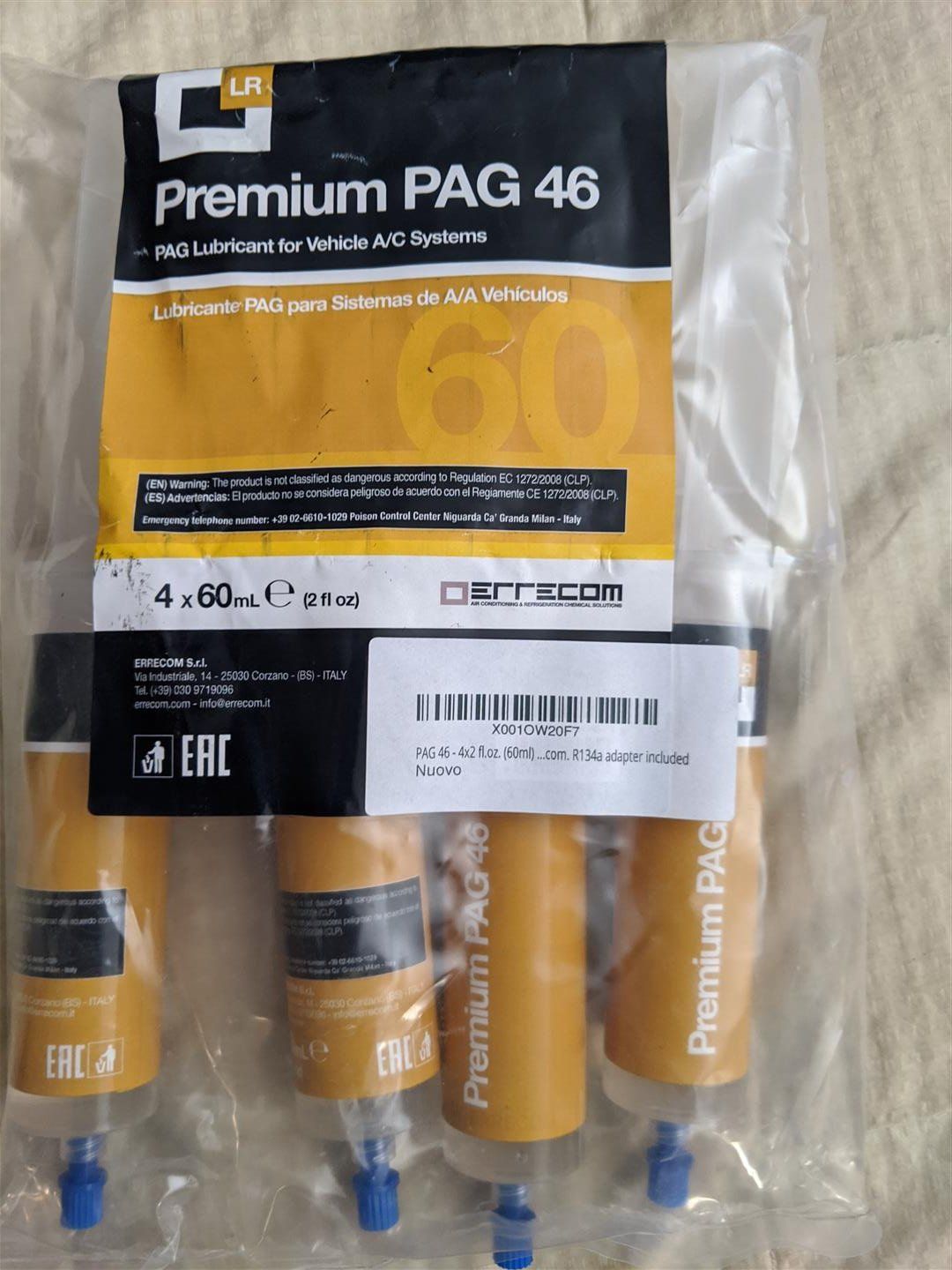

So I went looking for 2 oz of PAG 46 oil, and I found this on Amazon. Each syringe is 2 oz, so I only need one, but it was only 9 bucks the same as one big bottle at NAPA. I am a little concerned that 3 of the syringes appear to have some air in them. So my plan is to use the one that didn't have air and put half in the evaporator and half in the new drier as you recommended. Unless you tell me that using this PAG oil is a bad idea for some reason.
Thanks again.
Thanks again.
You’re not injecting it. You pour it in at the connection and then close it up. The air bubbles won’t make any difference because you pull a vacuum prior to charging.
